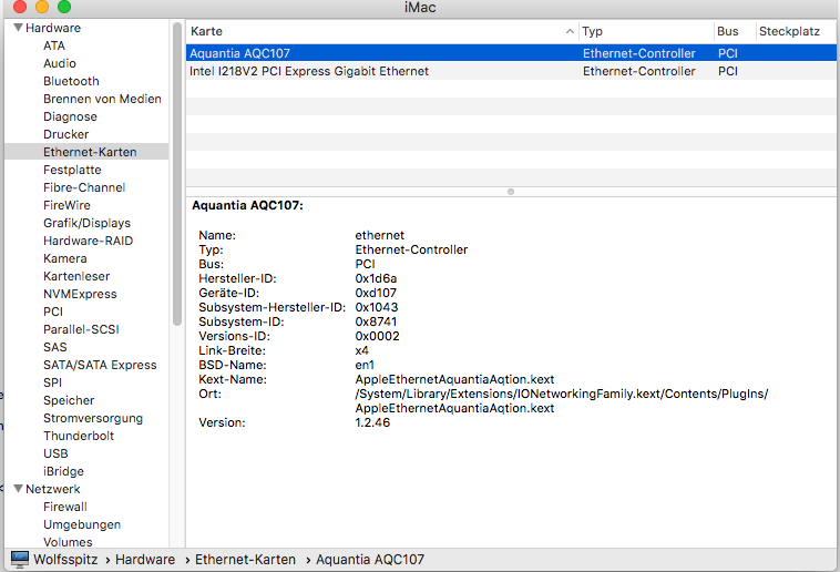

Mieze Posted January 30, 2018 Share Posted January 30, 2018 (edited) I've got bad news! I've got my card this afternoon, installed it in the machine (system definition iMac14,2), updated to 10.13.3 (from 10.13.2) but the firmware upgrade wasn't installed. No need to tell you, that it isn't working. It might be the system definition, or the fact that the Aquantia card is on en1 not en0 but this needs further investigation. Edit: I disabled the Intel onboard LAN (I218V) and tried again. Now the Aquantia NIC is on en2 and the firmware update has been installed. The card is working now! Really strange but on real Macs en1 usually is the Airport card. Maybe that's the reason why it failed the first time? Edit 2: I reenabled the Intel NIC in BIOS but I haven't been able to make both NICs work at the same time. When the Aquantia NIC is working, the Intel NIC is offline (no IP address or self assigned) and when I set the Intel NIC online the Aquantia NIC goes offline and vice versa. Neither DHCP nor manual configuration are able to make both chips work at the same time although both are working on the driver level. Really strange behavior. Never seen anything like that. Mieze Edited January 30, 2018 by Mieze Link to comment https://www.insanelymac.com/forum/topic/330614-marvell-aquantia-10-gb-ethernet-support-thread/page/3/#findComment-2580479 Share on other sites More sharing options...
ydeng Posted January 31, 2018 Share Posted January 31, 2018 I've got bad news! I've got my card this afternoon, installed it in the machine (system definition iMac14,2), updated to 10.13.3 (from 10.13.2) but the firmware upgrade wasn't installed. No need to tell you, that it isn't working. Bildschirmfoto 2018-01-30 um 19.45.29.png It might be the system definition, or the fact that the Aquantia card is on en1 not en0 but this needs further investigation. Edit: I disabled the Intel onboard LAN (I218V) and tried again. Now the Aquantia NIC is on en2 and the firmware update has been installed. The card is working now! Really strange but on real Macs en1 usually is the Airport card. Maybe that's the reason why it failed the first time? Bildschirmfoto 2018-01-30 um 20.04.02.png Edit 2: I reenabled the Intel NIC in BIOS but I haven't been able to make both NICs work at the same time. When the Aquantia NIC is working, the Intel NIC is offline (no IP address or self assigned) and when I set the Intel NIC online the Aquantia NIC goes offline and vice versa. Neither DHCP nor manual configuration are able to make both chips work at the same time although both are working on the driver level. Really strange behavior. Never seen anything like that. Mieze How about use 13.2 driver for AQC? Link to comment https://www.insanelymac.com/forum/topic/330614-marvell-aquantia-10-gb-ethernet-support-thread/page/3/#findComment-2580709 Share on other sites More sharing options...

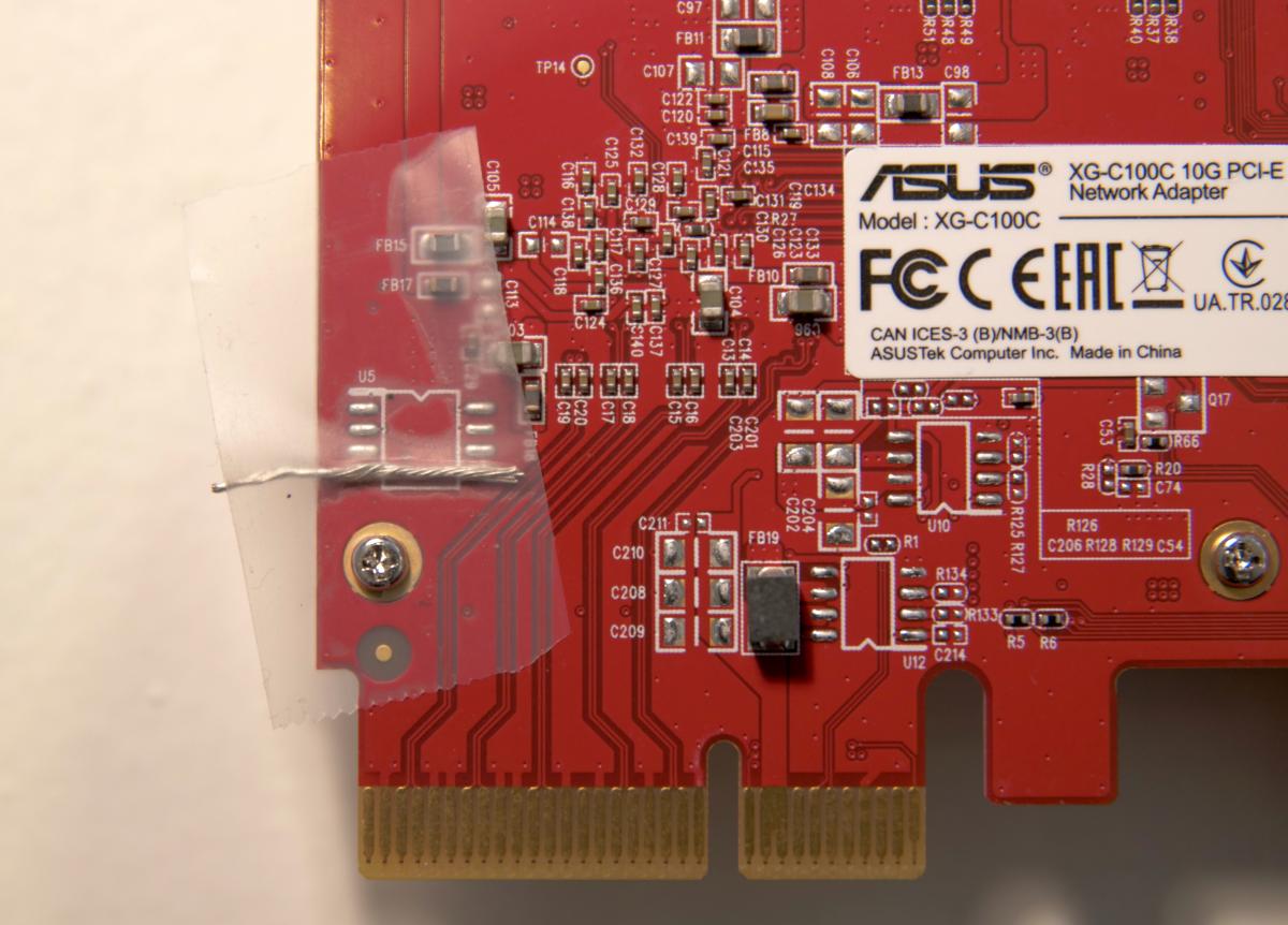

Dogman Posted February 1, 2018 Share Posted February 1, 2018 I've got it running with shortened pin 4 and 5. Vendor id is 0x1d6a but device id is 0x0001. The card shows up but pretends that no cable is connected which is not true of course Because of the 2 nics of the cMP the interface of my Asus xg-c100c interface is en2. Like Mieze said, maybe that's the reason it does not upgrade the card. Will try hackintosh next, just need to finish some projects first. 2 Link to comment https://www.insanelymac.com/forum/topic/330614-marvell-aquantia-10-gb-ethernet-support-thread/page/3/#findComment-2581972 Share on other sites More sharing options...
Paps4 Posted February 1, 2018 Share Posted February 1, 2018 Dogman, could you kindly show a picture of which are the right pins (4&5) to short out. I'm looking at the bottom of the card (U5) but can't understand the orientation. Link to comment https://www.insanelymac.com/forum/topic/330614-marvell-aquantia-10-gb-ethernet-support-thread/page/3/#findComment-2581976 Share on other sites More sharing options...
Dogman Posted February 1, 2018 Share Posted February 1, 2018 Of course. Here you go. But like I said, it does not work yet. 2 Link to comment https://www.insanelymac.com/forum/topic/330614-marvell-aquantia-10-gb-ethernet-support-thread/page/3/#findComment-2582048 Share on other sites More sharing options...

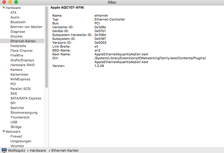

Dogman Posted February 5, 2018 Share Posted February 5, 2018 The interface name turned out to be irrelevant but for the upgrade to succeed it is crucial that the Aquantia NIC is the only ethernet NIC in the system. In a Hackintosh onboard LAN can be disabled in BIOS and additional cards may be removed but you will have a hard time performing the upgrade in a MacPro as there is no way to disable onboard LAN. Mieze Hey Mieze! I tried in on my Gigabyte Z170X-Designare with disabled onboard LAN on a clean 10.13.3 with newest clover 4392. The ASUS card was found as en0, but still has the vendor id 0x1d6a and device id 0x0001. Do you have any idea on how to force the upgrade? Kind regards! Edit: I found these lines while booting: AppleEthernetAquantiaAqtion::reset_enet_fw:786:error AppleEthernetAquantiaAqtionFirmware::doFirwareUpload 0.0.0 AppleEthernetAquantiaAqtion::notifyFwUploadCompleted:632 completed fw upload Macros: status, file /BuildRoot/Library/Cahces/com.apple.xbs/Sources/AppleEthernetAquantiaAqtion/AppleEthernetAquantiaAqtion-16.40.3/AppleEthernetAquantiaAqtion/if_axge.cpp line 5??5, value 0 Copied them from a bad photo. Where do I find these lines on my Mac? Link to comment https://www.insanelymac.com/forum/topic/330614-marvell-aquantia-10-gb-ethernet-support-thread/page/3/#findComment-2585138 Share on other sites More sharing options...
d5aqoep Posted February 5, 2018 Author Share Posted February 5, 2018 Hey Mieze! I tried in on my Gigabyte Z170X-Designare with disabled onboard LAN on a clean 10.13.3 with newest clover 4392. The ASUS card was found as en0, but still has the vendor id 0x1d6a and device id 0x0001. Do you have any idea on how to force the upgrade? Kind regards! Edit: I found these lines while booting: AppleEthernetAquantiaAqtion::reset_enet_fw:786:error AppleEthernetAquantiaAqtionFirmware::doFirwareUpload 0.0.0 AppleEthernetAquantiaAqtion::notifyFwUploadCompleted:632 completed fw upload Macros: status, file /BuildRoot/Library/Cahces/com.apple.xbs/Sources/AppleEthernetAquantiaAqtion/AppleEthernetAquantiaAqtion-16.40.3/AppleEthernetAquantiaAqtion/if_axge.cpp line 5??5, value 0Copied them from a bad photo. Where do I find these lines on my Mac?Clean install 10.13.2 and update to 10.13.3 through mac app store. That will trigger the firmware update. Make sure that you have disabled onboard LAN before updating. Link to comment https://www.insanelymac.com/forum/topic/330614-marvell-aquantia-10-gb-ethernet-support-thread/page/3/#findComment-2585191 Share on other sites More sharing options...
