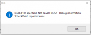

Cyberdevs Posted November 12, 2017 Share Posted November 12, 2017 black screen Just out of curiosity can you tell me the device ID for your GPU? Is it 67B0? right? Link to comment https://www.insanelymac.com/forum/topic/328549-tracing-back-the-amd-gpu-wakeup-issue-to-its-origin/page/7/#findComment-2533282 Share on other sites More sharing options...
MattsCreative Posted November 12, 2017 Share Posted November 12, 2017 Just out of curiosity can you tell me the device ID for your GPU? Is it 67B0? right?yup all the info was in the bios I gave you and the 290x has only one device Id Sent from my iPhone using Tapatalk Link to comment https://www.insanelymac.com/forum/topic/328549-tracing-back-the-amd-gpu-wakeup-issue-to-its-origin/page/7/#findComment-2533283 Share on other sites More sharing options...

Cyberdevs Posted November 12, 2017 Share Posted November 12, 2017 yup all the info was in the bios I gave you and the 290x has only one device Id Sent from my iPhone using Tapatalk When I tried to open the BIOS there was an error. So I couldn't say for sure, and I know that there's only one device ID for R9 290X but if it has a custom VBIOS or if it is a custom designed GPU things might change. Anyways your problem is solved and that's what matters. Link to comment https://www.insanelymac.com/forum/topic/328549-tracing-back-the-amd-gpu-wakeup-issue-to-its-origin/page/7/#findComment-2533291 Share on other sites More sharing options...
