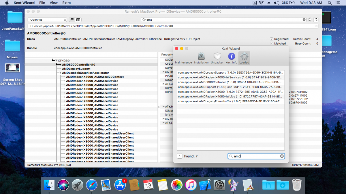

SiddRamesh Posted December 12, 2017 Share Posted December 12, 2017 Finally I got my AMD GPU working, only issue is black screen Link to comment https://www.insanelymac.com/forum/topic/328549-tracing-back-the-amd-gpu-wakeup-issue-to-its-origin/page/12/#findComment-2549164 Share on other sites More sharing options...
SiddRamesh Posted December 12, 2017 Share Posted December 12, 2017 display is not getting detected properly n also m getting artefacts ! how can i unlock 30bit colors Link to comment https://www.insanelymac.com/forum/topic/328549-tracing-back-the-amd-gpu-wakeup-issue-to-its-origin/page/12/#findComment-2549350 Share on other sites More sharing options...
Gigamaxx Posted December 12, 2017 Share Posted December 12, 2017 display is not getting detected properly n also m getting artefacts ! how can i unlock 30bit colors It looks like you have no accelerator kext loaded. Have you tried to add your 0x????1002 Device ID to one of the AMD?000kexts info.plist? Link to comment https://www.insanelymac.com/forum/topic/328549-tracing-back-the-amd-gpu-wakeup-issue-to-its-origin/page/12/#findComment-2549494 Share on other sites More sharing options...

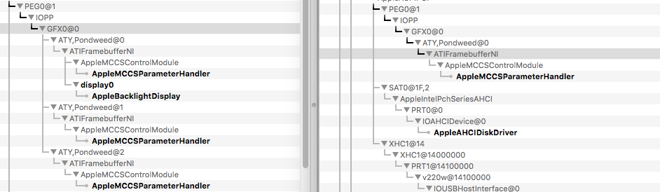

SiddRamesh Posted December 13, 2017 Share Posted December 13, 2017 I thing I got QE/CI! But now my only concern is 30-bit colors(its present in 10.11.6), how can I achieve it ! Sir I got QE/CI with screen Now my only concern is, how can I unlock 30-bit color (I got it in 10.11.6) ! AMD6000Controller/LVDS -Pondweed Sir its strange I've injected 2 FB patches 1. AMD FrameBuffer Utility FB 02000000 00010000 19010100 00000000 10000505 00000000 (LVDS) Patch 02000000 40000000 09010100 00000000 10010007 00000000 2. Manually Generated FB 00040000 04030000 00010000 12040105. (DP) Patch 02000000 40000000 08010000 10000107 1 Link to comment https://www.insanelymac.com/forum/topic/328549-tracing-back-the-amd-gpu-wakeup-issue-to-its-origin/page/12/#findComment-2549806 Share on other sites More sharing options...
SiddRamesh Posted December 13, 2017 Share Posted December 13, 2017 Now m facing another issue the screen is looking reddish ! The screen appears to be ok , but from certain angle it looks redish, while in 10.11.6 its clear n white(ok). Link to comment https://www.insanelymac.com/forum/topic/328549-tracing-back-the-amd-gpu-wakeup-issue-to-its-origin/page/12/#findComment-2549911 Share on other sites More sharing options...
