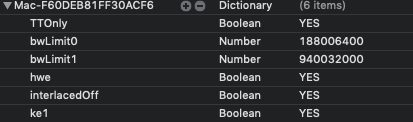

Try this config and dAGPM.kext. I don't think you can rename the kext to dAGPM-61.kext so just leave it as dAGPM.kext. I read the WEG source again and noticed we were both wrong for the shikigva, it should be shikigva=40. After you have booted with this config and this dAGPM.kext, run this VideoDecoderChecker.
You also might need to disable the iGPU completely in BIOS in order for hardware encoding/decoding to work for the dGPU. I noticed you had ig-platform-id set in the config.
MacNB-macpro.zip

One question: In the dAGPM.kext info.plist under the Machines section, you have:
			<key>Machines</key>
			<dict>
				<key>Mac-F60DEB81FF30ACF6</key>
				<dict>
					<key>Vendor1002Device687f</key>
I assume that Vendor1002Device687f is for your Vega so should I change that to Vendor1002Device67df (for my RX 580) ?
2 hours ago, MacNB said:
Thanks. I'll try it when I get home.
			<key>Machines</key>
			<dict>
				<dict>
Ah yes, I forgot to change the device-id.

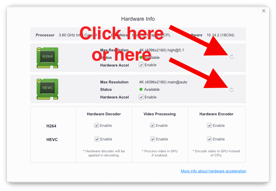

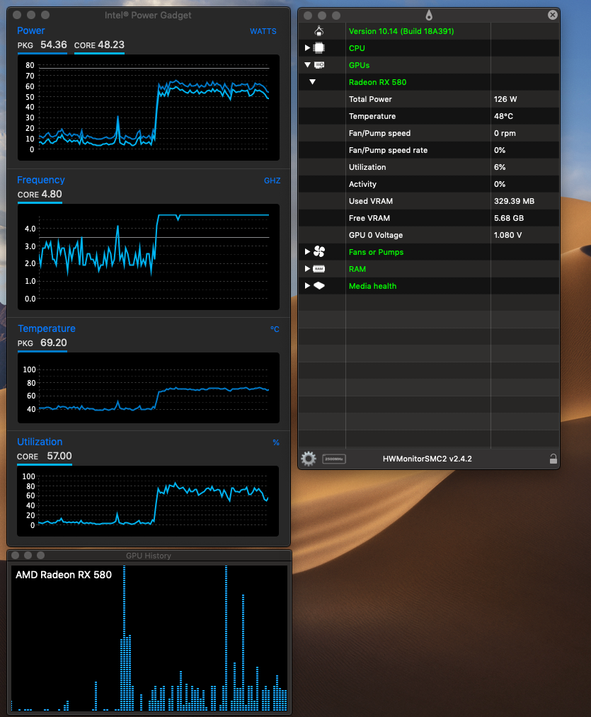

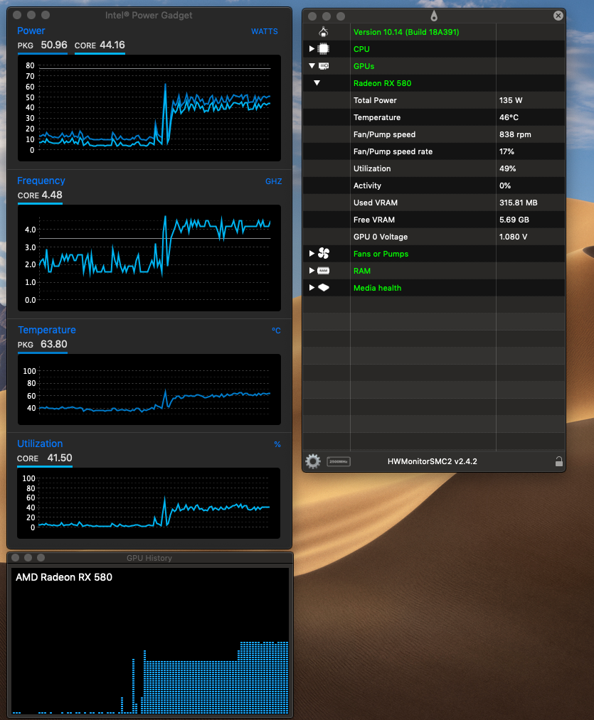

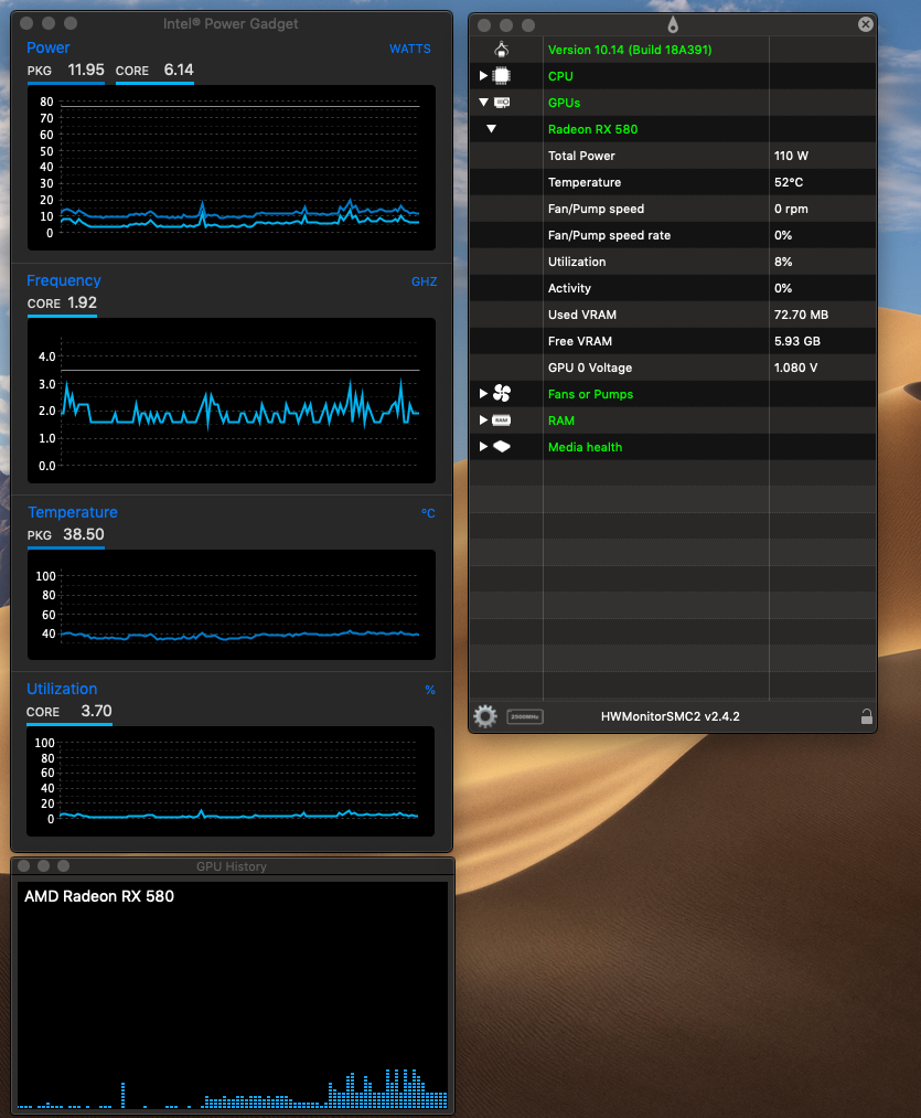

OK. So I tried your config file and Injector kext with IGPU disabled in the BIOS.
No real joy.
- H.264 4K playback seemed fine. Very little CPU or GPU load
- HEVC 4k playback played but CPU maxed out @4.8Ghz with RX580 ~ 45%
- H.264 4k to H.264 HD transcode via Compressor : system freeze/very sluggish - reset required.
- HEVC 4k to HEVC HD transcode via Compressor : works but CPU maxed out @4.8Ghz with RX580 ~ 10%
I also tried renaming GFX0 to GFX1 (MacPro's use GFX1 and GFX2) - makes no difference.
BTW, I am still on original Mojave 10.14.0 as that build still has the IOGVACodec AMDU6V3 for RX580 (IOGVACodec AMDU7V4 for Vega).
In 10.14.1 & .2, Apple removed it so people are using an Injector kext to Inject it back in.
H.264 Playback:
HEVC playback:
HEVC 4k to HEVC HD transcode:
Edited by MacNB
added image labels

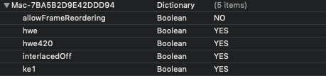

@vit9696 Can you explain why when using shikigva=40 shiki-id=Mac-7BA5B2D9E42DDD94 while using MacPro6,1 SMBIOs produces Unsupported Plug-In for Safari when watching Amazon Prime videos and screen capture tech and Hardware encoding/decoding works but when I remove shikigva=40 shiki-id=Mac-7BA5B2D9E42DDD94 and use iMacPro1,1 SMBIOS, Safari Amazon Prime videos, screen capture tech and hardware encoding/decoding work perfectly fine?
5 hours ago, vit9696 said:
@Pavo, most likely it has something to do with some kind of additionally applied capabilities. You are welcome to research it, I do not have a straightforward idea right now.
Ok here is kernel logs with using Lilu and WhateverGreen debug kexts with debug enabled for all. Only change I made was changing the SMBIOS between the kernels logs.

Well there is some differences in AppleGVA Info.plist between a iMacPro1,1 and MacPro6,1.
iMacPro1,1:
MacPro6,1:
