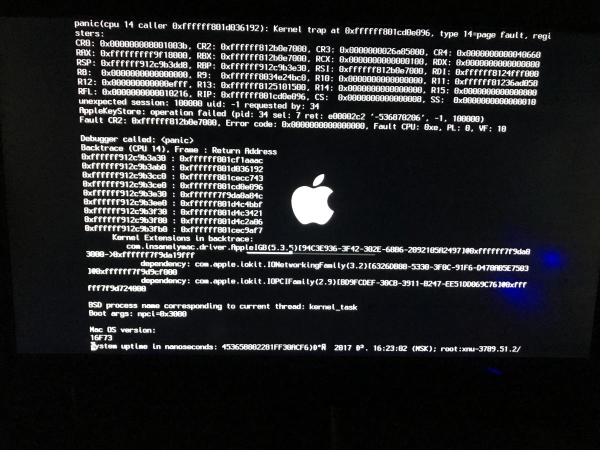

bbmatias3 Posted July 3, 2017 Share Posted July 3, 2017 After I install Microsoft office this always happens.. my fix is to reinstall everything:( can anyone help me? Link to comment Share on other sites More sharing options...
Bronya Posted July 3, 2017 Share Posted July 3, 2017 Try delete this kext apple1gb... Link to comment Share on other sites More sharing options...
bbmatias3 Posted July 3, 2017 Share Posted July 3, 2017 Okay thanks but that's the one I use for my Ethernet to work lol Link to comment Share on other sites More sharing options...
TheRacerMaster Posted July 3, 2017 Share Posted July 3, 2017 AppleIGB tends to cause panics. See if you can find another driver for your NIC. Link to comment Share on other sites More sharing options...
samaelestevez Posted July 3, 2017 Share Posted July 3, 2017 AppleIGB tends to cause panics. See if you can find another driver for your NIC. I also have issues using it, Ethernet disconnects frequently. What alternatives are there for Intel gigabit i211? Link to comment Share on other sites More sharing options...

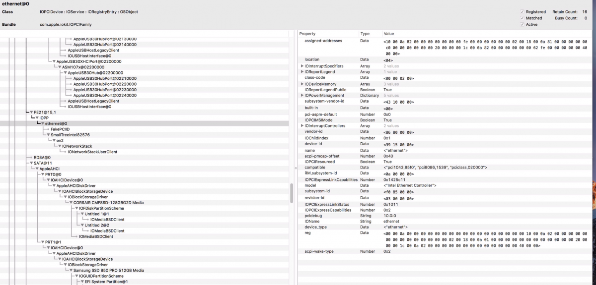

ydeng Posted July 6, 2017 Share Posted July 6, 2017 Hey @Gigamaxx I have intel i211at any way to make my ethernet work? Have you tried Sierra high? Did you try SmallTreeIntel82576.kext ? You need to use rehabman's fakepciid_igb to set the subsystem id to 0a for the driver to load. Screen shot running AppleRemoteDestop. AppleIGB would instantly panic when ARD connection is attempted. The only trick is that you need to get fakepciid_igb to load first. Tonymac has a long thread on small-tree drivers. i211 uses weird eeprom cannot be modified by ethtools. There seems to be an Intel program on the internet to reprogram the subdevice id but I have not tried it. 1 Link to comment Share on other sites More sharing options...
bbmatias3 Posted July 6, 2017 Share Posted July 6, 2017 I have tried High Sierra but it gets kernel panic, Bronya mentioned we need to wait for Apple to publish source code? It got pretty close, enabled all 16cpus but stuck with UsBHostcontrollerkext, or Darwin Kenrel panic. High Sierra developer beta has Immutable kernels (2 total in Prelinked Kernel folder). Might be a pain to fix. Hopefully we will be able to use it , im thinking of getting a rx 580 for native support in sierra high lol Did you try SmallTreeIntel82576.kext ? You need to use rehabman's fakepciid_igb to set the subsystem id to 0a for the driver to load. Screen shot running AppleRemoteDestop. AppleIGB would instantly panic when ARD connection is attempted. The only trick is that you need to get fakepciid_igb to load first. Tonymac has a long thread on small-tree drivers. i211 uses weird eeprom cannot be modified by ethtools. There seems to be an Intel program on the internet to reprogram the subdevice id but I have not tried it. Ill give it a shot thanks Link to comment Share on other sites More sharing options...
