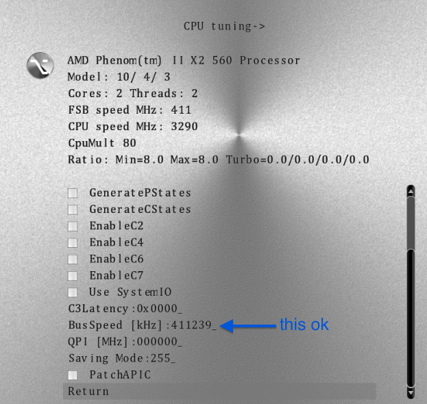

@Slice, in "main.c" need change this :
// Check if QPI is used
  if (gSettings.QPI == 0) {
    // Not used, quad-pumped FSB; divide ExternalClock by 4
    gCPUStructure.ExternalClock = gCPUStructure.ExternalClock / 4;
to
if (gCPUStructure.Vendor == CPU_VENDOR_INTEL){
Because this gSettings.QPI work only for Intel ! For AMD "QPI" doesn't exist !

OK, I will change something here.
As a workaround I'll propose to not set QPI=0. There is better to set BusSpeed here.
There are 5 pages discussion with Sherlocks what is ExternalClock and how to set it.
But I think AMD CPU should work own way.

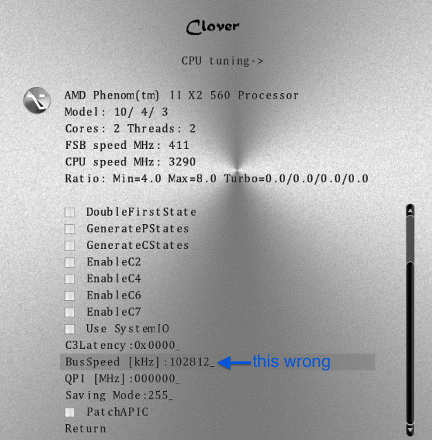

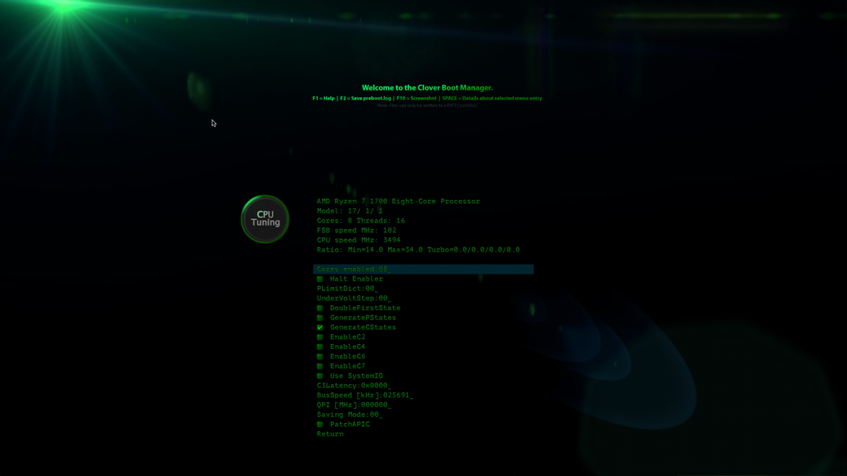

I tested and i getting BusSpeed  102 Mhz <-- this wrong ... Need 200 Mhz ... If official BusSpeed without "QPI", it works .
Example :
1) If without "QPI" , only BusSpeed , i getting this :
2) if use this formula :
i getting this :
​I used parallel desktop ...
OMG , In bios installed min ratio = 4 , but in Clover menu show = 2 . This also wrong ...
Ok i need fix this ...

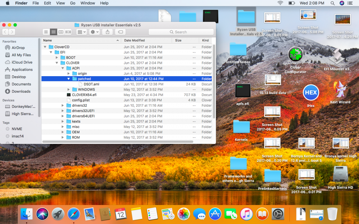

Do you have a DSDT file in your clover ACPI folder?    See pic, if so try removing it, actually check all the ACPI folders.
2).   busratio=xx in clover boot arg.?   or is it set in clover CPU settings as frequency MHz?
Example :
i getting this :

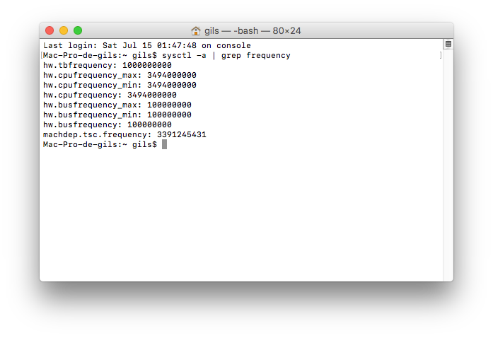

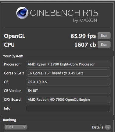

This Clover 4114 can boot 10.10.5 of Ryzen 1700X hackintosh to desktop, but its timer runs too fast and got very poor performance as previous bug at 10.9.5.
It can not boot 10.11.6 yet !
Is there any fix for this bug ?
This efi_4114 problem with timer if with new kernel 10.9.5 ???
Show, please, boot.log from clover
$ bdmesg >boot-log.txt
The boot-log.txt was attached here.
The new kernel dated on 2017-07-01 worked perfectly with EFI_4114 at 10.9.5.
Only it seemed not fully compatible with VoodooHDA.kext which resulted in interrupted sound output if booted by Clover.
No such a bug if booted by Bronya's 2667 boot file.
Previous kernel dated on 2017-05-31 had the timer problem at 10.9.5.
Please check at Post #607
http://www.insanelymac.com/forum/topic/321626-ryzen-macos-1012x-sierra-kernel-researchdevelopment-thread/page-31
Thanks again !

thanks Slice,
Problem audio lag :)
clock speed in bios : 3500 Mhz ( 35 x 100)

0:100  0:000  Running on: 'System Product Name' with board 'PRIME B350M-A'
0:100  0:000  === [ GetCPUProperties ] ==================================
0:100  0:000  CPU Vendor = 68747541 Model=800F11
0:100  0:000   The CPU supported SSE4.1
0:100  0:000  	Looking to disable C1E if is already enabled by the BIOS:
0:100  0:000  BrandString = AMD Ryzen 7 1700 Eight-Core Processor
0:100  0:000  CurrentSpeed: 3500
0:100  0:000  maxratio 68
0:100  0:000  cpudid_zen 136
0:100  0:000  FSBFrequency = 51 MHz, DMI FSBFrequency = 100 MHz, Corrected FSBFrequency = 100 MHz
0:100  0:000  MaxDiv/MinDiv: 34.0/14
0:100  0:000  Turbo: 0/0/0/0
0:100  0:000  Features: 0x178BFBFF
0:100  0:000  Threads: 16
0:100  0:000  Cores: 8
0:100  0:000  FSB: 100 MHz
0:100  0:000  CPU: 3499 MHz
0:100  0:000  TSC: 3500 MHz
0:100  0:000  PIS: 100 MHz
0:100  0:000  ExternalClock: 25 MHz

Ryzen 1800X 3.60GHz
kernel_10.2.4_auto, CLOVERX64.efi from post #190
hw.tbfrequency: 1000000000
hw.cpufrequency_max: 3601000000
hw.cpufrequency_min: 3601000000
hw.cpufrequency: 3601000000
hw.busfrequency_max: 100000000
hw.busfrequency_min: 100000000
hw.busfrequency: 100000000
machdep.tsc.frequency: 3600513362

0:102  0:000  Features: 0x178BFBFF
0:102  0:000  Threads: 16
0:102  0:000  Cores: 8
0:102  0:000  FSB: 100 MHz
0:102  0:000  CPU: 3600 MHz
0:102  0:000  TSC: 3600 MHz
0:102  0:000  PIS: 100 MHz
0:102  0:000  ExternalClock: 25 MHz
0:102  0:000  === [ GetDevices ] ========================================
0:102  0:000  PCI (00|00:00.00) : 1022 1450 class=060000
0:102  0:000  PCI (00|00:01.00) : 1022 1452 class=060000
0:102  0:000  PCI (00|00:01.03) : 1022 1453 class=060400
0:102  0:000  PCI (00|03:00.00) : 1022 43BB class=0C0330
0:102  0:000  PCI (00|03:00.01) : 1022 43B7 class=010601
0:102  0:000  PCI (00|03:00.02) : 1022 43B2 class=060400
0:102  0:000  PCI (00|04:00.00) : 1022 43B4 class=060400
0:102  0:000  PCI (00|04:01.00) : 1022 43B4 class=060400
0:102  0:000  PCI (00|1E:00.00) : 10EC 8168 class=020000
0:102  0:000   - LAN: 0 Vendor=Realtek
0:102  0:000  PCI (00|04:04.00) : 1022 43B4 class=060400
0:102  0:000  PCI (00|1F:00.00) : 1B73 1100 class=0C0330
0:102  0:000  PCI (00|00:02.00) : 1022 1452 class=060000
0:102  0:000  PCI (00|00:03.00) : 1022 1452 class=060000
0:102  0:000  PCI (00|00:03.01) : 1022 1453 class=060400
0:102  0:000  PCI (00|20:00.00) : 10DE 1187 class=030000
0:102  0:000   - GFX: Model=MSI GeForce GTX 760 family E4 (Nvidia)
0:102  0:000  PCI (00|20:00.01) : 10DE 0E0A class=040300
0:102  0:000   - HDMI Audio:
0:102  0:000  PCI (00|00:04.00) : 1022 1452 class=060000
0:102  0:000  PCI (00|00:07.00) : 1022 1452 class=060000
0:102  0:000  PCI (00|00:07.01) : 1022 1454 class=060400
0:102  0:000  PCI (00|21:00.00) : 1022 145A class=130000
0:102  0:000  PCI (00|21:00.02) : 1022 1456 class=108000
0:102  0:000  PCI (00|21:00.03) : 1022 145C class=0C0330
0:102  0:000  PCI (00|00:08.00) : 1022 1452 class=060000
0:102  0:000  PCI (00|00:08.01) : 1022 1454 class=060400
0:102  0:000  PCI (00|22:00.00) : 1022 1455 class=130000
0:102  0:000  PCI (00|22:00.02) : 1022 7901 class=010601
0:102  0:000  PCI (00|22:00.03) : 1022 1457 class=040300
0:103  0:000  PCI (00|00:14.00) : 1022 790B class=0C0500
0:103  0:000  PCI (00|00:14.03) : 1022 790E class=060100
0:103  0:000  PCI (00|00:18.00) : 1022 1460 class=060000
0:103  0:000  PCI (00|00:18.01) : 1022 1461 class=060000
0:103  0:000  PCI (00|00:18.02) : 1022 1462 class=060000
0:103  0:000  PCI (00|00:18.03) : 1022 1463 class=060000
0:103  0:000  PCI (00|00:18.04) : 1022 1464 class=060000
0:103  0:000  PCI (00|00:18.05) : 1022 1465 class=060000
0:103  0:000  PCI (00|00:18.06) : 1022 1466 class=060000
0:103  0:000  PCI (00|00:18.07) : 1022 1467 class=060000
0:103  0:000  === [ GetDefaultSettings ] ================================
0:103  0:000  Clover load options size = 0 bytes
0:120  0:017  EFI\CLOVER\config.plist loaded: Success
0:120  0:000  === [ GetListOfThemes ] ===================================
0:121  0:001  - [00]: BGM
0:142  0:020  - [01]: embedded
0:150  0:008  - [01]: random
0:166  0:015  - [01]: Shield
0:181  0:015  === [ Found config plists ] ===============================
0:182  0:001  - config.plist
0:183  0:001  - config Kopie.plist
0:185  0:001  - config_pro61.plist
0:186  0:001  === [ GetEarlyUserSettings ] ==============================
0:186  0:000  timeout set to 3
0:186  0:000  Custom boot CUSTOM_BOOT_DISABLED (0x0)
0:186  0:000  KextsToPatch: 1 requested
0:186  0:000   - [00]: com.apple.driver.usb.AppleUSBXHCIPCI (change 15 port limit to 26 in XHCI kext (100-series)) :: MatchOS: 10.12.x :: BinPatch :: data len: 7
0:186  0:000  Default theme: Shield
0:186  0:000  === [ LoadDrivers ] =======================================
0:187  0:001  Loading AppleImageCodec-64.efi  status=Success
0:205  0:017  Loading AppleKeyAggregator-64.efi  status=Success
0:209  0:004  Loading AppleUITheme-64.efi  status=Success
0:214  0:005  Loading CsmVideoDxe-64.efi  status=Success
0:225  0:010   - driver needs connecting
0:225  0:000  Loading DataHubDxe-64.efi  status=Success
0:231  0:006  Loading EmuVariableUefi-64.efi  status=Success
0:236  0:004  EmuVariableUefi Initialize: VariableCommonInitialize = Success, orig services stored, install gEmuVariableControlProtocolGuid = Success
0:236  0:000  Loading Fat-64.efi  status=Success
0:247  0:010   - driver needs connecting
0:247  0:000  Loading FirmwareVolume-64.efi  status=Success
0:252  0:004  Loading FSInject-64.efi  status=Success
0:256  0:004  Loading OsxAptioFixDrv-64.efi  status=Success
0:261  0:004  Loading OsxFatBinaryDrv-64.efi  status=Success
0:272  0:011  Loading PartitionDxe-64.efi  status=Success
0:278  0:005   - driver needs connecting
0:278  0:000  Loading SMCHelper-64.efi  status=Success
0:283  0:005  Loading VBoxHfs-64.efi  status=Success
0:288  0:005   - driver needs connecting
0:289  0:000  4 drivers needs connecting ...
0:289  0:000  PlatformDriverOverrideProtocol->GetDriver overriden
0:289  0:000  Partition driver loaded:
0:289  0:000  Video driver loaded: disconnect Success
0:366  0:077  Searching for invalid DiskIo BY_DRIVER connects: not found, all ok
0:521  0:154  CsmVideoDriverBindingStart
0:521  0:000  mixed support=40010
0:521  0:000  Controller is [030000]
0:521  0:000  Check for VBE
0:623  0:102   found Detail Timing 2560x1440
0:623  0:000   found Detail Timing 2560x1440
0:640  0:017    0 640x480 attr=3BF - ok, edid+, 640x480, working, highest, pref=0
0:643  0:002    1 800x600 attr=3BF - ok, edid+, 800x600, working, highest, pref=1
0:646  0:002    2 1024x768 attr=3BF - ok, edid+, 1024x768, working, highest, pref=2
0:649  0:003    3 1280x1024 attr=3BF - ok, edid+, working, highest, pref=3
0:667  0:017    4 1600x1200 attr=3BF - ok, edid+, working, highest, pref=4
0:671  0:004    5 2560x1440 attr=3BF - ok, edid+, working, highest, pref=5
0:674  0:002    6 1280x800 attr=3BF - ok, edid-
0:674  0:000  CsmVideo: New mode: 5 2560x1440 - set
1:217  0:543   - SetMode pref 5 (5) = Success
1:217  0:000  CsmVideoCheckForVbe - Success
1:217  0:000  CsmVideoDriverBindingStart end Success
1:217  0:000  CsmVideo: New mode: 2 1024x768 - set
1:409  0:191  CsmVideo: New mode: 2 1024x768EmuVariable InstallEmulation: orig vars copied, emu.var.services installed, CreateEvent VirtualAddressChange = Success, CreateEvent ExitBootServices = Success, set Status=Success
1:765  0:356  === [ InitScreen ] ========================================
1:765  0:000  SetScreenResolution: 1920x1080 - not found!
1:765  0:000  Console modes reported: 4, available modes:
1:765  0:000   - [01]: 80x25
1:765  0:000   - [02]: 80x50
1:765  0:000   - [03]: 100x31
1:765  0:000   - [04]: 128x40 (current mode)
1:765  0:000  SetScreenResolution: 1024x768 - already set
1:765  0:000  reinit: self device path=PciRoot(0x0)\Pci(0x1,0x3)\Pci(0x0,0x1)\Sata(0x1,0xFFFF,0x0)\HD(1,GPT,FF3EF174-38AA-44B7-A131-898CFDE5166D,0x28,0x64000)
1:768  0:002  Using embedded font: Success
1:768  0:000  === [ GetMacAddress ] =====================================
1:768  0:000  MAC address of LAN #0= 4C:CC:6A:F9:80:C4:
1:768  0:000  === [ ScanSPD ] ===========================================
1:769  0:000  === [ GetAcpiTablesList ] =================================
1:769  0:000  Get Acpi Tables List from RSDT:
1:769  0:000   - [00]: FACP  A M I  len=132
1:769  0:000   - [01]: APIC  A M I  len=222
1:769  0:000   - [02]: FPDT  A M I  len=68
1:769  0:000   - [03]: FIDT  A M I len=156
1:769  0:000   - [04]: SSDT  AMD ALIB len=35916
1:769  0:000   - [05]: SSDT  AMD CPU len=8420
1:769  0:000   - [06]: CRAT  AMD CRAT len=3920
1:769  0:000   - [07]: CDIT  AMD CDIT len=41
1:769  0:000   - [08]: SSDT  AMD AOD len=6098
1:769  0:000   - [09]: MCFG  A M I len=60
1:769  0:000   - [10]: HPET  A M I len=56
1:769  0:000   - [11]: SSDT  FCHZP len=36
1:769  0:000   - [12]: UEFI   len=66
1:769  0:000   - [13]: IVRS  AMD IVRS len=48
1:769  0:000   - [14]: SSDT  AMD PT len=248
1:769  0:000   - [15]: SSDT  CPMCMN len=5732
1:769  0:000  Calibrated TSC Frequency = 3600513360 = 3600MHz
1:769  0:000  === [ GetUserSettings ] ===================================
1:769  0:000  USB FixOwnership: yes
1:769  0:000   - final DSDT Fix mask=00000000
1:769  0:000  PatchesDSDT: 2 requested
1:769  0:000   - [00]: (change XHC0 to XHC1) lenToFind: 4, lenToReplace: 4
1:769  0:000    patch disabled at config
1:769  0:000   - [01]: (PTXH to XHC1) lenToFind: 4, lenToReplace: 4
1:769  0:000  ChassisType: 0x13
1:769  0:000  Converted CustomUUID 80F24F84-F3AB-4DC1-8949-223E4E951B48
1:784  0:015  === [ ScanVolumes ] =======================================
1:784  0:000  Found 4 volumes with blockIO
1:784  0:000  - [00]: Volume: PciRoot(0x0)\Pci(0x1,0x3)\Pci(0x0,0x1)\Sata(0x1,0xFFFF,0x0)
1:785  0:000  - [01]: Volume: PciRoot(0x0)\Pci(0x1,0x3)\Pci(0x0,0x1)\Sata(0x1,0xFFFF,0x0)\HD(1,GPT,FF3EF174-38AA-44B7-A131-898CFDE5166D,0x28,0x64000)
1:785  0:000          Result of bootcode detection: bootable unknown (legacy)
1:796  0:010          This is SelfVolume !!
1:796  0:000  - [02]: Volume: PciRoot(0x0)\Pci(0x1,0x3)\Pci(0x0,0x1)\Sata(0x1,0xFFFF,0x0)\HD(2,GPT,6EF18343-A588-4547-A9CF-4E680C6BCD76,0x64028,0xDDFAC40)
1:796  0:000  - [03]: Volume: PciRoot(0x0)\Pci(0x1,0x3)\Pci(0x0,0x1)\Sata(0x1,0xFFFF,0x0)\HD(3,GPT,B0DB51FF-00D2-4D9B-BD56-2BDE08496D02,0xDE5EC68,0x135F20)
1:808  0:011  Loading nvram.plist from Vol 'EFI' - loaded, size=2462
1:817  0:009  === [ PutNvramPlistToRtVars ] =============================
1:817  0:000   Adding Key: EFILoginHiDPI: Size = 4, Data: 00 00 00 00
1:817  0:000   Skipping EmuVariableUefiPresent
1:817  0:000   Skipping OsxAptioFixDrv-RelocBase
1:817  0:000   Adding Key: SystemAudioVolume: Size = 1, Data: 30
1:817  0:000   Adding Key: SystemAudioVolumeDB: Size = 1, Data: F0
1:817  0:000   Adding Key: backlight-level: Size = 2, Data: FF FF
1:817  0:000   Adding Key: boot-gamma: Size = 170, Data: C3 15 00 00 82 23 00 00 05 E5 61 02 AA 00 00 00 00 00 00 00 0C 00 C0 00 F9 03 40 02 B5 08 41 07 16 14 43 0E 8C 20 C5 17 E1 2E 48 22 E4 3C CB 2E 0B 4C CF 3D C4 5C 53 4E DD 6D 1C 71 D7 8E 66 9A 65 B2 B2 C9 E9 D7 0C 00 C0 00 F9 03 40 02 B5 08 41 07 16 14 43 0E 8C 20 C5 17 E1 2E 48 22 E4 3C CB 2E 0B 4C CF 3D C4 5C 53 4E DD 6D 1C 71 D7 8E 66 9A 65 B2 B2 C9 E9 D7 0C 00 C0 00 F9 03 40 02 B5 08 41 07 16 14 43 0E 8C 20 C5 17 E1 2E 48 22 E4 3C CB 2E 0B 4C CF 3D C4 5C 53 4E DD 6D 1C 71 D7 8E 66 9A 65 B2 B2 C9 E9 D7
1:817  0:000   Adding Key: bootercfg: Size = 2, Data: 28 00
1:817  0:000   Adding Key: csr-active-config: Size = 4, Data: 67 00 00 00
1:817  0:000   Adding Key: fakesmc-key-#KEY-ui32: Size = 4, Data: 00 00 00 12
1:817  0:000   Adding Key: fakesmc-key-$Adr-ui32: Size = 4, Data: 00 00 03 00
1:817  0:000   Adding Key: fakesmc-key-$Num-ui8: Size = 1, Data: 01
1:817  0:000   Adding Key: fakesmc-key-BATP-flag: Size = 1, Data: 00
1:817  0:000   Adding Key: fakesmc-key-BBIN-ui8: Size = 1, Data: 01
1:817  0:000   Adding Key: fakesmc-key-BEMB-flag: Size = 1, Data: 00
1:817  0:000   Adding Key: fakesmc-key-BNum-ui8: Size = 1, Data: 00
1:817  0:000   Adding Key: fakesmc-key-EPCI-ui32: Size = 4, Data: 08 C0 F0 00
1:817  0:000   Adding Key: fakesmc-key-MSAc-ui16: Size = 2, Data: 00 00
1:818  0:000   Adding Key: fakesmc-key-MSFW-ui8: Size = 2, Data: 01 00
1:818  0:000   Adding Key: fakesmc-key-MSLD-ui8: Size = 1, Data: 00
1:818  0:000   Adding Key: fakesmc-key-MSPS-ui16: Size = 2, Data: 00 03
1:818  0:000   Adding Key: fakesmc-key-MSTc-ui8: Size = 1, Data: 00
1:818  0:000   Adding Key: fakesmc-key-MSWr-ui8: Size = 1, Data: 00
1:818  0:000   Adding Key: fakesmc-key-RBr -ch8*: Size = 8, Data: 6A 39 35 6A 39 35 61 00
1:818  0:000   Adding Key: fakesmc-key-REV -ch8*: Size = 6, Data: 02 33 0F 00 00 10
1:818  0:000   Adding Key: fakesmc-key-RMde-char: Size = 1, Data: 41
1:818  0:000   Adding Key: fakesmc-key-RPlt-ch8*: Size = 8, Data: 6A 39 35 00 00 00 00 00
1:818  0:000   Adding Key: flagstate: Size = 32, Data: 00 00 00 00 00 00 00 00 00 00 00 00 00 00 00 00 00 00 00 00 00 00 00 00 00 00 00 00 00 00 00 00
1:818  0:000   Adding Key: fmm-computer-name: Size = 4, Data: 69 4D 61 63
1:818  0:000   Adding Key: nvda_drv: Size = 2, Data: 31 00
1:818  0:000   Adding Key: platform-uuid: Size = 16, Data: 0A C5 83 2E 08 C0 44 59 95 92 2F 2B B8 56 EF 72
1:818  0:000   Adding Key: prev-lang:kbd: Size = 4, Data: 65 6E 3A 30
1:818  0:000   Adding Key: security-mode: String: Size = 4, Val = 'none'
1:818  0:000   Adding Key: specialbootdevice: Size = 74, Data: 02 01 0C 00 D0 41 03 0A 00 00 00 00 01 01 06 00 00 17 03 12 0A 00 00 00 FF FF 00 00 04 01 2A 00 02 00 00 00 28 40 06 00 00 00 00 00 40 73 84 3B 00 00 00 00 C6 AC E6 D5 CC CD A4 49 AC 93 60 E1 F5 D6 60 36 02 02 7F FF 04 00
1:818  0:000  === [ InitTheme ] =========================================
1:822  0:004  Using theme 'Shield' (EFI\CLOVER\themes\Shield)
1:822  0:000  OS main and drive as badge
1:838  0:016  Loading font from ThemeDir: Success
1:839  0:000  Choosing theme Shield
1:839  0:000  after NVRAM boot-args=npci=0x3000 kext-dev-mode=1 ncl=262144 busratio=36
1:839  0:000  === [ Dump SMC keys from NVRAM ] ==========================
1:839  0:000  found AppleSMC protocol
1:839  0:000  === [ ScanLoader ] ========================================
1:839  0:000  - [01]: 'EFI'
1:966  0:126  - [02]: 'MacOS'
1:973  0:007          AddLoaderEntry for Volume Name=MacOS
1:980  0:007      Check if volume Is Hibernated:
1:980  0:000      Check sleep image 'by signature':
1:990  0:009      read prefs \Library\Preferences\com.apple.PowerManagement.plist status=Success
1:990  0:000      using default sleep image name = \private\var\vm\sleepimage
2:005  0:015      sleepimage not found -> Not Found
2:005  0:000      hibernated: no - sign
2:058  0:052  - [03]: 'Recovery HD'
2:062  0:004          AddLoaderEntry for Volume Name=Recovery HD
2:062  0:000      Check if volume Is Hibernated:
2:062  0:000      Check sleep image 'by signature':
2:062  0:000      using default sleep image name = \private\var\vm\sleepimage
2:062  0:000      sleepimage not found -> Not Found
2:062  0:000      hibernated: no - sign
2:066  0:003          AddLoaderEntry for Volume Name=Recovery HD
2:114  0:048  Scanning legacy ...
2:114  0:000  === [ AddCustomTool ] =====================================
2:118  0:003  found tool \EFI\CLOVER\tools\Shell64U.efi
2:118  0:000  Checking EFI partition Volume 1 for Clover
2:121  0:003   Found Clover
2:129  0:008  EmuVariable UninstallEmulation: CloseEvent = Success, original var services restored
2:138  0:008  EmuVariable InstallEmulation: orig vars copied, emu.var.services installed, CreateEvent VirtualAddressChange = Success, CreateEvent ExitBootServices = Success, set Status=Success
2:330  0:191  === [ GetEfiBootDeviceFromNvram ] =========================
2:330  0:000   - found entry 0. 'Boot macOS from MacOS', Volume 'MacOS', DevicePath 'PciRoot(0x0)\Pci(0x1,0x3)\Pci(0x0,0x1)\Sata(0x1,0xFFFF,0x0)\HD(2,GPT,6EF18343-A588-4547-A9CF-4E680C6BCD76,0x64028,0xDDFAC40)\System\Library\CoreServices\boot.efii'
2:330  0:000  EmuVariable UninstallEmulation: CloseEvent = Success, original var services restored
2:330  0:000  DefaultIndex=0 and MainMenu.EntryCount=9
2:758  0:427  GUI ready
6:794  4:035  === [ StartLoader ] =======================================
6:794  0:000  Finally: ExternalClock=25MHz BusSpeed=100014kHz CPU=3601MHz PIS: hw.busfrequency=100000000Hz
6:794  0:000  Loading boot.efi  status=Success
6:879  0:085  GetOSVersion: 10.12.5 (16F73)
6:879  0:000  CSR_CFG: CSR_ALLOW_UNTRUSTED_KEXTS | CSR_ALLOW_UNRESTRICTED_FS | CSR_ALLOW_TASK_FOR_PID | CSR_ALLOW_UNRESTRICTED_DTRACE | CSR_ALLOW_UNRESTRICTED_NVRAM
6:879  0:000  Filtering KextPatches:
6:879  0:000   - [00]: com.apple.driver.usb.AppleUSBXHCIPCI (change 15 port limit to 26 in XHCI kext (100-series)) :: BinPatch :: [OS: 10.12.5 | MatchOS: 10.12.x | MatchBuild: All] ==> allowed
6:879  0:000  EmuVariable InstallEmulation: orig vars copied, emu.var.services installed, CreateEvent VirtualAddressChange = Success, CreateEvent ExitBootServices = Success, set Status=Success
7:070  0:191  === [ PatchSmbios ] =======================================
7:070  0:000  insert table 9 for dev 0:0
7:070  0:000  insert table 9 for dev 0:1
7:071  0:000  Trusting SMBIOS...
7:071  0:000  Detected alternating SMBIOS channel banks
7:071  0:000  Channels: 2
7:071  0:000  Interleave: 0 2 1 3 4 6 5 7 8 10 9 11 12 14 13 15 16 18 17 19 20 22 21 23
7:071  0:000   partNum=Unknown
7:071  0:000  SMBIOS Type 17 Index = 0 => 0 0:
7:071  0:000  BANK 0 DIMM0 EMPTY
7:071  0:000   partNum=CMK16GX4M2B3200C16
7:071  0:000  SMBIOS Type 17 Index = 1 => 1 2:
7:071  0:000  BANK 1 DIMM0 3066MHz 8192MB
7:071  0:000  SMBIOS Type 17 Index = 2 => 2 1:
7:071  0:000  BANK 0 DIMM1 EMPTY
7:071  0:000  SMBIOS Type 17 Index = 3 => 3 3:
7:071  0:000  BANK 1 DIMM1 3066MHz 8192MB
7:071  0:000  mTotalSystemMemory = 16384
7:071  0:000  NumberOfMemoryDevices = 4
7:071  0:000  Type20[0]->End = 0xFFFFFF, Type17[3] = 0x4000
7:071  0:000  === [ PatchACPI ] =========================================
7:071  0:000  RSDT 0xDD347028
7:071  0:000  FADT from RSDT: 0xDD347148
7:071  0:000  XSDT 0xDD347090
7:071  0:000  FADT from XSDT: 0xDD34D0D8
7:071  0:000  Xsdt reallocation done
7:071  0:000  old FADT length=114
7:073  0:001  Apply DsdtFixMask=0x00000000
7:073  0:000     drop _DSM mask=0x0000
7:073  0:000  === [ FixBiosDsdt ] =======================================
7:073  0:000  USBADR[0] = 0x10003 and PCIe = 0x0
7:073  0:000  USBADR[1] = 0x10003 and PCIe = 0x2
7:073  0:000  VideoCard devID=0x118710DE
7:073  0:000  DisplayADR1[0] = 0x30001, DisplayADR2[0] = 0x0
7:073  0:000  USBADR[2] = 0x70001 and PCIe = 0x3
7:111  0:037  Patching DSDT:
7:111  0:000   - [change XHC0 to XHC1]: disabled
7:111  0:000   - [PTXH to XHC1]: disabled
7:111  0:000  first CPU found at 3F67 offset 3F6B
7:111  0:000  score candidate at 3E5A
7:111  0:000  score inserted in acpi_cpu_score _PR_
7:111  0:000  Found ACPI CPU: P000 | P001 | P002 | P003 | P004 | P005 | P006 | P007 | P008 | P009 | P00A | P00B | P00C | P00D | P00E | P00F , within the score: _PR_
7:111  0:000  Found PCIROOTUID = 0
7:111  0:000  === [ ACPIDropTables ] ====================================
7:111  0:000  === [ PatchAllSSDT ] ======================================
7:111  0:000  Patch table: SSDT  AMD ALIB len=0x8C4C
7:111  0:000  0. [change XHC0 to XHC1]: disabled
7:111  0:000  1. [PTXH to XHC1]: disabled
7:111  0:000  Patch table: SSDT  AMD CPU len=0x20E4
7:111  0:000  Patch table: SSDT  AMD AOD len=0x17D2
7:111  0:000  Patch table: SSDT  FCHZP len=0x24
7:111  0:000  Patch table: SSDT  AMD PT len=0xF8
7:111  0:000  Patch table: SSDT  CPMCMN len=0x1664
7:111  0:000  Drop tables from Xsdt, SIGN=XXXX TableID= Length=0
7:111  0:000   Xsdt has tables count=16
7:111  0:000  CPUBase=0 and ApicCPUBase=1 ApicCPUNum=16
7:111  0:000  === [ RestSetup macOS ] ===================================
7:111  0:000  EdidDiscovered size=128
7:111  0:000  ------- EDID Table
7:111  0:000  000  |  00  FF  FF  FF  FF  FF  FF  00  15  C3
7:111  0:000  010  |  83  23  05  E5  61  02  14  17  01  03
7:111  0:000  020  |  80  3C  22  78  EA  27  95  A9  54  4F
7:111  0:000  030  |  9E  26  0A  50  54  A1  08  00  D1  00
7:111  0:000  040  |  D1  C0  A9  40  81  80  81  40  81  C0
7:111  0:000  050  |  01  01  01  01  56  5E  00  A0  A0  A0
7:111  0:000  060  |  29  50  30  20  35  00  55  50  21  00
7:111  0:000  070  |  00  1A  21  39  00  00  A3  A0  1C  50
7:111  0:000  080  |  78  08  35  10  55  50  21  00  00  1C
7:111  0:000  090  |  00  00  00  FD  00  3B  3D  1F  59  19
7:111  0:000  100  |  00  0A  20  20  20  20  20  20  00  00
7:111  0:000  110  |  00  FC  00  45  56  32  37  33  36  57
7:111  0:000  120  |  0A  20  20  20  20  20  00  FB
7:111  0:000  mem_detected 1605220958208Mb
7:111  0:000  read_nVidia_ROM
7:111  0:000  Using PRAMIN fixups
7:314  0:202  PROM
7:591  0:276  ERROR: Unable to locate nVidia Video BIOS
7:591  0:000   there are no ROM loaded and no VBIOS read from hardware
7:591  0:000  nVidia MSI GeForce GTX 760  -1096810496MB NVE4 [10DE:1187] :: PciRoot(0x0)\Pci(0x3,0x1)\Pci(0x0,0x0) => device #1
7:591  0:000  Nvidia: VideoPorts: undefined, default to: 2
7:591  0:000  default NVCAP: 04000000-00000300-0C000000-00000007-00000000
7:591  0:000   RCBA disabled; cannot use it
7:591  0:000  stringlength = 3270
7:591  0:000  CurrentMode: Width=1024 Height=768
7:591  0:000  Beginning FSInjection
FSInjectionInstall ...
- Our FSI_SIMPLE_FILE_SYSTEM_PROTOCOL installed on handle: D9381D98
7:596  0:005  Use origin smbios table type 1 guid.
7:599  0:002  Preparing kexts injection for arch=x86_64 from EFI\CLOVER\kexts\Other
7:599  0:000    Extra kext: EFI\CLOVER\kexts\Other\FakeSMC.kext
7:612  0:012    Extra kext: EFI\CLOVER\kexts\Other\RealtekRTL8111.kext
7:620  0:008    Extra kext: EFI\CLOVER\kexts\Other\patched_10.12_AppleRTC.kext
7:628  0:007    Extra kext: EFI\CLOVER\kexts\Other\System.kext
7:632  0:003    Extra kext: EFI\CLOVER\kexts\Other\VoodooHDA.kext
7:641  0:008  Preparing kexts injection for arch=x86_64 from EFI\CLOVER\kexts\10.12
7:642  0:001  Custom boot is disabled
