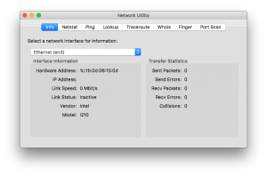

llamafilm Posted January 5, 2017 Share Posted January 5, 2017 I'd like to help with this, because I also have an i211 on my motherboard. Without any SSDT edits, I made a FakePCIID injector kext that changes device-id to 1533. I see the device in IOJones with the I210 driver attached. I see it in Network Utility as en3. (Oddly, en2 is missing. en0 is the other LAN and en1 is wifi.) I see it in Network Prefs with a red dot, and it says the cable is not plugged in. If I click on Advanced > Hardware, then System Preferences freezes and I have to force quit it. My other i218 NIC still works fine, but when I unplug it, it still shows green with an active IP address in Network Prefs. When I plug the cable back in, it works right away. No need to reboot nor disable the FakePCIID kext. This seems to be an improvement with Sierra. When I tried the same thing a few months ago on Yosemite, I got the same results as genzai, where the i218 did not work at all. I'm not very familiar with Sierra's new logging. Which log file would you like to see? FakePCIID_Intel_I211.kext.zip Sierra-Hack with fakepciid.zip Link to comment https://www.insanelymac.com/forum/topic/318434-hacking-i211/#findComment-2344746 Share on other sites More sharing options...
