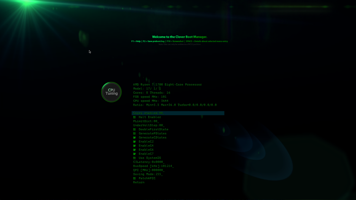

gills83 Posted June 30, 2017 Share Posted June 30, 2017 Try efi_rc3 )) EFI_rc3.zip Hello Bronya, 0:100 0:000 Running on: 'System Product Name' with board 'PRIME B350M-A' 0:100 0:000 === [ GetCPUProperties ] ================================== 0:100 0:000 CPU Vendor = 68747541 Model=800F11 0:100 0:000 The CPU supported SSE4.1 0:100 0:000 Looking to disable C1E if is already enabled by the BIOS: 0:100 0:000 BrandString = AMD Ryzen 7 1700 Eight-Core Processor 0:100 0:000 CurrentSpeed: 3650 0:100 0:000 maxratio 72 0:100 0:000 cpudid_zen 8 0:100 0:000 FSBFrequency = 50 MHz, DMI FSBFrequency = 100 MHz, Corrected FSBFrequency = 100 MHz 0:100 0:000 MaxDiv/MinDiv: 36.0/9 0:100 0:000 Turbo: 0/0/0/0 0:100 0:000 Features: 0x178BFBFF 0:100 0:000 Threads: 16 0:100 0:000 Cores: 8 0:100 0:000 FSB: 25 MHz 0:100 0:000 CPU: 3649 MHz 0:100 0:000 TSC: 3650 MHz 0:100 0:000 PIS: 100 MHz 1 Link to comment https://www.insanelymac.com/forum/topic/324831-release-open-source-clover-fork-with-ryzen-support/page/3/#findComment-2454258 Share on other sites More sharing options...
samaelestevez Posted June 30, 2017 Share Posted June 30, 2017 Hello Bronya, 0:100 0:000 Running on: 'System Product Name' with board 'PRIME B350M-A' 0:100 0:000 === [ GetCPUProperties ] ================================== 0:100 0:000 CPU Vendor = 68747541 Model=800F11 0:100 0:000 The CPU supported SSE4.1 0:100 0:000 Looking to disable C1E if is already enabled by the BIOS: 0:100 0:000 BrandString = AMD Ryzen 7 1700 Eight-Core Processor 0:100 0:000 CurrentSpeed: 3650 0:100 0:000 maxratio 72 0:100 0:000 cpudid_zen 8 0:100 0:000 FSBFrequency = 50 MHz, DMI FSBFrequency = 100 MHz, Corrected FSBFrequency = 100 MHz 0:100 0:000 MaxDiv/MinDiv: 36.0/9 0:100 0:000 Turbo: 0/0/0/0 0:100 0:000 Features: 0x178BFBFF 0:100 0:000 Threads: 16 0:100 0:000 Cores: 8 0:100 0:000 FSB: 25 MHz 0:100 0:000 CPU: 3649 MHz 0:100 0:000 TSC: 3650 MHz 0:100 0:000 PIS: 100 MHz How do you get that output? I'm trying the new clover but I dont known how? Link to comment https://www.insanelymac.com/forum/topic/324831-release-open-source-clover-fork-with-ryzen-support/page/3/#findComment-2454272 Share on other sites More sharing options...

Bronya Posted June 30, 2017 Share Posted June 30, 2017 Hello Bronya, 0:100 0:000 MaxDiv/MinDiv: 36.0/9 This MaxRatio = 36.0 , should 36.5 Link to comment https://www.insanelymac.com/forum/topic/324831-release-open-source-clover-fork-with-ryzen-support/page/3/#findComment-2454338 Share on other sites More sharing options...
Bronya Posted June 30, 2017 Share Posted June 30, 2017 Try EFI_rc4 ! Should maxratio = 36.5 )) I plan to add in the kernel and the bootloader Chameleon for Ryzen ! EFI_rc4.zip 2 Link to comment https://www.insanelymac.com/forum/topic/324831-release-open-source-clover-fork-with-ryzen-support/page/3/#findComment-2454369 Share on other sites More sharing options...

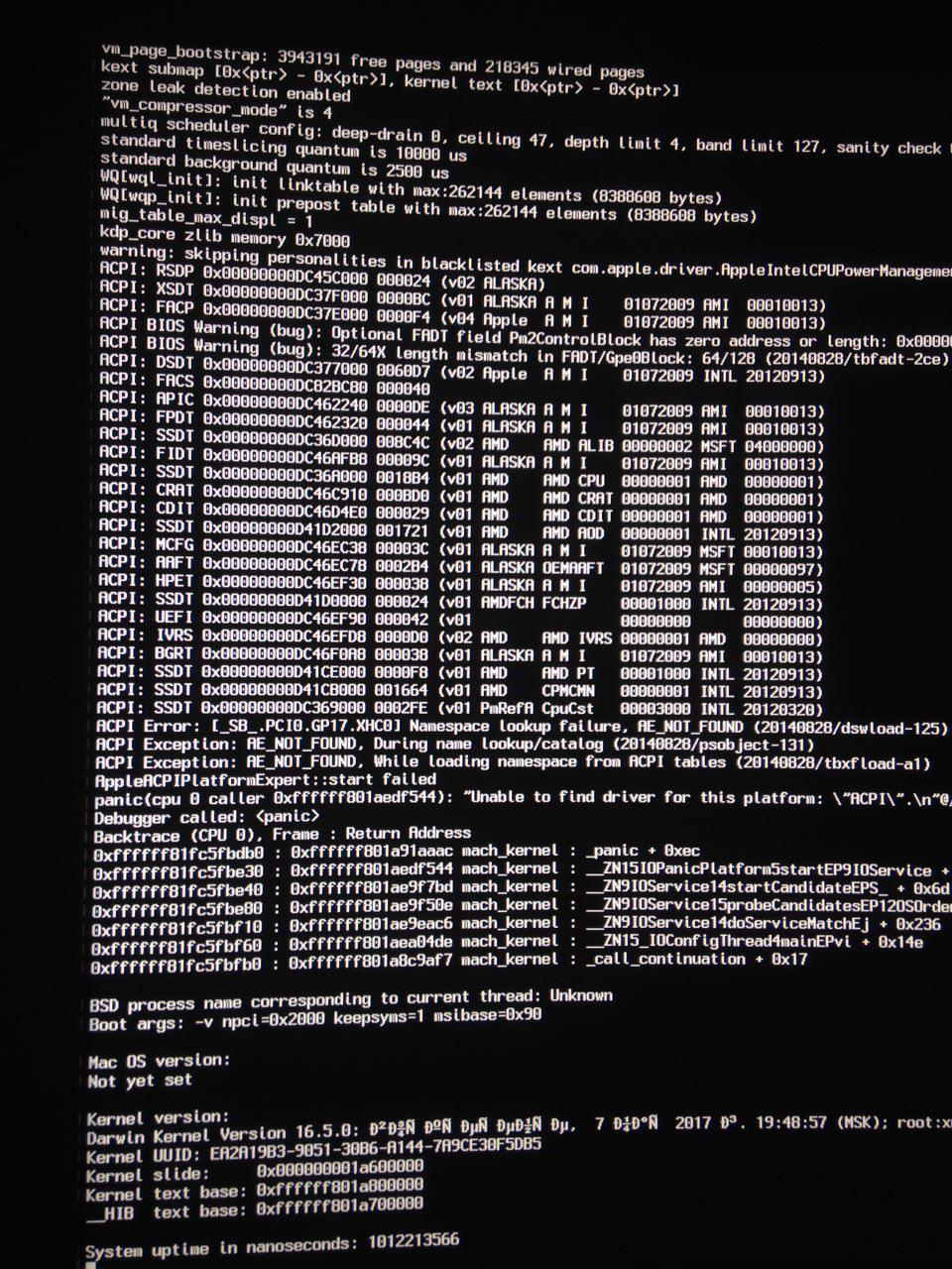

Ciro82 Posted June 30, 2017 Share Posted June 30, 2017 Try EFI_rc4 ! Should maxratio = 36.5 )) I plan to add in the kernel and the bootloader Chameleon for Ryzen ! I'm still having issue with the USB controller, i can't get passed that error.... If someone knows how to fix that issue it would be great. Link to comment https://www.insanelymac.com/forum/topic/324831-release-open-source-clover-fork-with-ryzen-support/page/3/#findComment-2454500 Share on other sites More sharing options...
Bronya Posted June 30, 2017 Share Posted June 30, 2017 I'm still having issue with the USB controller, i can't get passed that error.... If someone knows how to fix that issue it would be great. in menu clover : Disable or Enable USB Ownership , USB Injection . Or in ACPI Patching-> DSDT Fix Mask -> enable Fix USB Link to comment https://www.insanelymac.com/forum/topic/324831-release-open-source-clover-fork-with-ryzen-support/page/3/#findComment-2454506 Share on other sites More sharing options...
Ciro82 Posted June 30, 2017 Share Posted June 30, 2017 in menu clover : Disable or Enable USB Ownership , USB Injection . I've already tried all that stuff... 1 Link to comment https://www.insanelymac.com/forum/topic/324831-release-open-source-clover-fork-with-ryzen-support/page/3/#findComment-2454509 Share on other sites More sharing options...
Bronya Posted June 30, 2017 Share Posted June 30, 2017 I've already tried all that stuff... in ACPI Patching-> DSDT Fix Mask -> enable Fix USB ??? Link to comment https://www.insanelymac.com/forum/topic/324831-release-open-source-clover-fork-with-ryzen-support/page/3/#findComment-2454516 Share on other sites More sharing options...
Ciro82 Posted June 30, 2017 Share Posted June 30, 2017 in ACPI Patching-> DSDT Fix Mask -> enable Fix USB ??? It gives me an ACPI error Link to comment https://www.insanelymac.com/forum/topic/324831-release-open-source-clover-fork-with-ryzen-support/page/3/#findComment-2454521 Share on other sites More sharing options...
Bronya Posted June 30, 2017 Share Posted June 30, 2017 It gives me an ACPI error Yes , you need use other config.plist ! Link to comment https://www.insanelymac.com/forum/topic/324831-release-open-source-clover-fork-with-ryzen-support/page/3/#findComment-2454522 Share on other sites More sharing options...
Ciro82 Posted June 30, 2017 Share Posted June 30, 2017 Yes , you need use other config.plist ! What do you mean for "other config.plist" ? Link to comment https://www.insanelymac.com/forum/topic/324831-release-open-source-clover-fork-with-ryzen-support/page/3/#findComment-2454524 Share on other sites More sharing options...
Bronya Posted June 30, 2017 Share Posted June 30, 2017 What do you mean for "other config.plist" ? You need use other modify config.plist . I also get error ACPI, ok , i modified config.plist and working ! Link to comment https://www.insanelymac.com/forum/topic/324831-release-open-source-clover-fork-with-ryzen-support/page/3/#findComment-2454527 Share on other sites More sharing options...
Ciro82 Posted June 30, 2017 Share Posted June 30, 2017 You need use other modify config.plist . I also get error ACPI, ok , i modified config.plist and working ! Why you just don't give me the config.plist, so we can see if it works... Link to comment https://www.insanelymac.com/forum/topic/324831-release-open-source-clover-fork-with-ryzen-support/page/3/#findComment-2454528 Share on other sites More sharing options...
Bronya Posted June 30, 2017 Share Posted June 30, 2017 Why you just don't give me the config.plist, so we can see if it works... in config.plist edit dsdt . ok . config.plist.zip Link to comment https://www.insanelymac.com/forum/topic/324831-release-open-source-clover-fork-with-ryzen-support/page/3/#findComment-2454534 Share on other sites More sharing options...
Ciro82 Posted June 30, 2017 Share Posted June 30, 2017 No way... Link to comment https://www.insanelymac.com/forum/topic/324831-release-open-source-clover-fork-with-ryzen-support/page/3/#findComment-2454548 Share on other sites More sharing options...
gills83 Posted June 30, 2017 Share Posted June 30, 2017 Try EFI_rc4 ! Should maxratio = 36.5 )) I plan to add in the kernel and the bootloader Chameleon for Ryzen ! 0:100 0:000 Running on: 'System Product Name' with board 'PRIME B350M-A' 0:100 0:000 === [ GetCPUProperties ] ================================== 0:100 0:000 CPU Vendor = 68747541 Model=800F11 0:100 0:000 The CPU supported SSE4.1 0:100 0:000 Looking to disable C1E if is already enabled by the BIOS: 0:100 0:000 BrandString = AMD Ryzen 7 1700 Eight-Core Processor 0:100 0:000 CurrentSpeed: 3650 0:100 0:000 maxratio 72 0:100 0:000 cpudid_zen 8 0:100 0:000 FSBFrequency = 50 MHz, DMI FSBFrequency = 100 MHz, Corrected FSBFrequency = 100 MHz 0:100 0:000 MaxDiv/MinDiv: 36.0/3 0:100 0:000 Turbo: 0/0/0/0 0:100 0:000 Features: 0x178BFBFF 0:100 0:000 Threads: 16 0:100 0:000 Cores: 8 0:100 0:000 FSB: 25 MHz 0:100 0:000 CPU: 3649 MHz 0:100 0:000 TSC: 3650 MHz 0:100 0:000 PIS: 100 MHz sound is perfect Link to comment https://www.insanelymac.com/forum/topic/324831-release-open-source-clover-fork-with-ryzen-support/page/3/#findComment-2454554 Share on other sites More sharing options...
Ciro82 Posted June 30, 2017 Share Posted June 30, 2017 in config.plist edit dsdt . ok . Look at my picture ^^^ Link to comment https://www.insanelymac.com/forum/topic/324831-release-open-source-clover-fork-with-ryzen-support/page/3/#findComment-2454557 Share on other sites More sharing options...
Bronya Posted June 30, 2017 Share Posted June 30, 2017 Look at my picture ^^^ Think that you use wrong Extensions in /S/L/E or wrong kexts ... 0:100 0:000 MaxDiv/MinDiv: 36.0/3 0:100 0:000 Turbo: 0/0/0/0 0:100 0:000 Features: 0x178BFBFF 0:100 0:000 Threads: 16 0:100 0:000 Cores: 8 sound is perfect Thank ! But this wrong MinRatio . And wrong MaxRatio. Should 36.5 ! What really Min Ratio in bios ? You tried cloverx64.efi from #46 ? Link to comment https://www.insanelymac.com/forum/topic/324831-release-open-source-clover-fork-with-ryzen-support/page/3/#findComment-2454561 Share on other sites More sharing options...
Ciro82 Posted June 30, 2017 Share Posted June 30, 2017 Think that you use wrong Extensions in /S/L/E or wrong kexts ... FakeSMC is the only kext that i'm using now... That ACPI Error and Kernel error has nothing to do with Kexts. Link to comment https://www.insanelymac.com/forum/topic/324831-release-open-source-clover-fork-with-ryzen-support/page/3/#findComment-2454564 Share on other sites More sharing options...
Bronya Posted June 30, 2017 Share Posted June 30, 2017 FakeSMC is the only kext that i'm using now... That ACPI Error and Kernel error has nothing to do with Kexts. You use dsdt.aml ??? Link to comment https://www.insanelymac.com/forum/topic/324831-release-open-source-clover-fork-with-ryzen-support/page/3/#findComment-2454567 Share on other sites More sharing options...
Ciro82 Posted June 30, 2017 Share Posted June 30, 2017 You use dsdt.aml ??? Why should i use a DSDT? Sorry man, i'm having major issues understanding what you're saying... Write French,i may get it the right way. Link to comment https://www.insanelymac.com/forum/topic/324831-release-open-source-clover-fork-with-ryzen-support/page/3/#findComment-2454570 Share on other sites More sharing options...
