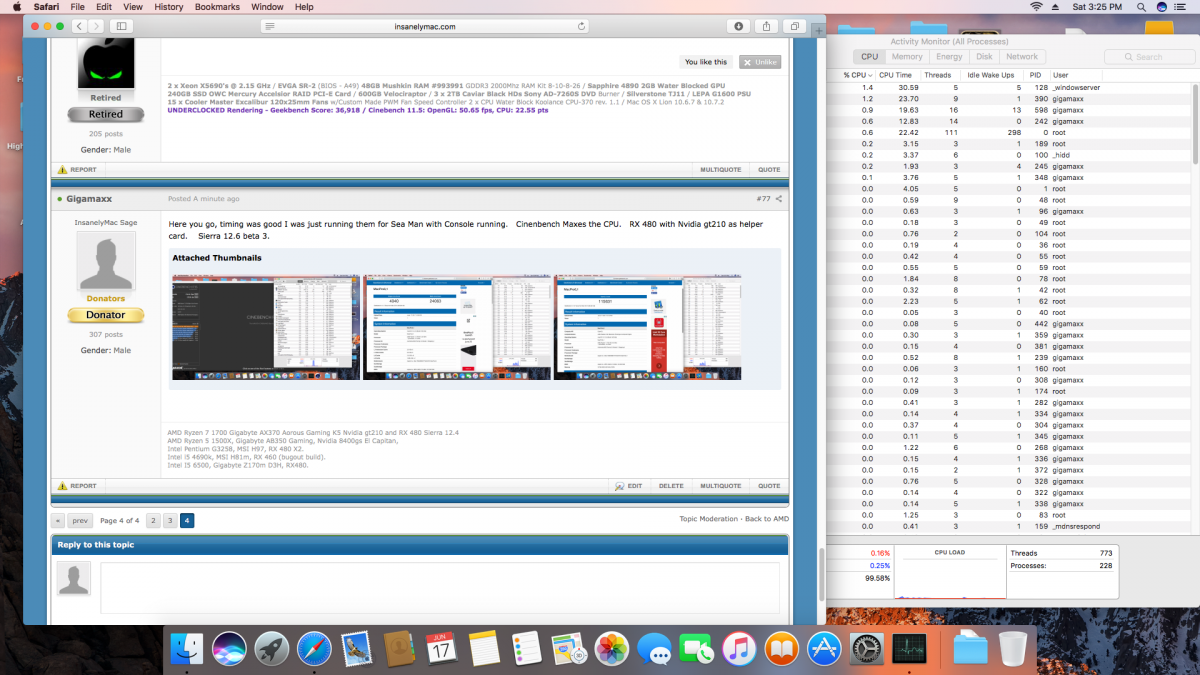

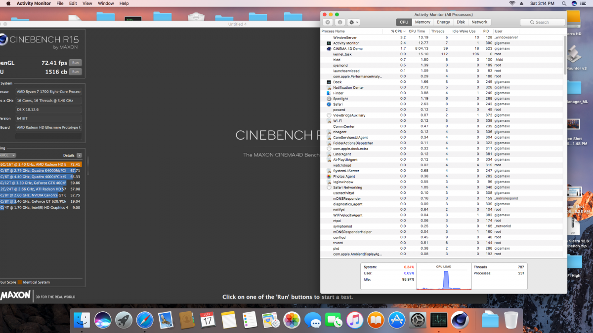

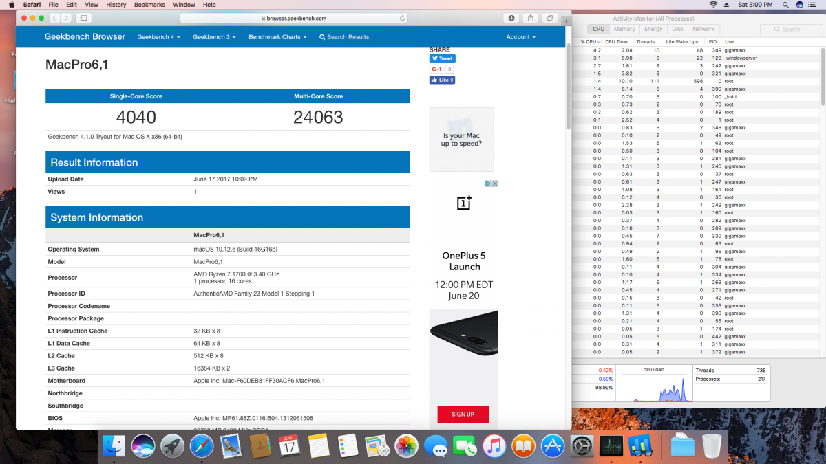

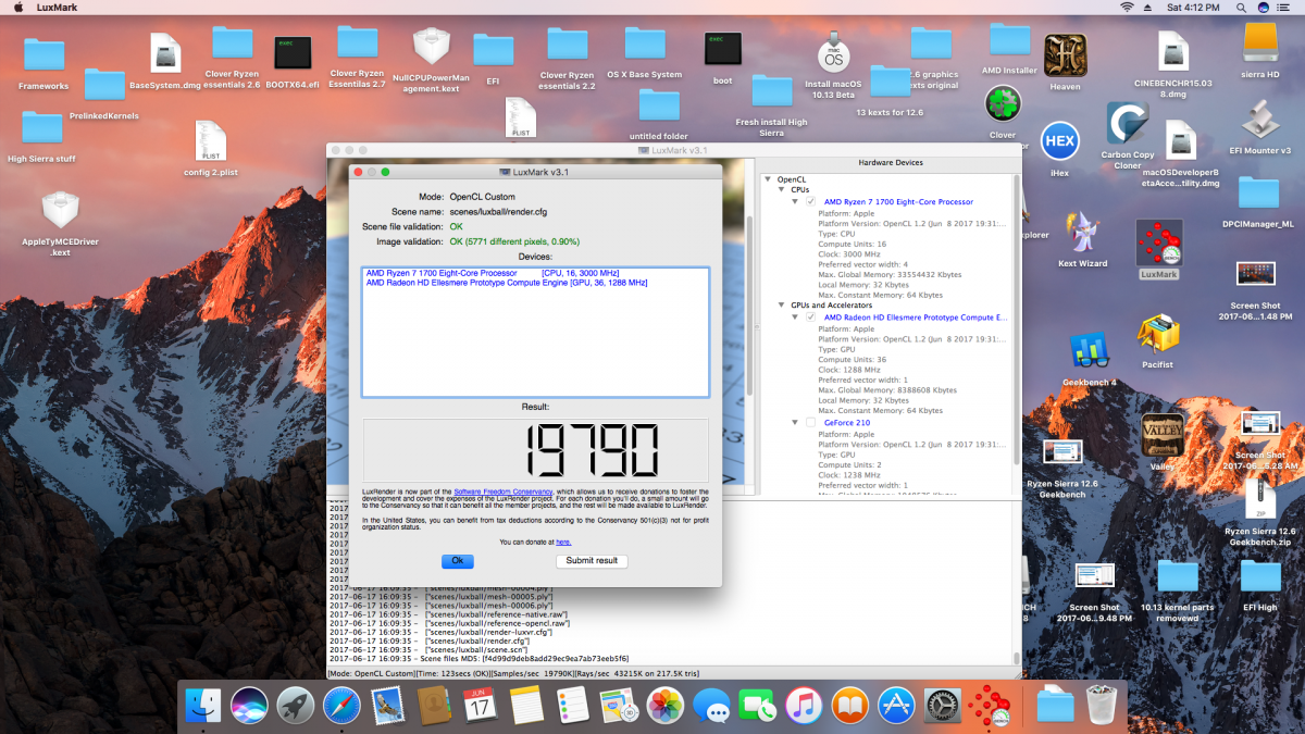

Here you go, timing was good I was just running them for Sea Man with Console running.   Cinenbench Maxes the CPU.   RX 480 with Nvidia gt210 as helper card.    Sierra 12.6 beta 3.

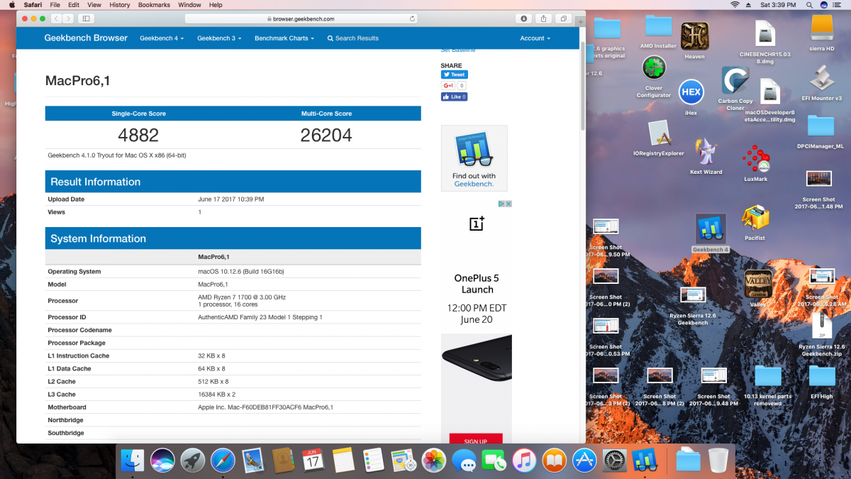

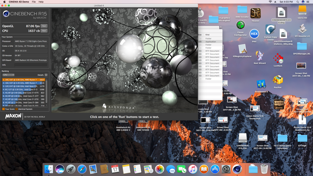

Dropped my CPU to 3.0GHZ and got this.   Must be a blue moon out!

Thanks ! I checked again and after repair permissions and clean system / user cache with onyx.app i have a lower kernel_task like you , before it was on 70% and more.

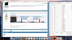

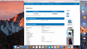

Your clock is wrong, you can not make 26000 point to 3 Ghz ;)
All these tests mean nothing, if your kernel is out of sync, you can do 3000 cb on cinebench and 50 000 points on geekbench cpu  ;)
You must fix the speed of your kernel

https://browser.primatelabs.com/v4/cpu/3149192

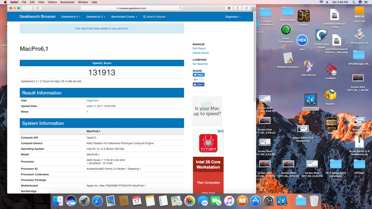

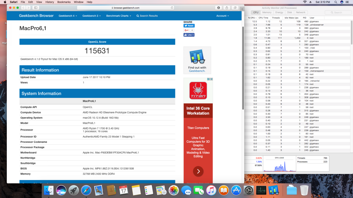

If I set BIOS to Auto the CPU runs at 3.0GHz, benchmarks= normal.       I set it manually to 3.0GHz vs. Auto setting in BIOS.
My RX 480 is punching it out are you saying my CPU is causing increased GPU performance?    RX 480 with gt210 before or on auto setting is 110,000 vs. 135,00-141,000 with IGPU Intel system.    So my RX is getting closer to peak performance,

Opencl is not significant, ryzen 7 1700 stock is at 1427 cb stock and no more, maybe 1450, your kernel is not fixed, so do not enter any flag busratio etc ... with kernel auto Darwin 16.5, Compare your results with Win10 64, normally you will have substantially the same results with lower opengl. :)
look 1800x @ 4 Ghz ;)
https://browser.primatelabs.com/v4/cpu/3145643
is true :)
