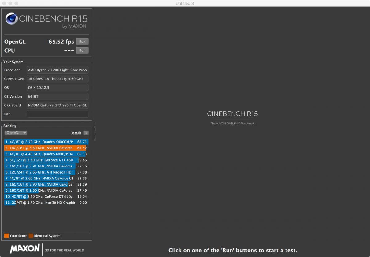

samaelestevez Posted June 20, 2017 Share Posted June 20, 2017 @Gigamaxx i will try ssd. i noticed that not a lot of people are using 10xx cards with hackingtosh specially the card i have. i have access to a gtx 970 i'll try to see if it's my card and try to narrow the issue. I have a 980ti and I'm also getting low scores on Cinebench OpenGL (~55 FPS). With this card ,on windows I get ~115 so something's off. You should be getting waaaay more than me with your 1080ti card. Any discoveries you may want me to try on my end? Link to comment https://www.insanelymac.com/forum/topic/324392-ryzen-clover-installation-guide-macos-sierra/page/6/#findComment-2448432 Share on other sites More sharing options...

Gigamaxx Posted June 20, 2017 Author Share Posted June 20, 2017 I have a 980ti and I'm also getting low scores on Cinebench OpenGL (~25 FPS). With this card I should be getting more FPS. You should be getting waaaay more than me with your pascal card. Any discoveries you may want me to try on my end? I would search this site and google the Web Drivers and installation methods. I have read ever since the drivers came out about great success and great disappointment. I t can be done on Intel systems it should be working for risen with Clover as well. The only thing I can think of is a possible bug in either Clover, the Kernel, or AM4 Bios that is not allowing the Web Drivers to function properly. Maybe try enable wake on Lan and Network stack enable in bios? I just thought of another possibility, do you guys have 16 pice lanes showing in about this Mac? Because I use a helper card gt210 for my RX 480 I only get 8 pie lanes for the card. It lowers my performance by 15-20% but not 50%. The arrangement of you PCIe slots on AM4 boards can make a difference, I had an issue with wifi until I moved it to another PCIe 2.0 slot. Try the card in another slot, its quick way to see if anything changes. Sorry, this is all I got for now, keep us posted there has to be a solution. Link to comment https://www.insanelymac.com/forum/topic/324392-ryzen-clover-installation-guide-macos-sierra/page/6/#findComment-2448446 Share on other sites More sharing options...
samaelestevez Posted June 20, 2017 Share Posted June 20, 2017 @bbmatias3 I read earlier here the recommendation to reinstall everything and I went ahead and reinstalled from scratch and also added kexts and drivers one by one just so I can get sierra working with minimal modifications from vanilla macOS and yet the opengl stuff still is low. Yes I just installed the drivers from the web and the card worked right away. In regards to the low scores being linked to ryzen, I believe so, I had this card with an Intel z170 motherboard and a 6700k and everything was running fine. My video card slowness is so bad that it shows while using the dock and closing and opening windows. It is not 100% smooth. Link to comment https://www.insanelymac.com/forum/topic/324392-ryzen-clover-installation-guide-macos-sierra/page/6/#findComment-2448449 Share on other sites More sharing options...

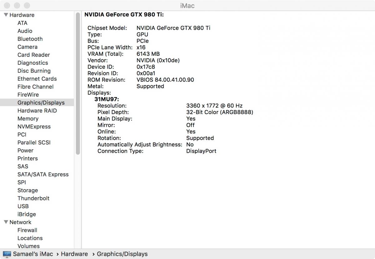

samaelestevez Posted June 20, 2017 Share Posted June 20, 2017 @Gigamaxx I can't thank you enough for all your hard work putting this foolproof guide together for us blue-collared folks. It takes a special kind of person to take some of their time to help others. In regards to this little issue, see attached "System Report" snapshot, it shows x16. I'll keep trying the other BIOS stuff you recommended. Also find attached the ioReg file. I hope you and your wisdom can help us solve this. Thanks in advance. Samael’s iMac.zip Link to comment https://www.insanelymac.com/forum/topic/324392-ryzen-clover-installation-guide-macos-sierra/page/6/#findComment-2448467 Share on other sites More sharing options...

samaelestevez Posted June 21, 2017 Share Posted June 21, 2017 @bbmatias3 @Gigamaxx I think I found the cause of the low OpenGL scores (At least I think I know where it's coming from) (I had to correct my previous post, i made a mistake of reporting "~25" when i actually meant to say ~55 FPS) Anyways, that's what I was getting, 55 FPS on average, i tinkered with the BCLK of the motherboard and got this: BCLK = 115mhz = ~60-62 FPS BCLK = 120mhz = ~65-66 FPS (see attached) @bbmatias3, how many FPS are you getting on CB15? I can't keep going up because it won't boot properly. Link to comment https://www.insanelymac.com/forum/topic/324392-ryzen-clover-installation-guide-macos-sierra/page/6/#findComment-2448504 Share on other sites More sharing options...
