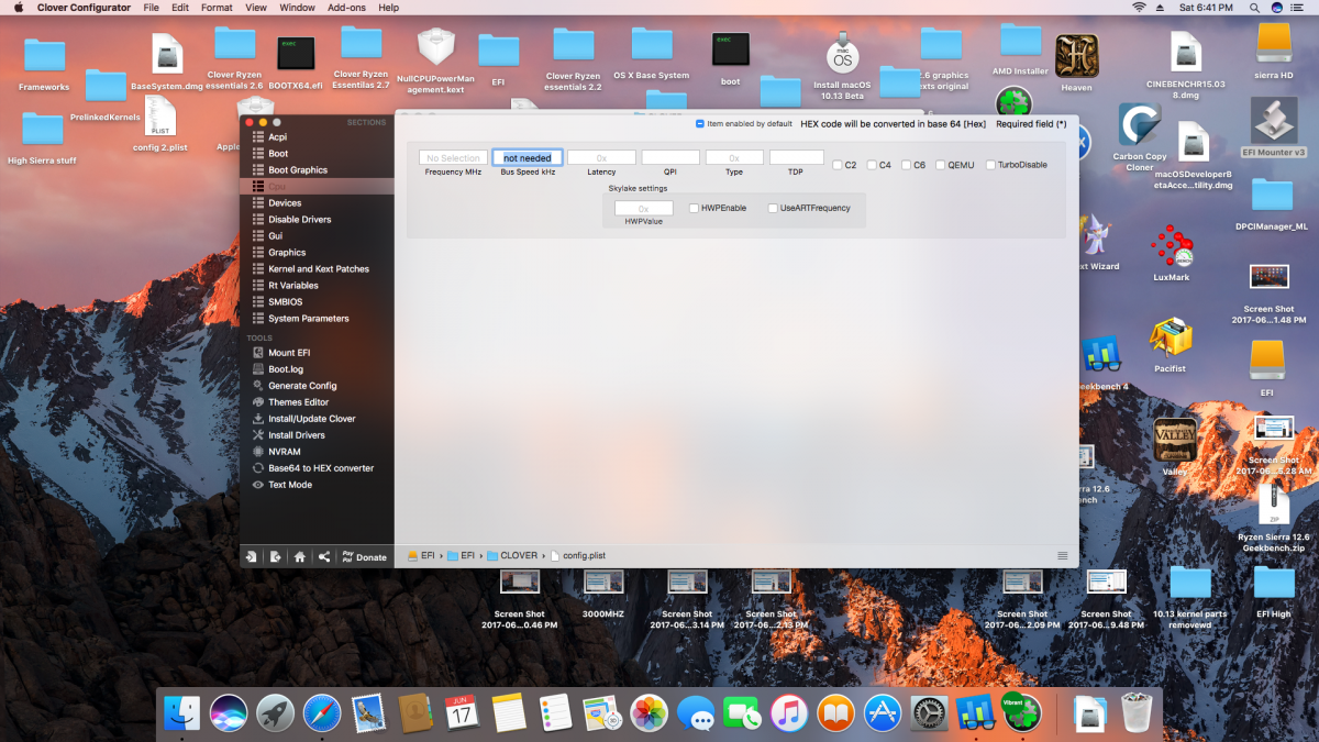

For setting your clock speed.    There are 3 things to look at or adjust.     First is your Bios you need to make certain that whatever you set in clover is what you really have set in bios.    Bios=3.0GHz then Clover=3.0Ghz is correct setting.    If Bios and CPU is set for example 3.4GHz then set clover at 3.4Ghz.
There are 2 ways to set CPU frequency in Clover.    One is for a permanent setting #2 and the other is for an adjustable settings made easy #1.    You should use one method or the other but not both.  If you have settings for 2 different frequencies it could cause problems.

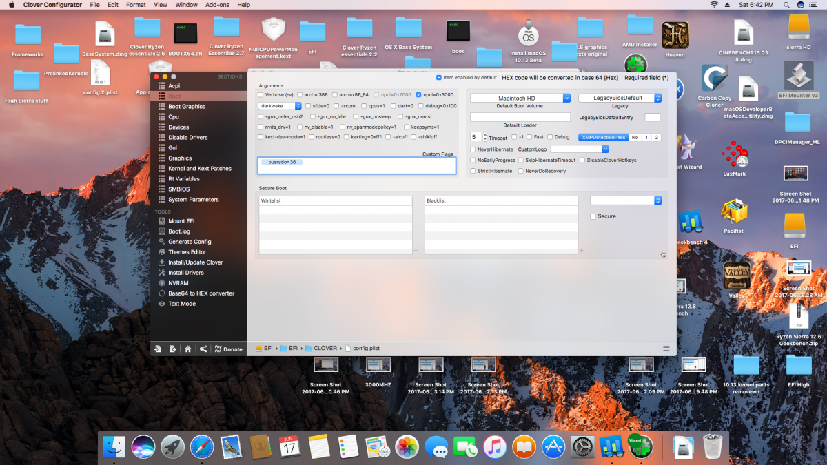

1).   If you want to overclock or adjust CPU frequency often then using busratio=xx is a good method.   It allows you to Start computer hold delete key go to Bios set CPU frequency hit exit.    At clover screen use option and set busratio=xx value equal to bios setting, hit enter and you have proper GHz settings.    These settings are set in Boot section of Clover Configurator.   Auto kernel does not require fsi=100MHz or setting "bus speed MHz" in clover.   You can but its not necessary with Auto 16.5 kernel, with other kernels in chameleon maybe, but not for clover.   This method gives you easy access to your CPU frequency settings.   If you use this do not use CPU settings below for permanent settings.

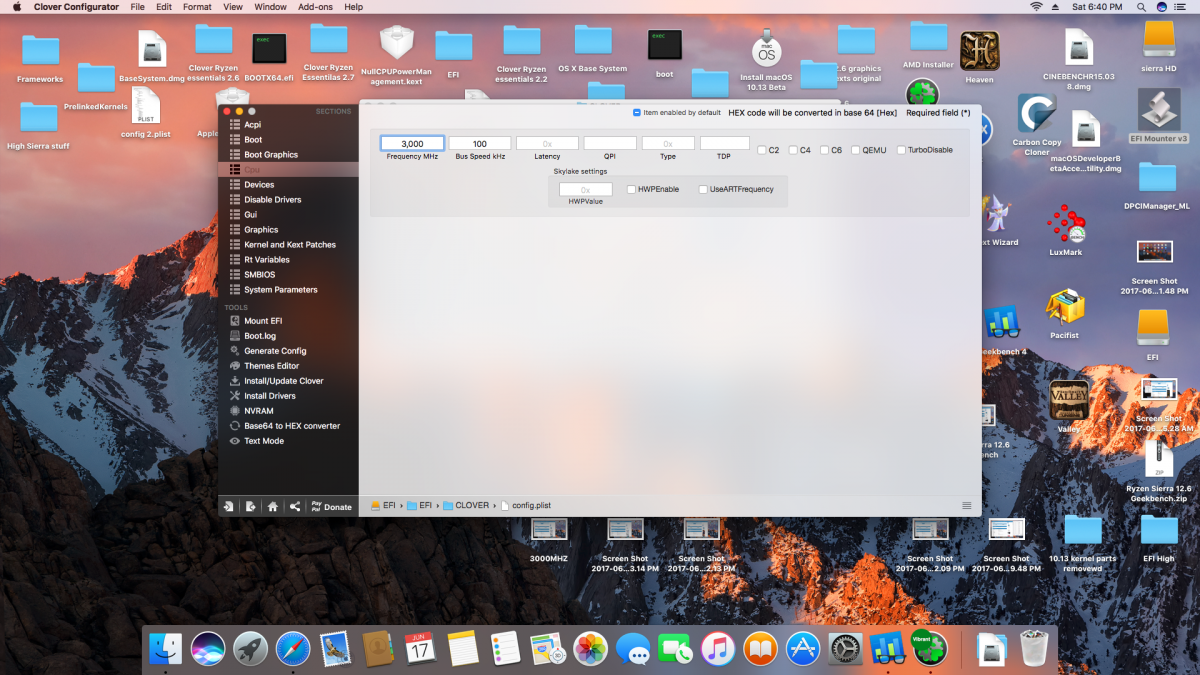

2).   If you want to set your CPU settings permanently then use the clover "bus speed MHz" and CPU frequency selections in Clover CPU section.    First set CPU frequency in Bios settings, then set these values.    After setting these values remove the busratio=xx in boot arg.    You want to use one or the other methods but not both.   Setting these values in config.plist using Clover Configurator means that if you want to change the CPU frequency you must first mount EFi and edit your config.plist then restart and set bios to match the edit.    It requires the system to be booted to set values so overclocking and changing CPU frequencies is not done on the fly like the busratio=xx method.
So, if you want to set your CPU frequency at a value permanently then use CPU settings in Clover, if you want to adjust frequencies or test overclocking the busratio=xx method will make more sense.

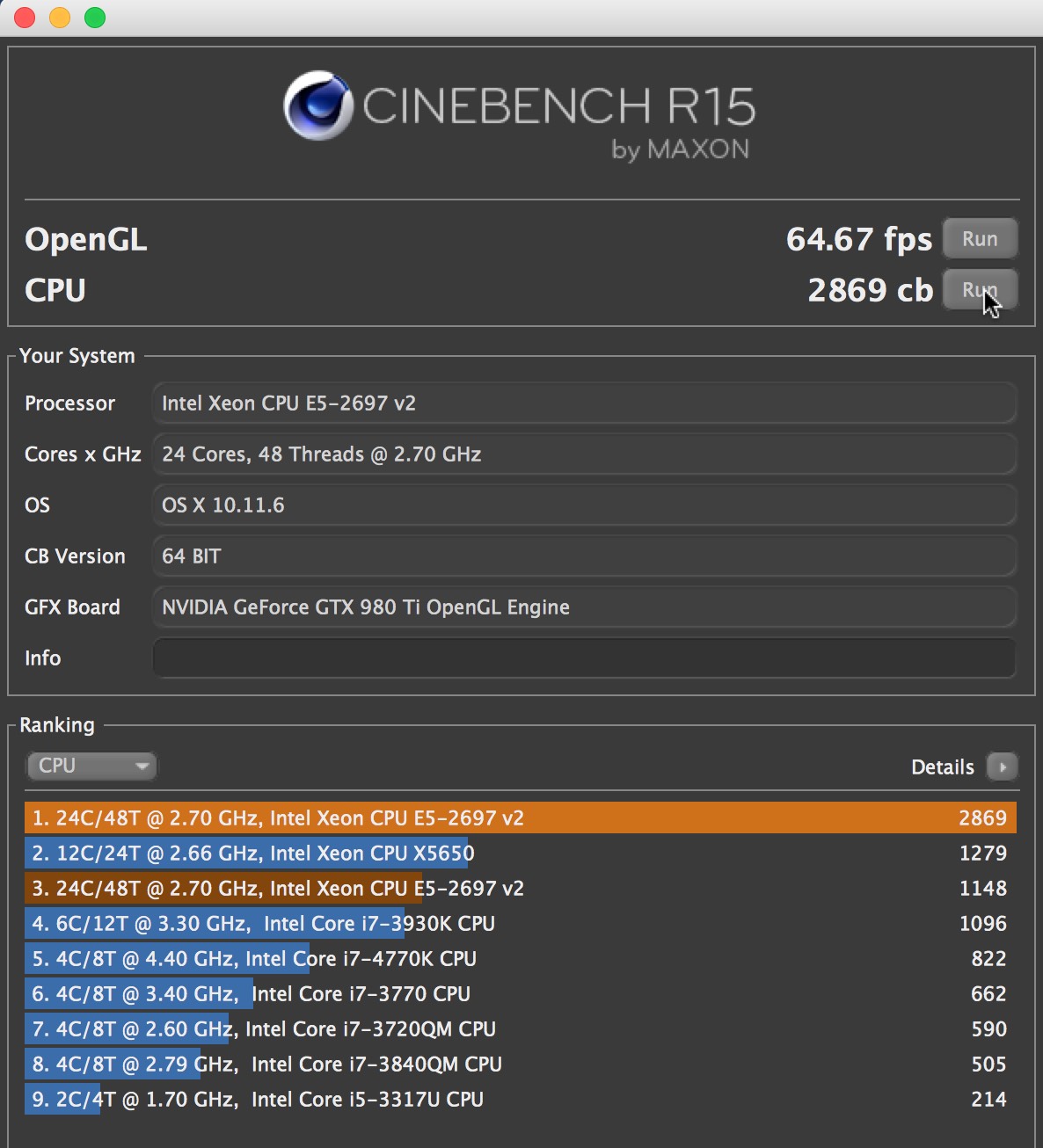

That definitely is low, when booted to windows I got 88FPS with a GTX1070

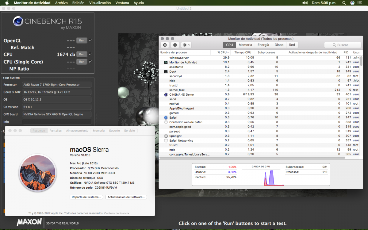

Hi, I'm amazed by how well this kernel works. I only have a few small issues (they might be related):
1. Is there any way to make this kernel recognize the Ryzen 7 8 cores 16 threads? Mine shows 16 cores 16 threads.
