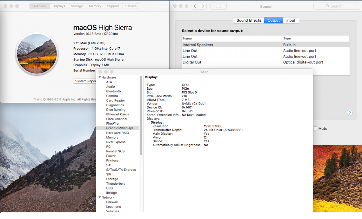

SavageAUS Posted June 30, 2017 Share Posted June 30, 2017 All good here minus Nvidia drivers on my Skylake system. And on Haswell laptop. Just the annoying battery indicator issue. 1 Link to comment Share on other sites More sharing options...

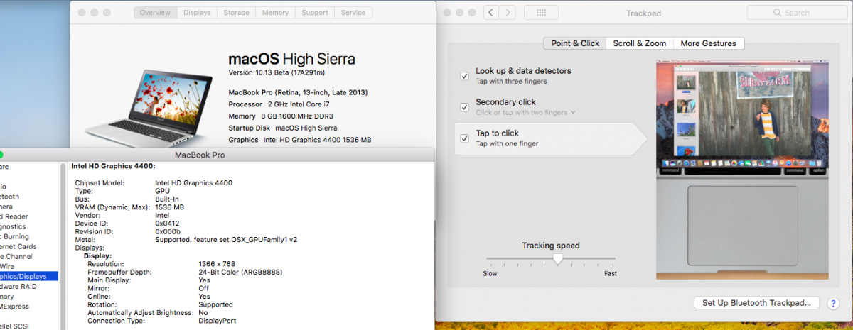

xtddd Posted June 30, 2017 Share Posted June 30, 2017 All good here minus Nvidia drivers on my Skylake system. Screen Shot 2017-06-30 at 10.27.03 am.png And on Haswell laptop. Just the annoying battery indicator issue. Screen Shot 2017-06-30 at 10.33.23 am.png should update biosdata before update public beta? Link to comment Share on other sites More sharing options...
Badruzeus Posted June 30, 2017 Share Posted June 30, 2017 All good here minus Nvidia drivers on my Skylake system. Screen Shot 2017-06-30 at 10.27.03 am.png GTX960? I'm not sure why native GeForce* won't loaded on some GPUs under 10.13, many changes on SMBios since 10.12. But I read this on @Pike's blog: The OSBundleLibraries in AppleSMC.kext has changed. This one is new: <key>com.apple.iokit.IOPCIFamily</key> <string>1.8</string> IDK how 10.13 sees PCIe GPU on hackintosh (or only some of them), is it become Internal or external (eGPU). I noticed on Beta 1 my GF119 always crashes while logging out with "No GPU found" logs, but my friend somewhere has no problem with HDMI. Then it solved on Beta 2 with disabling AutoLogin. Still waiting for Web Driver (if not Appl* bugs) Link to comment Share on other sites More sharing options...

SavageAUS Posted June 30, 2017 Share Posted June 30, 2017 should update biosdata before update public beta?I'm unsure what you mean? But I am already using updated bios information. Sent from my SM-G930F using Tapatalk GTX960? I'm not sure why native GeForce* won't loaded on some GPUs under 10.13, many changes on SMBios since 10.12. But I read this on @Pike's blog: The OSBundleLibraries in AppleSMC.kext has changed. This one is new: <key>com.apple.iokit.IOPCIFamily</key> <string>1.8</string> IDK how 10.13 sees PCIe GPU on hackintosh (or only some of them), is it become Internal or external (eGPU). I noticed on Beta 1 my GF119 always crashes while logging out with "No GPU found" logs, but my friend somewhere has no problem with HDMI. Then it solved on Beta 2 with disabling AutoLogin. Still waiting for Web Driver (if not Appl* bugs) https://www.youtube.com/watch?v=NlN7XCwDKnw Yeah I have no idea. You would think by now Apple would support more cards out of the box to reduce the need for Nvidia drivers. Sent from my SM-G930F using Tapatalk Link to comment Share on other sites More sharing options...

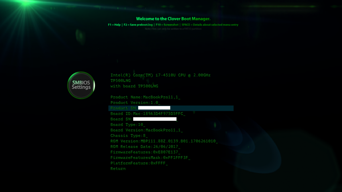

SavageAUS Posted June 30, 2017 Share Posted June 30, 2017 Only have to change bios version and date from EFI firmware in config.plist. Clover support FF and FFM native value above my test1 file. Before commit, need to surely check work or not. Until someone check, i never commit and also not report it to Slice 나의 LG-F800S 의 Tapatalk에서 보냄 Just to confirm this is MacBook Pro 11,1? MBP111.88Z.0139.B01.1706261010 And the date we set in smbios is 26/06/2017 And thats all we need to change? Along with your test1? Link to comment Share on other sites More sharing options...
Sherlocks Posted June 30, 2017 Share Posted June 30, 2017 Just to confirm this is MacBook Pro 11,1? MBP111.88Z.0139.B01.1706261010 And the date we set in smbios is 26/06/2017 And thats all we need to change? Along with your test1? Sorry my english -No need FF and FFM in config.plist(support native value according each model)-ofc you can use own value(keep) in config.plist or GUI(temp(once)) -Clover include latest BIOS ROM and bios date information. But normarlly users have own any data(BIOS ROM, bios date) So you have to change BIOS ROM and Date from cecekpawon's info according your model in config.plist. Then if you can, please test fresh install high sierra. 나의 LG-F800S 의 Tapatalk에서 보냄 Link to comment Share on other sites More sharing options...

SavageAUS Posted June 30, 2017 Share Posted June 30, 2017 Get DMI Dump from darwin dump here. Before you attached SMBIOS.txt, you have to remove your serial and MLB and ROM in txt. I will check your file 나의 LG-F800S 의 Tapatalk에서 보냄 DMI dump SMBIOS.txt Link to comment Share on other sites More sharing options...
xtddd Posted June 30, 2017 Share Posted June 30, 2017 Just to confirm this is MacBook Pro 11,1? MBP111.88Z.0139.B01.1706261010 And the date we set in smbios is 26/06/2017 And thats all we need to change? Along with your test1? right Link to comment Share on other sites More sharing options...

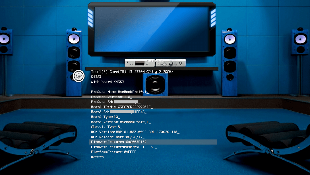

Badruzeus Posted June 30, 2017 Share Posted June 30, 2017 can you test fresh install high sierra? if you can, test and report please clover now support native value. but need to surely check work or not. ... Really need a cleaned install mach? Perhaps someone else on my case, $ sudo nvram -c && uuidgen with new (fake) SN w/o "Firmware Features" value, but use: BiosVersion=MBP101.88Z.00EF.B01.1706261418 BiosReleaseDate=06/26/17 And below is what I get. Thanks.. #Edit: DMI Tables output from DarwinDumper v3.0.3. SMBIOS_A43SJ_r4099_test.txt Link to comment Share on other sites More sharing options...

SavageAUS Posted June 30, 2017 Share Posted June 30, 2017 Nah, that was also happened with my USB Install method while on Beta 1 I think just booting the installer with those new Platform Data & Clover test version above, we'll know what appears there. Oops.. but I don't have new Installer yet.. (my Beta 1 Installer removed by mistake). Question: Bios Release Date pattern is American, isn't it? I mean: 06/26/17 (MM/DD/YY) and not 26/06/17 or am I wrong.. hmmb. Yes i believe i did it wrong, it should be, i think 06/26/2017 New USB created, with test1 files and updated smbios details. Attempting fresh install now. Link to comment Share on other sites More sharing options...
Badruzeus Posted June 30, 2017 Share Posted June 30, 2017 good status. thank you (MM/DD/YY) BIOS Information Vendor: Apple Inc. Version: IM171.88Z.0105.B05.1511031741 Release Date: 11/03/2015 ROM Size: 8192 kB as result, clover's platform data is right. Thank u for confirming... Yes i believe i did it wrong, it should be, i think 06/26/2017 New USB created, with test1 files and updated smbios details. Attempting fresh install now. Well done Link to comment Share on other sites More sharing options...
Sherlocks Posted June 30, 2017 Share Posted June 30, 2017 Yes i believe i did it wrong, it should be, i think 06/26/2017 New USB created, with test1 files and updated smbios details. Attempting fresh install now. good. i wonder fresh install result. Link to comment Share on other sites More sharing options...
SavageAUS Posted June 30, 2017 Share Posted June 30, 2017 good. i wonder fresh install result.OSInstall.mpkg error. Sent from my SM-G930F using Tapatalk Link to comment Share on other sites More sharing options...

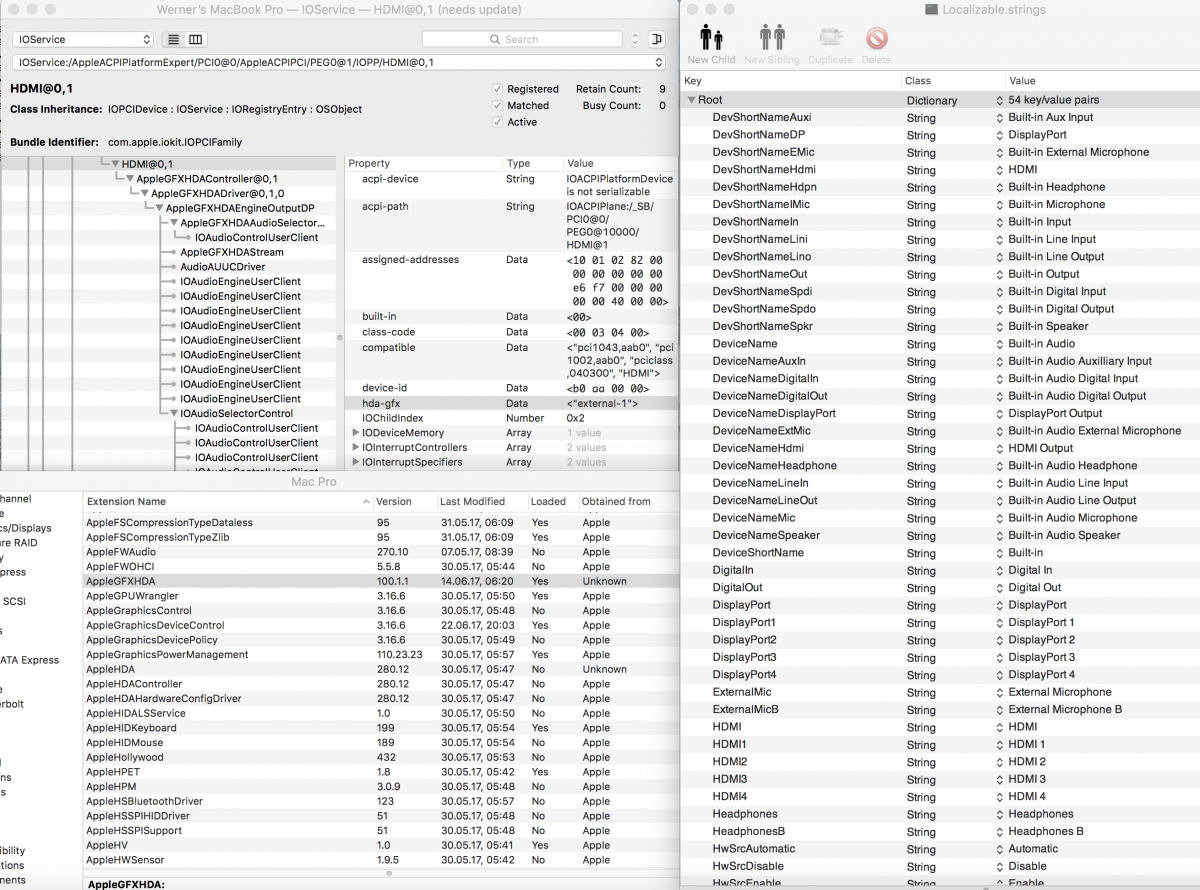

wern apfel Posted June 30, 2017 Share Posted June 30, 2017 (edited) It seems that the new AppleGFXHDAController.kext was built to work with external PCIe cards. The IOPCITunnelCompatible entry is already there, it works without the HDA kexts and probably also for external PCIe sound cards. Bad news for the nVidia users there are only Intel and AMD entries. I have not exactly searched, the nVidia device-IDs are there. Edited July 2, 2017 by wern apfel 1 Link to comment Share on other sites More sharing options...
