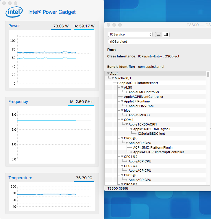

mikey1953 Posted December 24, 2017 Share Posted December 24, 2017 ok. Here's the IOReg output. That clover folder booted, but the power usage and temps are very high. Cpu frequency is flat at 2.6ghz. And I don't see a SSDT.aml in the CLOVER/ACPI/patched folder. Archive maldon.zip Link to comment https://www.insanelymac.com/forum/topic/323052-guide-el-capitan-sierra-high-sierra-mojave-catalina-on-intel-5-6-7-8-9-chipset-series-nehalem-sandybridge-ivybridge-haswell-broadwell/page/27/#findComment-2555827 Share on other sites More sharing options...
MaLd0n Posted December 24, 2017 Author Share Posted December 24, 2017 generate new SSDT and put in folder u try a patch? Link to comment https://www.insanelymac.com/forum/topic/323052-guide-el-capitan-sierra-high-sierra-mojave-catalina-on-intel-5-6-7-8-9-chipset-series-nehalem-sandybridge-ivybridge-haswell-broadwell/page/27/#findComment-2555837 Share on other sites More sharing options...
mikey1953 Posted December 24, 2017 Share Posted December 24, 2017 generate new SSDT and put in folder u try a patch? Yes I tried the patch, if you scroll back to post #633, I said that I did yesterday and that it is still in the S/E folder. I already generated a ssdt. Temps and power usage still high. generate new SSDT and put in folder u try a patch? This screenshot is after using your latest clover folder, generating a new ssdt, and using a patched AICPUPM. 2 Link to comment https://www.insanelymac.com/forum/topic/323052-guide-el-capitan-sierra-high-sierra-mojave-catalina-on-intel-5-6-7-8-9-chipset-series-nehalem-sandybridge-ivybridge-haswell-broadwell/page/27/#findComment-2555843 Share on other sites More sharing options...
MaLd0n Posted December 24, 2017 Author Share Posted December 24, 2017 Yes I tried the patch, if you scroll back to post #633, I said that I did yesterday and that it is still in the S/E folder. I already generated a ssdt. Temps and power usage still high. This screenshot is after using your latest clover folder, generating a new ssdt, and using a patched AICPUPM. u can check Stinga topic? http://www.insanelymac.com/forum/topic/324270-sandy-bridge-e-ivy-bridge-e-power-management-1013-appstore-release/ 1 Link to comment https://www.insanelymac.com/forum/topic/323052-guide-el-capitan-sierra-high-sierra-mojave-catalina-on-intel-5-6-7-8-9-chipset-series-nehalem-sandybridge-ivybridge-haswell-broadwell/page/27/#findComment-2555854 Share on other sites More sharing options...

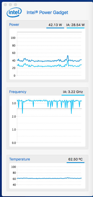

Elfmann Posted December 26, 2017 Share Posted December 26, 2017 Welcome! ok, Power Management it done. The problem was that I was using NullCPUPowerManagement.kext in clover EFI partition, so it prevented the AppleIntelCPUPowerManagement Client from loading. Then I removed the NullCpu kext from all directories, in my case only from EFI -> Clover -> kext -> others. But when I removed it and rebooted the system, it gave me a kernel panic caused by the AppleIntelCPUPowerManagement kext, so I had to enable the AppleIntelCPUPM option in Clover -> Kernel and Kext Patches. Rebooted the system, this time didn't have kernel panic and also the Power Management was working. Thanks you for everything MaLd0n, and wishing you happy Christmas holidays Link to comment https://www.insanelymac.com/forum/topic/323052-guide-el-capitan-sierra-high-sierra-mojave-catalina-on-intel-5-6-7-8-9-chipset-series-nehalem-sandybridge-ivybridge-haswell-broadwell/page/27/#findComment-2556649 Share on other sites More sharing options...

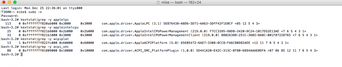

mikey1953 Posted December 26, 2017 Share Posted December 26, 2017 ioreg is nice, same yestarday, need only PM now, the others is ok, all load nothing in DSDT about PM now, removed yesterday, is a config.plist And a VERY Happy Holidays to you Sir! We have Native Power management working !!! This is a learning experience for both of us. Xeon E5-2670-E v1 is SandyBridge, and SandyBridge uses AICPUPM, not XCPM. The screenshots show that the required kexts AppleLPC, AICPUPM, AICPUPMClient, AppleACPIPlatform, and ACPI_SMC_PlatformPlugin are all loaded. The MSR on this Dell board is locked, so the AICPUPM patch for OS X 10.12.6 patches the MSRs, which I confirmed in Clover config debug mode. It also needed the addition of a second SSDT (SSDT-1) which I found on Rampage’s X79 thread. I have seen the CPU speed as low as 1.8GHz in IntelPowerGadget, I have a lot of programs on this computer so I think I might never see cpu speeds in the 1.2GHz range, which is ok with me. I also learned that this CPU always runs about 10 degrees hotter than an i7, so I turn up the fan speed in my BIOS for everyday use, then turn it back down when I am recording with microphones in Logic Pro X. Thanks so much for your help. I learned a lot. This was harder than getting Mountain Lion running on an AMD !! Happy Holidays! config.plist.zip 1 Link to comment https://www.insanelymac.com/forum/topic/323052-guide-el-capitan-sierra-high-sierra-mojave-catalina-on-intel-5-6-7-8-9-chipset-series-nehalem-sandybridge-ivybridge-haswell-broadwell/page/27/#findComment-2556670 Share on other sites More sharing options...

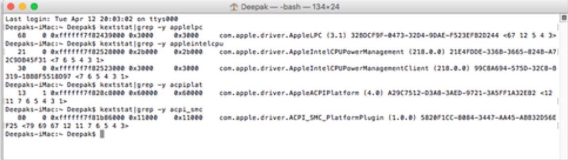

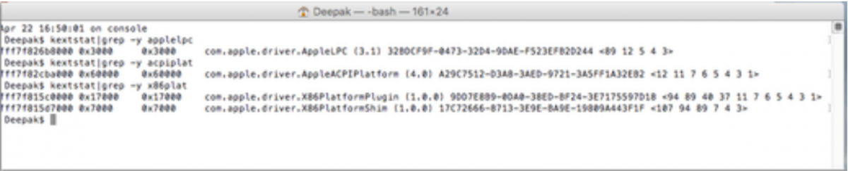

MaLd0n Posted December 26, 2017 Author Share Posted December 26, 2017 And a VERY Happy Holidays to you Sir! We have Native Power management working !!! This is a learning experience for both of us. Xeon E5-2670-E v1 is SandyBridge, and SandyBridge uses AICPUPM, not XCPM. The screenshots show that the required kexts AppleLPC, AICPUPM, AICPUPMClient, AppleACPIPlatform, and ACPI_SMC_PlatformPlugin are all loaded. The MSR on this Dell board is locked, so the AICPUPM patch for OS X 10.12.6 patches the MSRs, which I confirmed in Clover config debug mode. It also needed the addition of a second SSDT (SSDT-1) which I found on Rampage’s X79 thread. I have seen the CPU speed as low as 1.8GHz in IntelPowerGadget, I have a lot of programs on this computer so I think I might never see cpu speeds in the 1.2GHz range, which is ok with me. I also learned that this CPU always runs about 10 degrees hotter than an i7, so I turn up the fan speed in my BIOS for everyday use, then turn it back down when I am recording with microphones in Logic Pro X. Thanks so much for your help. I learned a lot. This was harder than getting Mountain Lion running on an AMD !! Happy Holidays! good, check ur ioreg, u see AGPM load too? LPC etc, i add all in ur DSDT, need solve only CPU PM 1 Link to comment https://www.insanelymac.com/forum/topic/323052-guide-el-capitan-sierra-high-sierra-mojave-catalina-on-intel-5-6-7-8-9-chipset-series-nehalem-sandybridge-ivybridge-haswell-broadwell/page/27/#findComment-2556683 Share on other sites More sharing options...

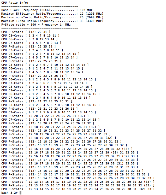

mikey1953 Posted December 26, 2017 Share Posted December 26, 2017 if generate c3, c6... live without it c3 and c6 are generated. And I can live with your suggestion to live without it!! I'm now on Piker's ssdtPRgen page and I will try some of his suggestions because I have time this holiday week. Thanks!!! 1 Link to comment https://www.insanelymac.com/forum/topic/323052-guide-el-capitan-sierra-high-sierra-mojave-catalina-on-intel-5-6-7-8-9-chipset-series-nehalem-sandybridge-ivybridge-haswell-broadwell/page/27/#findComment-2556745 Share on other sites More sharing options...
MaLd0n Posted December 26, 2017 Author Share Posted December 26, 2017 this version for AICPUPM work good for me in SandyBridge, u can try https://github.com/Piker-Alpha/ssdtPRGen.sh/releases/tag/v17.0 ssdtPRGen.command.zip 1 Link to comment https://www.insanelymac.com/forum/topic/323052-guide-el-capitan-sierra-high-sierra-mojave-catalina-on-intel-5-6-7-8-9-chipset-series-nehalem-sandybridge-ivybridge-haswell-broadwell/page/27/#findComment-2556751 Share on other sites More sharing options...
mikey1953 Posted December 26, 2017 Share Posted December 26, 2017 this version for AICPUPM work good for me in SandyBridge, u can try https://github.com/Piker-Alpha/ssdtPRGen.sh/releases/tag/v17.0 ssdtPRGen.command.zip Ok, I tried your command, no difference. i am using v21.5 of ssdtPRGen, there have been a lot of commits since the version 17.0 you are using. Here is my terminal code I enter : ~/ssdtPRGen.sh -p E5-2670 -c 0 -lfm 1200 -f 2600 -turbo 3300 -l 8 -t 115. May I ask what code you are entering? I am on a X79/C600, what cpu and board type are you using for your SandyBridge build? Link to comment https://www.insanelymac.com/forum/topic/323052-guide-el-capitan-sierra-high-sierra-mojave-catalina-on-intel-5-6-7-8-9-chipset-series-nehalem-sandybridge-ivybridge-haswell-broadwell/page/27/#findComment-2556820 Share on other sites More sharing options...
