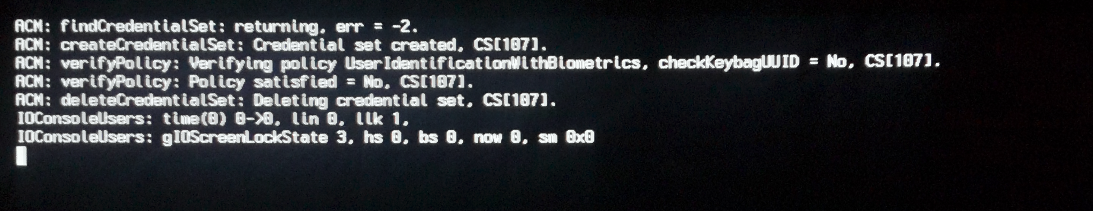

bocajoe Posted February 10, 2018 Share Posted February 10, 2018 Hi MaLd0n! Thanks for all the great help on here! I tried following your instructions several times and get this error below trying to install Sierra from my Clover USB. I used your attached EFI folder for my USB Installer. I have attached the Origin from my ACPI from Clover by pressing F4 to see if there is anything you can try to help me with I would sure appreciate it. My Hardware --------------------------------------------------------------- Gigabyte X299 UD4 Motherboard. Latest F5 BIOS i9-7900x CPU Nvidia 970 Video Card SSD origin.zip 1 Link to comment https://www.insanelymac.com/forum/topic/321872-guide-catalina-bigsur-monterey-on-mobos-serie-100-200-300-400-500-600-skylake-kabylake-coffeelake-cometlake-rocketlake-alderlake-dsdt/page/79/#findComment-2588488 Share on other sites More sharing options...
MaLd0n Posted February 10, 2018 Author Share Posted February 10, 2018 @MaLd0n I'm from China,Poor foreign language,Google translation now used。 The following is my Hackintosh platform: CPU:i7 8700k MB:Asrock Z370 Extreme4 RAM:G.skill DDR4 3200 8G*2 GPU:AMD 370X 4G I will not compile DSDT, I extracted DSDT clover guide, I hope you can help me compiler, thank you. I now have a problem sleeping, sleep will always restart and enter the system, usb I do not know is not right, I hope these problems can be solved in the DSDT, thank you Attach Files is run me app to Files CLOVER.zip Hi MaLd0n! Thanks for all the great help on here! I tried following your instructions several times and get this error below trying to install Sierra from my Clover USB. I used your attached EFI folder for my USB Installer. I have attached the Origin from my ACPI from Clover by pressing F4 to see if there is anything you can try to help me with I would sure appreciate it. My Hardware --------------------------------------------------------------- Gigabyte X299 UD4 Motherboard. Latest F5 BIOS i9-7900x CPU Nvidia 970 Video Card SSD i think u need a fakecpuid, 10.13.4 beta have a full support for u now 2 Link to comment https://www.insanelymac.com/forum/topic/321872-guide-catalina-bigsur-monterey-on-mobos-serie-100-200-300-400-500-600-skylake-kabylake-coffeelake-cometlake-rocketlake-alderlake-dsdt/page/79/#findComment-2588491 Share on other sites More sharing options...
bocajoe Posted February 10, 2018 Share Posted February 10, 2018 i think u need a fakecpuid, 10.13.4 beta have a full support for u now OK so I need to find 10.13.4 beta? I was able to download 10.13.3.02 from the AppStore but not sure how to get the 10.13.4 beta. 1 Link to comment https://www.insanelymac.com/forum/topic/321872-guide-catalina-bigsur-monterey-on-mobos-serie-100-200-300-400-500-600-skylake-kabylake-coffeelake-cometlake-rocketlake-alderlake-dsdt/page/79/#findComment-2588503 Share on other sites More sharing options...
MaLd0n Posted February 10, 2018 Author Share Posted February 10, 2018 create usb stick with 10.13.3 and update after install use voodootscsync with correct iocpunumber, if u need a fakecpuid use KernelCpu in clover 2 Link to comment https://www.insanelymac.com/forum/topic/321872-guide-catalina-bigsur-monterey-on-mobos-serie-100-200-300-400-500-600-skylake-kabylake-coffeelake-cometlake-rocketlake-alderlake-dsdt/page/79/#findComment-2588509 Share on other sites More sharing options...
bocajoe Posted February 10, 2018 Share Posted February 10, 2018 create usb stick with 10.13.3 and update after install use voodootscsync with correct iocpunumber, if u need a fakecpuid use KernelCpu in clover OK, I was trying regular Sierra (not High) but I will make a 10.13.3 now Do I us voodosync on the UBS Installer or after installation? 1 Link to comment https://www.insanelymac.com/forum/topic/321872-guide-catalina-bigsur-monterey-on-mobos-serie-100-200-300-400-500-600-skylake-kabylake-coffeelake-cometlake-rocketlake-alderlake-dsdt/page/79/#findComment-2588515 Share on other sites More sharing options...
MaLd0n Posted February 10, 2018 Author Share Posted February 10, 2018 if install don't up, use 1 Link to comment https://www.insanelymac.com/forum/topic/321872-guide-catalina-bigsur-monterey-on-mobos-serie-100-200-300-400-500-600-skylake-kabylake-coffeelake-cometlake-rocketlake-alderlake-dsdt/page/79/#findComment-2588531 Share on other sites More sharing options...

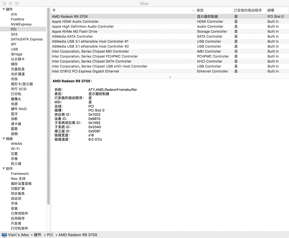

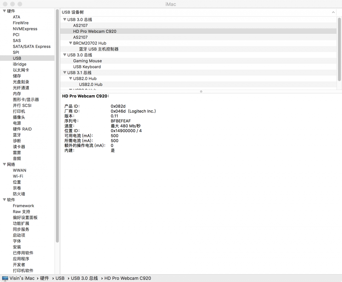

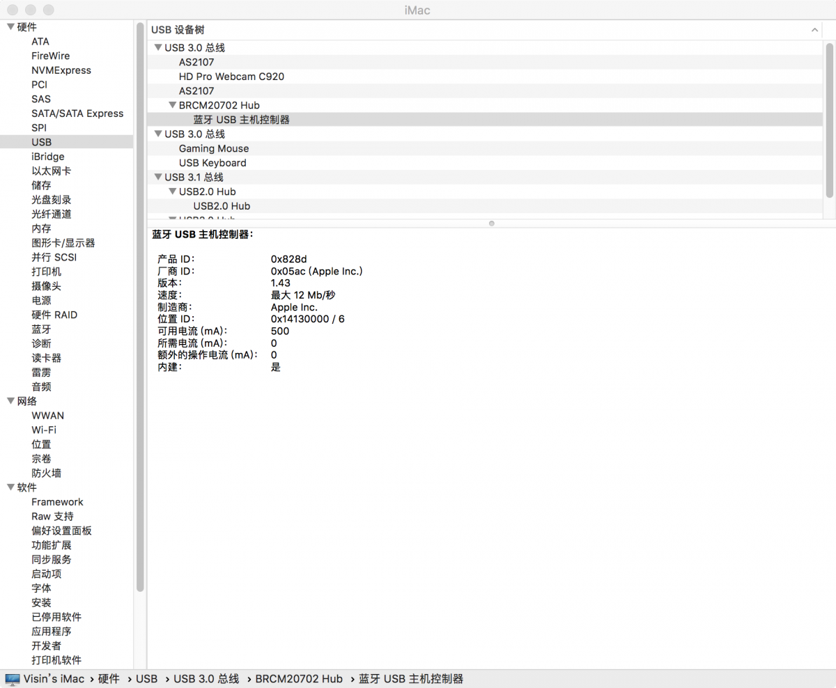

visin Posted February 10, 2018 Share Posted February 10, 2018 CLOVER.zip i think u need a fakecpuid, 10.13.4 beta have a full support for u now Thanks a lot, I've used the clover you provided, everything is fine, a lot of PCI devices are built in, and I've modified the USBInjectAll.kext port property to make my bluetooth and webcam built in. I have not tested the sleep mode will not be a problem, before testing, I need to modify the sleep mode it? Bios also need to modify other settings about sleep it? Please give me guidance, thank you! 1 Link to comment https://www.insanelymac.com/forum/topic/321872-guide-catalina-bigsur-monterey-on-mobos-serie-100-200-300-400-500-600-skylake-kabylake-coffeelake-cometlake-rocketlake-alderlake-dsdt/page/79/#findComment-2588546 Share on other sites More sharing options...
MaLd0n Posted February 10, 2018 Author Share Posted February 10, 2018 good, dont need ssdt, if u can exclude unused usb ports use flag uia_exclude=XXXX; 1 Link to comment https://www.insanelymac.com/forum/topic/321872-guide-catalina-bigsur-monterey-on-mobos-serie-100-200-300-400-500-600-skylake-kabylake-coffeelake-cometlake-rocketlake-alderlake-dsdt/page/79/#findComment-2588548 Share on other sites More sharing options...

bocajoe Posted February 10, 2018 Share Posted February 10, 2018 if install don't up, use Sorry, I don't understand 1 Link to comment https://www.insanelymac.com/forum/topic/321872-guide-catalina-bigsur-monterey-on-mobos-serie-100-200-300-400-500-600-skylake-kabylake-coffeelake-cometlake-rocketlake-alderlake-dsdt/page/79/#findComment-2588560 Share on other sites More sharing options...

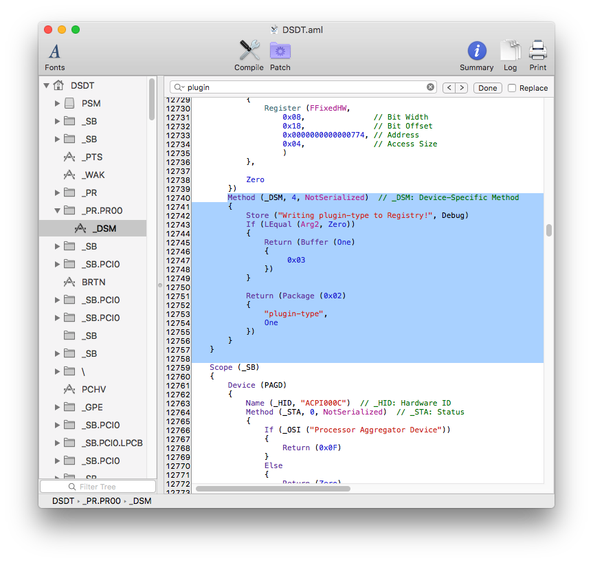

MaLd0n Posted February 10, 2018 Author Share Posted February 10, 2018 same result i use plugin type in dsdt, dont need add in config.plist into scope label _PR.PR00 insert use it and check Install Intel Power Gadget.pkg.zip run geekbench and check score Sorry, I don't understand if ur install fail, use voodootscsync 1 Link to comment https://www.insanelymac.com/forum/topic/321872-guide-catalina-bigsur-monterey-on-mobos-serie-100-200-300-400-500-600-skylake-kabylake-coffeelake-cometlake-rocketlake-alderlake-dsdt/page/79/#findComment-2588563 Share on other sites More sharing options...
bocajoe Posted February 10, 2018 Share Posted February 10, 2018 same result i use plugin type in dsdt, dont need add in config.plist into scope label _PR.PR00 insert use it and check Install Intel Power Gadget.pkg.zip run geekbench and check score if ur install fail, use voodootscsync OK. Waiting on new 10.13.02 USB installer to finish up. I noticed voodootscsync is available for 4,6,8 cores... my i9-7900x is a 10 core so not sure what to use for voodootscsync 1 Link to comment https://www.insanelymac.com/forum/topic/321872-guide-catalina-bigsur-monterey-on-mobos-serie-100-200-300-400-500-600-skylake-kabylake-coffeelake-cometlake-rocketlake-alderlake-dsdt/page/79/#findComment-2588564 Share on other sites More sharing options...

visin Posted February 10, 2018 Share Posted February 10, 2018 same result i use plugin type in dsdt, dont need add in config.plist into scope label _PR.PR00 insert use it and check Install Intel Power Gadget.pkg.zip run geekbench and check score Did you mean that you have already inserted 8700k frequency conversion in dsdt? So I do not need any settings on the cpu frequency, do not need ssdtPRGen.sh do not need PluginType? Integrated inside the DSDT? Or do I need to insert _PR.PR00? 1 Link to comment https://www.insanelymac.com/forum/topic/321872-guide-catalina-bigsur-monterey-on-mobos-serie-100-200-300-400-500-600-skylake-kabylake-coffeelake-cometlake-rocketlake-alderlake-dsdt/page/79/#findComment-2588569 Share on other sites More sharing options...
MaLd0n Posted February 10, 2018 Author Share Posted February 10, 2018 Did you mean that you have already inserted 8700k frequency conversion in dsdt? So I do not need any settings on the cpu frequency, do not need ssdtPRGen.sh do not need PluginType? Integrated inside the DSDT? Or do I need to insert _PR.PR00? yes, plugintype in DSDT 1 Link to comment https://www.insanelymac.com/forum/topic/321872-guide-catalina-bigsur-monterey-on-mobos-serie-100-200-300-400-500-600-skylake-kabylake-coffeelake-cometlake-rocketlake-alderlake-dsdt/page/79/#findComment-2588575 Share on other sites More sharing options...

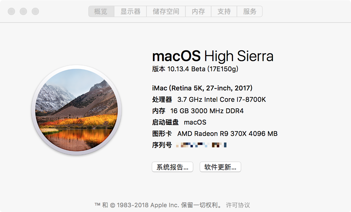

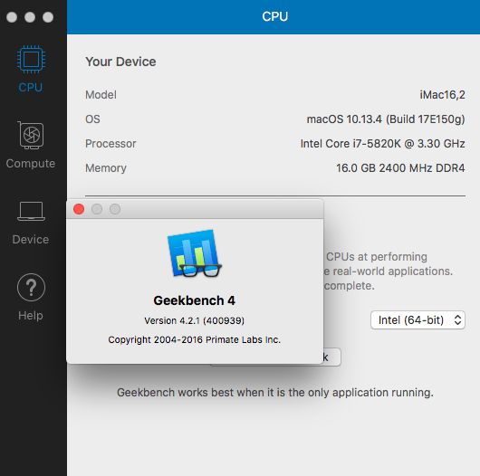

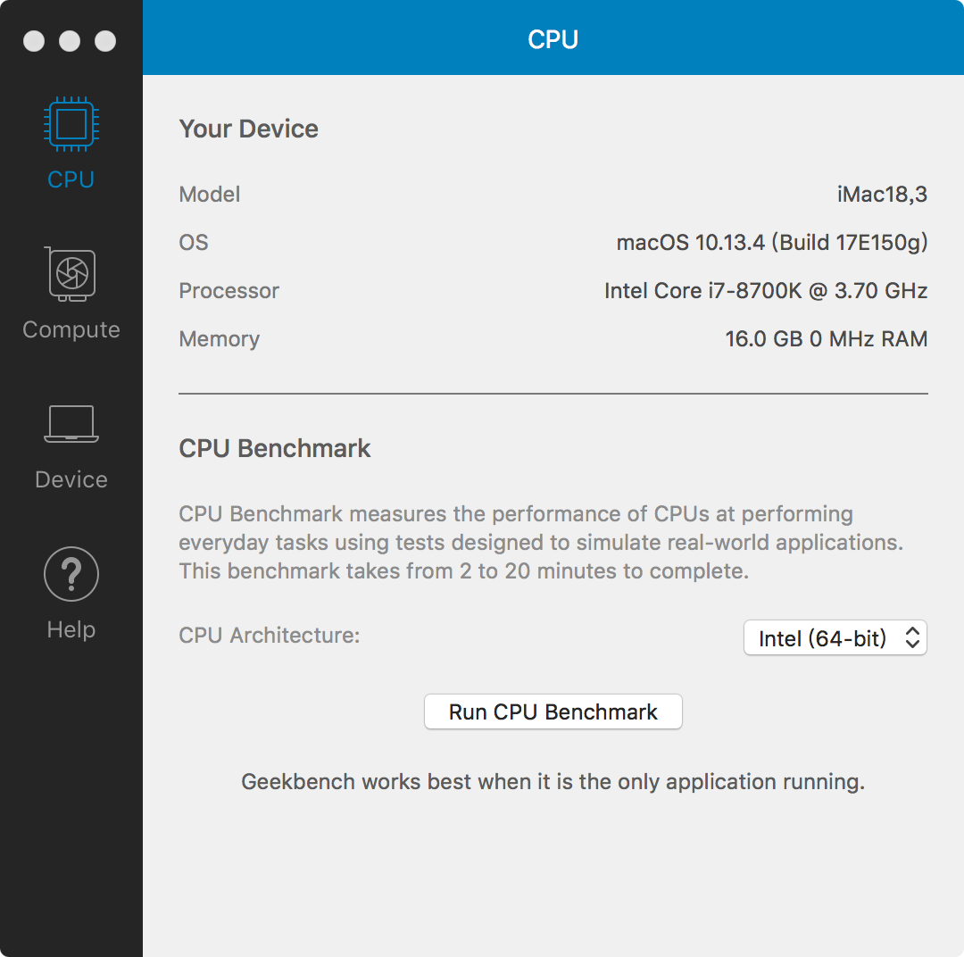

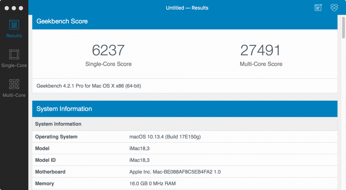

visin Posted February 10, 2018 Share Posted February 10, 2018 yes, plugintype in DSDT MaLd0n 2018-02-10 às 01.54.12.png No wonder I just started in the clover Lane PluginType restart error, it turned out in the DSDT opened PluginType, understand. This is Geekbench's run, is it normal? But there is a problem, can not detect the memory frequency. . . . 1 Link to comment https://www.insanelymac.com/forum/topic/321872-guide-catalina-bigsur-monterey-on-mobos-serie-100-200-300-400-500-600-skylake-kabylake-coffeelake-cometlake-rocketlake-alderlake-dsdt/page/79/#findComment-2588579 Share on other sites More sharing options...

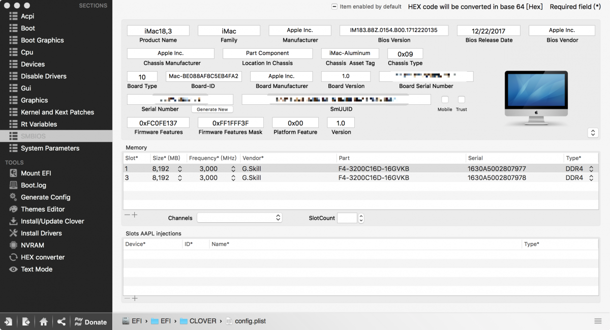

MaLd0n Posted February 10, 2018 Author Share Posted February 10, 2018 No wonder I just started in the clover Lane PluginType restart error, it turned out in the DSDT opened PluginType, understand. QQ20180210-120010@2x.png This is Geekbench's run, is it normal? QQ20180210-120142@2x.png But there is a problem, can not detect the memory frequency. . . . Memory is a Clover u can add info about it in SMBIOS tab, u use last version? Link to comment https://www.insanelymac.com/forum/topic/321872-guide-catalina-bigsur-monterey-on-mobos-serie-100-200-300-400-500-600-skylake-kabylake-coffeelake-cometlake-rocketlake-alderlake-dsdt/page/79/#findComment-2588582 Share on other sites More sharing options...

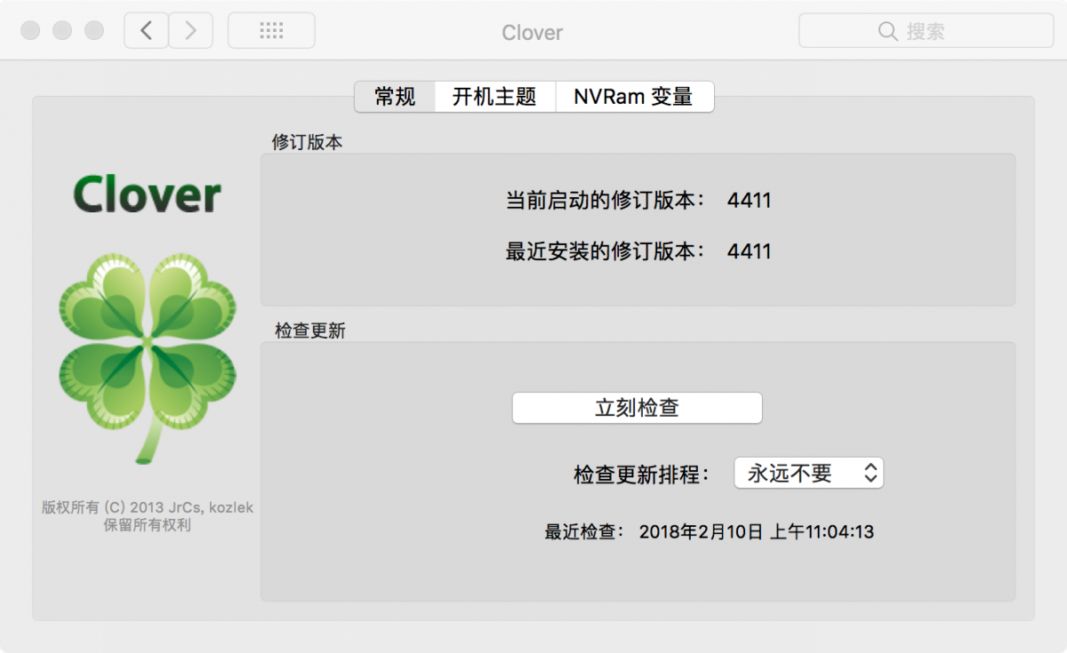

visin Posted February 10, 2018 Share Posted February 10, 2018 Memory is a Clover u can add info about it in SMBIOS tab, u use last version? 1 Link to comment https://www.insanelymac.com/forum/topic/321872-guide-catalina-bigsur-monterey-on-mobos-serie-100-200-300-400-500-600-skylake-kabylake-coffeelake-cometlake-rocketlake-alderlake-dsdt/page/79/#findComment-2588587 Share on other sites More sharing options...
MaLd0n Posted February 10, 2018 Author Share Posted February 10, 2018 4.2.1 version? work good in all my hacks Link to comment https://www.insanelymac.com/forum/topic/321872-guide-catalina-bigsur-monterey-on-mobos-serie-100-200-300-400-500-600-skylake-kabylake-coffeelake-cometlake-rocketlake-alderlake-dsdt/page/79/#findComment-2588593 Share on other sites More sharing options...
visin Posted February 10, 2018 Share Posted February 10, 2018 4.2.1 version? work good in all my hacks MaLd0n 2018-02-10 às 02.34.57.png yes,version this 4.2.1 Memory frequency can not identify how much should be no problem? 1 Link to comment https://www.insanelymac.com/forum/topic/321872-guide-catalina-bigsur-monterey-on-mobos-serie-100-200-300-400-500-600-skylake-kabylake-coffeelake-cometlake-rocketlake-alderlake-dsdt/page/79/#findComment-2588594 Share on other sites More sharing options...
MaLd0n Posted February 10, 2018 Author Share Posted February 10, 2018 i think is just a bug with very new hardware, next release i think solve it Link to comment https://www.insanelymac.com/forum/topic/321872-guide-catalina-bigsur-monterey-on-mobos-serie-100-200-300-400-500-600-skylake-kabylake-coffeelake-cometlake-rocketlake-alderlake-dsdt/page/79/#findComment-2588599 Share on other sites More sharing options...
visin Posted February 10, 2018 Share Posted February 10, 2018 i think is just a bug with very new hardware, next release i think solve it This should only be a message of error, will not lead to any problems with the system, I hope to be resolved later, Thank you for providing dsdt, I think my device can run perfectly, I have time to test will sleep for a long time will not have Problem, the computer appeared to sleep after a long time before the computer starts automatically, and can not boot hibernated mode, has been repeatedly restarted. I do not know after using DSDT will not solve this problem. 1 Link to comment https://www.insanelymac.com/forum/topic/321872-guide-catalina-bigsur-monterey-on-mobos-serie-100-200-300-400-500-600-skylake-kabylake-coffeelake-cometlake-rocketlake-alderlake-dsdt/page/79/#findComment-2588602 Share on other sites More sharing options...

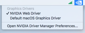

santes Posted February 10, 2018 Share Posted February 10, 2018 #1 - I'm stuck at apple Black screen Logo. I'm on High sSierra(10.13.0, 10.13.2, 10.13.3).#2 - i research a lot then get my answer is you have to remove Nvidia Graphics Card and install so i did it...and it work well on motherboard Graphics..but its pretty slow...like my Xcode simulator taking too much time..rather my Xcode simulator work pretty fast in sierra with my Nvidia graphics card...#3 i also did this method too..like i enable System Integrity Protection status: enabled (0x0000)...after install Nvidia driver..and web driver install successfully...and it showed enable at taskbar too...so I put it back my graphics card...and guess what? Problem is still occurring....#4 HDMI AUDIO NOT WORKING#5 here my specificationMotherboard : gigabyte ga-z270-hd3pprocessor : intel core i5 7600k (stock clock)Memory : 8 GB 2400 MHz DDR4Nvidia Graphics : NVIDIA GeForce GT 520 ( Not Working in High sierra)intel Graphics : Intel HD Graphics 630 1536 MB (working in high sierra)Display : DELL S2216H Display#6 ERROR Images when i run in verbose mode #7 i'm using EfI that provided by this ForumSo hope U guys Help ME 1 Link to comment https://www.insanelymac.com/forum/topic/321872-guide-catalina-bigsur-monterey-on-mobos-serie-100-200-300-400-500-600-skylake-kabylake-coffeelake-cometlake-rocketlake-alderlake-dsdt/page/79/#findComment-2589014 Share on other sites More sharing options...
MaLd0n Posted February 10, 2018 Author Share Posted February 10, 2018 if GPU dont work in High Sierra, remove, use IntelHDGraphics 1 Link to comment https://www.insanelymac.com/forum/topic/321872-guide-catalina-bigsur-monterey-on-mobos-serie-100-200-300-400-500-600-skylake-kabylake-coffeelake-cometlake-rocketlake-alderlake-dsdt/page/79/#findComment-2589020 Share on other sites More sharing options...
santes Posted February 10, 2018 Share Posted February 10, 2018 if GPOU dont work in High Sierra, remove, use IntelHDGraphics yeah I'm using IntelHDGraphics...work well but sometime is flicking and take too much time for my Xcode running 1 Link to comment https://www.insanelymac.com/forum/topic/321872-guide-catalina-bigsur-monterey-on-mobos-serie-100-200-300-400-500-600-skylake-kabylake-coffeelake-cometlake-rocketlake-alderlake-dsdt/page/79/#findComment-2589041 Share on other sites More sharing options...
