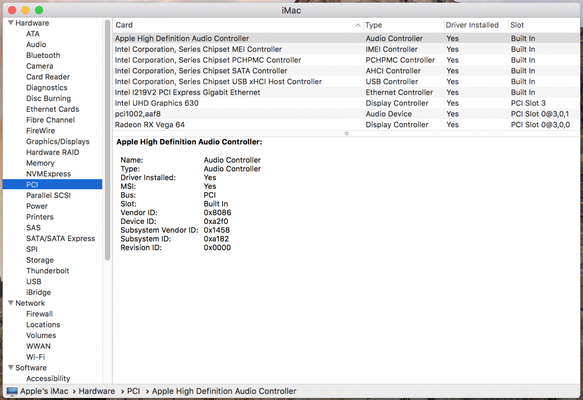

RandomTech Posted February 1, 2018 Share Posted February 1, 2018 DSDT.aml.zip Use Patches in config.plist GFX0 to IGPU 47465830 49475055 HDAS to HDEF 48444153 48444546 HECI to IMEI 48454349 494d4549 Usb, Use UsbInjectAll + xhci 200 series + patch port limit, if u can disable Unused ports, use it, dont need SSDT E.G uia_exclude=HS01;HS02;HS03;HS04;HS05;HS06;HS10;HS11;SSP1;SSP2;SSP6 Thank you Sir, all done and gave me the best results, much appreciate as I never had such a high level help like this. For USB, Im on 10.13.4 beta therefor I'm using Fred 10.13.4 usb patch and its working, in addition to USBInjectAll + XHCI-300-series.kext which I found on internet (don't remember where), so all good. Very happy thanks again. 1 Link to comment Share on other sites More sharing options...

MaLd0n Posted February 1, 2018 Author Share Posted February 1, 2018 Thank you Sir, all done and gave me the best results, much appreciate as I never had such a high level help like this. For USB, Im on 10.13.4 beta therefor I'm using Fred 10.13.4 usb patch and its working, in addition to USBInjectAll + XHCI-300-series.kext which I found on internet (don't remember where), so all good. Very happy thanks again. send me new ioreg, i apply correct patches for video and hdmi 2 Link to comment Share on other sites More sharing options...

RandomTech Posted February 1, 2018 Share Posted February 1, 2018 send me new ioreg, i apply correct patches for video and hdmi This is the new ioreg, Send me Apple’s iMac.zip 1 Link to comment Share on other sites More sharing options...

MaLd0n Posted February 1, 2018 Author Share Posted February 1, 2018 This is the new ioreg, Check if work now DSDT.FIX.zip i create 2 simple injector, serie 200 and serie 300 AHCI INJECTOR SERIE 200 and 300.zip if u have other id, just change inside kexts U need remove _DSM into device SAT0/SATA I'm sorry, last version of what? FakeSMC seems to be from Oct 17th, 2017, same version as https://bitbucket.org/RehabMan/os-x-fakesmc-kozlek/downloads/..Or is there another version somewhere else? Anway, removed FakeSMC, still blank screen 10.13.3? 1 Link to comment Share on other sites More sharing options...
