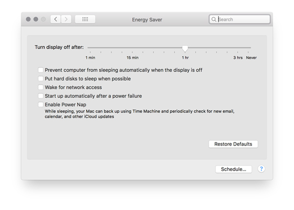

viktr Posted January 30, 2018 Share Posted January 30, 2018 run in terminal log show --style syslog | fgrep "Wake reason" and paste in one .txt, i need log after run it sudo log erase --all reboot and run it log show --predicate 'process == "kernel"' --start "`date -v -10M "+%Y-%m-%d %H:%M:%S"`" logs.tar.gz 1 Link to comment Share on other sites More sharing options...
MaLd0n Posted January 30, 2018 Author Share Posted January 30, 2018 run in terminal log show --style syslog | fgrep "Wake reason" and paste in one .txt, i need log after run it sudo log erase --all reboot and run it log show --predicate 'process == "kernel"' --start "`date -v -10M "+%Y-%m-%d %H:%M:%S"`" WoL enabled? Link to comment Share on other sites More sharing options...
viktr Posted January 30, 2018 Share Posted January 30, 2018 WoL enabled? Disabled in bios. Also: 1 Link to comment Share on other sites More sharing options...
MaLd0n Posted January 30, 2018 Author Share Posted January 30, 2018 very strange, many devices wake auto, with Wol enable i see it :S 1 Link to comment Share on other sites More sharing options...

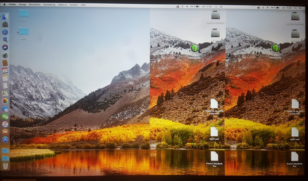

viktr Posted January 30, 2018 Share Posted January 30, 2018 very strange, many devices wake auto, with Wol enable i see it :S There's the bios setting "platform power management", maybe I'd try to disable it? But last time it prevented the system from sleep completely. I have no idea. Is it possible at all to build sleepable hackintosh? ) Anyway, if it would be possible to make video working, I'd don't mind these wakes at all. But video is like not initialized after that wake. It's strange because in this state I can connect via screen sharing and put computer in the short sleep (actually just pressing sleep so it starting to sleep and that's all) and after that video works fine. 1 Link to comment Share on other sites More sharing options...

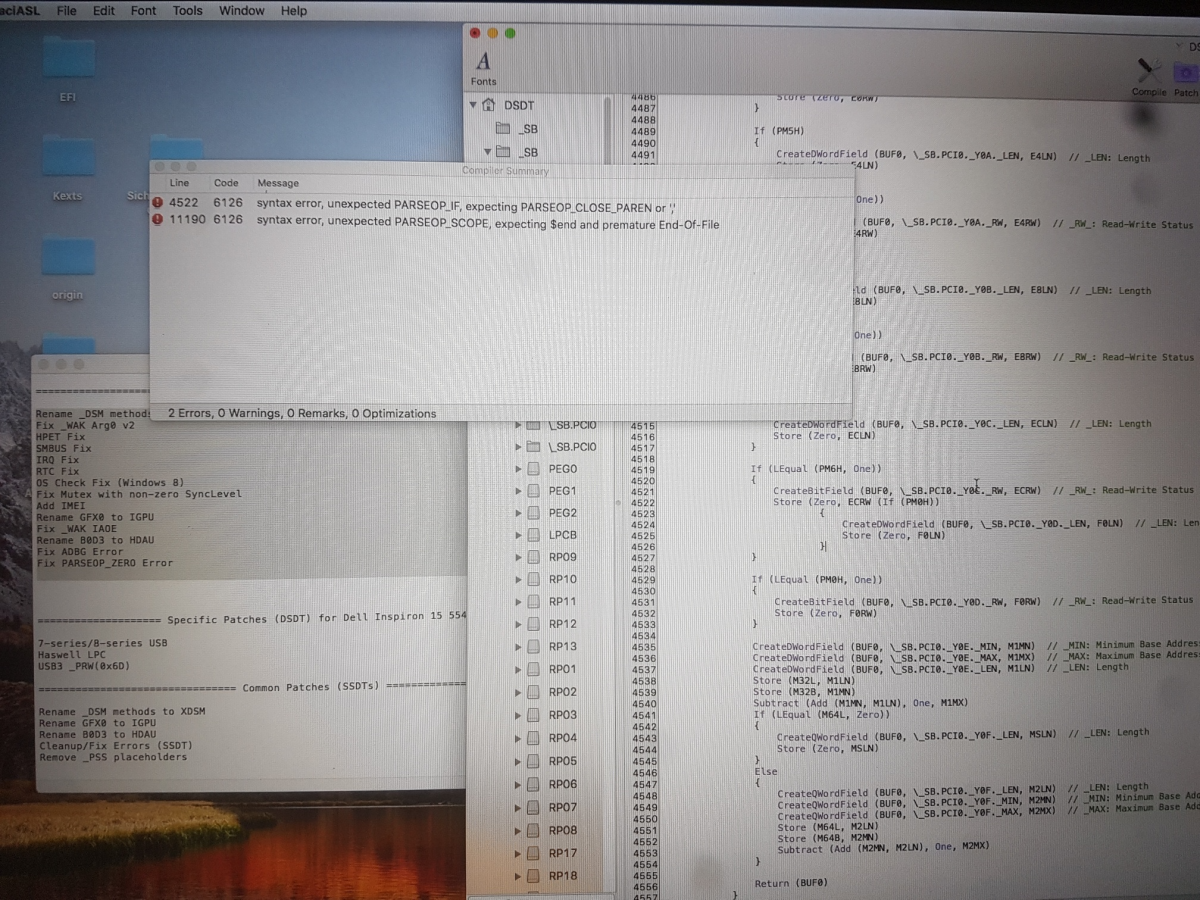

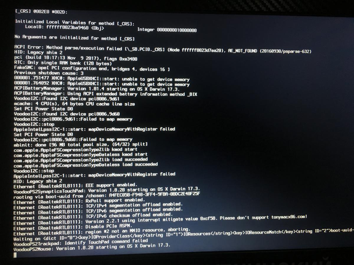

fmac Posted January 31, 2018 Share Posted January 31, 2018 Hallo have here a Dell Latitude 5580 (Kabylake i5 7440HQ:Intel HD630) try to compile the DSDT, after this patches : Rename _DSM methods to XDSM Fix _WAK Arg0 v2 HPET Fix SMBUS Fix IRQ Fix RTC Fix OS Check Fix (Windows 8) Fix Mutex with non-zero SyncLevel Add IMEI Rename GFX0 to IGPU Fix _WAK IAOE Rename B0D3 to HDAU Fix ADBG Error Fix PARSEOP_ZERO Error but can't fix the errors after sleep I have this screen and usb stops working : SMBIOS : MacBook Pro 13,1 macOS X High Sierra 10.13.3 (17D47) how to fix this errors ? what are the right patches for HD630 (hdmi output is not working) ? thanks Send me My MacBook Pro.zip MacBook13.1.zip 1 Link to comment Share on other sites More sharing options...

MaLd0n Posted January 31, 2018 Author Share Posted January 31, 2018 Hallo have here a Dell Latitude 5580 (Kabylake i5 7440HQ:Intel HD630) try to compile the DSDT, after this patches : Rename _DSM methods to XDSM Fix _WAK Arg0 v2 HPET Fix SMBUS Fix IRQ Fix RTC Fix OS Check Fix (Windows 8) Fix Mutex with non-zero SyncLevel Add IMEI Rename GFX0 to IGPU Fix _WAK IAOE Rename B0D3 to HDAU Fix ADBG Error Fix PARSEOP_ZERO Error but can't fix the errors after sleep I have this screen and usb stops working : SMBIOS : MacBook Pro 13,1 macOS X High Sierra 10.13.3 (17D47) how to fix this errors ? what are the right patches for HD630 (hdmi output is not working) ? thanks i'm waiting site, attach files fail Hi MaLd0n! I bough the new graphic card ASUS ROG Strix RX560. On GA Z270 Gaming K3 everything is ok. But on ASUS Z170I Pro Gaming with the same GPU the macOS doesn't see two monitors simultaneously. Can you check my files please. try with whatevergreen version 1.1.5 Check CLOVER.zip 1 Link to comment Share on other sites More sharing options...
fmac Posted January 31, 2018 Share Posted January 31, 2018 Halio here again see post 1835 thanks CLOVER.zip origin_untouched.zip 1 Link to comment Share on other sites More sharing options...
MaLd0n Posted January 31, 2018 Author Share Posted January 31, 2018 Halio here again see post 1835 thanks U need update ur clover https://sourceforge.net/projects/cloverefiboot/files/Installer/ fmac.zip Link to comment Share on other sites More sharing options...
fmac Posted January 31, 2018 Share Posted January 31, 2018 U need update ur clover https://sourceforge.net/projects/cloverefiboot/files/Installer/ fmac.zip Hallo have panics and acpi errors sorry Link to comment Share on other sites More sharing options...
MaLd0n Posted January 31, 2018 Author Share Posted January 31, 2018 u need use all my files and dont use any ssdt, only ssdt pnlf u need use my config.plist or add patches in ur config.plist GFX0 to IGPU 47465830 49475055 HDAS to HDEF 48444153 48444546 HECI to IMEI 48454349 494d4549 if we rename devices in DSDT , u need use patches in config.plist for rename same devices in OEM SSDTs 1 Link to comment Share on other sites More sharing options...

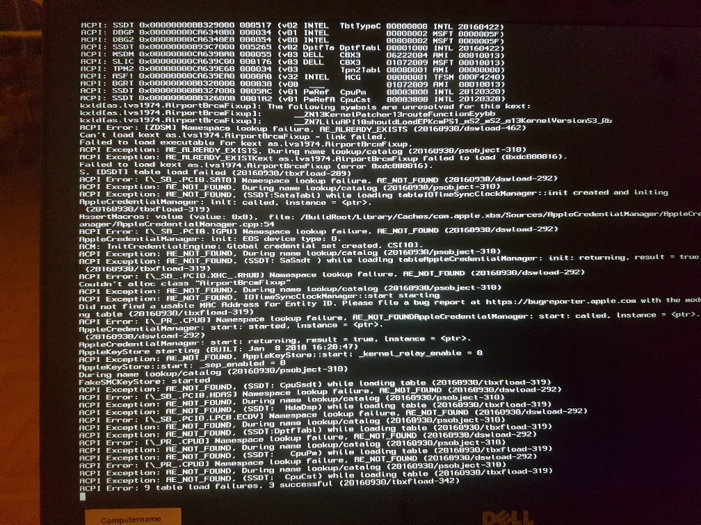

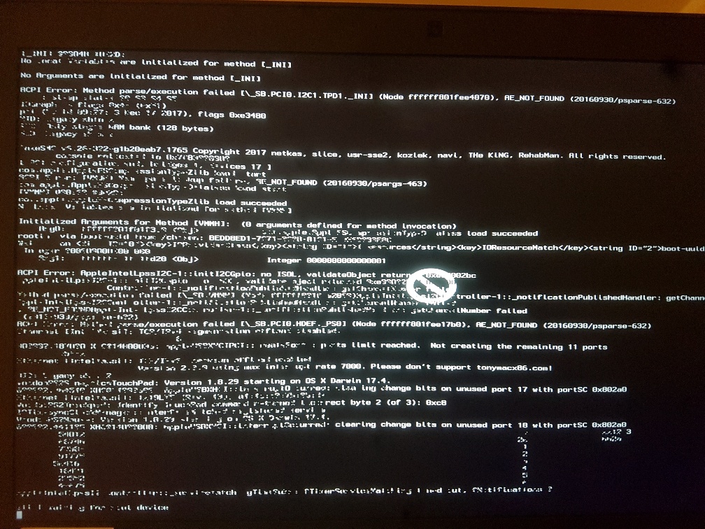

4l3x88 Posted January 31, 2018 Share Posted January 31, 2018 Hi MaLd0n, I've installed HS over Sierra with your "Serie 100/200/300" clover folder (I had to change smbios to imac18.3 and select "DisableASPM" in clover otherwise I had a blank screen after boot) You already helped me here and I have a couple querstions: - should I use the same Clover folder? (with that I had issues with the last security update and I posted about it here, that's why I reinstalled HS over Sierra) - what SMBIOS should I use? Since ssdtPRGen says `board-id [Mac-BE088AF8C5EB4FA2] not supported by Skylake – check SMBIOS data / use the -target option` Thank you in advance Update: Just in case I've uploaded the clover folder I'm actually using + sendme and ioreg Update 2: Tried to boot with 17.1 fails, still black screen, so DisableASPM alone isn't enough Update 3: Tried to boot with older config+dsdt+17.1, same issue (I've updated BIOS since the last config) Send me.zip ioreg.zip CLOVER.zip 1 Link to comment Share on other sites More sharing options...
MaLd0n Posted January 31, 2018 Author Share Posted January 31, 2018 Hi MaLd0n, I've installed HS over Sierra with your "Serie 100/200/300" clover folder (I had to change smbios to imac18.3 and select "DisableASPM" in clover otherwise I had a blank screen after boot) You already helped me here and I have a couple querstions: - should I use the same Clover folder? (with that I had issues with the last security update and I posted about it here, that's why I reinstalled HS over Sierra) - what SMBIOS should I use? Since ssdtPRGen says `board-id [Mac-BE088AF8C5EB4FA2] not supported by Skylake – check SMBIOS data / use the -target option` Thank you in advance Update: Just in case I've uploaded the clover folder I'm actually using + sendme and ioreg Update 2: Tried to boot with 17.1 fails, still black screen, so DisableASPM alone isn't enough Update 3: Tried to boot with older config+dsdt+17.1, same issue (I've updated BIOS since the last config) Install Clover in hdd/ssd, last version, replace full folder CLOVER.zip Install it if u use high sierra 10.13.3 http://www.insanelymac.com/forum/topic/323052-guide-sierra-high-sierra-on-intel-5-6-7-8-9-and-x99-chipset-series-nehalem-sandybridge-ivybridge-haswell-broadwell/?p=2575822 2 Link to comment Share on other sites More sharing options...
4l3x88 Posted February 1, 2018 Share Posted February 1, 2018 Install Clover in hdd/ssd, last version, replace full folder CLOVER.zip Install it if u use high sierra 10.13.3 http://www.insanelymac.com/forum/topic/323052-guide-sierra-high-sierra-on-intel-5-6-7-8-9-and-x99-chipset-series-nehalem-sandybridge-ivybridge-haswell-broadwell/?p=2575822 Copied CLOVER folder over, patched NVDAStartupWeb with OS build, blank screen on startup after loading screen 1 Link to comment Share on other sites More sharing options...
