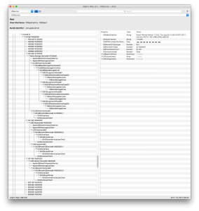

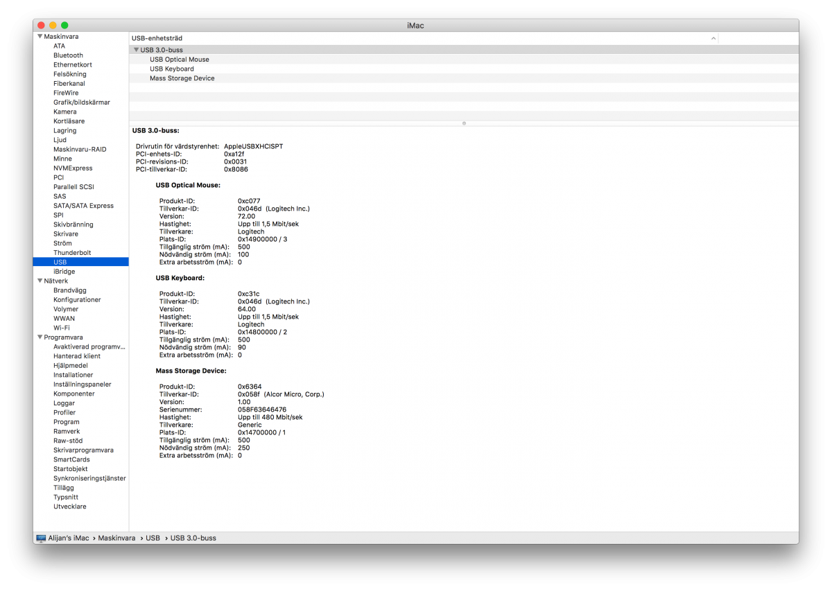

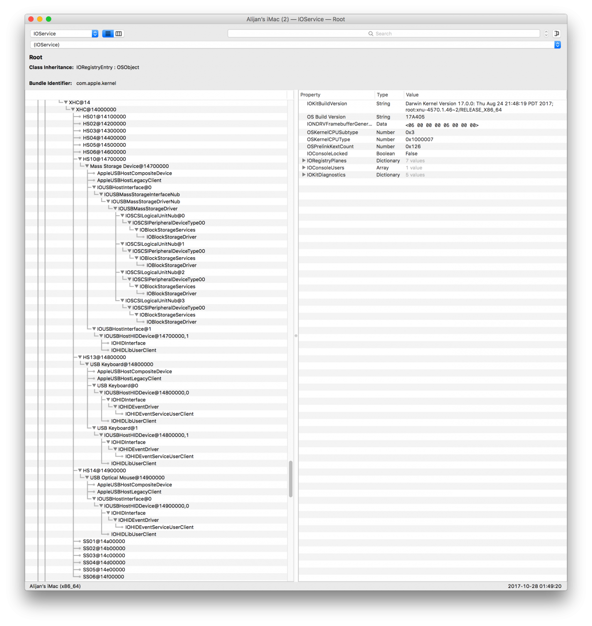

swede420 Posted October 27, 2017 Share Posted October 27, 2017 Why all my usb ports are listed under one USB 3.0? Link to comment Share on other sites More sharing options...
MaLd0n Posted October 28, 2017 Author Share Posted October 28, 2017 EHCI die, XHCI live if u see all devices into usb3 buss, it's ok 2 Link to comment Share on other sites More sharing options...
