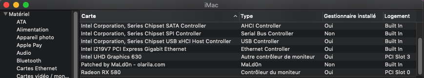

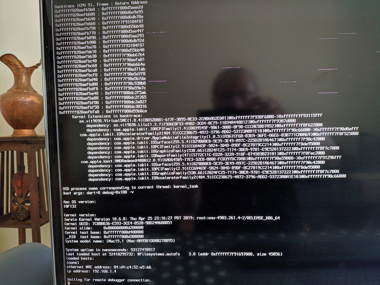

Matgen84 Posted June 2, 2019 Share Posted June 2, 2019 (edited) 39 minutes ago, MaLd0n said: Arquivo Comprimido.zip check ssdt, looks good, check if shutdown/restart. nvram, etc work fine Thanks Panic randomly at restart (see picture below) I doesn't remember how to check NVRAM work correctly. In "About my mac" System report: what means PCI "Patched byMaLdOn" not installed Sorry for my bad english Edited June 2, 2019 by Matgen84 Link to comment https://www.insanelymac.com/forum/topic/321872-guide-catalina-bigsur-monterey-on-mobos-serie-100-200-300-400-500-600-skylake-kabylake-coffeelake-cometlake-rocketlake-alderlake-dsdt/page/200/#findComment-2675921 Share on other sites More sharing options...
MaLd0n Posted June 2, 2019 Author Share Posted June 2, 2019 22 minutes ago, Matgen84 said: Thanks Panic randomly at restart (see picture below) I doesn't remember how to check NVRAM work correctly. In "About my mac" System report: what means PCI "Patched byMaLdOn" not installed Sorry for my bad english DSDT.aml.zip u can try with fakesmc instead virtualsmc and use a release kexts, i put compiled debug version 2 1 Link to comment https://www.insanelymac.com/forum/topic/321872-guide-catalina-bigsur-monterey-on-mobos-serie-100-200-300-400-500-600-skylake-kabylake-coffeelake-cometlake-rocketlake-alderlake-dsdt/page/200/#findComment-2675927 Share on other sites More sharing options...
MaLd0n Posted June 3, 2019 Author Share Posted June 3, 2019 9 hours ago, Matgen84 said: Thanks Panic randomly at restart (see picture below) try it for intel quick sync, is a correct value from iMac19,1 IntelGFX 0x3E928086 ig-platform-id 0x3E920003Check InjectIntelshikigva=60 2 Link to comment https://www.insanelymac.com/forum/topic/321872-guide-catalina-bigsur-monterey-on-mobos-serie-100-200-300-400-500-600-skylake-kabylake-coffeelake-cometlake-rocketlake-alderlake-dsdt/page/200/#findComment-2675984 Share on other sites More sharing options...
Matgen84 Posted June 3, 2019 Share Posted June 3, 2019 (edited) 10 hours ago, MaLd0n said: try it for intel quick sync, is a correct value from iMac19,1 IntelGFX 0x3E928086 ig-platform-id 0x3E920003Check InjectIntelshikigva=60 Thanks a lot EDIT: same issue at first restart What do you think of that: on Clover Topic, Slice said: "Chipset 390 has no support for real NVRAM even with AptioMemoryFix. You have to install EmuVariableUefi-64.efi." Question: macOS display "Intel 11 series chipset" without DSDT, "Intel 10 series chipset" with DSDT. What it means, I don't understand: Patched bt MaLdOn - olarila.com -->No--->Built In Edited June 3, 2019 by Matgen84 Link to comment https://www.insanelymac.com/forum/topic/321872-guide-catalina-bigsur-monterey-on-mobos-serie-100-200-300-400-500-600-skylake-kabylake-coffeelake-cometlake-rocketlake-alderlake-dsdt/page/200/#findComment-2676000 Share on other sites More sharing options...

Matgen84 Posted June 3, 2019 Share Posted June 3, 2019 (edited) 43 minutes ago, MaLd0n said: don't need EmuVariableUefi-64.efi, ur nvram work now, i think the problem is about weg or virtualsmc or clover or about intel quick sync, try without intelHD enable for check if work, the problem appears in boot from system need investigate use it to solve sata 10 series DSDT.aml.zip I think too for EmuvariableUefi-64.efi. Except at first boot, no problem now. I will try the new DSDT. And report. Thanks for your help EDIT: Replace DSDT in EFI Folder, Panic again at first restart. Maybe cause by VirtualSMC. I will use FakeSMC instead. Edited June 3, 2019 by Matgen84 Link to comment https://www.insanelymac.com/forum/topic/321872-guide-catalina-bigsur-monterey-on-mobos-serie-100-200-300-400-500-600-skylake-kabylake-coffeelake-cometlake-rocketlake-alderlake-dsdt/page/200/#findComment-2676038 Share on other sites More sharing options...
MaLd0n Posted June 3, 2019 Author Share Posted June 3, 2019 16 minutes ago, Matgen84 said: I think too for EmuvariableUefi-64.efi. Except at first boot, no problem now. I will try the new DSDT. And report. Thanks for your help EDIT: Replace DSDT in EFI Folder, Panic again at first restart. Maybe cause by VirtualSMC. I will use FakeSMC instead. take one shot with emuvariable let me know Link to comment https://www.insanelymac.com/forum/topic/321872-guide-catalina-bigsur-monterey-on-mobos-serie-100-200-300-400-500-600-skylake-kabylake-coffeelake-cometlake-rocketlake-alderlake-dsdt/page/200/#findComment-2676042 Share on other sites More sharing options...
Matgen84 Posted June 3, 2019 Share Posted June 3, 2019 28 minutes ago, MaLd0n said: take one shot with emuvariable let me know Test: Copy again DSDT in EFI folder Use VirtualSMC.kext, EmuVariableUEFI----> No problem at first restart Copy again DSDT in EFI folder Use VirtualSMC.kext, don't use EmuVariableUEFI----> No problem at first restart I can't reproduce the problem. Maybe is randomly issue? I don't know Link to comment https://www.insanelymac.com/forum/topic/321872-guide-catalina-bigsur-monterey-on-mobos-serie-100-200-300-400-500-600-skylake-kabylake-coffeelake-cometlake-rocketlake-alderlake-dsdt/page/200/#findComment-2676047 Share on other sites More sharing options...
MaLd0n Posted June 3, 2019 Author Share Posted June 3, 2019 1 hour ago, Matgen84 said: Test: Copy again DSDT in EFI folder Use VirtualSMC.kext, EmuVariableUEFI----> No problem at first restart Copy again DSDT in EFI folder Use VirtualSMC.kext, don't use EmuVariableUEFI----> No problem at first restart I can't reproduce the problem. Maybe is randomly issue? I don't know ye, random u try without IGPU enable? Link to comment https://www.insanelymac.com/forum/topic/321872-guide-catalina-bigsur-monterey-on-mobos-serie-100-200-300-400-500-600-skylake-kabylake-coffeelake-cometlake-rocketlake-alderlake-dsdt/page/200/#findComment-2676055 Share on other sites More sharing options...
Matgen84 Posted June 4, 2019 Share Posted June 4, 2019 14 hours ago, MaLd0n said: ye, random u try without IGPU enable? Test without IGPU enable----> No problem for the moment. Very strange this random issue. Link to comment https://www.insanelymac.com/forum/topic/321872-guide-catalina-bigsur-monterey-on-mobos-serie-100-200-300-400-500-600-skylake-kabylake-coffeelake-cometlake-rocketlake-alderlake-dsdt/page/200/#findComment-2676219 Share on other sites More sharing options...
