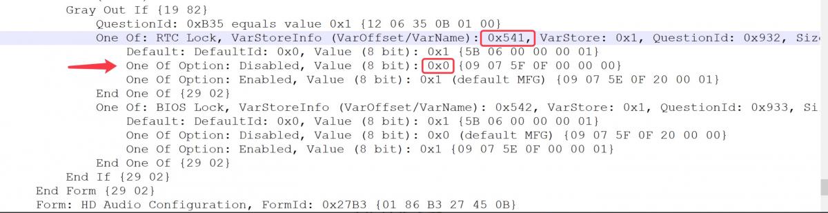

gujiangjiang Posted December 29, 2017 Share Posted December 29, 2017 Bios 1.6.1 is safe to upgrade Hello goodwinc My friend had helped me with some progress with native nvram work on our laptop. He found the nvram is related with a function called "RTC RAM Lock",and he test when he changed this to False then the nvram works well in natively. But in XPS BIOS we have no "RTC RAM Lock" found with GUI,So i think if we can use setup_var to set this to false then to test if native nvram works? Link to comment https://www.insanelymac.com/forum/topic/319764-guide-dell-xps-15-9550-mojave-1014-1015-quick-installation/page/42/#findComment-2558143 Share on other sites More sharing options...
gujiangjiang Posted December 29, 2017 Share Posted December 29, 2017 setup_var 0x541 0x0 I will test later. Link to comment https://www.insanelymac.com/forum/topic/319764-guide-dell-xps-15-9550-mojave-1014-1015-quick-installation/page/42/#findComment-2558188 Share on other sites More sharing options...
goodwin_c Posted December 29, 2017 Share Posted December 29, 2017 24E5D79744C0E9BB69FD14D9E3B46C1C.jpg setup_var 0x541 0x0 I will test later. This makes no difference 1 Link to comment https://www.insanelymac.com/forum/topic/319764-guide-dell-xps-15-9550-mojave-1014-1015-quick-installation/page/42/#findComment-2558335 Share on other sites More sharing options...
