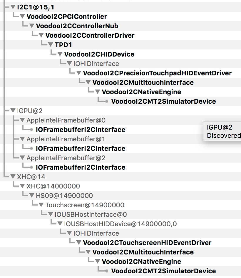

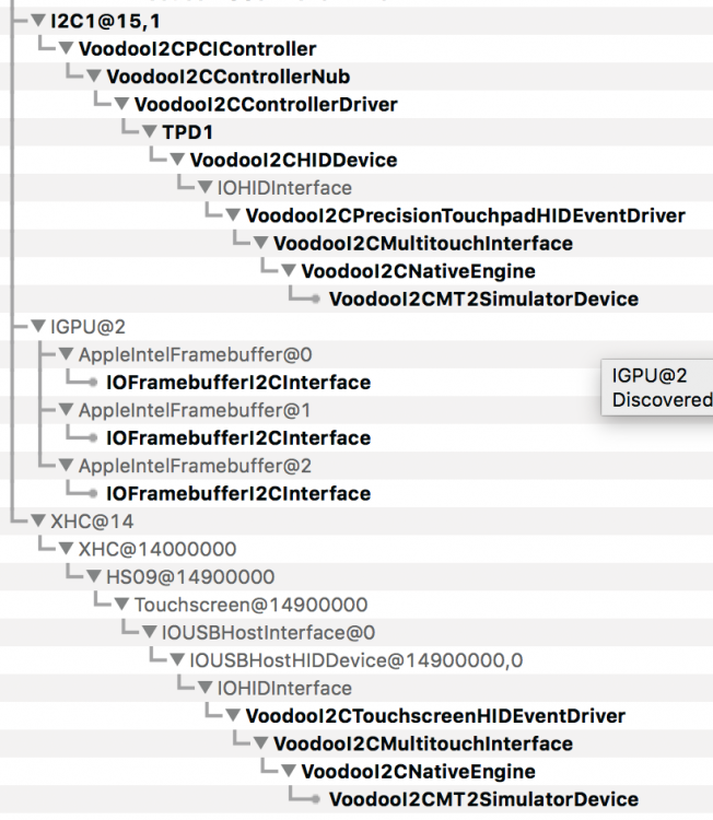

vasvas10 Posted March 11, 2018 Share Posted March 11, 2018 (edited) So, my post was deleted due to the forum's recent changes... Anyway, here is what you need to enable VoodooI2C on our machine (Better touchpad and touchscreen) More info about VoodooI2C here (thanks @alexandred for the great work) Add these two entries to Clover's config.plist at `ACPI > DSDT > Patches`: <dict> <key>Comment</key> <string>change GPI0 device _STA to XSTA</string> <key>Disabled</key> <false/> <key>Find</key> <data>X1NUQQCgCZNTQlJHAA==</data> <key>Replace</key> <data>WFNUQQCgCZNTQlJHAA==</data> </dict> <dict> <key>Comment</key> <string>change I2C devices _CRS to XCRS</string> <key>Disabled</key> <false/> <key>Find</key> <data>X0NSUwCgDg==</data> <key>Replace</key> <data>WENSUwCgDg==</data> </dict> Copy the SSDT-I2CX.aml and SSDT-XOSI.aml(thanks @goodwin_c) files inside the attached zip to `CLOVER > ACPI > patched` Download the latest VoodooI2C.kext release (link) and copy both VoodooI2C.kext and VoodooI2CHID.kext files to Clover's kexts folder . The other files are not needed. (more info about them here) Reboot and that's it. Personally I think the performance of our's laptop touchpad is better using VoodooI2C.kext than with VoodooPS2Controller.kext. And the added gestures to the Touchscreen are a nice bonus. P.S: Don't delete VoodooPS2Controller.kext, as it is still necessary for the keyboard to function and it is compatible with VoodooI2C. P.S.S: Inside the attached zip I included a beta version of VoodooI2C.kext (10.13 only, based on this changes) that enable native gestures and settings for our touchpad (Just like Apple's Magic Trackpad). However this version is in current development and those willing to test should expect bugs. (Removed per author's request, if you want to know more about this version go here) I2C.zip Edited March 21, 2018 by hvolkoff Changed attachment, removed VoodooI2C beta binary and added missing SSDT-XOSI.aml file Link to comment https://www.insanelymac.com/forum/topic/319764-guide-dell-xps-15-9550-mojave-1014-1015-quick-installation/page/45/#findComment-2602481 Share on other sites More sharing options...

vasvas10 Posted March 12, 2018 Share Posted March 12, 2018 8 minutes ago, goodwin_c said: Could you share your IOReg with VoodooI2C working? Sure, Here it is. dump.ioreg.zip Link to comment https://www.insanelymac.com/forum/topic/319764-guide-dell-xps-15-9550-mojave-1014-1015-quick-installation/page/45/#findComment-2602570 Share on other sites More sharing options...
goodwin_c Posted March 12, 2018 Share Posted March 12, 2018 1 hour ago, hvolkoff said: Sure, Here it is. dump.ioreg.zip Thanks. That is what i was thinking - on my machine it didn't catch TPD1 device. Even, i don't see TPD1 in IOReg. Will try to debug ACPI to find out what is going on. 1 Link to comment https://www.insanelymac.com/forum/topic/319764-guide-dell-xps-15-9550-mojave-1014-1015-quick-installation/page/45/#findComment-2602580 Share on other sites More sharing options...

Krim404 Posted March 12, 2018 Author Share Posted March 12, 2018 4 hours ago, goodwin_c said: Thanks. That is what i was thinking - on my machine it didn't catch TPD1 device. Even, i don't see TPD1 in IOReg. Will try to debug ACPI to find out what is going on. same here, TPD* missing. to be honest i'm a lil bit confused... i'm pretty sure the ELAN Touchscreen is connected with USB, not I2C... Link to comment https://www.insanelymac.com/forum/topic/319764-guide-dell-xps-15-9550-mojave-1014-1015-quick-installation/page/45/#findComment-2602645 Share on other sites More sharing options...
goodwin_c Posted March 12, 2018 Share Posted March 12, 2018 3 hours ago, wmchris said: same here, TPD* missing. to be honest i'm a lil bit confused... i'm pretty sure the ELAN Touchscreen is connected with USB, not I2C... Try to replace your SSDT-XOSI with next code: DefinitionBlock ("", "SSDT", 2, "hack", "XOSI", 0x00000000) { External (_SB.TBFP, MethodObj) External (USTP, UnknownObj) Name (CNT1, Zero) Method (XOSI, 1, NotSerialized) { CNT1++ IF (CNT1 == 0x1) { \_SB.TBFP (One) USTP = One } Local0 = Package (0x0A) { "Windows", "Windows 2001", "Windows 2001 SP2", "Windows 2006", "Windows 2006 SP1", "Windows 2006.1", "Windows 2009", "Windows 2012", "Windows 2013", "Windows 2015" } Return ((Ones != Match (Local0, MEQ, Arg0, MTR, Zero, Zero))) } } This will: - permanently enable TB controller (USB-C works like a charm ) - should make VoodooI2C attaching to TPD acpi device 1 Link to comment https://www.insanelymac.com/forum/topic/319764-guide-dell-xps-15-9550-mojave-1014-1015-quick-installation/page/45/#findComment-2602686 Share on other sites More sharing options...

vasvas10 Posted March 13, 2018 Share Posted March 13, 2018 2 hours ago, goodwin_c said: Try to replace your SSDT-XOSI with next code: DefinitionBlock ("", "SSDT", 2, "hack", "XOSI", 0x00000000) { External (_SB.TBFP, MethodObj) External (USTP, UnknownObj) Name (CNT1, Zero) Method (XOSI, 1, NotSerialized) { CNT1++ IF (CNT1 == 0x1) { \_SB.TBFP (One) USTP = One } Local0 = Package (0x0A) { "Windows", "Windows 2001", "Windows 2001 SP2", "Windows 2006", "Windows 2006 SP1", "Windows 2006.1", "Windows 2009", "Windows 2012", "Windows 2013", "Windows 2015" } Return ((Ones != Match (Local0, MEQ, Arg0, MTR, Zero, Zero))) } } This will: - permanently enable TB controller (USB-C works like a charm ) - should make VoodooI2C attaching to TPD acpi device Damn, thanks man. I totally forgot about adding that to the post... I too did have to make changes in SSDT-XOSI, but I only had to add the newer "windows" identifiers to it. Do you mind explaining what the CNT1 bit is about? Link to comment https://www.insanelymac.com/forum/topic/319764-guide-dell-xps-15-9550-mojave-1014-1015-quick-installation/page/45/#findComment-2602718 Share on other sites More sharing options...
Krim404 Posted March 13, 2018 Author Share Posted March 13, 2018 (edited) 3 minutes ago, hvolkoff said: Damn, thanks man. I totally forgot about adding that to the post... I too did have to make changes in SSDT-XOSI, but I only had to add the newer "windows" identifiers to it. Do you mind explaining what the CNT1 bit is about? afaik its for triggering power to the TB device on bootup. Edited March 13, 2018 by wmchris Link to comment https://www.insanelymac.com/forum/topic/319764-guide-dell-xps-15-9550-mojave-1014-1015-quick-installation/page/45/#findComment-2602719 Share on other sites More sharing options...
goodwin_c Posted March 13, 2018 Share Posted March 13, 2018 7 hours ago, wmchris said: afaik its for triggering power to the TB device on bootup. Yes, it is done to be sure that part inside of "if" will be triggered only once (on first call of XOSI function), as XOSI function is used few times in original DSDT. Link to comment https://www.insanelymac.com/forum/topic/319764-guide-dell-xps-15-9550-mojave-1014-1015-quick-installation/page/45/#findComment-2602762 Share on other sites More sharing options...
