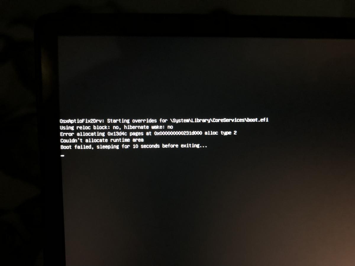

karelson Posted February 8, 2018 Share Posted February 8, 2018 Hello, i am using thuis guid. http://www.insanelym...ation-tutorial/ bios 1.2.21 ( tried 1.2.29,1.2,25,1.4,1.5) 32gb 1tb Samsung i cant boot the installer. I am am getting the can’t allocate err. I replaced OsxAptioFix3Drv-64 with OsxAptioFix2Drv-64 used slide 33 and 288. Followed this guid. https://github.com/w..._10.13_Step7.md it did not help still can’t boot installer. any ideas?? Link to comment https://www.insanelymac.com/forum/topic/319764-guide-dell-xps-15-9550-mojave-1014-1015-quick-installation/page/44/#findComment-2587508 Share on other sites More sharing options...
Krim404 Posted February 8, 2018 Author Share Posted February 8, 2018 it did not help still can’t boot installer. any ideas?? see: https://github.com/wmchris/DellXPS15-9550-OSX/tree/10.13/10.13/CLOVER/drivers64UEFI/other also check your slide parameter. >200 is very dubious and 33 is one too low. Where should I put SSD patch in config.plist I put patch in Patches sector. if it's correct, It's not working for me. I have Hynix PC300 256GB SSD you added it to the DSDT patches, this is a Kext Patch. Link to comment https://www.insanelymac.com/forum/topic/319764-guide-dell-xps-15-9550-mojave-1014-1015-quick-installation/page/44/#findComment-2587531 Share on other sites More sharing options...

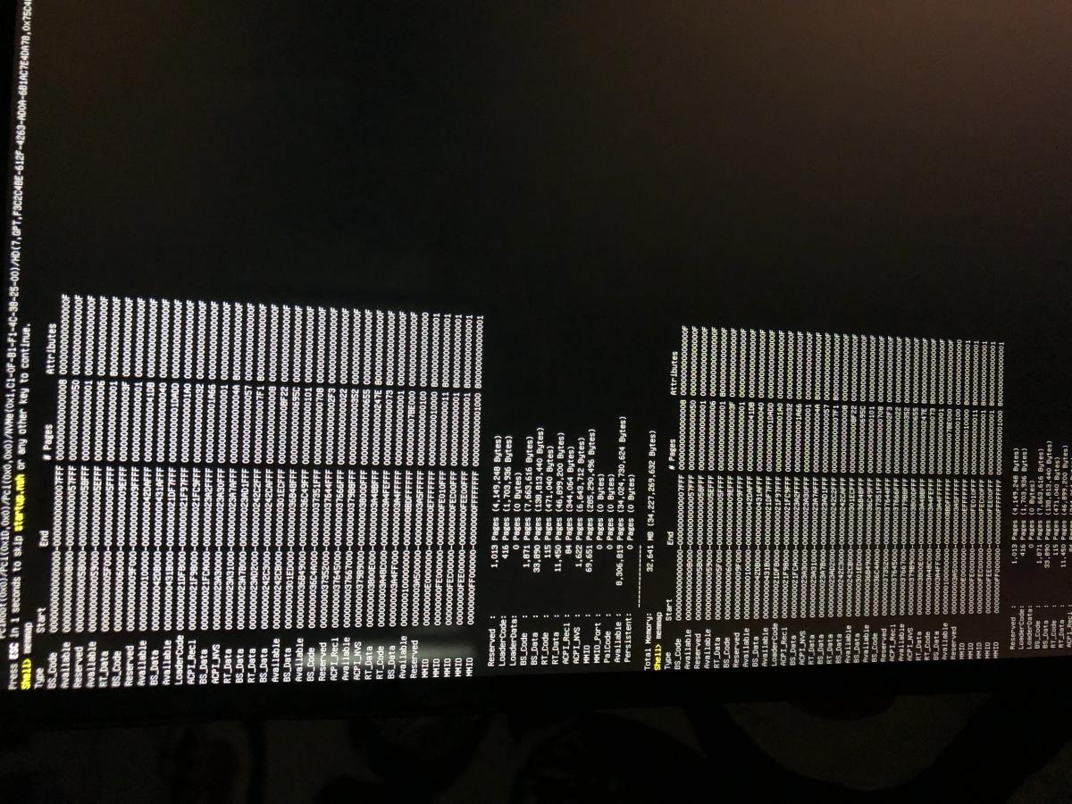

karelson Posted February 9, 2018 Share Posted February 9, 2018 see: https://github.com/wmchris/DellXPS15-9550-OSX/tree/10.13/10.13/CLOVER/drivers64UEFI/other also check your slide parameter. >200 is very dubious and 33 is one too low. you added it to the DSDT patches, this is a Kext Patch. Any chance you can help me with calculation? I have attached the memmap, in my post. ?? Link to comment https://www.insanelymac.com/forum/topic/319764-guide-dell-xps-15-9550-mojave-1014-1015-quick-installation/page/44/#findComment-2588081 Share on other sites More sharing options...
Krim404 Posted February 9, 2018 Author Share Posted February 9, 2018 Any chance you can help me with calculation? I have attached the memmap, in my post. ?? as i said... 33 is one too low. you forgot to add 1. 1 Link to comment https://www.insanelymac.com/forum/topic/319764-guide-dell-xps-15-9550-mojave-1014-1015-quick-installation/page/44/#findComment-2588140 Share on other sites More sharing options...
karelson Posted February 9, 2018 Share Posted February 9, 2018 as i said... 33 is one too low. you forgot to add 1. Well it seems better, now i am getting "unable to find driver for this platform" any idea where to look for solution? Link to comment https://www.insanelymac.com/forum/topic/319764-guide-dell-xps-15-9550-mojave-1014-1015-quick-installation/page/44/#findComment-2588278 Share on other sites More sharing options...
Krim404 Posted February 9, 2018 Author Share Posted February 9, 2018 Well it seems better, now i am getting "unable to find driver for this platform" any idea where to look for solution? where to look? http://bfy.tw/GWUc (scnr ;-) ). Never had this issue before. seems like a bad usb install media. Link to comment https://www.insanelymac.com/forum/topic/319764-guide-dell-xps-15-9550-mojave-1014-1015-quick-installation/page/44/#findComment-2588285 Share on other sites More sharing options...
karelson Posted February 11, 2018 Share Posted February 11, 2018 where to look? http://bfy.tw/GWUc (scnr ;-) ). Never had this issue before. seems like a bad usb install media. Thank you. seems that the installer USB was bed. redid it with other method and it worked fine. ALSO, unchecked slide=0 at the plist file with OsxAptioFixDrv-64.efi in the CLOVER/drivers64UEFI - made the install to work. Had some problems with reformatting the Samsung 960 Pro Thanks for the response. It's strange that windows works fine on it. Do you recommend a dive that had the most compatibility ? Thanks again for your help. reycingef9- Don't know if that helps, I had problems with formatting and mounting and so on, with diskutil in the installer, in diskutil above drive list on the drives there is an option to "show all devices" then you see the master drive and you can partition and reformat with no problems. Link to comment https://www.insanelymac.com/forum/topic/319764-guide-dell-xps-15-9550-mojave-1014-1015-quick-installation/page/44/#findComment-2589638 Share on other sites More sharing options...
