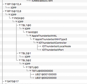

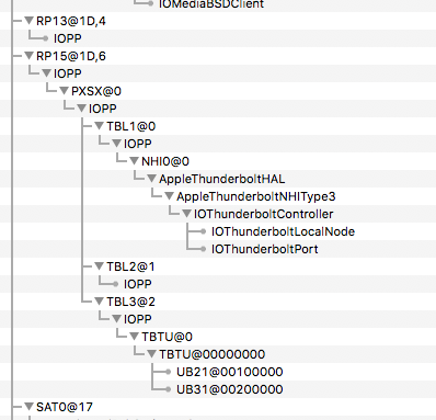

goodwin_c Posted September 8, 2017 Share Posted September 8, 2017 Hehe, new finding from me regarding ThunderBolt: - removing AppleThunderboltNHI.kext will at least help to avoid kernel panic on TB unplug - hot-plug will still work (even plugging after boot) - looks like i found how to force power TB controller on our dell machines!!! In ACPI there is specific method! \_SB.TBFP - thunder-bolt-force-power )) Will try it in next days to see how it is working and will try to make thunderbolt work in always-on mode. This ACPI method is also exposed as PNP0C14 in WMI interface to allow Intel thunderbolt updater (fwupd) to update tb firmware in sutuation when there is no tb device connected - so it is doing force-power for it. 4 Link to comment https://www.insanelymac.com/forum/topic/319764-guide-dell-xps-15-9550-mojave-1014-1015-quick-installation/page/35/#findComment-2491438 Share on other sites More sharing options...
KNNSpeed Posted September 9, 2017 Share Posted September 9, 2017 You're right. TBFP was it. Here--I made an SSDT that enables it. Hotplug of Thunderbolt devices doesn't work for me, though. USB's still OK. I think this is because there are still a lot of properties that need to be injected into the TB device. Looking at my rMBP 2013, the ioreg shows a lot more info. EDIT: Well, I got the below image to work once, and then it stopped on reboots. :/ SSDT-TBON.zip 4 Link to comment https://www.insanelymac.com/forum/topic/319764-guide-dell-xps-15-9550-mojave-1014-1015-quick-installation/page/35/#findComment-2491739 Share on other sites More sharing options...

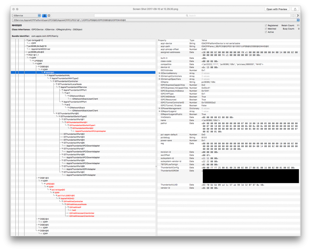

KNNSpeed Posted September 10, 2017 Share Posted September 10, 2017 Found something: 1575 DSL6340 Thunderbolt 3 NHI [Alpine Ridge 2C 2015] 1576 DSL6340 Thunderbolt 3 Bridge [Alpine Ridge 2C 2015] 1577 DSL6540 Thunderbolt 3 NHI [Alpine Ridge 4C 2015] 1578 DSL6540 Thunderbolt 3 Bridge [Alpine Ridge 4C 2015] We all have the DSL6340 (1575/1576 device ID), but I noticed in Apple's SSDT for MBP13,3 it's checking for 0x15788086. Perhaps the NHI driver is also looking for the 1578 NHI. It appears as though the primary issue is that IOThunderboltFamily is not loading onto the thunderbolt controller. This is something it should do even if a device is plugged in on boot (so until TBFP can be made reliable in Mac OS that's something to work on). Not sure what's preventing TBFP from working 100% in Mac OS. I can toggle it in Windows with AIDA64 just fine and it brings up the controller (TBFP (1)) or takes it down (TBFP (0)) no problem. Here's something similar to what it should look like (taken from rMBP 2013, which has TB2), if everything were working natively. 1 Link to comment https://www.insanelymac.com/forum/topic/319764-guide-dell-xps-15-9550-mojave-1014-1015-quick-installation/page/35/#findComment-2492398 Share on other sites More sharing options...
goodwin_c Posted September 10, 2017 Share Posted September 10, 2017 Found something: 1575 DSL6340 Thunderbolt 3 NHI [Alpine Ridge 2C 2015] 1576 DSL6340 Thunderbolt 3 Bridge [Alpine Ridge 2C 2015] 1577 DSL6540 Thunderbolt 3 NHI [Alpine Ridge 4C 2015] 1578 DSL6540 Thunderbolt 3 Bridge [Alpine Ridge 4C 2015] We all have the DSL6340 (1575/1576 device ID), but I noticed in Apple's SSDT for MBP13,3 it's checking for 0x15788086. Perhaps the NHI driver is also looking for the 1578 NHI. It appears as though the primary issue is that IOThunderboltFamily is not loading onto the thunderbolt controller. This is something it should do even if a device is plugged in on boot (so until TBFP can be made reliable in Mac OS that's something to work on). Not sure what's preventing TBFP from working 100% in Mac OS. I can toggle it in Windows with AIDA64 just fine and it brings up the controller (TBFP (1)) or takes it down (TBFP (0)) no problem. Here's something similar to what it should look like (taken from rMBP 2013, which has TB2), if everything were working natively. Could you post ioreg from rMBP with something connected to TB and output of kextstat (and one - after disconnecting TB device)? Also, the main problem may be that root node of pci device has thunderbolt attribute on rMBP - our doesn't have. And injecting it through _DSM is not working - i did try already. I think it is injected on real mac by efi TB driver - so, we can try to inject it with Clover. Also, key for working correct NHI interface may be in RTPC method in mac acpi Also, XRST, SXFP, TRPE methods of NHI0 in acpi are used - unfortunately, can't tell atm how important are they. 2 Link to comment https://www.insanelymac.com/forum/topic/319764-guide-dell-xps-15-9550-mojave-1014-1015-quick-installation/page/35/#findComment-2492446 Share on other sites More sharing options...
KNNSpeed Posted September 10, 2017 Share Posted September 10, 2017 Here you go. Do you mean injecting "PCI-Thunderbolt" = 1? Because that actually causes the device to show up in system profiler (PCI section) as "Thunderbolt@xxx" instead of "PCI Slot 1@xx," but breaks hotplug. I think there's a whole layer of complexity that's missing. Just these past couple days I found that the MBP 14,1 DSDT and SSDT (found in the 10.12.6 update) have a LOT of debug statements left in them, and they actually explain what's going on in the thunderbolt ACPI code. I'm thinking worst case we might need to just port the whole SSDT to our machines if we can't do it in any simpler way. There's also an NVRAM variable called "tbt-options," and for the Skylake and Kaby Lake MBP series it appears the value should be "4." Note: I tried adding RTPC, and it behaved like the rMBP (RTPC = true when nothing was plugged in, no RTPC value otherwise), but it didn't help with enumeration. I think we need to look at what TRPE is doing and see how to implement the same functions [RTPC, MUST, TRPE, SXFP, XRST] with the methods already available to us in Dell's DSDT--if we want to use the native TB drivers and stop relying on the ExpressCard hack. I noticed that the SGOV methods between Apple and Dell are actually the same (maybe an Intel thing?), and Apple added SGDO and GGDV, but I think for SXFP we might be able to just toggle TBFP instead. Update: And here's the MBP14,1 stuff attached. SXFP - Force Power (off, it seems) for SX (meaning S0, S3) TRPE - Thunderbolt root port enable? enumerate? MUST - related to USB/TB detection, specifically for determining whether a USB or TB device was attached XRST - some sort of reset event RTPC - related to when there's no USB or TB device attached The other ACPI names (like XRIN) that are in the NHI kext I know are for TB2 and TB1 machines. For our machines, I think the address supplied to SGOV is different; tracing TBFP gives the following: CGWR - Configuration write CGRD - Configuration read (from the TFPS method) // These come from memory (GNVS Global Non Volatile Storage (NVRAM)) // FPAT - force power activate?, per Windows = 1 // FPEN - force power enable, per Windows = 0 // FPGN - force power group number (?), per Windows = 0x01060010 // FPLV - force power level, per Windows = 1 EDIT: Some links: https://github.com/Dunedan/mbp-2016-linux/issues/24 https://www.spinics.net/lists/kernel/msg2525682.html https://developer.apple.com/library/content/documentation/HardwareDrivers/Conceptual/ThunderboltDevGuide/Introduction/Introduction.html#//apple_ref/doc/uid/TP40011138-CH1-SW1 rMBP2013_TB.zip MBP141.zip 2 Link to comment https://www.insanelymac.com/forum/topic/319764-guide-dell-xps-15-9550-mojave-1014-1015-quick-installation/page/35/#findComment-2492494 Share on other sites More sharing options...
goodwin_c Posted September 10, 2017 Share Posted September 10, 2017 Here you go. Do you mean injecting "PCI-Thunderbolt" = 1? Because that actually causes the device to show up in system profiler (PCI section) as "Thunderbolt@xxx" instead of "PCI Slot 1@xx," but breaks hotplug. I think there's a whole layer of complexity that's missing. Just these past couple days I found that the MBP 14,1 DSDT and SSDT (found in the 10.12.6 update) have a LOT of debug statements left in them, and they actually explain what's going on in the thunderbolt ACPI code. I'm thinking worst case we might need to just port the whole SSDT to our machines if we can't do it in any simpler way. There's also an NVRAM variable called "tbt-options," and for the Skylake and Kaby Lake MBP series it appears the value should be "4." Note: I tried adding RTPC, and it behaved like the rMBP (RTPC = true when nothing was plugged in, no RTPC value otherwise), but it didn't help with enumeration. I think we need to look at what TRPE is doing and see how to implement the same functions [RTPC, MUST, TRPE, SXFP, XRST] with the methods already available to us in Dell's DSDT--if we want to use the native TB drivers and stop relying on the ExpressCard hack. I noticed that the SGOV methods between Apple and Dell are actually the same (maybe an Intel thing?), and Apple added SGDO and GGDV, but I think for SXFP we might be able to just toggle TBFP instead. Update: And here's the MBP14,1 stuff attached. SXFP - Force Power (off, it seems) for SX (meaning S0, S3) TRPE - Thunderbolt root port enable? enumerate? MUST - related to USB/TB detection, specifically for determining whether a USB or TB device was attached XRST - some sort of reset event RTPC - related to when there's no USB or TB device attached The other ACPI names (like XRIN) that are in the NHI kext I know are for TB2 and TB1 machines. For our machines, I think the address supplied to SGOV is different; tracing TBFP gives the following: CGWR - Configuration write CGRD - Configuration read (from the TFPS method) // These come from memory (GNVS Global Non Volatile Storage (NVRAM)) // FPAT - force power activate?, per Windows = 1 // FPEN - force power enable, per Windows = 0 // FPGN - force power group number (?), per Windows = 0x01060010 // FPLV - force power level, per Windows = 1 EDIT: Some links: https://github.com/Dunedan/mbp-2016-linux/issues/24 https://www.spinics.net/lists/kernel/msg2525682.html https://developer.apple.com/library/content/documentation/HardwareDrivers/Conceptual/ThunderboltDevGuide/Introduction/Introduction.html#//apple_ref/doc/uid/TP40011138-CH1-SW1 I have acpi from 13,1, and looking on it - looks like detection of TB/USB mode is combination of RTPC, PCED/PCDA and UGIO methods and RUSB/RTBT + GNHI/GXCI attributes. And it is real mix how offten they are called Also, there is no MUST in mbp13,1 acpi - so it can be skipped. Link to comment https://www.insanelymac.com/forum/topic/319764-guide-dell-xps-15-9550-mojave-1014-1015-quick-installation/page/35/#findComment-2492503 Share on other sites More sharing options...
KNNSpeed Posted September 10, 2017 Share Posted September 10, 2017 Yeah--if you look at the 14,1 one, you'll see they left in a lot of "debug = " statements, and they explain what some of the 4-letter names are. It's as if someone left a bunch of debugging "printfs" in a C program. I don't think much at all changed between the 13,1 and 14,1 files except for that, and it looks like they removed some extra PCED and PCDA functions that weren't being used. You can see the differences with FileMerge. 3 Link to comment https://www.insanelymac.com/forum/topic/319764-guide-dell-xps-15-9550-mojave-1014-1015-quick-installation/page/35/#findComment-2492546 Share on other sites More sharing options...
goodwin_c Posted September 10, 2017 Share Posted September 10, 2017 Yeah--if you look at the 14,1 one, you'll see they left in a lot of "debug = " statements, and they explain what some of the 4-letter names are. It's as if someone left a bunch of debugging "printfs" in a C program. I don't think much at all changed between the 13,1 and 14,1 files except for that, and it looks like they removed some extra PCED and PCDA functions that weren't being used. You can see the differences with FileMerge. Yeah, this 14,1 acpi is really great peace, and really helpful to understand some parts of AAPL acpi code. As was supposed much earlier before - apple is using "manual" mode for TB - everything is controlled by driver and driver just triggers acpi methods - this is not Intel-way, as other vendors are doing much more automation in ACPI (look on our Dell acpi - TB is automated by _E42 event trigger that is called everytime you will plug-unplug something physical into port - and it is doing detection what kind of device was connected/was it USB/was it TB/etc.) 5 Link to comment https://www.insanelymac.com/forum/topic/319764-guide-dell-xps-15-9550-mojave-1014-1015-quick-installation/page/35/#findComment-2492557 Share on other sites More sharing options...
TheRacerMaster Posted September 10, 2017 Share Posted September 10, 2017 If it helps, I have attached a IOReg dump from a mid-2015 MacBook Pro 15" with an Thunderbolt Ethernet adapter plugged in. And speaking of debug statements... I've also attached the Thunderbolt SSDT from an unreleased Mac (AAPJ1371, iMac Pro maybe?) (debug firmware present from 10.13 DP1). It also has debug statements in the SSDT (e.g. you can see that the ICMB method is used to enable the Internal Connection Manager [used on PCs to handle Thunderbolt events in ACPI/SMM, and also enabled on 2015+ Macs in Windows]). MacBook Pro.ioreg.zip SSDT-TbtPEG23.aml.zip 1 Link to comment https://www.insanelymac.com/forum/topic/319764-guide-dell-xps-15-9550-mojave-1014-1015-quick-installation/page/35/#findComment-2492575 Share on other sites More sharing options...
goodwin_c Posted September 11, 2017 Share Posted September 11, 2017 Ok, now i have TB controller always-on on reboot, with NHI always populated, and with USB-C mode always on. Switch between TB-USB modes is broken - i was expecting this. Now i have to implement proper logic to provide macos information about current mode to have everything working. By the way - without "dirty" express-card hack i have TB permanently on with working hotplug for USB - having Dell TB15 connected i can connect-disconnect it and always have proper working DP monitor (it is not going through pci-e lines as thunderbolt has separate line for DisplayPort connectivity). So we have 50% road finished By the way, maybe it will be useful for somebody else - by design, all systems with TB host chip on-board, always have ability to force-power tb-controller. And this ability is done by WMI instruments in ACPI. There is always method in ACPI code with ID as "86CCFD48-205E-4A77-9C48-2021CBEDE341" that runs proper procedures for turning on and off TB. For ex., in our ACPI this is method "WMTF" and this is identification part of it: Name (_HID, "PNP0C14") // _HID: Hardware ID Name (_UID, "TBFP") // _UID: Unique ID Name (_WDG, Buffer (0x14) { /* 0000 */ 0x48, 0xFD, 0xCC, 0x86, 0x5E, 0x20, 0x77, 0x4A, /* 0008 */ 0x9C, 0x48, 0x20, 0x21, 0xCB, 0xED, 0xE3, 0x41, /* 0010 */ 0x54, 0x46, 0x01, 0x02 }) So you can se in _WDG same ID as i have wrote here. 4 Link to comment https://www.insanelymac.com/forum/topic/319764-guide-dell-xps-15-9550-mojave-1014-1015-quick-installation/page/35/#findComment-2492650 Share on other sites More sharing options...
