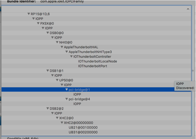

goodwin_c Posted September 12, 2017 Share Posted September 12, 2017 This is my current state - looks like almost fine - only final child nodes in DSB1 are missing 4 Link to comment https://www.insanelymac.com/forum/topic/319764-guide-dell-xps-15-9550-mojave-1014-1015-quick-installation/page/36/#findComment-2493035 Share on other sites More sharing options...
KNNSpeed Posted September 13, 2017 Share Posted September 13, 2017 What do you mean by "final child nodes"? Anything deeper on the DSB1 chain is the actual device that gets plugged in (DEV0@0). Link to comment https://www.insanelymac.com/forum/topic/319764-guide-dell-xps-15-9550-mojave-1014-1015-quick-installation/page/36/#findComment-2493545 Share on other sites More sharing options...

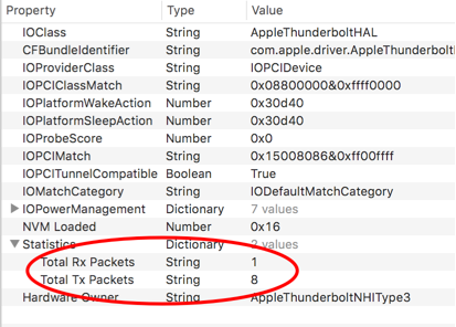

goodwin_c Posted September 14, 2017 Share Posted September 14, 2017 What do you mean by "final child nodes"? Anything deeper on the DSB1 chain is the actual device that gets plugged in (DEV0@0). Sorry, I didn't realize at moment of this post real situation. And real situation is that macos is not initalizing TB at all - i'm still not sure about exact reasons but i have some ideas. Frist of all, problem is somewhere around NHI - maybe, interface itself or just small part inside called ICM (Connection Manager). So things are not initialized properly or just macos doesn't like them - still not sure. Trying to find some answers at the moment. What i'm sure - we have to understand and provide correct ThunderboltConfig and ThunderboltDROM device properties - they are used to build all communication with NHI (on windows/linux this things are done by driver in OS, but in mac EFI tb driver is exporting information about thunderbolt structure/configuration as device properties - what an odd solution) 2 Link to comment https://www.insanelymac.com/forum/topic/319764-guide-dell-xps-15-9550-mojave-1014-1015-quick-installation/page/36/#findComment-2493958 Share on other sites More sharing options...
KNNSpeed Posted September 14, 2017 Share Posted September 14, 2017 Thunderbolt is supposed to be a driverless spec, i.e. The pcie configuration is meant to be handled by firmware rather than OS. Unfortunately the spec is still closed (until some time next year), but your findings do actually make sense. Perhaps there's a thinderbolt-related .efi file in the firmware? (We already know there's an NVRAM variable "tbt-options" that takes a value of "4" on MBP13,3 and 14,3.) The more I think about it the more I also think TRPE is the key function when it comes to enumeration since it checks AVND (device vendor id). At the same time I noticed your screenshot was still missing the children of IOThunderboltPort@5. I believe it is related to the IOThunderboltFamily kext--I know the NVRAM option is. 1 Link to comment https://www.insanelymac.com/forum/topic/319764-guide-dell-xps-15-9550-mojave-1014-1015-quick-installation/page/36/#findComment-2493973 Share on other sites More sharing options...

KNNSpeed Posted September 16, 2017 Share Posted September 16, 2017 Yes, Port@5 is missing as NHI switch is not properly recognized/poplated. Also, looking on IOService properties - i see that NHI has TX count 0x8 and RX count 0x0 - that most probably indicates that command interchange with ICM is not working as expected. At the moment i'm checking different options starting from rMBP acpi to sources of Linux TB driver - to understand where problem may occur. But IOThunderBoldFamily is giving zero messages into logs - os it is very hard to understand at least something. By the way - you have XPS 9560, and as i remember - latest NVM for it's TB is 21. Do you have Windows installed? Can you run HWInfo, find thunderbolt pcie line, expand all children nodes and make screenshot? Or at least tell what NHI and DSB0-DSB3 nodes in macos has device/vendor id's. I want to try to update TB firmware on my 9550 with one from 9560 - if they have same TB controller. hope i'll not break it Yes, the latest NVM is 21. Here's a screenshot folder of all the stuff in HWInfo. Note the "Cactus Ridge" controller is just the TB3-to-TB2 adapter (I believe it's also the "pci-bridge@0" under IOPP under UPS0@0 under DSB1@3 in my rMBP screenshot posted last page, which should just be where DEV0@0 is for that DSB node). TB_Tree_Windows.zip Link to comment https://www.insanelymac.com/forum/topic/319764-guide-dell-xps-15-9550-mojave-1014-1015-quick-installation/page/36/#findComment-2495153 Share on other sites More sharing options...
