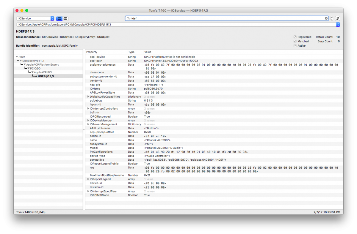

loppol Posted February 7, 2017 Share Posted February 7, 2017 HI tluck, I'm wondering how did you make the HDMI audio work? since I have a similar laptop(X1 yoga), I checked your file, it seems you follow the similar procedure as toleda's HD5x0 guide. I followed similar procedures: on clover config: rename GFX0 TO IGPU rename HECI TO IMEI add one kext to patch for HDMi from your config add 2 ssdt patch file: modified your hdef file copied your igpu file I don't know why once I used modified version of HDEF ssdt and set audio inject to empty string on clover, my aduio icon is dimmed and of course there's no corresponding change on ioReg when I looked at property for 'HDEF' thanks in advance! Link to comment https://www.insanelymac.com/forum/topic/315451-guide-lenovo-t460t470-macos-with-clover-and-opencore/page/10/#findComment-2364369 Share on other sites More sharing options...
tluck Posted February 7, 2017 Author Share Posted February 7, 2017 @loppol - the other key factor is the kext - AppleHDA (or AppleALC.kext) layout file. I added a property in there. 1 Link to comment https://www.insanelymac.com/forum/topic/315451-guide-lenovo-t460t470-macos-with-clover-and-opencore/page/10/#findComment-2364480 Share on other sites More sharing options...
loppol Posted February 8, 2017 Share Posted February 8, 2017 @loppol - the other key factor is the kext - AppleHDA (or AppleALC.kext) layout file. I added a property in there. Hi tluck, thanks for the hint and I assume you means this post http://www.insanelymac.com/forum/topic/319211-guide-fix-skylake-hdmidp-output/ After I added the property in the layout file and it shows 'HDMI output' on sys report/audio, I still can't get the audio work, my problem probably is that no codec of HDMI is detected could you show me your status of DPCIManger as well as the output HDEF result on IOReg? thanks! Link to comment https://www.insanelymac.com/forum/topic/315451-guide-lenovo-t460t470-macos-with-clover-and-opencore/page/10/#findComment-2364546 Share on other sites More sharing options...

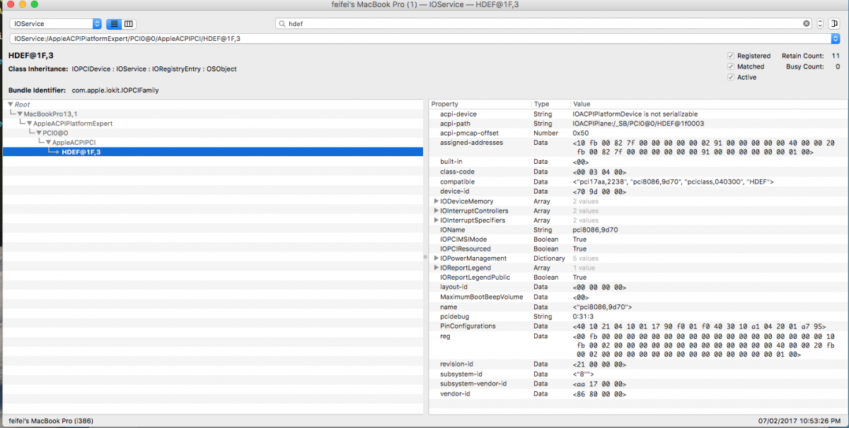

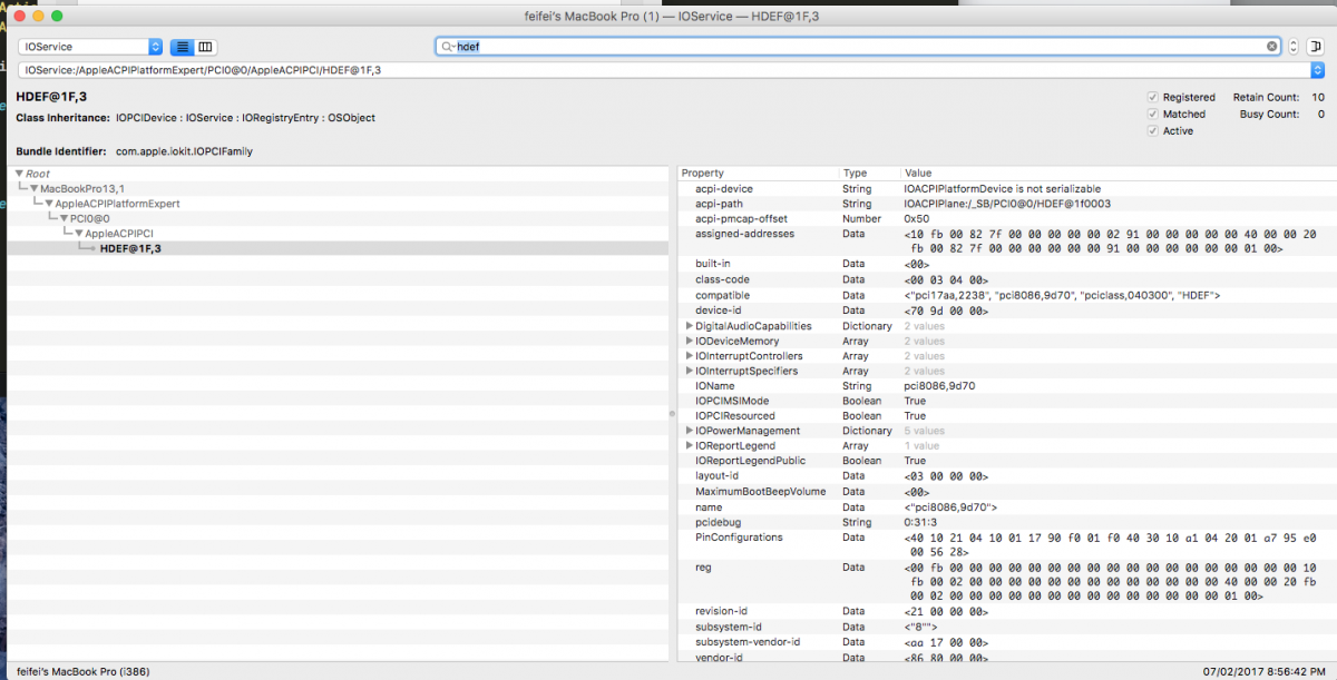

tluck Posted February 8, 2017 Author Share Posted February 8, 2017 so you have a working AppleHDA kext? and you seem to not have SDDT-HDEF as there are some properties missing my HDEF in IOREG Link to comment https://www.insanelymac.com/forum/topic/315451-guide-lenovo-t460t470-macos-with-clover-and-opencore/page/10/#findComment-2364566 Share on other sites More sharing options...
loppol Posted February 8, 2017 Share Posted February 8, 2017 so you have a working AppleHDA kext? and you seem to not have SDDT-HDEF as there are some properties missing my HDEF in IOREG Screen Shot 2017-02-07 at 10.26.58 PM.png this is where I don't know why, I have a working aDummyHda.kext if I inject layout ID to 3 in clover config, which is what the above pic showed (which shows correct layout id:3, and missing some other properies) but If I set audio inject to empty in clover config and include SSDT-HDEF, It gets even worse and seems the SSDT-HDEF doesn't work. I checked boot log which shows SSDT-HDEF is patched successfully: 7:834 0:000 === [ ACPIPatchedAML ] ==================================== 7:834 0:000 Start: Processing Patched AML(s): Sorted 7:834 0:000 Inserting table[0]:SSDT.aml from EFI\CLOVER\ACPI\patched ... Success 7:834 0:000 Inserting table[1]:SSDT-0.aml from EFI\CLOVER\ACPI\patched ... Success 7:835 0:000 Inserting table[2]:SSDT-1.aml from EFI\CLOVER\ACPI\patched ... Success 7:835 0:000 Inserting table[3]:SSDT-2.aml from EFI\CLOVER\ACPI\patched ... Success 7:835 0:000 Inserting table[4]:SSDT-3.aml from EFI\CLOVER\ACPI\patched ... Success 7:835 0:000 Inserting table[5]:SSDT-4.aml from EFI\CLOVER\ACPI\patched ... Success 7:836 0:000 Inserting table[6]:SSDT-12.aml from EFI\CLOVER\ACPI\patched ... Success 7:836 0:000 Inserting table[7]:SSDT-UIAC-AL.aml from EFI\CLOVER\ACPI\patched ... Success 7:836 0:000 Inserting table[8]:SSDT-NVMe.aml from EFI\CLOVER\ACPI\patched ... Success 7:836 0:000 Inserting table[9]:SSDT-XOSI.aml from EFI\CLOVER\ACPI\patched ... Success 7:836 0:000 Inserting table[10]:SSDT-IGPU-T460.aml from EFI\CLOVER\ACPI\patched ... Success 7:837 0:000 Inserting table[11]:SSDT-HDEF-T460.aml from EFI\CLOVER\ACPI\patched ... Success here is my ioreg on this situation(which shows layoutid=0 so that audio icon is dimmed...): here is what I edited based on your SSDT-HDEF file DefinitionBlock ("", "SSDT", 2, "T460", "HDEF", 0x00000000) { External (_SB_.PCI0.HDEF, DeviceObj) // (from opcode) Method (\_SB.PCI0.HDEF._DSM, 4, NotSerialized) // _DSM: Device-Specific Method { If (LNot (Arg2)) { Return (Buffer (One) { 0x03 }) } Return (Package (0x14) { "AAPL,slot-name", Buffer (0x09) { "Built in" }, "layout-id", Buffer (0x04) { 0x03, 0x00, 0x00, 0x00 }, "codec-id", Buffer (0x04) { 0x11, 0x51, 0xF1, 0x14 }, "model", Buffer (0x18) { "Conexant 20753 HD Audio" }, "name", Buffer (0x0F) { "Conexant 20753" }, "device_type", Buffer (0x11) { "Audio Controller" }, "built-in", Buffer (One) { 0x00 }, "PinConfigurations", Buffer (Zero) {}, "hda-gfx", Buffer (0x0A) { "onboard-1" }, "MaximumBootBeepVolume", 0x2F }) } } What I'm thinking is that probably I mixed up with some config settings so that clover override the HDEF related property? here is my config file, if you have time, could you please take a look? config copy.plist.zip thanks! Link to comment https://www.insanelymac.com/forum/topic/315451-guide-lenovo-t460t470-macos-with-clover-and-opencore/page/10/#findComment-2364567 Share on other sites More sharing options...
loppol Posted February 8, 2017 Share Posted February 8, 2017 Hi tluck, I finally get the hdmi audio working, I checked my original DSDT, there's one special non-trivial line of code ADBG ("HDAS _DSM") inside the _DSM method under the HDEF scope. I tried to use a separate ssdt by adding ADGB method(it's a method from the root of dsdt), but is failed to inject on ioreg so that I have to do it in dsdt and I also disable the patch of ‘change _DSM to XDSM’,then issue is sloved! by the way, for all the scripts from your root folder, did you make any special/ particular hack only for T460, if not, do you think I can steal them directly for my x1 yoga? thanks for your help! Link to comment https://www.insanelymac.com/forum/topic/315451-guide-lenovo-t460t470-macos-with-clover-and-opencore/page/10/#findComment-2364587 Share on other sites More sharing options...

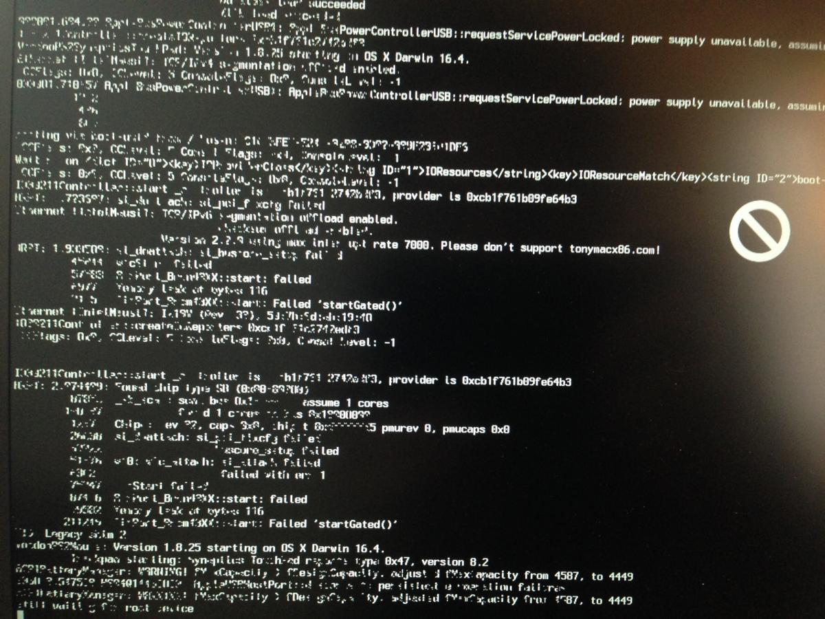

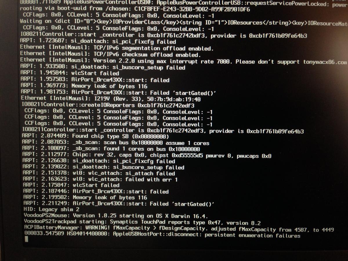

Espamac Posted February 25, 2017 Share Posted February 25, 2017 Hi there, I just got a T460s, I've been using a X220 thanks to @tluck great guide on the other post. I'm stuck with a recurrent KP at the beginning of the installation. I'm posting a couple of pictures. My specs are 192GB m2 NVMe SATA SSD, 12GB RAM and 1920x1080 non-touch display. Injecting Fake graphics DeviceID doesn't change a thing. Any idea? Thank you! EDIT: Maybe it has something to do with the NVMe SSD drive, I'm looking at this thread http://www.insanelymac.com/forum/topic/312803-patch-for-using-nvme-under-macos-sierra-is-ready/?p=2322636 It looks daunting though... @thedeliveryboy did you had any problems on the initial installation on your T460s? EDIT 2: My drive is SATA still checking for solutions... Link to comment https://www.insanelymac.com/forum/topic/315451-guide-lenovo-t460t470-macos-with-clover-and-opencore/page/10/#findComment-2373200 Share on other sites More sharing options...
tluck Posted February 26, 2017 Author Share Posted February 26, 2017 @espamac - what is the KP? is it SkylakeFramebuffer or something else? did you check Inject Graphics and change the ID to 0x12345678? perhaps take your T420 drive - clone it. then patch the graphics with the manual patch script. Link to comment https://www.insanelymac.com/forum/topic/315451-guide-lenovo-t460t470-macos-with-clover-and-opencore/page/10/#findComment-2373737 Share on other sites More sharing options...
Espamac Posted February 26, 2017 Share Posted February 26, 2017 @tluck - After clover loads I go to Options -> Graphics Injector -> InjectIntel FakeID:0x12345678 After the installer boots in verbose I always get stuck in the same line (1st image posted above): 000033.547509 HS04@14400000: AppleUSBHostPort : :disconnect: persistent enumeration failures After 10 seconds the screen gets glitchy (2nd image posted). It actually seems to be doing something (jumps from time to time) but I can't read clearly what is says, it looks like it keeps writing "still waiting for root device". The USB installation drive is blinking all the time. I'm doing a clean install using your package. I'll start from scratch again just in case there's something wrong with the USB installer. Just for clarification after I execute sudo mount -t msdos /dev/disk1s1 /Volumes/ESP-USB Can I simply drag an drop the EFI folder from T460-distribute? (that's how I've been doing it until now) Thanks a lot for your time. Link to comment https://www.insanelymac.com/forum/topic/315451-guide-lenovo-t460t470-macos-with-clover-and-opencore/page/10/#findComment-2373746 Share on other sites More sharing options...
tluck Posted February 26, 2017 Author Share Posted February 26, 2017 (edited) @Espamac - check the box to Inject GFX AND change FakeID=0x12345678 on the USB installer. sure you can use cp or drag-n-drop to copy the zip EFI to the USB... but you have a T460s - you probably need to change your ACPI (DSDT/SSDT) to match your box. the zip contains T460 ACPI - and the scripts to make the custom DSDT. not sure if you did that? I just update the guide to help with creating your own patched DSDT file. Edited February 26, 2017 by tluck Link to comment https://www.insanelymac.com/forum/topic/315451-guide-lenovo-t460t470-macos-with-clover-and-opencore/page/10/#findComment-2374134 Share on other sites More sharing options...
