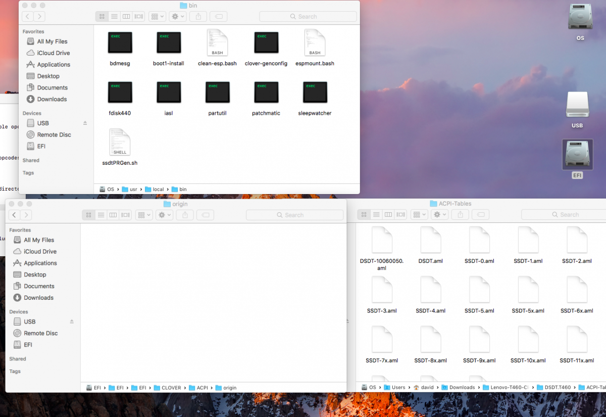

czech99 Posted May 30, 2017 Share Posted May 30, 2017 ordered the tp link usb dongle for wifi. now if I can still get some assistance trying to figure out what I'm doing wrong or what I'm not doing to get this laptop to boot up into Sierra w/o the use of the USB drive that would be greatly appreciated! edit* so in the root of my drive I have an EFI folder if I open that I have a BOOT and Clover folder. Inside of Clover are a bunch of folders, if I open ACPI I have Origin, patched, Windows. All which are empty. Is that my problem? Should there be something inside of those folders in order for my laptop to boot of the hard drive? Link to comment https://www.insanelymac.com/forum/topic/315451-guide-lenovo-t460t470-macos-with-clover-and-opencore/page/15/#findComment-2432889 Share on other sites More sharing options...
tluck Posted May 30, 2017 Author Share Posted May 30, 2017 @czech99 well presuming your HD is GPT formatted (which means it has a hidden partition), you would have to mount the disk0s1 partition and copy the EFI folders there - just like you did for the USB? there is tool in the zip - espmount.bash - if you run that on the command line ./espmount.bash 0 - then it will mount your disk0 (system disk) ESP @buoncri95 - i seem to get 3-4 hours? the energy tab crash is a know conflict between ACPIBatteryManager and Activity Monitor that crept in around 12.3 or 12.4 - i don't know of a fix. Link to comment https://www.insanelymac.com/forum/topic/315451-guide-lenovo-t460t470-macos-with-clover-and-opencore/page/15/#findComment-2432909 Share on other sites More sharing options...
czech99 Posted May 30, 2017 Share Posted May 30, 2017 @czech99 well presuming your HD is GPT formatted (which means it has a hidden partition), you would have to mount the disk0s1 partition and copy the EFI folders there - just like you did for the USB? there is tool in the zip - espmount.bash - if you run that on the command line ./espmount.bash 0 - then it will mount your disk0 (system disk) ESP @buoncri95 - i seem to get 3-4 hours? the energy tab crash is a know conflict between ACPIBatteryManager and Activity Monitor that crept in around 12.3 or 12.4 - i don't know of a fix. wonderful, i will try that shortly, i did follow your instructions on mounting the efi volume (which it does have) if i do a diskutil list in terminal i see that it has a 200mb hidden partition. I never ran the ./espmount.bash 0 though. Do i need to redo my acpi files since everything works fine? or will it use yours that seem to be working Link to comment https://www.insanelymac.com/forum/topic/315451-guide-lenovo-t460t470-macos-with-clover-and-opencore/page/15/#findComment-2432912 Share on other sites More sharing options...
czech99 Posted May 30, 2017 Share Posted May 30, 2017 So no luck still Here's what I have and what I've typed... maybe you can see a step I'm missing? here's everything from my terminal Terminal Output Davids-MacBook-Pro:utilities david$ /usr/local/bin/espmount.bash 0/Volumes/ESPDavids-MacBook-Pro:utilities david$ cd ~/downloads/lenovo-t460-clover-2017.05.24/dsdt.t460Davids-MacBook-Pro:dsdt.t460 david$ ./create_patched_dsdt.commandde-compiling ACPI tablesIntel ACPI Component ArchitectureASL+ Optimizing Compiler version 20160422-64(RM)Copyright © 2000 - 2016 Intel CorporationInput file SSDT-0.aml, Length 0x3A2 (930) bytesACPI: SSDT 0x0000000000000000 0003A2 (v02 LENOVO TcgTable 00001000 INTL 20141107)External object resolution file DSDT.amlInput file DSDT.aml, Length 0x125B5 (75189) bytesACPI: DSDT 0x0000000000000000 0125B5 (v02 LENOVO TP-R06 00001230 INTL 20141107)Pass 1 parse of [DSDT]Pass 2 parse of [DSDT]External object resolution file SSDT-9x.amlInput file SSDT-9x.aml, Length 0x119 (281) bytesACPI: SSDT 0x0000000000000000 000119 (v02 PmRef ApCst 00003000 INTL 20141107)Pass 1 parse of [sSDT]Pass 2 parse of [sSDT]External object resolution file SSDT-8x.amlInput file SSDT-8x.aml, Length 0x3CF (975) bytesACPI: SSDT 0x0000000000000000 0003CF (v02 PmRef Cpu0Cst 00003001 INTL 20141107)Pass 1 parse of [sSDT]Pass 2 parse of [sSDT]External object resolution file SSDT-7x.amlInput file SSDT-7x.aml, Length 0x5AA (1450) bytesACPI: SSDT 0x0000000000000000 0005AA (v02 PmRef ApIst 00003000 INTL 20141107)Pass 1 parse of [sSDT]Pass 2 parse of [sSDT]External object resolution file SSDT-6x.amlInput file SSDT-6x.aml, Length 0x6AC (1708) bytesACPI: SSDT 0x0000000000000000 0006AC (v02 PmRef Cpu0Ist 00003000 INTL 20141107)Pass 1 parse of [sSDT]Pass 2 parse of [sSDT]External object resolution file SSDT-5x.amlInput file SSDT-5x.aml, Length 0x6AC (1708) bytesACPI: SSDT 0x0000000000000000 0006AC (v02 PmRef Cpu0Ist 00003000 INTL 20141107)Pass 1 parse of [sSDT]ACPI Error: [_PPC] Namespace lookup failure, AE_ALREADY_EXISTS (20160422/dswload-462)ACPI Exception: AE_ALREADY_EXISTS, During name lookup/catalog (20160422/psobject-310)Could not parse external ACPI tables, AE_ALREADY_EXISTSDavids-MacBook-Pro:dsdt.t460 david$ ./install_acpi_to_esp.command/Volumes/ESPIntel ACPI Component ArchitectureASL+ Optimizing Compiler version 20160422-64(RM)Copyright © 2000 - 2016 Intel CorporationASL Input: SSDT-ARPT-T460.dsl - 23 lines, 709 bytes, 5 keywordsAML Output: SSDT-ARPT-T460.aml - 260 bytes, 1 named objects, 4 executable opcodesCompilation complete. 0 Errors, 0 Warnings, 0 Remarks, 1 OptimizationsASL Input: SSDT-CPU.dsl - 27 lines, 640 bytes, 7 keywordsAML Output: SSDT-CPU.aml - 137 bytes, 2 named objects, 5 executable opcodesCompilation complete. 0 Errors, 0 Warnings, 0 Remarks, 0 OptimizationsASL Input: SSDT-HACK-T460.dsl - 33 lines, 773 bytes, 12 keywordsAML Output: SSDT-HACK-T460.aml - 160 bytes, 2 named objects, 10 executable opcodesCompilation complete. 0 Errors, 1 Warnings, 0 Remarks, 0 OptimizationsASL Input: SSDT-HDEF-T460.dsl - 30 lines, 900 bytes, 5 keywordsAML Output: SSDT-HDEF-T460.aml - 338 bytes, 1 named objects, 4 executable opcodesCompilation complete. 0 Errors, 0 Warnings, 1 Remarks, 3 OptimizationsASL Input: SSDT-IGPU-T460.dsl - 102 lines, 2650 bytes, 20 keywordsAML Output: SSDT-IGPU-T460.aml - 418 bytes, 5 named objects, 15 executable opcodesCompilation complete. 0 Errors, 0 Warnings, 1 Remarks, 1 OptimizationsASL Input: SSDT-LPC-T460.dsl - 19 lines, 346 bytes, 5 keywordsAML Output: SSDT-LPC-T460.aml - 119 bytes, 1 named objects, 4 executable opcodesCompilation complete. 0 Errors, 0 Warnings, 0 Remarks, 1 OptimizationsASL Input: SSDT-PNLF-T460.dsl - 17 lines, 314 bytes, 6 keywordsAML Output: SSDT-PNLF-T460.aml - 94 bytes, 6 named objects, 0 executable opcodesCompilation complete. 0 Errors, 0 Warnings, 0 Remarks, 0 OptimizationsASL Input: SSDT-PS2K-T460.dsl - 26 lines, 550 bytes, 6 keywordsAML Output: SSDT-PS2K-T460.aml - 176 bytes, 2 named objects, 4 executable opcodesCompilation complete. 0 Errors, 0 Warnings, 0 Remarks, 1 OptimizationsASL Input: SSDT-SMBUS-T460.dsl - 23 lines, 460 bytes, 11 keywordsAML Output: SSDT-SMBUS-T460.aml - 139 bytes, 7 named objects, 4 executable opcodesCompilation complete. 0 Errors, 0 Warnings, 0 Remarks, 1 OptimizationsASL Input: SSDT-XHC-T460.dsl - 135 lines, 4923 bytes, 9 keywordsAML Output: SSDT-XHC-T460.aml - 819 bytes, 4 named objects, 5 executable opcodesCompilation complete. 0 Errors, 0 Warnings, 0 Remarks, 1 OptimizationsASL Input: SSDT-XOSI.dsl - 34 lines, 1450 bytes, 5 keywordsAML Output: SSDT-XOSI.aml - 164 bytes, 1 named objects, 4 executable opcodesCompilation complete. 0 Errors, 0 Warnings, 0 Remarks, 2 Optimizationsrm: /Volumes/ESP/EFI/CLOVER/ACPI/patched/*: No such file or directoryusage: cp [-R [-H | -L | -P]] [-fi | -n] [-apvX] source_file target_filecp [-R [-H | -L | -P]] [-fi | -n] [-apvX] source_file ... target_directoryDavids-MacBook-Pro:dsdt.t460 david$[Restored May 30, 2017, 11:36:53 AM]Last login: Tue May 30 11:36:50 on consoleRestored session: Tue May 30 11:34:15 PDT 2017Davids-MacBook-Pro:dsdt.t460 david$ sudo mkdir /Volumes/ESPPassword:Davids-MacBook-Pro:dsdt.t460 david$ sudo mount -t msdos /dev/disk0s1 /Volumes/ESPDavids-MacBook-Pro:dsdt.t460 david$ Link to comment https://www.insanelymac.com/forum/topic/315451-guide-lenovo-t460t470-macos-with-clover-and-opencore/page/15/#findComment-2432955 Share on other sites More sharing options...
tluck Posted May 30, 2017 Author Share Posted May 30, 2017 Go to guide follow part 2 post install Focus on step 4 Link to comment https://www.insanelymac.com/forum/topic/315451-guide-lenovo-t460t470-macos-with-clover-and-opencore/page/15/#findComment-2432984 Share on other sites More sharing options...
czech99 Posted May 30, 2017 Share Posted May 30, 2017 ok I got it now! I found my issue. When I copied the efi folder to the hd's efi partition I made an extra EFI folder it was essentially EFI > EFI > BOOT, CLOVER, APPLE instead of EFI > BOOT, CLOVER, APPLE I realized it when I compared the folder structure of my USB vs HD EFI volume Link to comment https://www.insanelymac.com/forum/topic/315451-guide-lenovo-t460t470-macos-with-clover-and-opencore/page/15/#findComment-2432987 Share on other sites More sharing options...
