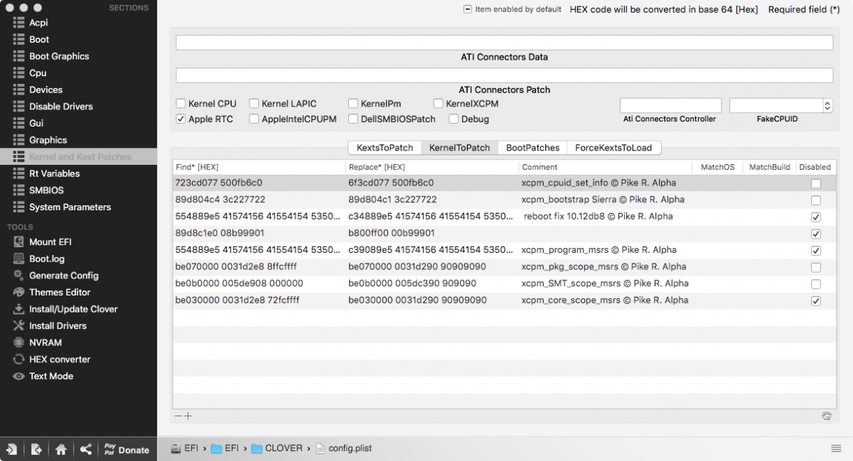

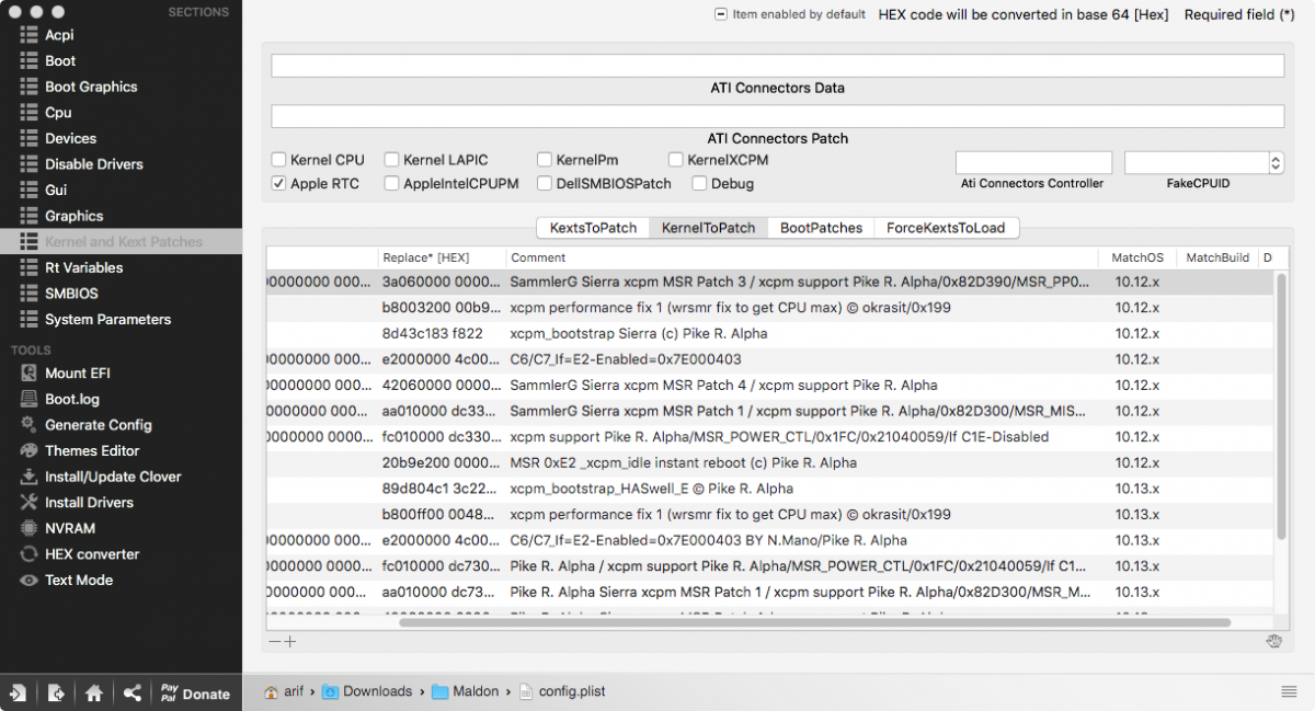

@Mald0n With ssrdt Patched SSDT and without it, I can't see a difference, should I remove SSDT ?

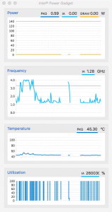

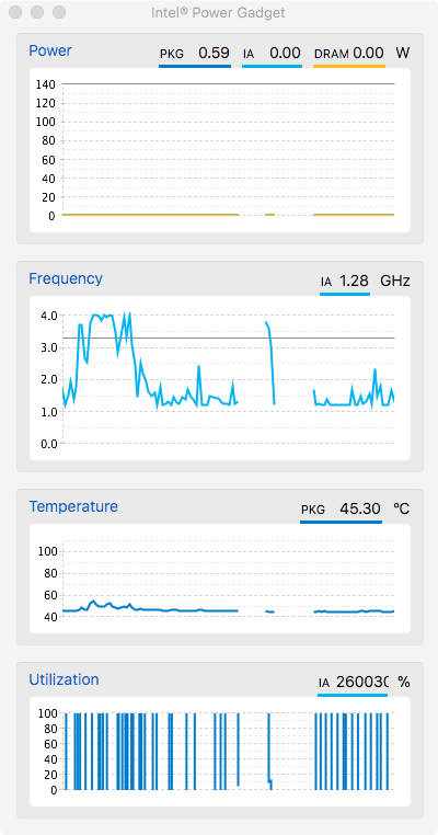

And, something strange with Intel Power Gadget - I meant the Utilization percentage
K,C-3 is back now, "xcpm_program_msrs" and "xcpm_core_scope_msrs" KernelToPatch entries seem to disable C3 states!

Single-Core Score 24191   Multi-Core Score 4720
Using your kernel patches from the Clover folder, I have better performance, it scales up quickly in demand but still no sleep  :( .  I patched my USB ports too with proper power properties like real mac by injecting only active ports, so no more need of port limit patch

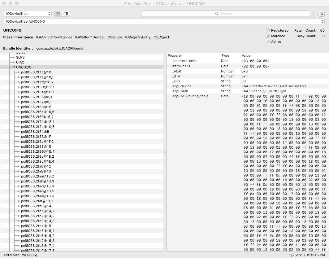

And you know what, I have a Corsair H100i Liquid Cooler and it is known to cause Sleep issue but I have disabled this internal usb by patching SSDT and removing the port which was at HS11 for me and surprisingly, it is still not working for me.
Update: I removed the Corsair usb header from motherboard to check but still no sleep.
Edited by adamshahcatalys
@MalD0n I figured it out, it was waking up from USB. To test, I removed all the devices and put it to Sleep and hallelujah !!!
Coming back to permanent fix it for , how to disable Wake from USB, by editing DSDT ? something like removing
Method (_PRW)
in DSDT ?
But doing so, I will have to wake it up from Power button only ? Is it what we have to compromise being on Hackintosh ?
Can't there be a harmony here ?
@Mald0n, can you share your Geekbench Score ? I am a little obsessed with @nmano benchmark's multicore score. And, I am starting to think that my xnu is not working as expected.
Any user with 5820K processor are encouraged to share their Geekbench score.
