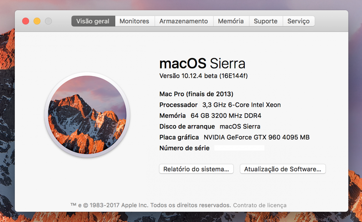

Fergarth Posted January 29, 2017 Share Posted January 29, 2017 Update from 12.3 Final to 12.4 Beta (16E144f)I lost the onboard sound on the ALC1150, but I'm still not sure if it was the OS or the Clover update for v3.2k_r3994, which changed the ALC patches, erasing the AppleHDAControler patch. (I'm studying the case)The Nvidia Web Driver, editing NVDAStartup.kext form 16D to 16E, recognizes the graphics card and allows some resolutions (not all), but without full acceleration.Bluetooth, WiFi and USB's remained ok.XPCM and speedsteps have stopped working and I think it requires new patches... but as I said above, I am studying the case! Link to comment https://www.insanelymac.com/forum/topic/313296-guide-mac-osx-1012-and-1013-with-x99-broadwell-e-family-and-haswell-e-family/page/38/#findComment-2359328 Share on other sites More sharing options...
thenightflyer Posted January 29, 2017 Share Posted January 29, 2017 Update from 12.3 Final to 12.4 Beta (16E144f) I lost the onboard sound on the ALC1150, but I'm still not sure if it was the OS or the Clover update for v3.2k_r3994, which changed the ALC patches, erasing the AppleHDAControler patch. (I'm studying the case) The Nvidia Web Driver, editing NVDAStartup.kext form 16D to 16E, recognizes the graphics card and allows some resolutions (not all), but without full acceleration. Bluetooth, WiFi and USB's remained ok. XPCM and speedsteps have stopped working and I think it requires new patches... but as I said above, I am studying the case! You are in advance mate Now we should solve patch problems with 10.12.3...then it will be time to think about 10.12.4 final..... Link to comment https://www.insanelymac.com/forum/topic/313296-guide-mac-osx-1012-and-1013-with-x99-broadwell-e-family-and-haswell-e-family/page/38/#findComment-2359358 Share on other sites More sharing options...

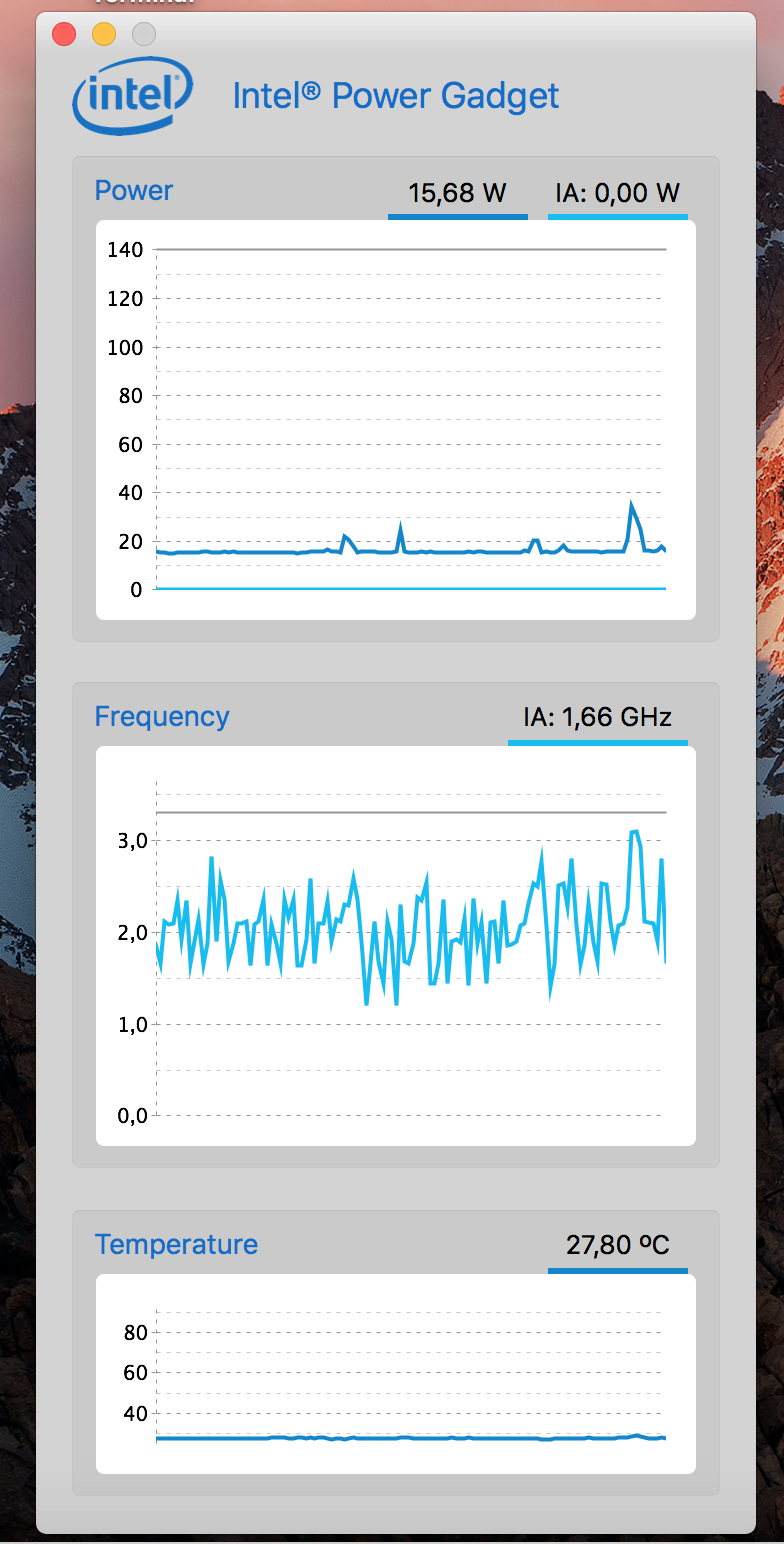

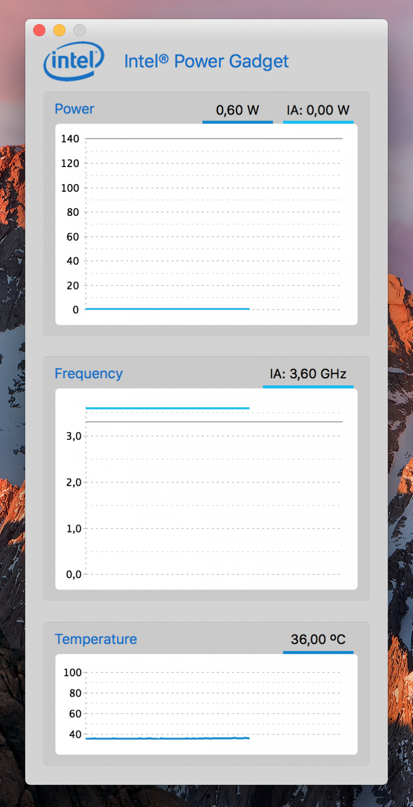

Fergarth Posted January 30, 2017 Share Posted January 30, 2017 Hello everyone For information, with 10.12.3 not needs anymore patches for the kernel I just confirmed this! It works perfectly for me too! In 12.2 and 12.3 (including all betas) I did not have any problems, but now in 12.4 with the latest Clover I was without XCPM. I turned all XCPM Patchs off and everything went back to normal. XCPM working Speedsteps working Freq.Vectors Loaded Everything Loaded EIST Disabled (but if Enabled, apparently works the same) Each time my EFI is thinner and my Plist cleaner, as I like it! Tanks Fljagd EDIT: Do not mind this, it was due to a recent Clover bug (activaded / desactivated) were reverted. Link to comment https://www.insanelymac.com/forum/topic/313296-guide-mac-osx-1012-and-1013-with-x99-broadwell-e-family-and-haswell-e-family/page/38/#findComment-2359841 Share on other sites More sharing options...
mfc88 Posted January 30, 2017 Share Posted January 30, 2017 I just confirmed this! It works perfectly for me too! In 12.2 and 12.3 (including all betas) I did not have any problems, but now in 12.4 with the latest Clover I was without XCPM. I turned all XCPM Patchs off and everything went back to normal. XCPM working Speedsteps working Freq.Vectors Loaded Everything Loaded EIST Disabled (but if Enabled, apparently works the same) Each time my EFI is thinner and my Plist cleaner, as I like it! Tanks Fljagd Must be native support for 5820k? Are you still loading Pike's SSDT? Curious if anyone else has success with their processor (other than a 5820k)... On that note, did a refresh install of 10.12.3 (required some tweaking): ✓ Audio over HDMI/DP ✓ Bluetooth ✓ CPU Power Management/Stepping ✓ Ethernet ✓ GPU recognition/usage ✓ NVMe recognition and R/W/E permissions (updated SSDT NVMe to 10.12.3) ✓ Sleep ✓ USB 2.0, 3.0, 3.1 recognition/usage ✓ WIFI 2.4ghz/5ghz Still not sure if it's 100% stable... will continue to test. 1 Link to comment https://www.insanelymac.com/forum/topic/313296-guide-mac-osx-1012-and-1013-with-x99-broadwell-e-family-and-haswell-e-family/page/38/#findComment-2359848 Share on other sites More sharing options...

Fergarth Posted January 30, 2017 Share Posted January 30, 2017 As I said I am with the last Clover r3994 and in fact, everything worked again as soon as I deactivated all xcpm patches. Although the patches are disabled, now I will delete them from the plist and test to see how it behaves Link to comment https://www.insanelymac.com/forum/topic/313296-guide-mac-osx-1012-and-1013-with-x99-broadwell-e-family-and-haswell-e-family/page/38/#findComment-2359965 Share on other sites More sharing options...

Fergarth Posted January 30, 2017 Share Posted January 30, 2017 I just tested and confirmed that it is a Clover bug. As I mentioned before, with 12.2 and 12.3 and with the previous Clover I had no stress. I started having it from the moment I updated to 12.4 and upgraded to the Clover r3994, since the previous version of Clover did not finish the boot in 12.4 And the result was this: With all xcpm patchs enabled in Plist - Cpu blocks at maximum frequency.With all xcpm patchs disabled in Plist - Everything works normally and loaded.With all xcpm patchs deleted in Plist - Cpu blocks at maximum frequency. Link to comment https://www.insanelymac.com/forum/topic/313296-guide-mac-osx-1012-and-1013-with-x99-broadwell-e-family-and-haswell-e-family/page/38/#findComment-2360012 Share on other sites More sharing options...
Toooorch Posted January 30, 2017 Share Posted January 30, 2017 I can confirm - Clover 3994 has serious bug. I returned to older version of Clover from 3994 and now everything is just fine again on 10.12.3 - but on boot system writing XCPM: registered instead of IOPPF: XCPM mode also I have problems to load freq vectors again... damnt on 10.12.2 was everything awesome... 5820K. If someone has still 10.12.2 installation file I will be very happy if someone can post link to download because I can´t find any source on web. Link to comment https://www.insanelymac.com/forum/topic/313296-guide-mac-osx-1012-and-1013-with-x99-broadwell-e-family-and-haswell-e-family/page/38/#findComment-2360016 Share on other sites More sharing options...
