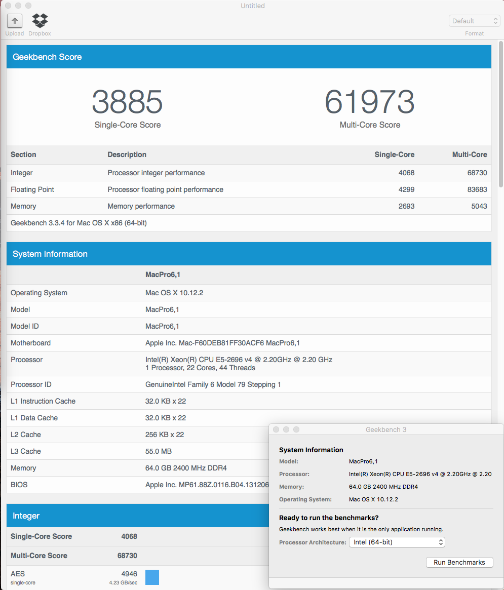

Core i7 5930k
By the way, the Nvidia web driver is super sketchy. If you change the resolution/refresh rate, it'll black screen. If you change Nvidiaweb=true, it'll either black screen at boot or load up an "unsupported" gfx card @ 1280x1024p with terrible performance. Recommend anyone looking to upgrade to 10.12.2, to hold off until the web drivers becomes more stable.

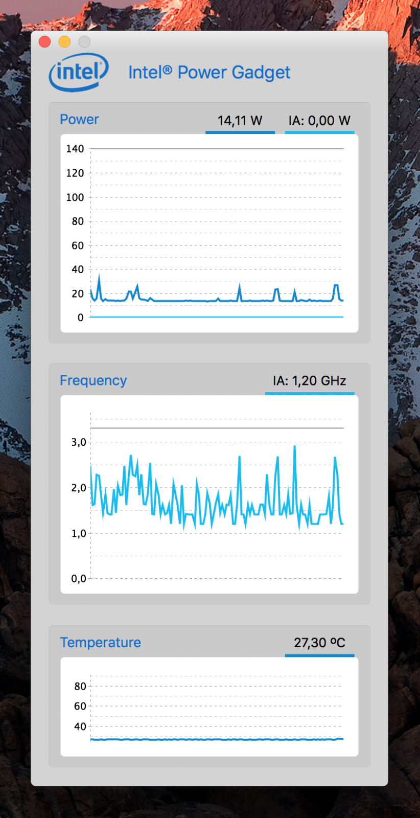

-  Included CPU, GPU, APCI and LPC sensors for the HWsensor/Intel Power Gadget apps

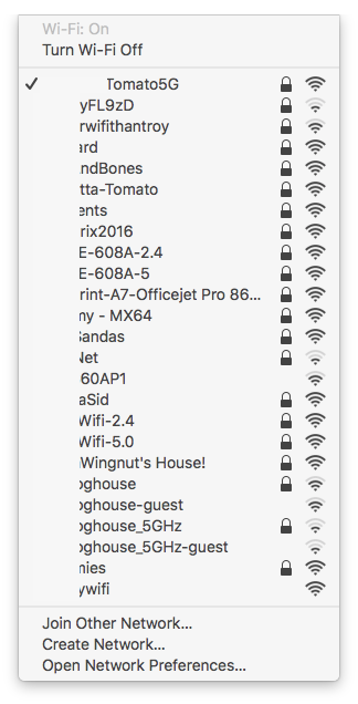

  • Wifi patches (100% functional! -- supports 2.4ghz and 5ghz)

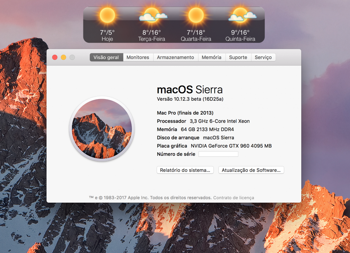

I have a 980 Ti and I can change resolution and refresh rate with the latest driver in 10.12.2. I do however see an annoying message about about Nvidia Driver Manager being unable to open from time to time.
Definitely not the best release from Nvidia, but no real issues that I have found.

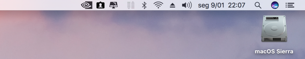

When setting my DP to 75hz, I get a black screen, then no signal. Have to reset SMC in order to get my screen back.
Didn't get any annoying nvidia messages, but did notice that my HWmontior icon in the menu bar would flip black then resolve to normal (could be because I'm using an older version).

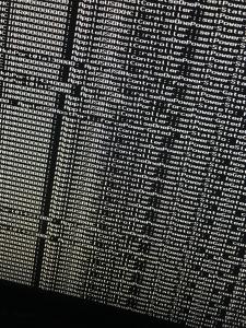

Hey guys! Have installed OS X on a new USB Drive now. ALL went good until i installed the nvidia WebDrivers.
The exact same EFI setup works yesterday. So i dunno whats wrong now. I installed it again because i messed up the system.
Black screen to death!
I have attached my files here. Can some one look in to it and see whats wrong? :/
Se my specs in the signature.

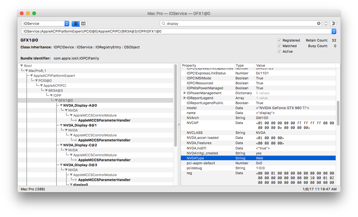

Hi.
I have made a SSDT patch with GFX1. maybe i have missed someting? Its succesfully loaded to.
Attached IOReg, log and EFI files.
UPDATE:
I switched to HDMI and now its working. But I need to replug the hdmi cable when the system has booted.
debug Mac Pro.zip
Hi.
UPDATE:
Yea, GFX1 looks fine.
What does Nvidia Driver Manager report? Try turning off web driver within it, then restarting with nv_disable=1 and turning it back on.
Also, add EMUVariable to your Clover kexts if NVRAM is not persistent in your board. That will help the Nvidia Driver Manager reflect the real state of things.
Although, if HDMI works and the System Info says you have a 980 Ti (or whatever model) then it doesn't sound like a driver issue. In my experience, all my 9xx cards have all ports working automatically. No work to be done.

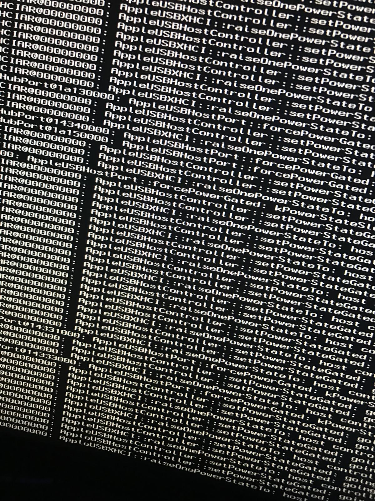

Update:
Boot ends up with a black screen. Now i cant even replug the hdmi or displayport.
