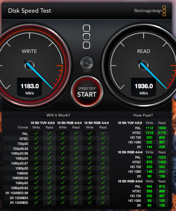

In my opinion also in USB3 video you have no thebest result you can achieve
If you can try to test in both situation your usbdevice with black magic disk speed test (it is free)
In my case I have a value for usb 2 of about 35/40 mb/s
for usb3 a value of about 115/120 Mb/s
and this are in my case a correct value

No difference. Same slow write speeds.
Edit: Should have just read the specs on the USB drive. Looks like it's only rated for 45 Mb/s writes... so much for "USB 3.0".
Everything is in order. The stick is not better than that.
USB devices will not switch from SuperSpeed (USB 3.0) to HighSpeed (2.0) or vice versa while operating. If it reads using SS it will write using SS as well.
Using USB 3.0 does not mean that the device must be fast. Driving a slow car on a high way doesn't make it faster, the high way only allows a faster car to use it's faster speed.
That's what you are seeing. The stick reads fast and writes slow.
If you want higher write speeds buy a more modern, higher capacity stick.

Its worked without any patches.
with adappter.
SM951:
  Type: AHCI Controller
  Driver Installed: Yes
  MSI: Yes
  Bus: PCI
  Slot: PCI Slot 4
  Vendor ID: 0x144d
  Device ID: 0xa801
  Subsystem Vendor ID: 0x144d
  Subsystem ID: 0xa801
  Revision ID: 0x0001
  Link Width: x4
  Link Speed: 8.0 GT/s
