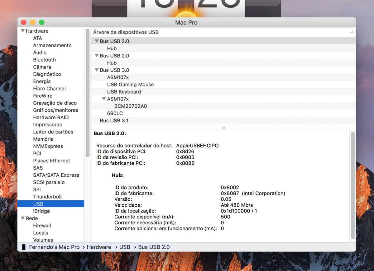

USBInjectAll.kext injects just USB 2.0 ports, while XHCI-x99-Injector.kext injects 3.0 ports (per Rehabman's github). They work alongside SSDT-UAIC.aml
If you have an X99-series chipset XHC controller, 8086:8d31, install XHCI-x99-injector.kext from the project as well. The USB3 drivers will not load without this injector kext.

1. You can download it from @RehabMan's bitbucket. (https://bitbucket.org/RehabMan/os-x-brcmpatchram/downloads/)
2. I see... In this case why don't you also create the USB injector kext for USB2?
3. Need further testing. And could you please upload both of them? I will check a bit later, ASAP.  :)
4. You don't configure your audio correctly. Definitely. Actually there's almost no change in 10.12.3 for AppleHDA related... Yup. You can create your own dummy HDA injector, yep. Just get the proper database from AppleALC.
1. Does firmwarerepo need patchram2? Or standalone? According to IOREG, my bluetooth is: pci14e4,43b1 (BRCM 4360)
2. Take a look USBInjectAll vs XHCI-Port-Injector... how to combine... (if it's any different than nmano's x99 port injector 3.kext)

3. Will test tomorrow. Midnight right now. You can find the kexts in my EFI 10.12.3 folder in my signature below.
4. I use the same board as Fergarth, so the dummy kext should be the same no? My board uses ALC1150.
1. Sorry I don't quite know what you mean... But anyway. BrcmFirmwareRepo is just a replacement for BrcmFirmwareData. (When you installed the kexts to SLE)
2. Ah I see. Your XHCI X99 Injector is to attach an ID. Sorry my fault. Don't touch both of them.
3. Have a good night !  :)
4. Sorry. I didn't make any changes for @Fergarth's audio and thus I didn't know how he made his audio work.
Tidied up my S/L/E folder:
-- Removed ACHIPortInjector.kext
-- Removed ACHI_Intel_Generic_SATA.kext
(injected ACHI port via SSDT-SAT1.aml)
-- Removed BrcmFirmwareData.kext
++ Added BrcmFirmwareRepo.kext
-+ Swapped BrcmPatchRAM2.kext for Rehabman's BrcmPatchRAM2.kext **Required, otherwise Bluetooth device isn't recognized**
Can you guide me on what to do for AppleALC? Otherwise, I'll just keep it as is.
Realtek Audio Controller: pci8086,8d20

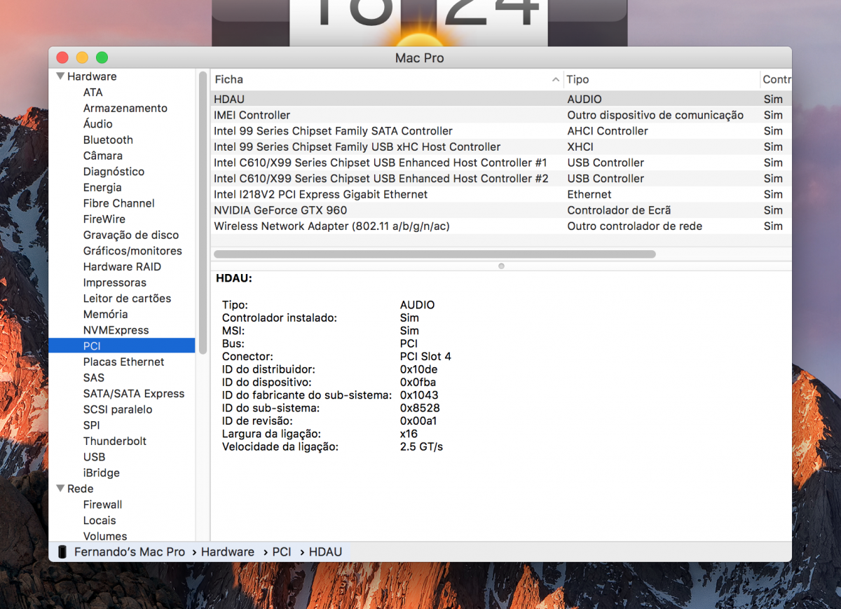

Updated. Download the archive and extract it.
AppleHDA_ALC1150.kext - Install this to SLE
config_sample_1150.plist - Merge the patches in this with your current config.plist
Your current AppleALC - Delete it (You'd better to have a backup.)
DSDT - No editing required
No CodecCommander required, with some patches I don't think ALC1150 has need for it.
1150.zip
Okay. Wait for a while.  :)
Sent from my iPhone 7 using Tapatalk
No CodecCommander required, with some patches I think ALC1150 doesn't have need for it.
attachicon.gif1150.zip
Testing...
Thanks for the help!!!
Update: Sound seems to be working 100%. Will test long term to make sure I don't get any weird KPs/loss of sound. Thanks again. I appreciate your help!

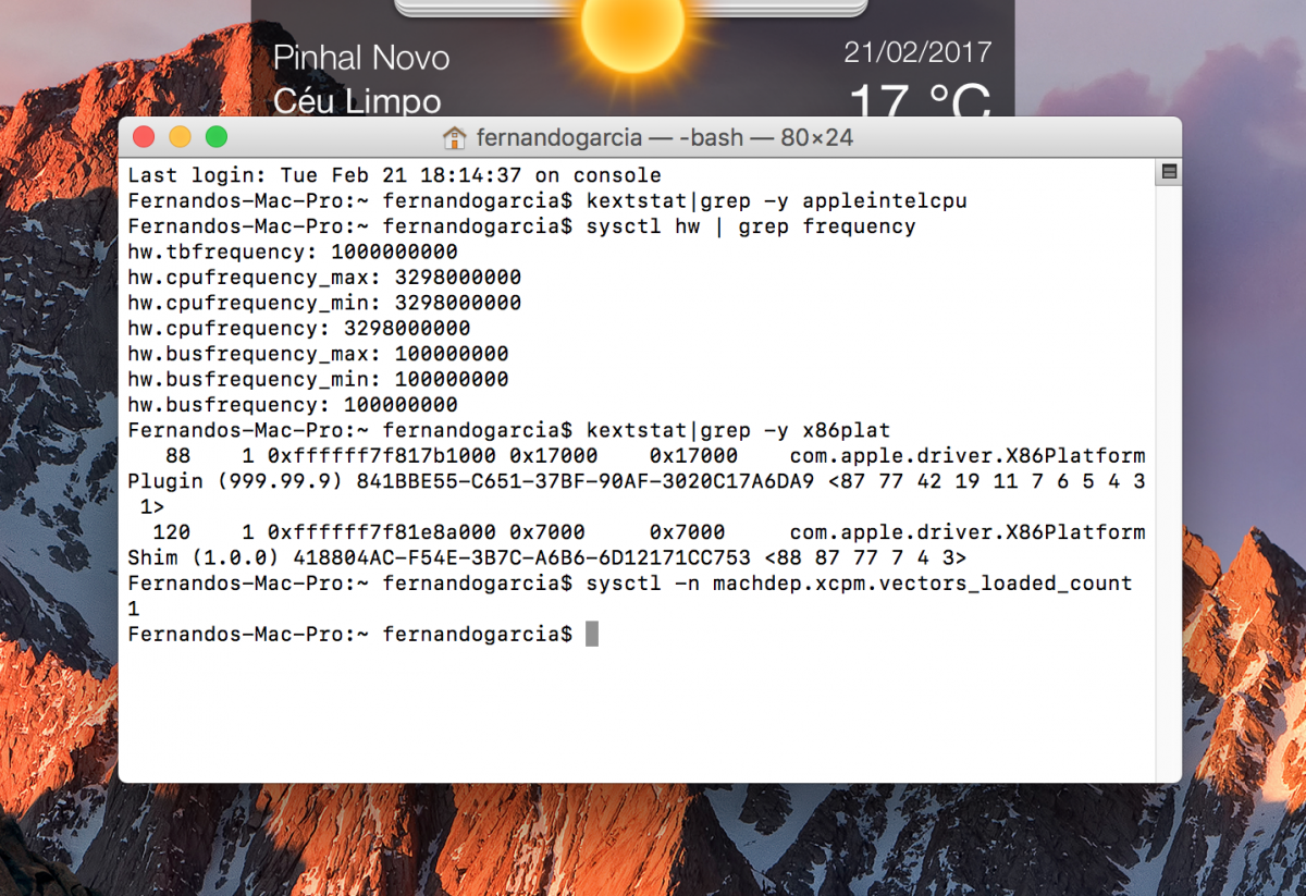

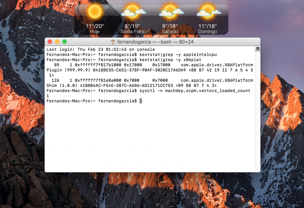

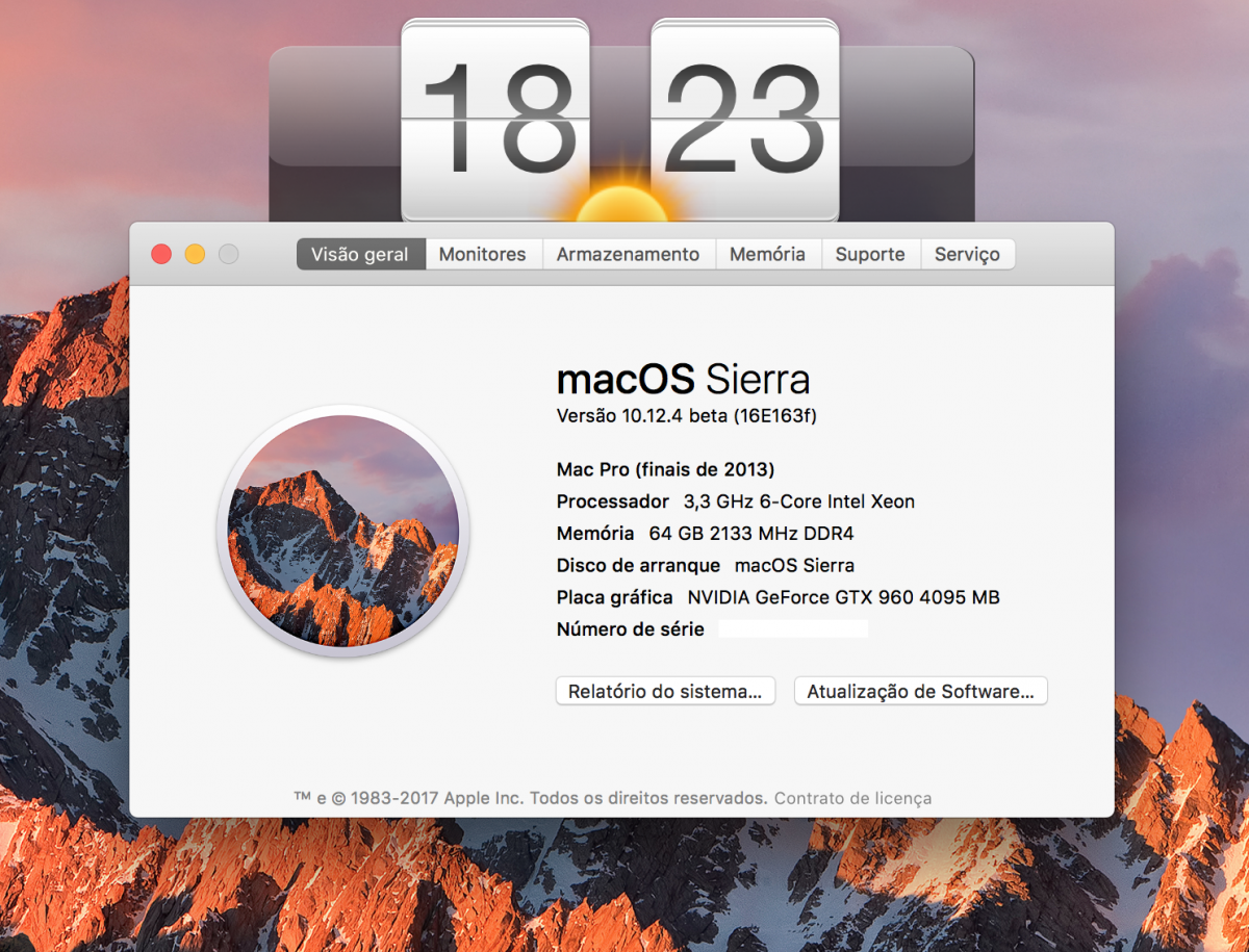

First of all, big thank you to my friend PMheart :yes:
Now with macOS Sierra 10.12.4 beta 3 (16E163f) and Clover r4012.
I followed your advice and at this point I have only two XCPM patches on the plist. My system works perfectly and is stable as I want, I think it's better than ever. At this point I have P-States, C3-Cores and C6-Cores, something I've never had before and I think it's good.
If anyone wants to test my EFI, I leave it here. But remember that it will only work well with hardware just like mine. Everything is optimized for my setup. Some of the kexts and patches are no longer in the "other" folder and are integrated into FakeSMC (thanks to PMheart).
The FreqVetors.rar (thanks PMheart) is to install on L/E or S/L/E, not in Clover. I installed in S/L/E and already did two Sierra updates and I had no problems cause dummy kext survives updates.
On the browser, in OS X, I have always used Safari and in fact never had any problem, even without having NV acceleration as is the case now, I can see and listen to videos perfectly. Of course without graphical acceleration I cannot use iMovie and other similar applications, but I have no complaints from Safari. I just used Chrome in Windows and it was before there was Edge.
To have onboard sound I used what is in the ALC 1150.rar, and has also survived the various updates I have already done.
And that's all for now. Always learning and improving with those who know! ;)

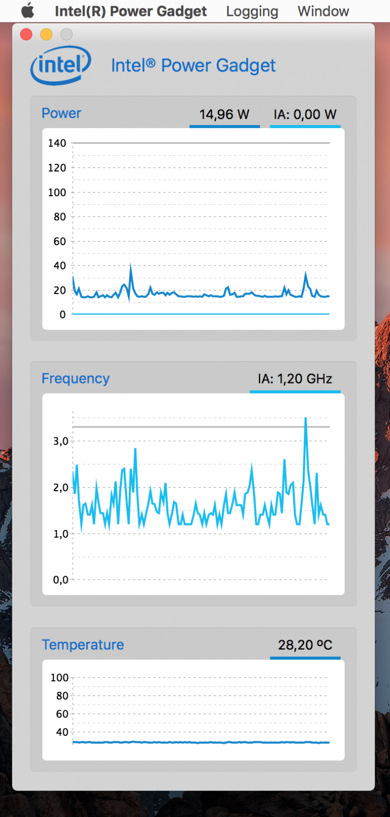

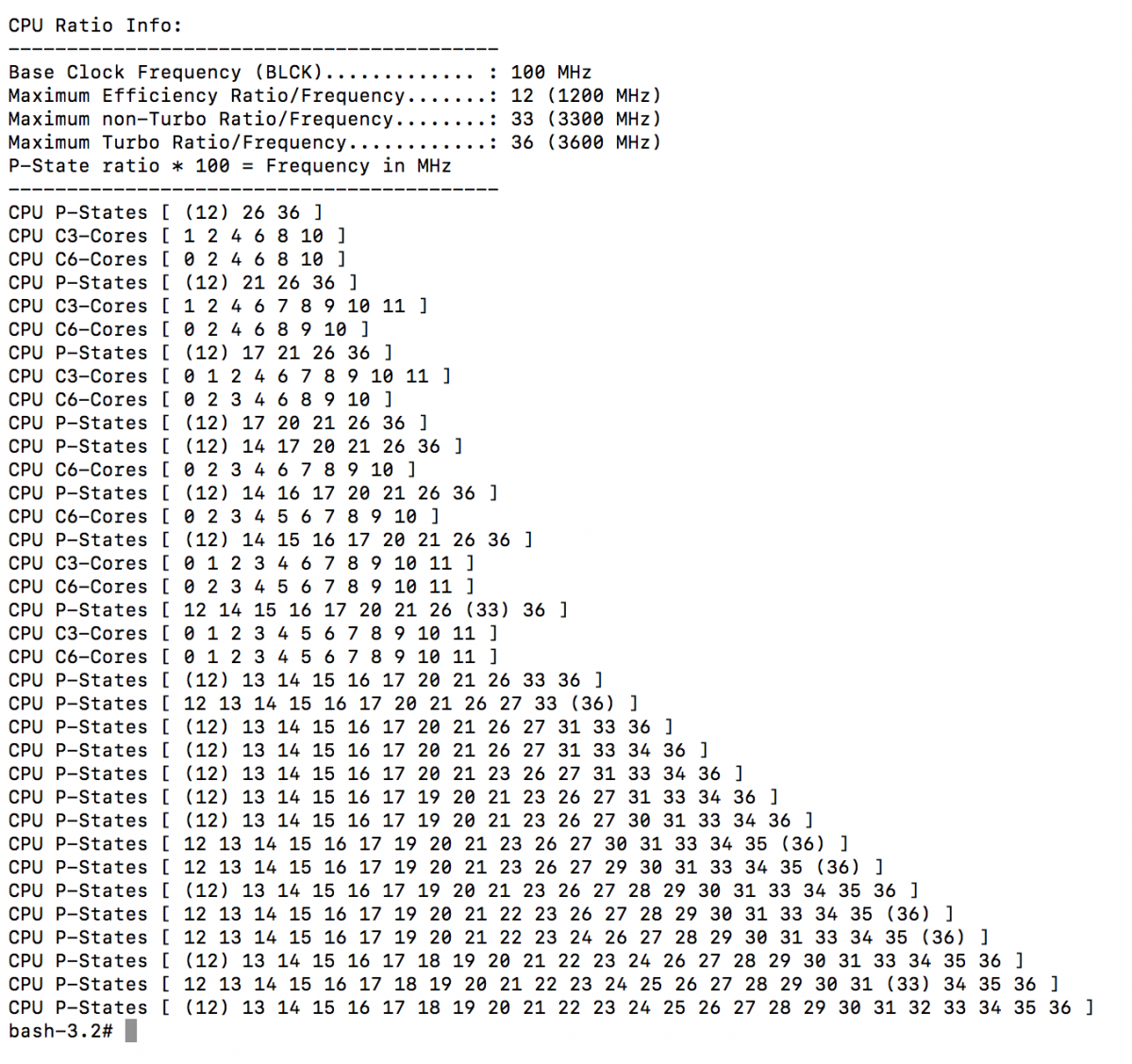

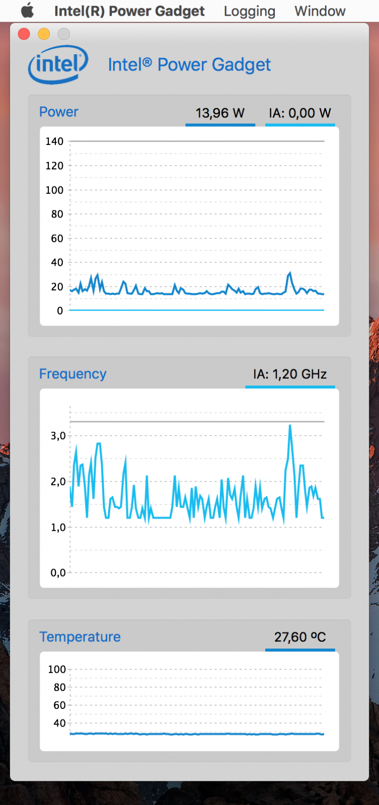

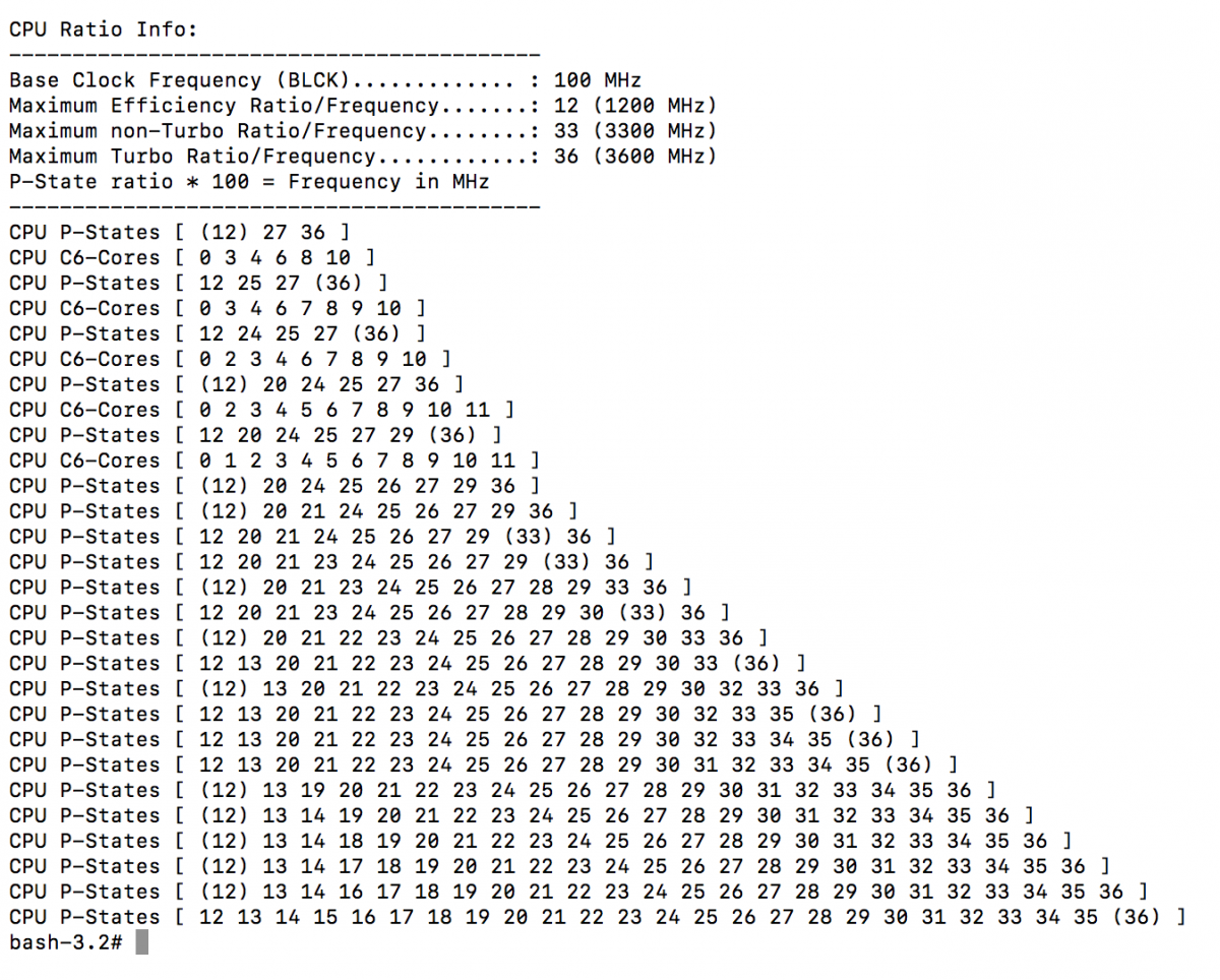

Also, can you help me with CPU PM... this just doesn't seem quite right (missing C3 states as well as C6 Residency (also, according to your CPU-S program, I'm only getting two states: base and turbo)):
AppleIntelInfo.kext v2.0 Copyright © 2012-2016 Pike R. Alpha. All rights reserved
enableHWP................................: 0
Settings:
logMSRs..................................: 1
logIGPU..................................: 0
logCStates...............................: 1
logIPGStyle..............................: 1
InitialTSC...............................: 0x94a1c8701b67 (4669 MHz)
MWAIT C-States...........................: 8480
Processor Brandstring....................: Intel(R) Core(TM) i7-5930K CPU @ 3.50GHz
Processor Signature..................... : 0x306F2
 - Family............................... : 6
 - Stepping............................. : 2
 - Model................................ : 0x3F (63)
Model Specific Registers (MSRs)
MSR_CORE_THREAD_COUNT............(0x35)  : 0xFFFFFF806C3D3400
 - Core Count........................... : 6
 - Thread Count......................... : 12
MSR_PLATFORM_INFO................(0xCE)  : 0x20080C3BF3812300
 - Maximum Non-Turbo Ratio.............. : 0x23 (3500 MHz)
 - Ratio Limit for Turbo Mode........... : 1 (programmable)
 - TDP Limit for Turbo Mode............. : 1 (programmable)
 - Low Power Mode Support............... : 1 (LPM supported)
 - Number of ConfigTDP Levels........... : 1 (additional TDP level(s) available)
 - Maximum Efficiency Ratio............. : 12
 - Minimum Operating Ratio.............. : 8
MSR_PMG_CST_CONFIG_CONTROL.......(0xE2)  : 0x400
 - I/O MWAIT Redirection Enable......... : 1 (enabled, IO read of MSR(0xE4) mapped to MWAIT)
 - CFG Lock............................. : 0 (MSR not locked)
 - C3 State Auto Demotion............... : 0 (disabled/unsupported)
 - C1 State Auto Demotion............... : 0 (disabled/unsupported)
 - C3 State Undemotion.................. : 0 (disabled/unsupported)
 - C1 State Undemotion.................. : 0 (disabled/unsupported)
 - Package C-State Auto Demotion........ : 0 (disabled/unsupported)
 - Package C-State Undemotion........... : 0 (disabled/unsupported)
MSR_PMG_IO_CAPTURE_BASE..........(0xE4)  : 0x10414
 - LVL_2 Base Address................... : 0x414
 - C-state Range........................ : 1 (C6 is the max C-State to include)
IA32_MPERF.......................(0xE7)  : 0x1575362984F
IA32_APERF.......................(0xE8)  : 0x153B33A673C
MSR_FLEX_RATIO...................(0x194) : 0xE0000
MSR_IA32_PERF_STATUS.............(0x198) : 0x22BB00002500
 - Current Performance State Value...... : 0x2500 (3700 MHz)
MSR_IA32_PERF_CONTROL............(0x199) : 0xFF00
 - Target performance State Value....... : 0xFF00 (25500 MHz)
 - Intel Dynamic Acceleration........... : 0 (IDA engaged)
IA32_CLOCK_MODULATION............(0x19A) : 0x0
IA32_THERM_INTERRUPT.............(0x19B) : 0x0
IA32_THERM_STATUS................(0x19C) : 0x88440000
 - Thermal Status....................... : 0
 - Thermal Log.......................... : 0
 - PROCHOT # or FORCEPR# event.......... : 0
 - PROCHOT # or FORCEPR# log............ : 0
 - Critical Temperature Status.......... : 0
 - Critical Temperature log............. : 0
 - Thermal Threshold #1 Status.......... : 0
 - Thermal Threshold #1 log............. : 0
 - Thermal Threshold #2 Status.......... : 0
 - Thermal Threshold #2 log............. : 0
 - Power Limitation Status.............. : 0
 - Power Limitation log................. : 0
 - Current Limit Status................. : 0
 - Current Limit log.................... : 0
 - Cross Domain Limit Status............ : 0
 - Cross Domain Limit log............... : 0
 - Digital Readout...................... : 68
 - Resolution in Degrees Celsius........ : 1
 - Reading Valid........................ : 1 (valid)
MSR_THERM2_CTL...................(0x19D) : 0x0
IA32_MISC_ENABLES................(0x1A0) : 0x840089
 - Fast-Strings......................... : 1 (enabled)
 - FOPCODE compatibility mode Enable.... : 0
 - Automatic Thermal Control Circuit.... : 1 (enabled)
 - Split-lock Disable................... : 0
 - Performance Monitoring............... : 1 (available)
 - Bus Lock On Cache Line Splits Disable : 0
 - Hardware prefetch Disable............ : 0
 - Processor Event Based Sampling....... : 0 (PEBS supported)
 - GV1/2 legacy Enable.................. : 0
 - Enhanced Intel SpeedStep Technology.. : 0 (disabled)
 - MONITOR FSM.......................... : 1 (MONITOR/MWAIT supported)
 - Adjacent sector prefetch Disable..... : 0
 - xTPR Message Disable................. : 1 (disabled)
MSR_TEMPERATURE_TARGET...........(0x1A2) : 0x640A00
 - Turbo Attenuation Units.............. : 0
 - Temperature Target................... : 100
 - TCC Activation Offset................ : 0
MSR_MISC_PWR_MGMT................(0x1AA) : 0x400000
 - EIST Hardware Coordination........... : 0 (hardware coordination enabled)
 - Energy/Performance Bias support...... : 1
 - Energy/Performance Bias.............. : 0 (disabled/MSR not visible to software)
 - Thermal Interrupt Coordination Enable : 1 (thermal interrupt routed to all cores)
MSR_TURBO_RATIO_LIMIT............(0x1AD) : 0x2424252525252525
 - Maximum Ratio Limit for C01.......... : 25 (3700 MHz)
 - Maximum Ratio Limit for C02.......... : 25 (3700 MHz)
 - Maximum Ratio Limit for C03.......... : 25 (3700 MHz)
 - Maximum Ratio Limit for C04.......... : 25 (3700 MHz)
 - Maximum Ratio Limit for C05.......... : 25 (3700 MHz)
 - Maximum Ratio Limit for C06.......... : 25 (3700 MHz)
IA32_ENERGY_PERF_BIAS............(0x1B0) : 0x0
MSR_POWER_CTL....................(0x1FC) : 0x29040059
 - Bi-Directional Processor Hot..........: 1 (enabled)
 - C1E Enable............................: 0 (disabled)
MSR_RAPL_POWER_UNIT..............(0x606) : 0xA0E03
 - Power Units.......................... : 3 (1/8 Watt)
 - Energy Status Units.................. : 14 (61 micro-Joules)
 - Time Units .......................... : 10 (976.6 micro-Seconds)
MSR_PKG_POWER_LIMIT..............(0x610) : 0x7FFF80015FFF8
 - Package Power Limit #1............... : 4095 Watt
 - Enable Power Limit #1................ : 1 (enabled)
 - Package Clamping Limitation #1....... : 1 (allow going below OS-requested P/T state during Time Window for Power Limit #1)
 - Time Window for Power Limit #1....... : 10 (2560 milli-Seconds)
 - Package Power Limit #2............... : 4095 Watt
 - Enable Power Limit #2................ : 1 (enabled)
 - Package Clamping Limitation #2....... : 1 (allow going below OS-requested P/T state setting Time Window for Power Limit #2)
 - Time Window for Power Limit #2....... : 3 (20 milli-Seconds)
 - Lock................................. : 0 (MSR not locked)
MSR_PKG_ENERGY_STATUS............(0x611) : 0x9B378152
 - Total Energy Consumed................ : 158942 Joules (Watt = Joules / seconds)
MSR_PKG_POWER_INFO...............(0x614) : 0x1280460
 - Thermal Spec Power................... : 140 Watt
 - Minimum Power........................ : 0
 - Maximum Power........................ : 0
 - Maximum Time Window.................. : 0
MSR_PP0_POWER_LIMIT..............(0x638) : 0x0
MSR_PP0_ENERGY_STATUS............(0x639) : 0x0
MSR_TURBO_ACTIVATION_RATIO.......(0x64C) : 0x0
MSR_CONFIG_TDP_NOMINAL...........(0x648) : 0x23
MSR_CONFIG_TDP_LEVEL1............(0x649) : 0x94000000200460
MSR_CONFIG_TDP_LEVEL2............(0x64a) : 0x94000000000000
MSR_CONFIG_TDP_CONTROL...........(0x64b) : 0x0
MSR_TURBO_ACTIVATION_RATIO.......(0x64c) : 0x0
MSR_PKGC6_IRTL...................(0x60b) : 0x0
MSR_PKG_C2_RESIDENCY.............(0x60d) : 0x0
MSR_PKG_C6_RESIDENCY.............(0x3f9) : 0x0
IA32_TSC_DEADLINE................(0x6E0) : 0x94A1CD98871C
CPU Ratio Info:
Base Clock Frequency (BLCK)............. : 100 MHz
Maximum Efficiency Ratio/Frequency.......: 12 (1200 MHz)
Maximum non-Turbo Ratio/Frequency........: 35 (3500 MHz)
Maximum Turbo Ratio/Frequency............: 37 (3700 MHz)
P-State ratio * 100 = Frequency in MHz
CPU P-States [ (12) 30 37 ]
CPU C6-Cores [ 0 2 4 6 8 10 ]
CPU P-States [ (12) 30 34 37 ]
CPU C6-Cores [ 0 2 4 6 8 9 10 ]
CPU P-States [ (12) 30 31 34 37 ]
CPU P-States [ (12) 28 30 31 34 37 ]
CPU C6-Cores [ 0 2 4 5 6 7 8 9 10 ]
CPU P-States [ (12) 28 29 30 31 34 37 ]
CPU P-States [ (12) 22 28 29 30 31 34 37 ]
CPU P-States [ 12 22 28 29 30 31 32 34 (37) ]
CPU C6-Cores [ 0 1 2 3 4 5 6 7 8 9 10 11 ]
CPU P-States [ 12 22 27 28 29 30 31 32 34 (37) ]
CPU P-States [ (12) 22 26 27 28 29 30 31 32 34 37 ]
CPU P-States [ (12) 22 26 27 28 29 30 31 32 33 34 37 ]
CPU P-States [ (12) 22 24 26 27 28 29 30 31 32 33 34 37 ]
CPU P-States [ (12) 22 24 25 26 27 28 29 30 31 32 33 34 37 ]
CPU P-States [ 12 22 23 24 25 26 27 28 29 30 31 32 33 34 (37) ]
CPU P-States [ 12 22 23 24 25 26 27 28 29 30 31 32 33 34 35 (37) ]
CPU P-States [ (12) 22 23 24 25 26 27 28 29 30 31 32 33 34 35 36 37 ]
CPU P-States [ (12) 20 22 23 24 25 26 27 28 29 30 31 32 33 34 35 36 37 ]
CPU P-States [ (12) 20 21 22 23 24 25 26 27 28 29 30 31 32 33 34 35 36 37 ]
CPU P-States [ (12) 19 20 21 22 23 24 25 26 27 28 29 30 31 32 33 34 35 36 37 ]

CPU Ratio Info:
CPU P-States [ (12) 29 35 ]
CPU C3-Cores [ 1 3 4 7 ]
CPU C6-Cores [ 0 4 7 9 11 ]
CPU P-States [ (12) 18 29 35 ]
CPU C3-Cores [ 0 1 3 4 6 7 ]
CPU C6-Cores [ 0 1 2 4 6 7 8 9 10 11 ]
CPU P-States [ (12) 18 26 29 35 ]
CPU C3-Cores [ 0 1 2 3 4 6 7 ]
CPU P-States [ (12) 18 23 26 29 35 ]
CPU P-States [ (12) 15 18 23 26 29 35 ]
CPU P-States [ (12) 15 17 18 23 26 29 35 ]
CPU P-States [ (12) 15 17 18 22 23 26 29 35 ]
CPU C6-Cores [ 0 1 2 4 5 6 7 8 9 10 11 ]
CPU P-States [ (12) 15 16 17 18 22 23 26 29 35 ]
CPU P-States [ 12 15 16 17 18 20 22 23 26 29 35 (37) ]
CPU C3-Cores [ 0 1 2 3 4 5 6 7 ]
CPU P-States [ 12 15 16 17 18 20 22 23 26 29 31 (35) 37 ]
CPU P-States [ (12) 15 16 17 18 20 22 23 24 26 29 31 35 37 ]
CPU P-States [ (12) 15 16 17 18 20 22 23 24 25 26 29 31 35 37 ]
CPU P-States [ (12) 14 15 16 17 18 20 22 23 24 25 26 29 31 35 37 ]
CPU P-States [ (12) 14 15 16 17 18 20 22 23 24 25 26 28 29 31 35 37 ]
CPU P-States [ (12) 14 15 16 17 18 19 20 22 23 24 25 26 28 29 31 35 37 ]
CPU P-States [ (12) 14 15 16 17 18 19 20 21 22 23 24 25 26 28 29 31 35 37 ]
CPU P-States [ (12) 13 14 15 16 17 18 19 20 21 22 23 24 25 26 28 29 31 35 37 ]
CPU P-States [ 12 13 14 15 16 17 18 19 20 21 22 23 24 25 26 28 29 31 33 (35) 37 ]
CPU P-States [ 12 13 14 15 16 17 18 19 20 21 22 23 24 25 26 28 29 31 33 35 36 (37) ]
CPU P-States [ 12 13 14 15 16 17 18 19 20 21 22 23 24 25 26 28 29 30 31 33 35 36 (37) ]
CPU P-States [ (12) 13 14 15 16 17 18 19 20 21 22 23 24 25 26 27 28 29 30 31 33 35 36 37 ]
CPU P-States [ 12 13 14 15 16 17 18 19 20 21 22 23 24 25 26 27 28 29 30 31 32 33 (35) 36 37 ]
CPU P-States [ (12) 13 14 15 16 17 18 19 20 21 22 23 24 25 26 27 28 29 30 31 32 33 34 35 36 37 ]
CPU C3-Cores [ 0 1 2 3 4 5 6 7 8 ]
CPU C3-Cores [ 0 1 2 3 4 5 6 7 8 9 ]
However, my Package Power Limit #1 and #2 are too high...
Edit #2: Annnnddd... fixed.  :)

CPU Ratio Info:
CPU C3-Cores [ 1 5 ]
CPU C6-Cores [ 1 2 6 8 11 ]
CPU P-States [ (12) 23 30 37 ]
CPU C3-Cores [ 0 1 5 ]
CPU C6-Cores [ 1 2 4 6 8 11 ]
CPU P-States [ (12) 23 28 30 37 ]
CPU C6-Cores [ 0 1 2 4 5 6 8 10 11 ]
CPU P-States [ (12) 17 23 28 30 37 ]
CPU C3-Cores [ 0 1 4 5 ]
CPU P-States [ (12) 17 20 23 28 30 37 ]
CPU P-States [ (12) 17 20 22 23 28 30 37 ]
CPU P-States [ 12 17 19 20 22 23 28 30 (35) 37 ]
CPU P-States [ (12) 15 17 19 20 22 23 28 30 35 37 ]
CPU P-States [ (12) 15 17 18 19 20 22 23 28 30 35 37 ]
CPU P-States [ (12) 15 17 18 19 20 22 23 28 30 34 35 37 ]
CPU P-States [ (12) 14 15 17 18 19 20 22 23 28 30 34 35 37 ]
CPU P-States [ (12) 14 15 16 17 18 19 20 22 23 28 30 34 35 37 ]
CPU P-States [ (12) 13 14 15 16 17 18 19 20 22 23 28 30 34 35 37 ]
CPU P-States [ 12 13 14 15 16 17 18 19 20 22 23 28 30 33 34 35 (37) ]
CPU P-States [ (12) 13 14 15 16 17 18 19 20 22 23 25 28 30 33 34 35 37 ]
CPU P-States [ (12) 13 14 15 16 17 18 19 20 22 23 24 25 28 30 33 34 35 37 ]
CPU P-States [ 12 13 14 15 16 17 18 19 20 22 23 24 25 28 30 33 34 35 36 (37) ]
CPU P-States [ 12 13 14 15 16 17 18 19 20 22 23 24 25 28 30 32 33 34 (35) 36 37 ]
CPU P-States [ 12 13 14 15 16 17 18 19 20 22 23 24 25 28 29 30 32 33 34 (35) 36 37 ]
CPU P-States [ (12) 13 14 15 16 17 18 19 20 22 23 24 25 27 28 29 30 32 33 34 35 36 37 ]
CPU P-States [ (12) 13 14 15 16 17 18 19 20 22 23 24 25 27 28 29 30 31 32 33 34 35 36 37 ]
CPU C3-Cores [ 0 1 3 4 5 ]
CPU C3-Cores [ 0 1 2 3 4 5 ]
CPU P-States [ 12 13 14 15 16 17 18 19 20 22 23 24 25 26 27 28 29 30 31 32 33 34 (35) 36 37 ]
CPU C3-Cores [ 0 1 2 3 4 5 9 10 ]
CPU C3-Cores [ 0 1 2 3 4 5 8 9 10 ]
CPU C3-Cores [ 0 1 2 3 4 5 8 9 10 11 ]
Now you must see and test the stability, but the final result looks good
Yeah... we will see!
If it works, I'll definitely need to update my EFI 10.12.3 post.
Update: Preliminary tests... not good:
Will eliminate XCPM patches one by one and test...
Testing... Done.
Kept 5 XCPM patches in config.plist, removed 3 XCPM patches:
config.plist/KernelandKextsToPatch/KernelToPatch
F=>Find, R=>Replace, C=>Comments, N=>Notes
* In my config.plist           *
F: 83C3C483FB22
R: 83C3C183FB22
C: _xcpm_bootstrap Sierra © Pike R. Alpha
N: Required. Will not boot into OS
F: BE0700000031D2E894FCFFFF
R: BE0700000031D29090909090
C: _xcpm_pkg_scope_msr  © Pike R. Alpha
F: BE0B0000005DE908000000
R: BE0B0000005DC390909090
C: _xcpm_SMT_scope_msrs  © Pike R. Alpha
N: Needed to achieve maximum turbo boost
F: BE0B00000031D2E859FCFFFF
R: BE0B00000031D29090909090
N: Needed to sustain turbo boost
F: 20B9E20000000F30
R: 20B9E20000009090
C: XCPM_idle Replace All fix by Pike R. Alpha
N: Needed to achieve a MSR_PKG_C3_RESIDENCY above 0x0 and to set Target performance State Value to 0xC00 (1200 MHz)
* Removed from my config.plist *
F: BE0200000031D2E86CFCFFFF
R: BE0200000031D29090909090
C: _xcpm_core_scope_msrs  © Pike R. Alpha
N: Sets MSR_PKG_C2_RESIDENCY.............(0x60d) : 0x0
MSR_PKG_C3_RESIDENCY.............(0x3f8) : 0x0
F: 89D8C1E008B99901
R: B800FF0000B99901
C: xcpm performance fix 1 (wrsmr fix to get CPU max) © okrasit
N: Sets Target performance State Value to 0xFF00 (25500 MHz) *Not recommended*
F: 83C0E9
R: 83C0E6
C: Haswell-E CPUID Patch
N: No longer needed for Sierra, already patched by Apple

CPU Ratio Info:
CPU P-States [ 30 (37) ]
CPU C3-Cores [ 0 9 10 ]
CPU C6-Cores [ 1 3 5 7 8 11 ]
CPU P-States [ (12) 24 30 37 ]
CPU C6-Cores [ 1 2 3 5 7 8 9 10 11 ]
CPU P-States [ (12) 24 30 32 37 ]
CPU C3-Cores [ 0 1 8 9 10 11 ]
CPU C6-Cores [ 1 2 3 4 5 6 7 8 9 10 11 ]
CPU P-States [ (12) 22 24 30 32 37 ]
CPU P-States [ (12) 22 24 25 30 32 37 ]
CPU P-States [ 12 22 24 25 30 32 35 (37) ]
CPU P-States [ (12) 22 24 25 30 32 35 36 37 ]
CPU P-States [ (12) 22 24 25 30 31 32 35 36 37 ]
CPU P-States [ (12) 22 24 25 30 31 32 34 35 36 37 ]
CPU P-States [ 12 22 24 25 29 30 31 32 34 35 36 (37) ]
CPU P-States [ 12 22 24 25 29 30 31 32 33 34 35 36 (37) ]
CPU P-States [ (12) 21 22 24 25 29 30 31 32 33 34 35 36 37 ]
CPU P-States [ 12 21 22 24 25 28 29 30 31 32 33 34 35 36 (37) ]
CPU P-States [ (12) 21 22 24 25 27 28 29 30 31 32 33 34 35 36 37 ]
CPU P-States [ (12) 21 22 23 24 25 27 28 29 30 31 32 33 34 35 36 37 ]
CPU P-States [ 12 17 21 22 23 24 25 27 28 29 30 31 32 33 34 35 36 (37) ]
CPU P-States [ (12) 17 21 22 23 24 25 26 27 28 29 30 31 32 33 34 35 36 37 ]
CPU P-States [ (12) 17 18 21 22 23 24 25 26 27 28 29 30 31 32 33 34 35 36 37 ]
CPU P-States [ (12) 17 18 19 21 22 23 24 25 26 27 28 29 30 31 32 33 34 35 36 37 ]
CPU P-States [ 12 17 18 19 20 21 22 23 24 25 26 27 28 29 30 31 32 33 34 35 36 (37) ]
CPU P-States [ 12 15 17 18 19 20 21 22 23 24 25 26 27 28 29 30 31 32 33 34 35 36 (37) ]
CPU P-States [ 12 15 16 17 18 19 20 21 22 23 24 25 26 27 28 29 30 31 32 33 34 35 36 (37) ]
CPU P-States [ (12) 14 15 16 17 18 19 20 21 22 23 24 25 26 27 28 29 30 31 32 33 34 35 36 37 ]
CPU C3-Cores [ 0 1 2 4 8 9 10 11 ]
CPU C3-Cores [ 0 1 2 3 4 5 6 8 9 10 11 ]
CPU C3-Cores [ 0 1 2 3 4 5 6 7 8 9 10 11 ]
