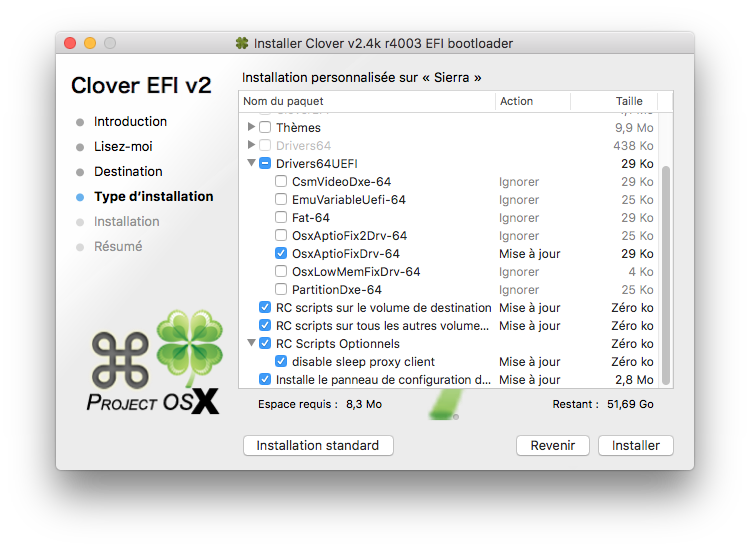

And as you suggest it is desirable to put only the essentials when you install clover  :wink_anim:
Emuvariable is not necessary

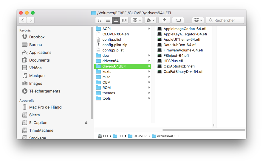

Don't install the AptioFix from Clover pkg!!! I've given a trick for that.
Update 2/11/17 @ 8:45AM: Since PMHeart has graciously provided a OsxAptioFixDrv with 512MB of free space, I've been allowed to continue to test a OsxAptioFixDrv.efi over the past 3 days.  So far, I haven't had any stability issues with my current Clover revision. However, do note, that I was having stability issues when running Clover EFI r3899+, and therefore had to revert back to using what I've been using already: r3859. It may just be my particular setup doesn't like the newer Clover versions, but its hard to say which is at fault (Clover,  my system or the efi). Anyway, update at your own risk. Added a new EFI folder called: EFI_ASUS-PRO-USB3.1_10.12.3_FIXDRV-512MB.zip which includes my EFI and the modded .efi.
Also added some CPU PM links that help new comers with checking/setting up XCPM mode.
Updated my EFI 10.12.3 post to reflect new changes.

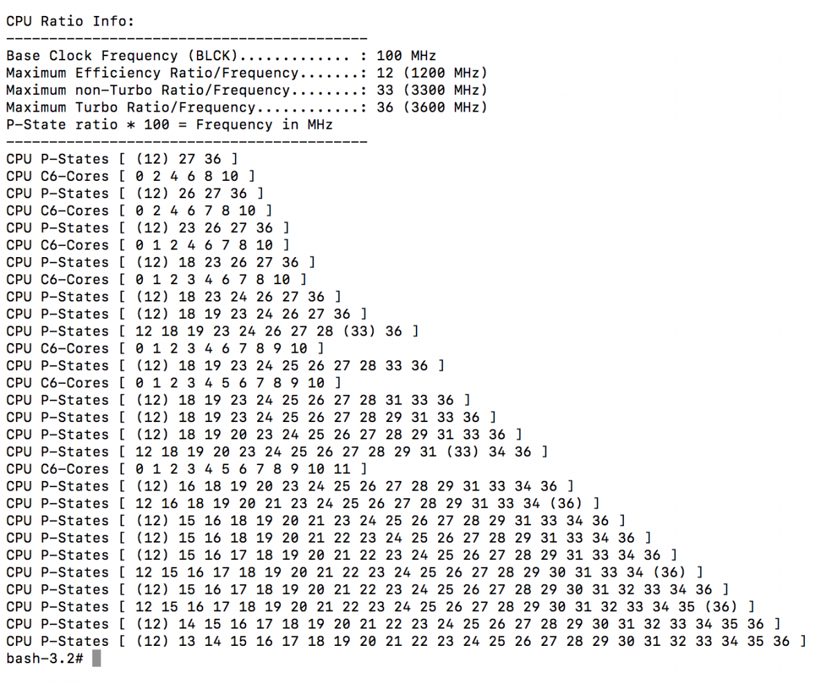

Update 2/12/17 @ 9:30PMOsxAptioFixDrv.efi: Sleep appears to be partially broken. Power nap works, but putting the Mac to sleep manually results in a black screen on wake up (no video signal). Also, power nap, while working, tends to mess up Keychain permissions. I'd avoid any sleep/nap features for the time being.
But after some tests I came to the conclusion that the system is more stable with the 4 XCPM patches.
Running 10.12.3. Was able to remove some XCPM patches according to your EFI, however, I needed one extra to get CPU turbo boost across all States:
F: 89D8C1E008B99901
R: B800FF0000B99901
C: xcpm performance fix 1 (wrsmr fix to get CPU max) © okrasit
Without:
With:
In fact I'm not using this XCPM patch (xcpm performance fix 1) and my result looks good, with more C / P-States and more complete than yours. I just select "Sync All Cores" on bios and use MP61_freqV_w_iMac171.kext on S/L/E and I like the final result :yes:

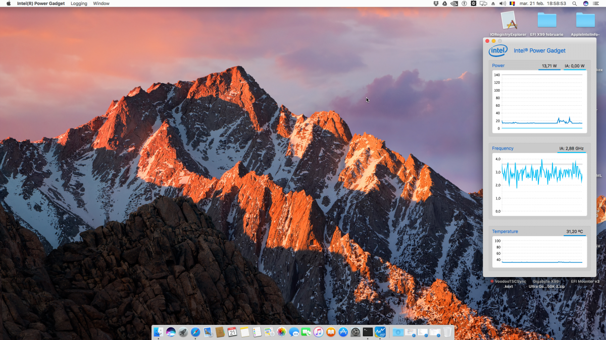

Hi guys! can anybody confirm if this its correct power management?
AppleIntelInfo.kext v2.2 Copyright © 2012-2017 Pike R. Alpha. All rights reserved
enableHWP................................: 0
Settings:
logMSRs..................................: 1
logIGPU..................................: 0
logCStates...............................: 1
logIPGStyle..............................: 1
InitialTSC...............................: 0x2206678655c7 (1039 MHz)
MWAIT C-States...........................: 8480
Processor Brandstring....................: Intel® Core i7-6850K CPU @ 3.60GHz
Processor Signature..................... : 0x406F1
 - Family............................... : 6
 - Stepping............................. : 1
 - Model................................ : 0x4F (79)
Model Specific Registers (MSRs)
MSR_CORE_THREAD_COUNT............(0x35)  : 0xFFFFFF805CE05F00
 - Core Count........................... : 6
 - Thread Count......................... : 12
MSR_PLATFORM_INFO................(0xCE)  : 0x20080C3BF3812400
 - Maximum Non-Turbo Ratio.............. : 0x24 (3600 MHz)
 - Ratio Limit for Turbo Mode........... : 1 (programmable)
 - TDP Limit for Turbo Mode............. : 1 (programmable)
 - Low Power Mode Support............... : 1 (LPM supported)
 - Number of ConfigTDP Levels........... : 1 (additional TDP level(s) available)
 - Maximum Efficiency Ratio............. : 12
 - Minimum Operating Ratio.............. : 8
MSR_PMG_CST_CONFIG_CONTROL.......(0xE2)  : 0x3
 - I/O MWAIT Redirection Enable......... : 0 (not enabled)
 - CFG Lock............................. : 0 (MSR not locked)
 - C3 State Auto Demotion............... : 0 (disabled/unsupported)
 - C1 State Auto Demotion............... : 0 (disabled/unsupported)
 - C3 State Undemotion.................. : 0 (disabled/unsupported)
 - C1 State Undemotion.................. : 0 (disabled/unsupported)
 - Package C-State Auto Demotion........ : 0 (disabled/unsupported)
 - Package C-State Undemotion........... : 0 (disabled/unsupported)
MSR_PMG_IO_CAPTURE_BASE..........(0xE4)  : 0x0
 - C-state Range........................ : 0 (C-States not included, I/O MWAIT redirection not enabled)
IA32_MPERF.......................(0xE7)  : 0xFF1686889E
IA32_APERF.......................(0xE8)  : 0x1055FBC302A
MSR_0x150........................(0x150) : 0x20000000000
MSR_FLEX_RATIO...................(0x194) : 0xE0000
MSR_IA32_PERF_STATUS.............(0x198) : 0x27F700002800
 - Current Performance State Value...... : 0x2800 (4000 MHz)
MSR_IA32_PERF_CONTROL............(0x199) : 0x3100
 - Target performance State Value....... : 0x3100 (4900 MHz)
 - Intel Dynamic Acceleration........... : 0 (IDA engaged)
IA32_CLOCK_MODULATION............(0x19A) : 0x0
IA32_THERM_INTERRUPT.............(0x19B) : 0x0
IA32_THERM_STATUS................(0x19C) : 0x88460000
 - Thermal Status....................... : 0
 - Thermal Log.......................... : 0
 - PROCHOT # or FORCEPR# event.......... : 0
 - PROCHOT # or FORCEPR# log............ : 0
 - Critical Temperature Status.......... : 0
 - Critical Temperature log............. : 0
 - Thermal Threshold #1 Status.......... : 0
 - Thermal Threshold #1 log............. : 0
 - Thermal Threshold #2 Status.......... : 0
 - Thermal Threshold #2 log............. : 0
 - Power Limitation Status.............. : 0
 - Power Limitation log................. : 0
 - Current Limit Status................. : 0
 - Current Limit log.................... : 0
 - Cross Domain Limit Status............ : 0
 - Cross Domain Limit log............... : 0
 - Digital Readout...................... : 70
 - Resolution in Degrees Celsius........ : 1
 - Reading Valid........................ : 1 (valid)
MSR_THERM2_CTL...................(0x19D) : 0x0
IA32_MISC_ENABLES................(0x1A0) : 0x850089
 - Fast-Strings......................... : 1 (enabled)
 - FOPCODE compatibility mode Enable.... : 0
 - Automatic Thermal Control Circuit.... : 1 (enabled)
 - Split-lock Disable................... : 0
 - Performance Monitoring............... : 1 (available)
 - Bus Lock On Cache Line Splits Disable : 0
 - Hardware prefetch Disable............ : 0
 - Processor Event Based Sampling....... : 0 (PEBS supported)
 - GV1/2 legacy Enable.................. : 0
 - Enhanced Intel SpeedStep Technology.. : 1 (enabled)
 - MONITOR FSM.......................... : 1 (MONITOR/MWAIT supported)
 - Adjacent sector prefetch Disable..... : 0
 - xTPR Message Disable................. : 1 (disabled)
MSR_TEMPERATURE_TARGET...........(0x1A2) : 0x640A00
 - Turbo Attenuation Units.............. : 0
 - Temperature Target................... : 100
 - TCC Activation Offset................ : 0
MSR_MISC_PWR_MGMT................(0x1AA) : 0x402000
 - EIST Hardware Coordination........... : 0 (hardware coordination enabled)
 - Energy/Performance Bias support...... : 1
 - Energy/Performance Bias.............. : 0 (disabled/MSR not visible to software)
 - Thermal Interrupt Coordination Enable : 1 (thermal interrupt routed to all cores)
MSR_TURBO_RATIO_LIMIT............(0x1AD) : 0x2525282828282828
 - Maximum Ratio Limit for C01.......... : 28 (4000 MHz)
 - Maximum Ratio Limit for C02.......... : 28 (4000 MHz)
 - Maximum Ratio Limit for C03.......... : 28 (4000 MHz)
 - Maximum Ratio Limit for C04.......... : 28 (4000 MHz)
 - Maximum Ratio Limit for C05.......... : 28 (4000 MHz)
 - Maximum Ratio Limit for C06.......... : 28 (4000 MHz)
IA32_ENERGY_PERF_BIAS............(0x1B0) : 0x5
 - Power Policy Preference...............: 5 (balanced performance and energy saving)
MSR_POWER_CTL....................(0x1FC) : 0x2104005B
 - Bi-Directional Processor Hot..........: 1 (enabled)
 - C1E Enable............................: 1 (enabled)
MSR_RAPL_POWER_UNIT..............(0x606) : 0xA0E03
 - Power Units.......................... : 3 (1/8 Watt)
 - Energy Status Units.................. : 14 (61 micro-Joules)

bash-3.2# cat /tmp/AppleIntelInfo.dat
In my opinion is not correct, there should be more steps in the last lines, especially the last should be all. And the line of your IPG in idle, should be in the minimum frequencies of the processor that is 1200MHz. But it's just my opinion...
Speaking only of the last line, although not the only one that is not correct...
This is what you have in the last line:
CPU P-States [ 12 17 18 19 20 21 22 23 24 25 26 27 28 29 30 31 32 33 34 35 36 37 38 39 (40) ]
This is what in my opinion you should have:
CPU P-States [ 12 13 14 15 16 17 18 19 20 21 22 23 24 25 26 27 28 29 30 31 32 33 34 35 36 37 38 39 (40) ]​
