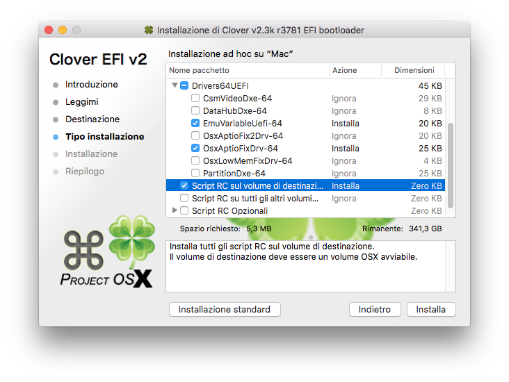

giacomoleopardo Posted October 2, 2016 Share Posted October 2, 2016 May I ask which drivers do you have in EFI/Clover/Drivers64 folder? If I warm boot, I get stuck on memory allocation, but a cold boot takes me through. I have the OsxAptioFixDrv-2000.efi On Asus X99-A and X99-A II I had success with original Clover OsxAptioFixDrv-64.efi (not OsxAptioFixDrv2-64.efi) and Test2-2016.efi. In Clover Install I also needed to select EmuVariableUefi-64.efi and Install RC Script on target Volume option. Attached my drivers64UEFI folder System Hardware - X99-A (and previously X99-A II) - Latest Uefi Patched Bios (code Rush credits) - Intel i7 6900K - nVidia GTX 980 Ti - Both El Capitan 10.11.6 and macOS Sierra 10.12.0 I've noticed that with X99-A II I need to give Clover about 15 seconds of time out before getting into OS X CREDITS to Nick Woodhams @Balamut Your bios is clearly different from "gaming and consumer " boards as I remembered You miss to show CPU Advanced PM tuning IF you find Enhanced intel speedstep technology you can try to disable it In USB section many X99 guides advice to enable also EHCI hand off and set IntelXhci from auto to enabled Then , In AI Overclock Tuner try to change to manual and see with parameters you could modify You say also that you see only 32 Gb of 128 Gb It seems that only one cpu is feed, are you sure you have ram in correct way? you should see 64 gb without any clover injection But maybe all of these advice are not relevant for your problem if you have on this rig a solid microsoft windows working setup Edit if you want try to boot with the attached files without any modify and then modifying in clover only fakecpuid from the existed to 306E0 before was 40674 Fabio, does your mobo need VoodooTSCSync.kext for sleep/wake up? Cause my X99-A doesn't do that without it. drivers64UEFI.zip Link to comment https://www.insanelymac.com/forum/topic/313296-guide-mac-osx-1012-and-1013-with-x99-broadwell-e-family-and-haswell-e-family/page/6/#findComment-2291122 Share on other sites More sharing options...
Fljagd Posted October 2, 2016 Share Posted October 2, 2016 On Asus X99-A and X99-A II I had success with original Clover OsxAptioFixDrv-64.efi (not OsxAptioFixDrv2-64.efi) and Test2-2016.efi. In Clover Install I also needed to select EmuVariableUefi-64.efi and Install RC Script on target Volume option. I confirm I have X99-A with 5820K Here my EFI Last login: Sun Oct 2 13:03:51 on console Mac-Pro-de-Fljagd:~ fljagd$ bdmesg 0:100 0:100 MemLog inited, TSC freq: 3300000160 0:100 0:000 0:100 0:000 Now is 2.10.2016, 11:3:31 (GMT) 0:100 0:000 Starting Clover revision: 3781 on American Megatrends EFI 0:100 0:000 Build with: [Args: -x64 -D NO_GRUB_DRIVERS_EMBEDDED -D CHECK_FLAGS -t XCODE5 | -D NO_GRUB_DRIVERS_EMBEDDED -D CHECK_FLAGS -D USE_LOW_EBDA -a X64 -b RELEASE -t XCODE5 -n 13 | OS: 10.12 | XCODE: 8.0] 0:100 0:000 SelfDevicePath=PciRoot(0x0)\Pci(0x11,0x4)\Sata(0x3,0xFFFF,0x0)\HD(1,GPT,0A2A3BFE-C3AC-4090-A736-7453B3238CE2,0x28,0x64000) @C87CAE98 0:100 0:000 SelfDirPath = \EFI\BOOT 0:102 0:002 === [ Get Smbios ] ======================================== 0:103 0:000 Total Memory Slots Count = 8 0:103 0:000 Type 17 Index = 0 0:103 0:000 SmbiosTable.Type17->Speed = 2133MHz 0:103 0:000 SmbiosTable.Type17->Size = 4096MB 0:103 0:000 SmbiosTable.Type17->Bank/Device = NODE 1 DIMM_A1 0:103 0:000 SmbiosTable.Type17->Vendor = G-Skill 0:103 0:000 SmbiosTable.Type17->SerialNumber = 00000000 0:103 0:000 SmbiosTable.Type17->PartNumber = F4-3000C15-4GRR 0:103 0:000 Type 17 Index = 1 0:103 0:000 SmbiosTable.Type17->Speed = 2133MHz 0:103 0:000 SmbiosTable.Type17->Size = 4096MB 0:103 0:000 SmbiosTable.Type17->Bank/Device = NODE 1 DIMM_A2 0:103 0:000 SmbiosTable.Type17->Vendor = G-Skill 0:103 0:000 SmbiosTable.Type17->SerialNumber = 00000000 0:103 0:000 SmbiosTable.Type17->PartNumber = F4-3000C15-4GRR 0:103 0:000 Type 17 Index = 2 0:103 0:000 SmbiosTable.Type17->Speed = 2133MHz 0:103 0:000 SmbiosTable.Type17->Size = 4096MB 0:103 0:000 SmbiosTable.Type17->Bank/Device = NODE 1 DIMM_B1 0:103 0:000 SmbiosTable.Type17->Vendor = G-Skill 0:103 0:000 SmbiosTable.Type17->SerialNumber = 00000000 0:103 0:000 SmbiosTable.Type17->PartNumber = F4-3000C15-4GRR 0:103 0:000 Type 17 Index = 3 0:103 0:000 SmbiosTable.Type17->Speed = 2133MHz 0:103 0:000 SmbiosTable.Type17->Size = 4096MB 0:103 0:000 SmbiosTable.Type17->Bank/Device = NODE 1 DIMM_B2 0:103 0:000 SmbiosTable.Type17->Vendor = G-Skill 0:103 0:000 SmbiosTable.Type17->SerialNumber = 00000000 0:103 0:000 SmbiosTable.Type17->PartNumber = F4-3000C15-4GRR 0:103 0:000 Type 17 Index = 4 0:103 0:000 Ignoring insane frequency value 0MHz 0:103 0:000 SmbiosTable.Type17->Speed = 0MHz 0:103 0:000 SmbiosTable.Type17->Size = 0MB 0:103 0:000 SmbiosTable.Type17->Bank/Device = NODE 1 DIMM_C1 0:103 0:000 SmbiosTable.Type17->Vendor = 0:103 0:000 SmbiosTable.Type17->SerialNumber = 0:103 0:000 SmbiosTable.Type17->PartNumber = 0:103 0:000 Type 17 Index = 5 0:103 0:000 Ignoring insane frequency value 0MHz 0:103 0:000 SmbiosTable.Type17->Speed = 0MHz 0:103 0:000 SmbiosTable.Type17->Size = 0MB 0:103 0:000 SmbiosTable.Type17->Bank/Device = NODE 1 DIMM_C2 0:103 0:000 SmbiosTable.Type17->Vendor = 0:103 0:000 SmbiosTable.Type17->SerialNumber = 0:103 0:000 SmbiosTable.Type17->PartNumber = 0:103 0:000 Type 17 Index = 6 0:103 0:000 Ignoring insane frequency value 0MHz 0:103 0:000 SmbiosTable.Type17->Speed = 0MHz 0:103 0:000 SmbiosTable.Type17->Size = 0MB 0:103 0:000 SmbiosTable.Type17->Bank/Device = NODE 1 DIMM_D1 0:103 0:000 SmbiosTable.Type17->Vendor = 0:103 0:000 SmbiosTable.Type17->SerialNumber = 0:103 0:000 SmbiosTable.Type17->PartNumber = 0:103 0:000 Type 17 Index = 7 0:103 0:000 Ignoring insane frequency value 0MHz 0:103 0:000 SmbiosTable.Type17->Speed = 0MHz 0:103 0:000 SmbiosTable.Type17->Size = 0MB 0:103 0:000 SmbiosTable.Type17->Bank/Device = NODE 1 DIMM_D2 0:103 0:000 SmbiosTable.Type17->Vendor = 0:103 0:000 SmbiosTable.Type17->SerialNumber = 0:103 0:000 SmbiosTable.Type17->PartNumber = 0:103 0:000 Boot status=0 0:103 0:000 Running on: 'All Series' with board 'X99-A' 0:103 0:000 === [ GetCPUProperties ] ================================== 0:103 0:000 CPU Vendor = 756E6547 Model=306F2 0:103 0:000 got cores from CPUID_1 = 0 0:103 0:000 The CPU supported turbo 0:103 0:000 BrandString = Intel® Core i7-5820K CPU @ 3.30GHz 0:103 0:000 MSR 0xE2 before patch 00008400 0:103 0:000 MSR 0xE2 is locked, PM patches will be turned on 0:103 0:000 MSR 0xE4 00010414 0:103 0:000 MSR 0xCE 20080C3B_F3812100 0:103 0:000 MSR 0x1B0 00000000 0:103 0:000 FSBFrequency=100MHz DMIvalue=100000kHz 0:103 0:000 Corrected FSBFrequency=100MHz 0:103 0:000 Vendor/Model/Stepping: 0x756E6547/0x3F/0x2 0:103 0:000 Family/ExtFamily: 0x6/0x0 0:103 0:000 MaxDiv/MinDiv: 33.0/12 0:103 0:000 Turbo: 43/43/43/43 0:103 0:000 Features: 0xBFEBFBFF 0:103 0:000 Threads: 12 0:103 0:000 Cores: 6 0:103 0:000 FSB: 100 MHz 0:103 0:000 CPU: 3300 MHz 0:103 0:000 TSC: 3300 MHz 0:103 0:000 PIS: 400 MHz 0:103 0:000 === [ GetDevices ] ======================================== 0:103 0:000 PCI (00|00:03.00) : 8086 2F08 class=060400 0:103 0:000 PCI (00|01:00.00) : 1002 679A class=030000 0:103 0:000 - GFX: Model=AMD Radeon HD 7950/8950/R9 280 (ATI/AMD) 0:103 0:000 PCI (00|01:00.01) : 1002 AAA0 class=040300 0:103 0:000 - HDMI Audio: 0:103 0:000 PCI (00|00:01.00) : 8086 2F02 class=060400 0:103 0:000 PCI (00|00:01.01) : 8086 2F03 class=060400 0:103 0:000 PCI (00|00:00.00) : 8086 2F00 class=060000 0:103 0:000 PCI (00|00:05.00) : 8086 2F28 class=088000 0:103 0:000 PCI (00|00:05.01) : 8086 2F29 class=088000 0:103 0:000 PCI (00|00:05.02) : 8086 2F2A class=088000 0:103 0:000 PCI (00|00:05.04) : 8086 2F2C class=080020 0:103 0:000 PCI (00|00:05.06) : FFFF FFFF class=FFFFFF 0:103 0:000 PCI (00|00:1F.00) : 8086 8D47 class=060100 0:103 0:000 PCI (00|00:1F.02) : 8086 8D02 class=010601 0:103 0:000 PCI (00|00:1F.03) : 8086 8D22 class=0C0500 0:103 0:000 PCI (00|00:1F.06) : FFFF FFFF class=FFFFFF 0:103 0:000 PCI (00|00:11.00) : 8086 8D7C class=FF0000 0:103 0:000 PCI (00|00:11.04) : 8086 8D62 class=010601 0:103 0:000 PCI (00|00:14.00) : 8086 8D31 class=0C0330 0:103 0:000 PCI (00|00:16.00) : 8086 8D3A class=078000 0:103 0:000 PCI (00|00:16.01) : FFFF FFFF class=FFFFFF 0:103 0:000 PCI (00|00:16.02) : FFFF FFFF class=FFFFFF 0:103 0:000 PCI (00|00:16.03) : FFFF FFFF class=FFFFFF 0:103 0:000 PCI (00|00:19.00) : 8086 15A1 class=020000 0:103 0:000 - LAN: 0 Vendor=Intel 0:103 0:000 PCI (00|00:1A.00) : 8086 8D2D class=0C0320 0:103 0:000 PCI (00|00:1B.00) : 8086 8D20 class=040300 0:103 0:000 PCI (00|00:1C.00) : 8086 8D10 class=060400 0:103 0:000 PCI (00|00:1C.04) : 8086 8D18 class=060400 0:103 0:000 PCI (00|05:00.00) : 1B21 1142 class=0C0330 0:103 0:000 PCI (00|00:1D.00) : 8086 8D26 class=0C0320 0:103 0:000 === [ GetDefaultSettings ] ================================ 0:103 0:000 Clover load options size = 0 bytes 0:105 0:001 , Status=Success 0:105 0:000 EFI\CLOVER\config.plist loaded: Success 0:105 0:000 === [ GetListOfThemes ] =================================== 0:107 0:002 - [00]: CrispyOSX 0:109 0:001 === [ Found config plists ] =============================== 0:109 0:000 - config.plist 0:110 0:001 === [ GetEarlyUserSettings ] ============================== 0:110 0:000 timeout set to 5 0:110 0:000 Custom boot CUSTOM_BOOT_DISABLED (0x0) 0:125 0:014 KextsToPatch: 3 requested 0:131 0:006 - [00]: AppleUSBXHCIPCI (usb 3 limit 10.11) :: MatchOS: 10.11.x :: BinPatch :: data len: 7 0:161 0:029 - [01]: IOAHCIBlockStorage (Trim) :: MatchOS: 10.11.x,10.12.x :: BinPatch :: data len: 11 0:191 0:030 - [02]: AppleUSBXHCIPCI (usb 3 limit 10.12) :: MatchOS: 10.12.x :: BinPatch :: data len: 7 0:224 0:033 KernelToPatch: 6 requested 0:230 0:005 - [00]: NoLabel :: MatchOS: 10.11.x :: data len: 9 0:254 0:023 - [01]: NoLabel :: MatchOS: 10.11.x :: data len: 6 0:278 0:024 - [02]: NoLabel :: MatchOS: 10.12.x :: data len: 9 0:302 0:023 - [03]: NoLabel :: MatchOS: 10.11.x :: data len: 28 0:326 0:023 - [04]: NoLabel :: MatchOS: 10.12.x :: data len: 6 0:350 0:023 - [05]: NoLabel :: MatchOS: 10.12.x :: data len: 28 0:377 0:027 Default theme: CrispyOSX 0:383 0:005 Hiding entries with string BOOTX64.EFI 0:389 0:006 Hiding entries with string windows 0:395 0:005 Hiding entries with string Recovery 0:401 0:005 === [ LoadDrivers ] ======================================= 0:648 0:246 Loading DataHubDxe-64.efi status=Success 0:667 0:019 Loading EmuVariableUefi-64.efi status=Success 0:685 0:018 EmuVariableUefi Initialize: VariableCommonInitialize = Success, orig services stored, install gEmuVariableControlProtocolGuid = Success 0:713 0:027 Loading FSInject-64.efi status=Success 0:731 0:018 Loading HFSPlus.efi status=Success 0:749 0:018 - driver needs connecting 0:755 0:005 Loading OsxAptioFixDrv-64.efi status=Success 0:773 0:018 Loading OsxFatBinaryDrv-64.efi status=Success 0:792 0:018 1 drivers needs connecting ... 0:798 0:006 PlatformDriverOverrideProtocol not found. Installing ... Success 0:810 0:011 HFS+ driver loaded 0:816 0:005 Searching for invalid DiskIo BY_DRIVER connects: not found, all ok 1:054 0:238 EmuVariable InstallEmulation: orig vars copied, emu.var.services installed, CreateEvent VirtualAddressChange = Success, CreateEvent ExitBootServices = Success, set Status=Success 1:094 0:040 === [ InitScreen ] ======================================== 1:346 0:251 SetScreenResolution: 1920x1080 - already set 1:358 0:011 Console modes reported: 4, available modes: 1:364 0:005 - [01]: 80x25 (current mode) 1:370 0:005 - [02]: 80x50 1:376 0:005 - [03]: 100x31 1:385 0:009 - [04]: 240x56 1:391 0:005 reinit: self device path=PciRoot(0x0)\Pci(0x11,0x4)\Sata(0x3,0xFFFF,0x0)\HD(1,GPT,0A2A3BFE-C3AC-4090-A736-7453B3238CE2,0x28,0x64000) 1:398 0:006 === [ GetMacAddress ] ===================================== 1:631 0:233 MAC address of LAN #0= 30:5A:3A:57:61:82: 1:679 0:047 === [ ScanSPD ] =========================================== 1:949 0:270 SMBus device : 8086 8D22 class=0C0500 status=Success 1:955 0:005 SMBus CmdReg: 0x1 1:961 0:005 Scanning SMBus [8086:8D22], mmio: 0xFBF3C004, ioport: 0x580, hostc: 0x1 1:971 0:009 Slots to scan [8]... 1:978 0:007 === [ GetAcpiTablesList ] ================================= 2:188 0:210 Get Acpi Tables List from RSDT: 2:200 0:011 - [00]: FACP A M I len=132 2:206 0:005 - [01]: APIC A M I len=256 2:212 0:005 - [02]: FPDT A M I len=68 2:218 0:006 - [03]: FIDT A M I len=156 2:224 0:005 - [04]: MCFG A M I len=60 2:230 0:005 - [05]: ASF! HCG len=160 2:236 0:006 - [06]: SSDT SataTabl len=877 2:245 0:009 - [07]: UEFI A M I len=66 2:251 0:006 - [08]: HPET A M I len=56 2:257 0:005 - [09]: MSCT A M I len=144 2:263 0:006 - [10]: SLIT A M I len=45 2:269 0:005 - [11]: SRAT A M I len=4440 2:275 0:005 - [12]: WDDT A M I len=64 2:281 0:005 - [13]: SSDT PmMgt len=85085 2:287 0:005 - [14]: VFCT A M I len=65668 2:293 0:005 - [15]: BGRT A M I len=56 2:299 0:005 Calibrated TSC frequency =3300000160 =3300MHz 2:305 0:006 === [ GetUserSettings ] =================================== 2:530 0:224 USB FixOwnership: yes 2:536 0:005 Dropping 3 tables: 2:542 0:005 - [00]: Drop table signature="SSDT" (54445353) table-id="Cpu0Ist" (0074734930757043) 2:644 0:101 - set table: 54445353, 74734930757043 to drop: no 2:656 0:011 - [01]: Drop table signature="DMAR" (52414D44) 2:703 0:047 - set table: 52414D44, 0 to drop: no 2:715 0:011 - [02]: Drop table signature="SSDT" (54445353) table-id="CpuPm" (0000006D50757043) 2:809 0:093 - set table: 54445353, 6D50757043 to drop: no 2:821 0:011 - final DSDT Fix mask=90400000 2:827 0:005 EnableC6: yes 2:833 0:005 Using smbios.plist at path: EFI\CLOVER\smbios.plist, Status=Not Found 2:845 0:012 === [ ScanVolumes ] ======================================= 3:090 0:245 Found 17 volumes with blockIO 3:096 0:006 - [00]: Volume: PciRoot(0x0)\Pci(0x1F,0x2)\Sata(0x2,0xFFFF,0x0) 3:111 0:014 - [01]: Volume: PciRoot(0x0)\Pci(0x1F,0x2)\Sata(0x3,0xFFFF,0x0) 3:128 0:017 - [02]: Volume: PciRoot(0x0)\Pci(0x1F,0x2)\Sata(0x4,0xFFFF,0x0) 3:140 0:012 Found optical drive 3:146 0:005 - [03]: Volume: PciRoot(0x0)\Pci(0x1F,0x2)\Sata(0x2,0xFFFF,0x0)\HD(1,GPT,00960645-06CE-4E0A-B82C-747B390637C8,0x800,0x100000) 3:158 0:012 Result of bootcode detection: bootable unknown (legacy) 3:164 0:006 - [04]: Volume: PciRoot(0x0)\Pci(0x1F,0x2)\Sata(0x2,0xFFFF,0x0)\HD(2,GPT,6CC56453-A3D4-4AAC-871A-914E80991FB0,0x100800,0xBEC0800) 3:180 0:015 - [05]: Volume: PciRoot(0x0)\Pci(0x1F,0x2)\Sata(0x2,0xFFFF,0x0)\HD(3,GPT,3AB5D446-EF8B-47DC-B1A7-73B1E3FA80F1,0xBFC1000,0x1FD3800) 3:193 0:012 - [06]: Volume: PciRoot(0x0)\Pci(0x1F,0x2)\Sata(0x3,0xFFFF,0x0)\HD(1,GPT,E306BFEC-2CD4-47F2-B260-BC8AF4736067,0x28,0x64000) 3:205 0:012 Result of bootcode detection: bootable unknown (legacy) 3:212 0:007 - [07]: Volume: PciRoot(0x0)\Pci(0x1F,0x2)\Sata(0x3,0xFFFF,0x0)\HD(2,GPT,A9DD86F4-69CE-4B54-86A3-9A2D95BBD68A,0x64028,0xDDFAC40) 3:228 0:015 - [08]: Volume: PciRoot(0x0)\Pci(0x1F,0x2)\Sata(0x3,0xFFFF,0x0)\HD(3,GPT,27798B1C-2997-452F-A8F6-31FC9B5A44BD,0xDE5EC68,0x135F20) 3:241 0:012 hiding this volume 3:247 0:005 - [09]: Volume: PciRoot(0x0)\Pci(0x11,0x4)\Sata(0x2,0xFFFF,0x0) 3:259 0:012 - [10]: Volume: PciRoot(0x0)\Pci(0x11,0x4)\Sata(0x3,0xFFFF,0x0) 3:272 0:012 - [11]: Volume: PciRoot(0x0)\Pci(0x11,0x4)\Sata(0x2,0xFFFF,0x0)\HD(1,GPT,B1650157-FE7D-492F-AC4C-7B333B79F801,0x28,0x64000) 3:284 0:012 Result of bootcode detection: bootable unknown (legacy) 3:314 0:029 - [12]: Volume: PciRoot(0x0)\Pci(0x11,0x4)\Sata(0x2,0xFFFF,0x0)\HD(2,GPT,9128246A-7393-40AC-BB96-75465F7DE11D,0x64028,0xA30723F8) 3:327 0:012 - [13]: Volume: PciRoot(0x0)\Pci(0x11,0x4)\Sata(0x2,0xFFFF,0x0)\HD(3,GPT,63C4321E-4CF1-4831-93BC-0B8AC34F5751,0xA3116420,0x45CB2468) 3:339 0:012 - [14]: Volume: PciRoot(0x0)\Pci(0x11,0x4)\Sata(0x3,0xFFFF,0x0)\HD(1,GPT,0A2A3BFE-C3AC-4090-A736-7453B3238CE2,0x28,0x64000) 3:352 0:012 Result of bootcode detection: bootable unknown (legacy) 3:361 0:009 This is SelfVolume !! 3:367 0:006 - [15]: Volume: PciRoot(0x0)\Pci(0x11,0x4)\Sata(0x3,0xFFFF,0x0)\HD(2,GPT,F9EB2C88-4756-4B60-B231-6CDC92DABA9E,0x64028,0x1BD8A540) 3:380 0:012 - [16]: Volume: PciRoot(0x0)\Pci(0x11,0x4)\Sata(0x3,0xFFFF,0x0)\HD(3,GPT,69789CCA-F8B6-4C40-AE30-89A595B6863B,0x1BDEE568,0x135F20) 3:393 0:012 hiding this volume 3:402 0:009 Loading nvram.plist from Vol 'El Capitan' - loaded, size=5427 3:419 0:017 === [ PutNvramPlistToRtVars ] ============================= 3:605 0:186 Skipping EmuVariableUefiPresent 3:611 0:005 Skipping OsxAptioFixDrv-RelocBase 3:617 0:006 === [ InitTheme ] ========================================= 3:875 0:257 Using theme 'CrispyOSX' (EFI\CLOVER\themes\CrispyOSX) 3:881 0:005 theme CrispyOSX defined in NVRAM found and theme.plist parsed 3:887 0:006 OS main and drive as badge 3:895 0:007 Choosing theme CrispyOSX 3:901 0:005 after NVRAM boot-args=npci=0x2000 -alcoff 3:910 0:009 === [ ScanLoader ] ======================================== 4:161 0:251 - [03]: 'EFI' 4:179 0:017 - [06]: 'EFI' 4:195 0:016 - [07]: 'Sierra' 4:210 0:015 AddLoaderEntry for Volume Name=Sierra 4:218 0:007 Check if volume Is Hibernated: 4:224 0:006 Check sleep image 'by signature': 4:233 0:008 read prefs \Library\Preferences\SystemConfiguration\com.apple.PowerManagement.plist status=Not Found 4:239 0:006 using default sleep image name = \private\var\vm\sleepimage 4:250 0:011 Reading first 512 bytes of sleepimage ... 4:257 0:006 OurBlockIoRead: Lba=16FD5D8, Offset=2DFABB000 (BlockSize=512) 4:263 0:005 sig lion: 0 4:269 0:005 sig snow: 0 4:275 0:006 no valid sleep image offset was found 4:281 0:005 Reading completed -> Success 4:287 0:006 sleepimage offset could not be acquired 4:293 0:005 hibernated: no - sign 4:299 0:006 [!] Icon 17 (icons\vol_internal_hfs.icns) not found (path: EFI\CLOVER\themes\CrispyOSX) 4:313 0:013 - [08]: 'Recovery HD', hidden 4:325 0:012 - [11]: 'EFI' 4:357 0:031 AddLoaderEntry for Volume Name=EFI 4:363 0:006 [!] Icon 19 (icons\vol_internal_ext3.icns) not found (path: EFI\CLOVER\themes\CrispyOSX) 4:371 0:008 - [12]: 'Stockage' 4:388 0:016 - [13]: 'Time Machine' 4:405 0:017 - [14]: 'EFI' 4:421 0:016 - [15]: 'El Capitan' 4:436 0:015 AddLoaderEntry for Volume Name=El Capitan 4:446 0:009 Check if volume Is Hibernated: 4:455 0:009 Check sleep image 'by signature': 4:466 0:011 read prefs \Library\Preferences\SystemConfiguration\com.apple.PowerManagement.plist status=Success 4:472 0:006 SleepImage name from pref: ImageVolume = 'El Capitan', ImageName = '\private\var\vm\sleepimage' 4:480 0:007 Reading first 512 bytes of sleepimage ... 4:487 0:006 OurBlockIoRead: Lba=13624048, Offset=26C4809000 (BlockSize=512) 4:493 0:006 sig lion: 0 4:499 0:005 sig snow: 0 4:508 0:009 no valid sleep image offset was found 4:514 0:006 Reading completed -> Success 4:520 0:005 sleepimage offset could not be acquired 4:526 0:005 hibernated: no - sign 4:537 0:010 - [16]: 'Recovery HD', hidden 4:549 0:012 === [ AddCustomLegacy ] =================================== 4:772 0:222 Scanning legacy ... 4:778 0:005 0: 'Whole Disc Boot' (legacy) not legacy 4:790 0:011 1: 'Whole Disc Boot' (legacy) not legacy 4:802 0:011 2: 'Whole Disc Boot' (legacy) not legacy 4:817 0:015 3: 'EFI' (legacy) not legacy 4:829 0:011 4: 'Legacy HD2' (legacy) not legacy 4:841 0:011 5: 'Legacy HD3' (legacy) not legacy 4:853 0:011 6: 'EFI' (legacy) not legacy 4:865 0:011 7: 'Sierra' (legacy) not legacy 4:877 0:011 8: 'Recovery HD' (legacy) not legacy 4:889 0:011 9: 'Whole Disc Boot' (legacy) not legacy 4:901 0:011 10: 'Whole Disc Boot' (legacy) not legacy 4:913 0:011 11: 'EFI' (legacy) not legacy 4:925 0:012 12: 'Stockage' (legacy) not legacy 4:940 0:015 13: 'Time Machine' (legacy) not legacy 4:952 0:011 14: 'EFI' (legacy) not legacy 4:964 0:011 15: 'El Capitan' (legacy) not legacy 4:976 0:012 16: 'Recovery HD' (legacy) not legacy 4:988 0:012 === [ AddCustomTool ] ===================================== 5:222 0:234 found tool \EFI\CLOVER\tools\Shell64U.efi 5:228 0:006 Checking EFI partition Volume 3 for Clover 5:234 0:005 Checking EFI partition Volume 6 for Clover 5:240 0:005 Checking EFI partition Volume 11 for Clover 5:250 0:009 Checking EFI partition Volume 14 for Clover 5:256 0:005 Found Clover 5:262 0:006 EmuVariable UninstallEmulation: CloseEvent = Success, original var services restored 5:280 0:018 === [ FindDefaultEntry ] ================================== 5:496 0:215 EmuVariable InstallEmulation: orig vars copied, emu.var.services installed, CreateEvent VirtualAddressChange = Success, CreateEvent ExitBootServices = Success, set Status=Success 5:536 0:040 === [ GetEfiBootDeviceFromNvram ] ========================= 5:701 0:165 Default boot entry not found 5:707 0:005 EmuVariable UninstallEmulation: CloseEvent = Success, original var services restored 5:725 0:017 DefaultIndex=-1 and MainMenu.EntryCount=9 5:981 0:255 Found Mouse device: 5:989 0:007 GUI ready 7:199 1:209 BootOption of the entry is empty 7:210 0:011 === [ StartLoader ] ======================================= 7:455 0:245 Finally: Bus=100000kHz CPU=3300MHz 7:461 0:005 Loading boot.efi status=Success 7:495 0:034 GetOSVersion: 10.12 (16A323) 7:507 0:011 CSR_CFG: CSR_ALLOW_UNTRUSTED_KEXTS | CSR_ALLOW_UNRESTRICTED_FS | CSR_ALLOW_TASK_FOR_PID | CSR_ALLOW_UNRESTRICTED_DTRACE | CSR_ALLOW_UNRESTRICTED_NVRAM 7:513 0:005 Filtering KextPatches: 7:519 0:005 - [00]: AppleUSBXHCIPCI (usb 3 limit 10.11) :: BinPatch :: [OS: 10.12 | MatchOS: 10.11.x | MatchBuild: All] ==> not allowed 7:531 0:011 - [01]: IOAHCIBlockStorage (Trim) :: BinPatch :: [OS: 10.12 | MatchOS: 10.11.x,10.12.x | MatchBuild: All] ==> allowed 7:546 0:015 - [02]: AppleUSBXHCIPCI (usb 3 limit 10.12) :: BinPatch :: [OS: 10.12 | MatchOS: 10.12.x | MatchBuild: All] ==> allowed 7:558 0:011 Filtering KernelPatches: 7:564 0:005 - [00]: NoLabel :: [OS: 10.12 | MatchOS: 10.11.x | MatchBuild: All] ==> not allowed 7:576 0:011 - [01]: NoLabel :: [OS: 10.12 | MatchOS: 10.11.x | MatchBuild: All] ==> not allowed 7:588 0:011 - [02]: NoLabel :: [OS: 10.12 | MatchOS: 10.12.x | MatchBuild: All] ==> allowed 7:600 0:011 - [03]: NoLabel :: [OS: 10.12 | MatchOS: 10.11.x | MatchBuild: All] ==> not allowed 7:615 0:015 - [04]: NoLabel :: [OS: 10.12 | MatchOS: 10.12.x | MatchBuild: All] ==> allowed 7:627 0:011 - [05]: NoLabel :: [OS: 10.12 | MatchOS: 10.12.x | MatchBuild: All] ==> allowed 7:639 0:011 EmuVariable InstallEmulation: orig vars copied, emu.var.services installed, CreateEvent VirtualAddressChange = Success, CreateEvent ExitBootServices = Success, set Status=Success 7:680 0:040 === [ PatchSmbios ] ======================================= 7:929 0:248 insert table 9 for dev 0:0 7:935 0:005 insert table 9 for dev 0:1 7:941 0:005 insert table 9 for dev 19:0 7:947 0:006 Trusting SMBIOS... 7:953 0:005 Detected alternating SMBIOS channel banks 7:959 0:005 Channels: 4 7:965 0:005 Interleave: 0 2 4 6 1 3 5 7 8 10 12 14 9 11 13 15 16 18 20 22 17 19 21 23 8:121 0:155 partNum=F4-3000C15-4GRR 8:127 0:005 SMBIOS Type 17 Index = 0 => 0 0: 8:133 0:005 DIMM1 2133MHz 4096MB 8:139 0:005 partNum=F4-3000C15-4GRR 8:148 0:009 SMBIOS Type 17 Index = 1 => 1 2: 8:154 0:005 DIMM2 2133MHz 4096MB 8:160 0:005 partNum=F4-3000C15-4GRR 8:166 0:005 SMBIOS Type 17 Index = 2 => 2 4: 8:172 0:005 DIMM3 2133MHz 4096MB 8:178 0:005 partNum=F4-3000C15-4GRR 8:184 0:005 SMBIOS Type 17 Index = 3 => 3 6: 8:190 0:005 DIMM4 2133MHz 4096MB 8:196 0:005 SMBIOS Type 17 Index = 4 => 4 1: 8:202 0:005 DIMM5 EMPTY 8:208 0:005 SMBIOS Type 17 Index = 5 => 5 3: 8:214 0:005 DIMM6 EMPTY 8:223 0:009 SMBIOS Type 17 Index = 6 => 6 5: 8:229 0:005 DIMM7 EMPTY 8:235 0:005 SMBIOS Type 17 Index = 7 => 7 7: 8:241 0:006 DIMM8 EMPTY 8:247 0:005 mTotalSystemMemory = 16384 8:253 0:005 NumberOfMemoryDevices = 8 8:259 0:005 Type20[0]->End = 0x3FFFFF, Type17[0] = 0x1000 8:265 0:005 Type20[1]->End = 0x7FFFFF, Type17[1] = 0x3000 8:271 0:005 Type20[2]->End = 0xBFFFFF, Type17[2] = 0x6000 8:277 0:005 Type20[3]->End = 0xFFFFFF, Type17[3] = 0xA000 8:283 0:005 Table 131 is present, CPUType=10 8:292 0:009 Change to: 507 8:298 0:005 === [ PatchACPI ] ========================================= 8:555 0:257 RSDT 0xCB39D028 8:561 0:006 FADT from RSDT: 0xCB39D148 8:567 0:005 XSDT 0xCB39D098 8:573 0:006 FADT from XSDT: 0xCB3D33A0 8:579 0:005 Xsdt reallocation done 8:585 0:005 old FADT length=10C 8:591 0:006 Found OperationRegion(PSYS, SystemMemory, CC5E4000, ...) 8:597 0:006 Found OperationRegion(HPTC, SystemMemory, FED1F404, ...) 8:603 0:005 Found OperationRegion(MCTL, SystemMemory, E0000188, ...) 8:613 0:009 Found OperationRegion(MCTL, SystemMemory, E0008188, ...) 8:619 0:006 Found OperationRegion(MCTL, SystemMemory, E0009188, ...) 8:625 0:005 Found OperationRegion(MCTL, SystemMemory, E0010188, ...) 8:631 0:005 Found OperationRegion(MCTL, SystemMemory, E0011188, ...) 8:637 0:005 Found OperationRegion(MCTL, SystemMemory, E0012188, ...) 8:643 0:005 Found OperationRegion(MCTL, SystemMemory, E0013188, ...) 8:648 0:005 Found OperationRegion(MCTL, SystemMemory, E0018188, ...) 8:658 0:009 Found OperationRegion(MCTL, SystemMemory, E0019188, ...) 8:664 0:005 Found OperationRegion(MCTL, SystemMemory, E001A188, ...) 8:670 0:006 Found OperationRegion(MCTL, SystemMemory, E001B188, ...) 8:676 0:005 Found OperationRegion(MCTL, SystemMemory, E0000188, ...) 8:682 0:005 Found OperationRegion(MCTL, SystemMemory, E0008188, ...) 8:688 0:006 Found OperationRegion(MCTL, SystemMemory, E0009188, ...) 8:694 0:005 Found OperationRegion(MCTL, SystemMemory, E0010188, ...) 8:703 0:009 Found OperationRegion(MCTL, SystemMemory, E0011188, ...) 8:709 0:005 Found OperationRegion(MCTL, SystemMemory, E0012188, ...) 8:715 0:005 Found OperationRegion(MCTL, SystemMemory, E0013188, ...) 8:721 0:005 Found OperationRegion(MCTL, SystemMemory, E0018188, ...) 8:727 0:005 Found OperationRegion(MCTL, SystemMemory, E0019188, ...) 8:733 0:005 Found OperationRegion(MCTL, SystemMemory, E001A188, ...) 8:739 0:005 Found OperationRegion(MCTL, SystemMemory, E001B188, ...) 8:748 0:009 Found OperationRegion(MCTL, SystemMemory, E0000188, ...) 8:754 0:005 Found OperationRegion(MCTL, SystemMemory, E0008188, ...) 8:760 0:005 Found OperationRegion(MCTL, SystemMemory, E0009188, ...) 8:766 0:006 Found OperationRegion(MCTL, SystemMemory, E0010188, ...) 8:772 0:005 Found OperationRegion(MCTL, SystemMemory, E0011188, ...) 8:778 0:006 Found OperationRegion(MCTL, SystemMemory, E0012188, ...) 8:784 0:005 Found OperationRegion(MCTL, SystemMemory, E0013188, ...) 8:793 0:009 Found OperationRegion(MCTL, SystemMemory, E0018188, ...) 8:799 0:006 Found OperationRegion(MCTL, SystemMemory, E0019188, ...) 8:805 0:005 Found OperationRegion(MCTL, SystemMemory, E001A188, ...) 8:811 0:005 Found OperationRegion(MCTL, SystemMemory, E001B188, ...) 8:817 0:005 Found OperationRegion(MCTL, SystemMemory, E0000188, ...) 8:823 0:005 Found OperationRegion(MCTL, SystemMemory, E0008188, ...) 8:829 0:005 Found OperationRegion(MCTL, SystemMemory, E0009188, ...) 8:838 0:009 Found OperationRegion(MCTL, SystemMemory, E0010188, ...) 8:844 0:006 Found OperationRegion(MCTL, SystemMemory, E0011188, ...) 8:850 0:005 Found OperationRegion(MCTL, SystemMemory, E0012188, ...) 8:856 0:005 Found OperationRegion(MCTL, SystemMemory, E0013188, ...) 8:862 0:005 Found OperationRegion(MCTL, SystemMemory, E0018188, ...) 8:868 0:005 Found OperationRegion(MCTL, SystemMemory, E0019188, ...) 8:874 0:005 Found OperationRegion(MCTL, SystemMemory, E001A188, ...) 8:884 0:009 Found OperationRegion(RAMW, SystemMemory, CC5D3018, ...) 8:890 0:006 Found OperationRegion(RAMX, SystemMemory, CC5F2D98, ...) 8:896 0:006 Found OperationRegion(TMMB, SystemMemory, FED40000, ...) 8:902 0:005 Found OperationRegion(CRBD, SystemMemory, FED40000, ...) 8:908 0:005 Found OperationRegion(TPMR, SystemMemory, FFFFFFFF, ...) 8:914 0:005 Found OperationRegion(TBNV, SystemMemory, FFFF0000, ...) 8:920 0:005 Unable to determine address for OperationRegion(PXVD, SystemMemory, ...) skipping 8:929 0:009 Unable to determine address for OperationRegion(PXVD, SystemMemory, ...) skipping 8:935 0:005 Unable to determine address for OperationRegion(MMMM, SystemMemory, ...) skipping 8:941 0:005 Unable to determine address for OperationRegion(RP_X, SystemMemory, ...) skipping 8:947 0:005 Unable to determine address for OperationRegion(RP_X, SystemMemory, ...) skipping 8:953 0:005 Unable to determine address for OperationRegion(RP_X, SystemMemory, ...) skipping 8:959 0:005 Unable to determine address for OperationRegion(PXVD, SystemMemory, ...) skipping 8:968 0:009 Unable to determine address for OperationRegion(RP_X, SystemMemory, ...) skipping 8:974 0:005 Unable to determine address for OperationRegion(RP_X, SystemMemory, ...) skipping 8:980 0:005 Unable to determine address for OperationRegion(PCFG, SystemMemory, ...) skipping 8:986 0:005 Unable to determine address for OperationRegion(PCFG, SystemMemory, ...) skipping 8:992 0:005 Unable to determine address for OperationRegion(PCFG, SystemMemory, ...) skipping 9:001 0:009 Unable to determine address for OperationRegion(PCFG, SystemMemory, ...) skipping 9:007 0:005 Unable to determine address for OperationRegion(PCFG, SystemMemory, ...) skipping 9:013 0:005 Unable to determine address for OperationRegion(PCFG, SystemMemory, ...) skipping 9:019 0:005 Unable to determine address for OperationRegion(PCFG, SystemMemory, ...) skipping 9:025 0:005 DSDT found in Clover volume OEM folder: EFI\CLOVER\ACPI\patched\DSDT.aml 9:037 0:012 Apply DsdtFixMask=0x90400000 new way 9:044 0:006 drop _DSM mask=0x0000 9:050 0:006 === [ FixBiosDsdt ] ======================================= 9:295 0:244 VideoCard devID=0x679A1002 9:301 0:005 DisplayADR1[0] = 0x30000, DisplayADR2[0] = 0x0 9:307 0:006 USBADR[0] = 0x140000 and PCIe = 0xFFFE 9:313 0:006 USBADR[1] = 0x1A0000 and PCIe = 0xFFFE 9:346 0:033 Audio HDA (addr:0x1B0000) setting specified layout-id=1 (0x1) 9:352 0:006 USBADR[2] = 0x1C0004 and PCIe = 0x0 9:362 0:009 USBADR[3] = 0x1D0000 and PCIe = 0xFFFE 9:367 0:005 first CPU found at 2A5B offset 2A5F 9:373 0:005 device candidate at 29C7 9:379 0:005 device inserted in acpi_cpu_score SCK0 9:385 0:005 score candidate at 27F4 9:391 0:005 score inserted in acpi_cpu_score _SB_SCK0 9:397 0:005 Found ACPI CPU: CP00 | CP01 | CP02 | CP03 | CP04 | CP05 | CP06 | CP07 | CP08 | CP09 | CP0A | CP0B | CP0C | CP0D | CP0E | CP0F | CP10 | CP11 | CP12 | CP13 | CP14 | CP15 | CP16 | CP17 | CP18 | CP19 | CP1A | CP1B | CP1C | CP1D | CP1E | CP1F , within the score: _SB_SCK0 9:599 0:201 Found PCIROOTUID = 0 9:605 0:005 deleting device CRT_ 9:612 0:006 deleting device DVI_ 9:618 0:006 deleting device SPKR 9:624 0:006 deleting device ECP_ 9:631 0:006 deleting device LPT_ 9:637 0:006 deleting device FDC0 9:644 0:006 deleting device ECP1 9:650 0:006 deleting device LPT1 9:657 0:006 OperationRegion (PSYS...) corrected to addr=0xCC5E4000 9:663 0:006 OperationRegion (MCTL...) corrected to addr=0xE001A188 9:672 0:009 OperationRegion (MCTL...) corrected to addr=0xE001A188 9:678 0:005 OperationRegion (MCTL...) corrected to addr=0xE001A188 9:684 0:005 OperationRegion (MCTL...) corrected to addr=0xE001A188 9:690 0:005 OperationRegion (MCTL...) corrected to addr=0xE001A188 9:696 0:005 OperationRegion (MCTL...) corrected to addr=0xE001A188 9:702 0:005 OperationRegion (MCTL...) corrected to addr=0xE001A188 9:708 0:005 OperationRegion (MCTL...) corrected to addr=0xE001A188 9:717 0:009 OperationRegion (MCTL...) corrected to addr=0xE001A188 9:723 0:006 OperationRegion (MCTL...) corrected to addr=0xE001A188 9:729 0:005 OperationRegion (MCTL...) corrected to addr=0xE001A188 9:735 0:005 OperationRegion (MCTL...) corrected to addr=0xE001A188 9:741 0:005 OperationRegion (MCTL...) corrected to addr=0xE001A188 9:747 0:005 OperationRegion (MCTL...) corrected to addr=0xE001A188 9:753 0:005 OperationRegion (MCTL...) corrected to addr=0xE001A188 9:762 0:009 OperationRegion (MCTL...) corrected to addr=0xE001A188 9:768 0:006 OperationRegion (MCTL...) corrected to addr=0xE001A188 9:774 0:005 OperationRegion (MCTL...) corrected to addr=0xE001A188 9:780 0:005 OperationRegion (MCTL...) corrected to addr=0xE001A188 9:786 0:005 OperationRegion (MCTL...) corrected to addr=0xE001A188 9:792 0:005 OperationRegion (MCTL...) corrected to addr=0xE001A188 9:798 0:005 OperationRegion (MCTL...) corrected to addr=0xE001A188 9:804 0:005 OperationRegion (MCTL...) corrected to addr=0xE001A188 9:813 0:009 OperationRegion (MCTL...) corrected to addr=0xE001A188 9:819 0:005 OperationRegion (MCTL...) corrected to addr=0xE001A188 9:825 0:005 OperationRegion (MCTL...) corrected to addr=0xE001A188 9:831 0:005 OperationRegion (MCTL...) corrected to addr=0xE001A188 9:837 0:005 OperationRegion (MCTL...) corrected to addr=0xE001A188 9:843 0:005 OperationRegion (MCTL...) corrected to addr=0xE001A188 9:849 0:005 OperationRegion (MCTL...) corrected to addr=0xE001A188 9:858 0:009 OperationRegion (MCTL...) corrected to addr=0xE001A188 9:864 0:005 OperationRegion (MCTL...) corrected to addr=0xE001A188 9:870 0:005 OperationRegion (MCTL...) corrected to addr=0xE001A188 9:876 0:005 OperationRegion (MCTL...) corrected to addr=0xE001A188 9:882 0:005 OperationRegion (MCTL...) corrected to addr=0xE001A188 9:888 0:005 OperationRegion (MCTL...) corrected to addr=0xE001A188 9:894 0:005 OperationRegion (MCTL...) corrected to addr=0xE001A188 9:904 0:009 OperationRegion (MCTL...) corrected to addr=0xE001A188 9:910 0:005 OperationRegion (MCTL...) corrected to addr=0xE001A188 9:916 0:006 indirect name=RAMB 9:922 0:005 OperationRegion (RAMW...) corrected to addr=0xCC5D3018 9:928 0:006 indirect name=RAMS 9:934 0:005 OperationRegion (RAMX...) corrected to addr=0xCC5F2D98 9:940 0:005 indirect name=TPMM 9:946 0:005 indirect name=FTPM 9:952 0:006 === [ ACPIDropTables ] ==================================== 10:179 0:227 === [ PatchAllSSDT ] ====================================== 10:422 0:242 Patch table: SSDT SataTabl 10:428 0:005 SSDT len = 0x36D 10:434 0:005 Patch table: SSDT PmMgt 10:440 0:005 SSDT len = 0x14C5D 10:446 0:006 Drop tables from Xsdt, SIGN=XXXX TableID= Length=0 10:452 0:005 Xsdt has tables count=16 10:458 0:005 corrected XSDT length=164 10:464 0:005 CPUBase=0 and ApicCPUBase=0 ApicCPUNum=12 10:470 0:005 Maximum control=0x21 10:476 0:005 Turbo control=0x2B 10:482 0:005 P-States: min 0xC, max 0x2B 10:491 0:009 SSDT with CPU P-States generated successfully 10:497 0:006 SSDT with CPU C-States generated successfully 10:503 0:006 === [ RestSetupOSX ] ====================================== 10:743 0:239 Framebuffer @0xD0000000 MMIO @0xFBE00000 I/O Port @0x0000E000 ROM Addr @0xFBE40000 10:749 0:005 ATI card POSTed, 10:761 0:012 Set VRAM for Cedar+ =3072Mb 10:767 0:005 ATI: get_vram_size returned 0xC0000000 10:773 0:006 ATI Radeon EVERGREEN family 10:782 0:009 Users config name Aji 10:788 0:006 (AtiPorts) Nr of ports set to: 5 10:794 0:006 ATI Tahiti AMD Radeon HD 7950/8950/R9 280 3072MB (Aji) [1002:679A] (subsys [174B:E208]):: PciRoot(0x0)\Pci(0x3,0x0)\Pci(0x0,0x0) 10:800 0:006 HDA Controller [8086:8D20] :: PciRoot(0x0)\Pci(0x1B,0x0) => setting specified layout-id=1 (0x1) 10:812 0:012 stringlength = 6698 10:818 0:006 CurrentMode: Width=1920 Height=1080 10:824 0:005 Beginning FSInjection FSInjectionInstall ... - Our FSI_SIMPLE_FILE_SYSTEM_PROTOCOL installed on handle: C8748A98 FSInjectionInstall ... - Our FSI_SIMPLE_FILE_SYSTEM_PROTOCOL installed on handle: C8748A98 10:834 0:009 Preparing kexts injection for arch=x86_64 from EFI\CLOVER\kexts\Other 10:847 0:013 Preparing kexts injection for arch=x86_64 from EFI\CLOVER\kexts\10.12 10:855 0:008 Extra kext: EFI\CLOVER\kexts\10.12\FakeSMC.kext 10:863 0:007 Extra PlugIn kext: EFI\CLOVER\kexts\10.12\FakeSMC.kext\Contents\PlugIns\FakeSMC_ACPISensors.kext 10:869 0:005 Extra PlugIn kext: EFI\CLOVER\kexts\10.12\FakeSMC.kext\Contents\PlugIns\FakeSMC_CPUSensors.kext 10:875 0:005 Extra PlugIn kext: EFI\CLOVER\kexts\10.12\FakeSMC.kext\Contents\PlugIns\FakeSMC_GPUSensors.kext 10:884 0:009 Extra PlugIn kext: EFI\CLOVER\kexts\10.12\FakeSMC.kext\Contents\PlugIns\FakeSMC_LPCSensors.kext 10:893 0:008 Extra kext: EFI\CLOVER\kexts\10.12\USB_Injector.kext 10:898 0:005 Extra kext: EFI\CLOVER\kexts\10.12\Shiki.kext 10:906 0:008 Extra kext: EFI\CLOVER\kexts\10.12\IntelMausiEthernet.kext 10:915 0:008 Extra kext: EFI\CLOVER\kexts\10.12\VoodooHDA.kext 10:925 0:009 Extra kext: EFI\CLOVER\kexts\10.12\AppleHDADisabler.kext 10:935 0:009 Custom boot is disabled Mac-Pro-de-Fljagd:~ fljagd$ EFI.zip 1 Link to comment https://www.insanelymac.com/forum/topic/313296-guide-mac-osx-1012-and-1013-with-x99-broadwell-e-family-and-haswell-e-family/page/6/#findComment-2291139 Share on other sites More sharing options...
