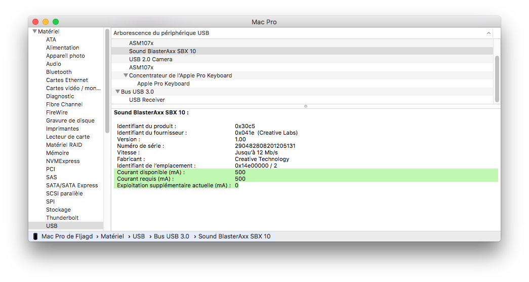

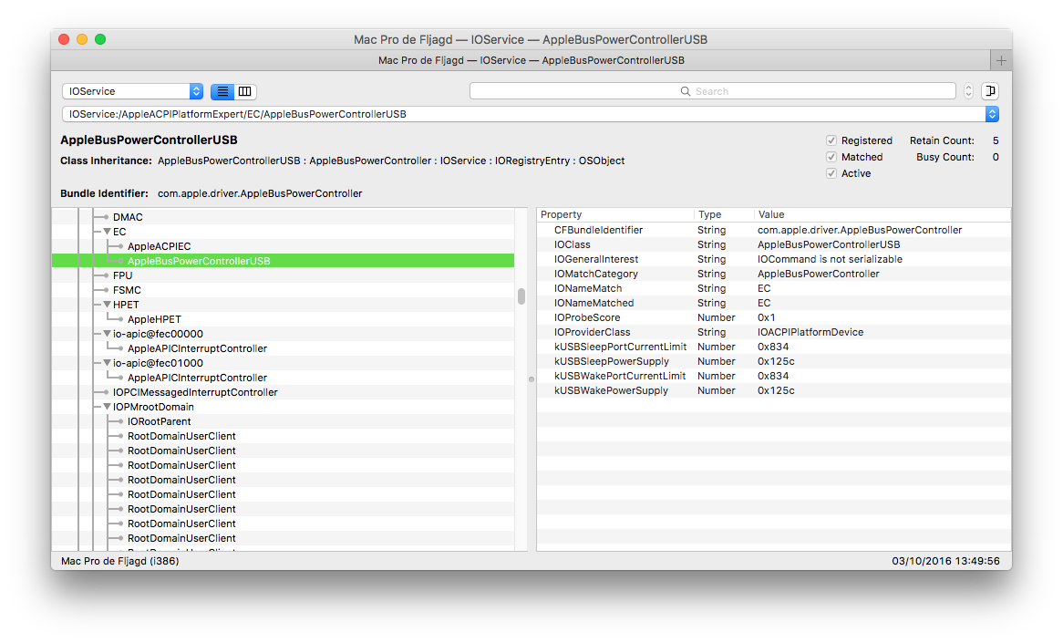

With X99 Board you can test to enable Apple Bus Power Controller USB
Rename
Scope (_SB.PCI0.LPC0)
        Device (EC0)
to
        Device (EC)
  • Like 3
With X99 Board you can't test to enable Apple Bus Power Controller USB
Rename
        Device (EC0)
to
        Device (EC)
Thank a lot  :thumbsup_anim:

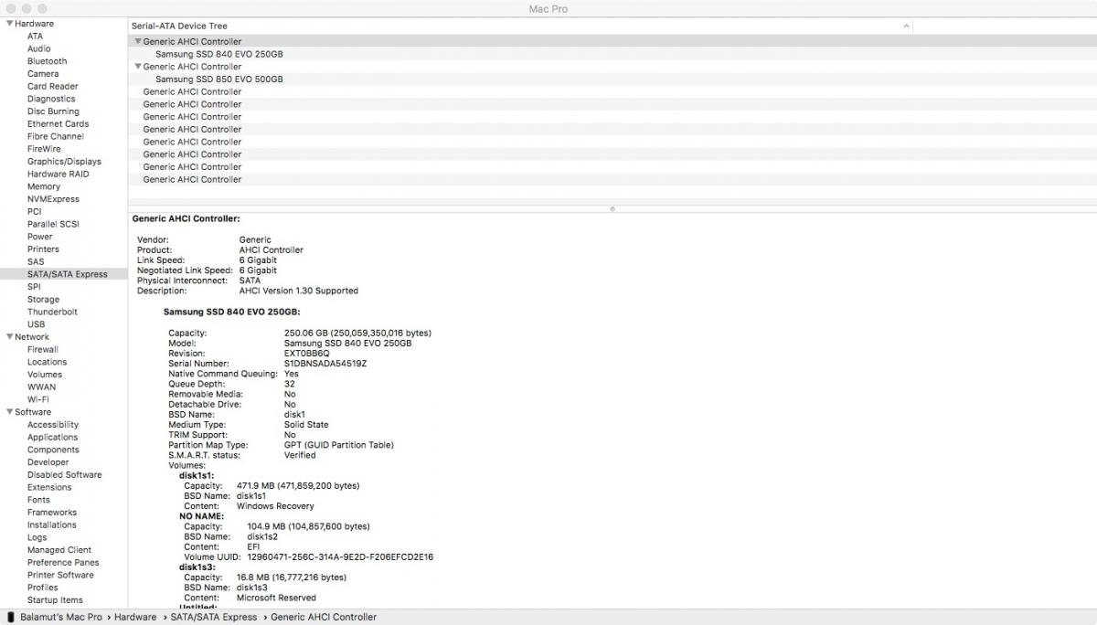

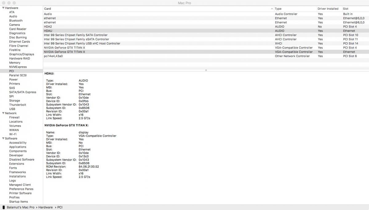

Hi nmano, sorry for a bit late response.
Almost everything on the DSDT worked perfectly just a few bugs.
Under SATA - it says generic AHCI controller while in PCIE details it says Intel 99 Series Chipset
Under PCIE and Graphics one of the GPU with HDAU it shows the slot as ethernet.
Also is there 4 _SB_SCK0-_SB_SCK4 in the DSDT do you think it some how affects the hyper threading crash?
Thanks a lot,

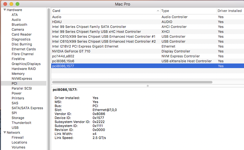

Hi Balamut
#Z10PE-D16 WS(Socket 2011-3 for Intel Xeon processor E5-2600 v4)
#With Dual graphic
#test and feedback
It is, it's more on the pro side then gaming.
Attaching the CPU power management screens, sorry for some odd reason I thought I zip them.
Ram is correct way, memtest, ubuntu and windows ran on 72h full load test and passed with flying colors, ESXI doesn't have the problem on it ether.
According to Slice there is an issue on getting the SPD info from the second controller and he's been trying to figure out the fix for a while.
On the Cpu he said something a long the line that ACPI might not be passed on correctly.
Tried the file with different FakeCPUIDs same result, panic with hyper threading and same issues on the installed system without.
@Balamut
Your bios is clearly different from "gaming and consumer " boards as I remembered
You miss to show CPU Advanced PM tuning
IF you find Enhanced intel speedstep technology you can try to disable it
In USB section many X99 guides advice to enable also EHCI hand off and set IntelXhci from auto to enabled
Then , In AI Overclock Tuner try to change to manual and see with parameters you could modify
You say also that you see only 32 Gb of 128 Gb
It seems that only one cpu is feed, are you sure you have ram in correct way? you should see 64 gb without any clover injection
But maybe all of these advice are not relevant for your problem if you have on this rig a solid microsoft windows working setup
Edit
if you want try to boot with the attached files
without any modify and then modifying in clover only fakecpuid from the existed to 306E0 before was 40674
Screenshots.zip

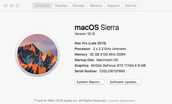

Sorry for the delay but only tonight i tried your files...everything is ok, peripherals are showed correctly and at the momento there are no bugs.
Thanks again for your help

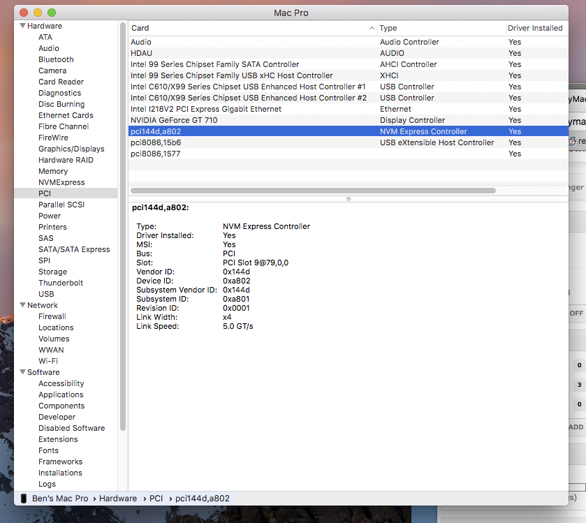

Hi Nmano, if you get a chance you you patch the DSDT for me also  :rolleyes:
1- uploaded
2 - uploaded
3 - gigabyte X99P-SLI and Bios version F23
4 - Graphics - Gigabyte GeForce GT 710 (954MHz), 1GB DDR3 (1600MHz), PCIE2.0, DVI, HDMI, VGA, Silent Fanless
      Sound - Onboard Realtek ALC1150
5 - sorry how do i go about getting this??
original dsdt.zip
ekwipt Mac Pro ioreg.zip
1- uploaded
2 - uploaded
Hi Ekwipt
#Gigabyte X99 P-SLI
#Test and Feedback
gigabyte X99P-SLI.zip
