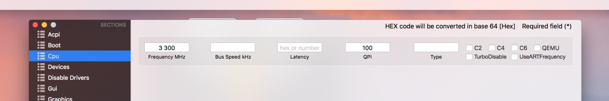

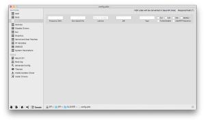

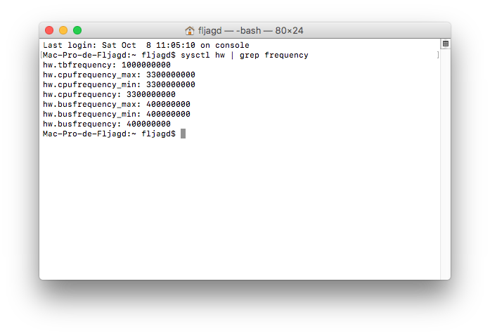

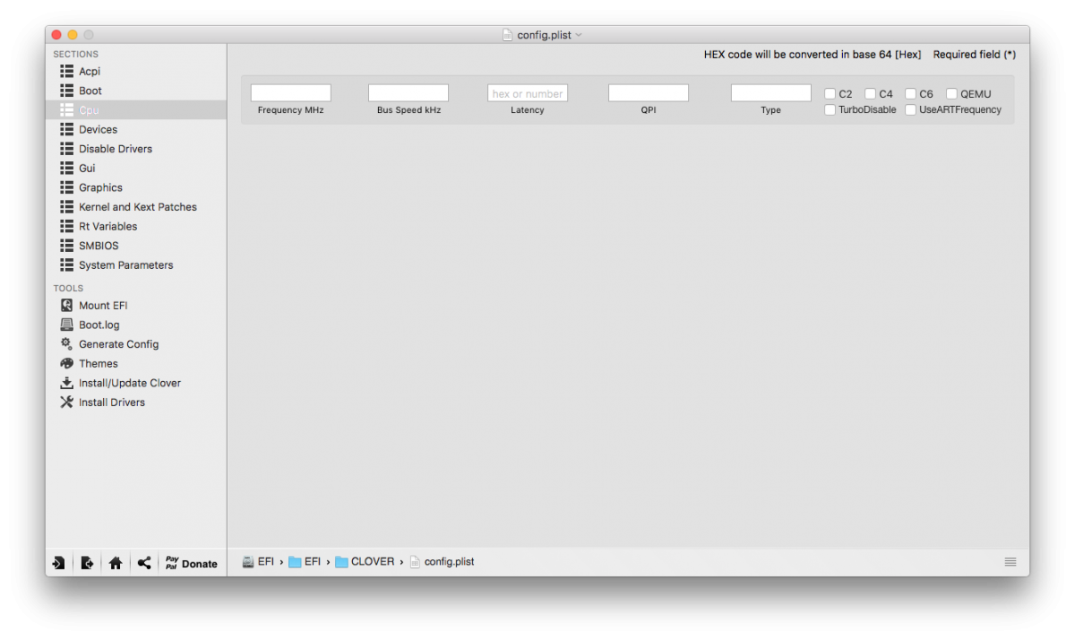

Bravò :-)
If you want setting QPI = 100 in clover bootloader you will solve this "problem":
Warning: Clover hw.busfrequency error detected : 17d78400​
then you have also this:
- Package Power Limit #1............... : 4095 Watt
- Enable Power Limit #1................ : 1 (enabled)
- Package Clamping Limitation #1....... : 1 (allow going below OS-requested P/T state during Time Window for Power Limit #1)
- Time Window for Power Limit #1....... : 10 (2560 milli-Seconds)
- Package Power Limit #2............... : 4095 Watt
but I don't know how you can solve it
isn't very important , I think
Thank again
Bravò :-)
Power Limit must be manually edited in Bios
Go to "Internal CPU Powermangement" in section Ai Tweaker.
Here you can set long duration power limit / time window....

By the way, a question!
According my CPU (signature), as I should correctly set this area for the CPU in Clover? Should I get put normal speed, or the turbo speed? Can anyone give me a hand? He is currently working as the picture, but I think that lack more information ...
Obrigado.
Obrigado.
Bom dia ( Figueira da Foz  :wink_anim: )
I put nothing
With QPI=100 now no mistake for initialTSC
AppleIntelInfo.kext v1.8c Copyright © 2012-2016 Pike R. Alpha. All rights reserved
Settings:
logMSRs..................................: 1
logIGPU..................................: 0
logCStates...............................: 1
logIPGStyle..............................: 1
InitialTSC...............................: 0x119ad3616cb8 (586 MHz)
MWAIT C-States...........................: 8480
Processor Brandstring....................: Intel(R) Core(TM) i7-5820K CPU @ 3.30GHz
Thank
