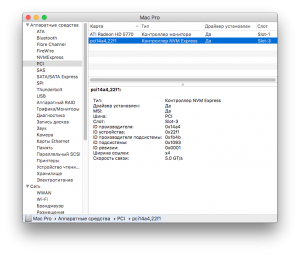

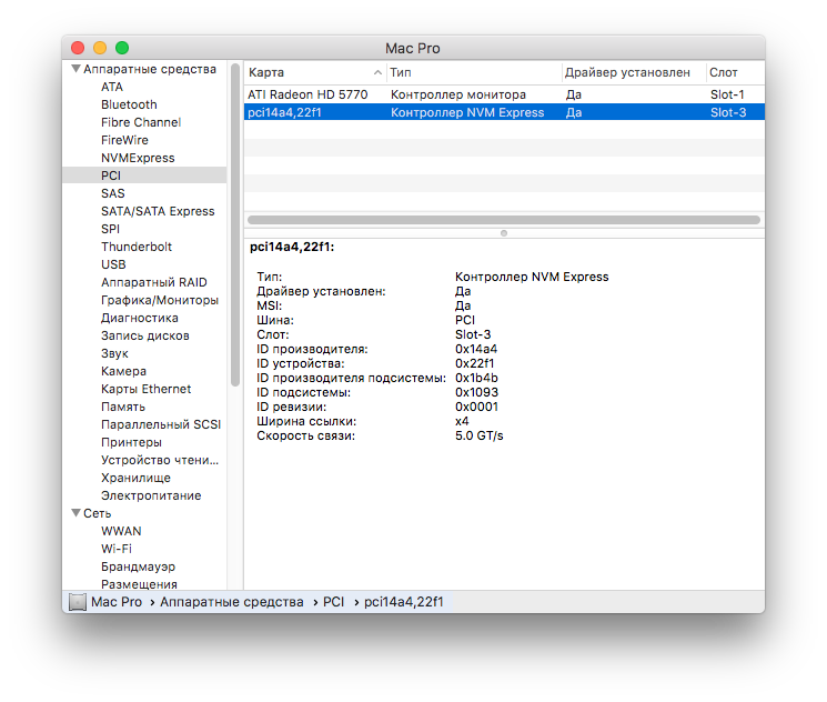

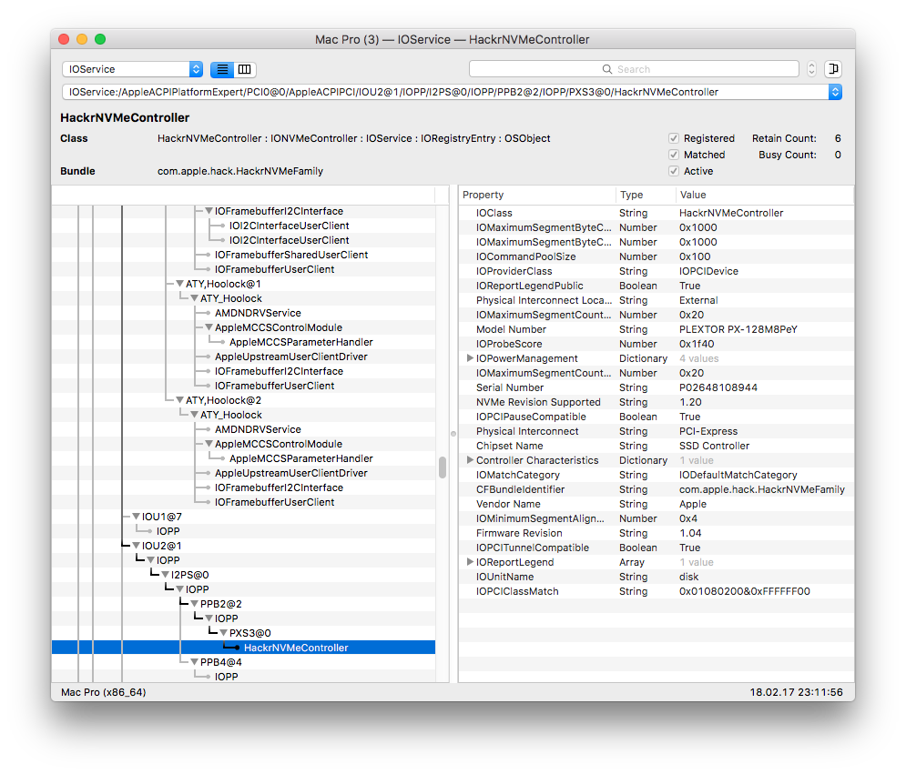

Hello, I'm trying to make working Plextor PX-128M8PeY with Mac Pro 5.1. OS 10.12.3. After these steps:
  1. Download patch https://github.com/RehabMan/patch-nvme
  2. Disable SIP
  3. Create HackrNVMeFamily.ktext with 10_12_3
  4. Use Kext Utility to put generated file in S/L/E of the OS
  5. I then delete IONVMeFamily.kext
  6. Install the PCIe w/NVMe SSDs into Mac Pro
  7.  Restart
​I,ve seen Apple SSD Controller but have no SSD Drive. Also IORegistry Explorer shows me my disk (look at the screenshot).
I'm trying to figure out what I should do regarding this post http://www.insanelymac.com/forum/topic/312803-patch-for-using-nvme-under-macos-sierra-is-ready/page-42?do=findComment&comment=2356251 but don't understand which file I have to edit. Actually, I have no any experience to setup Hackintosh computers, just need to upgrade my Mac.
Would you help me to connect SSD to computer?

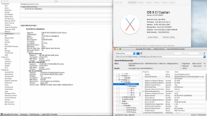

The attached file is my vanilla IONVMeFamily.kext of 10.11.6(15G31)
IONVMeFamily.kext.zip
Got it.
BTW and how are you patching this kext. Via @RehabMan's way or just KextToPatch?
I have done it by each way independently.
But both were failed.

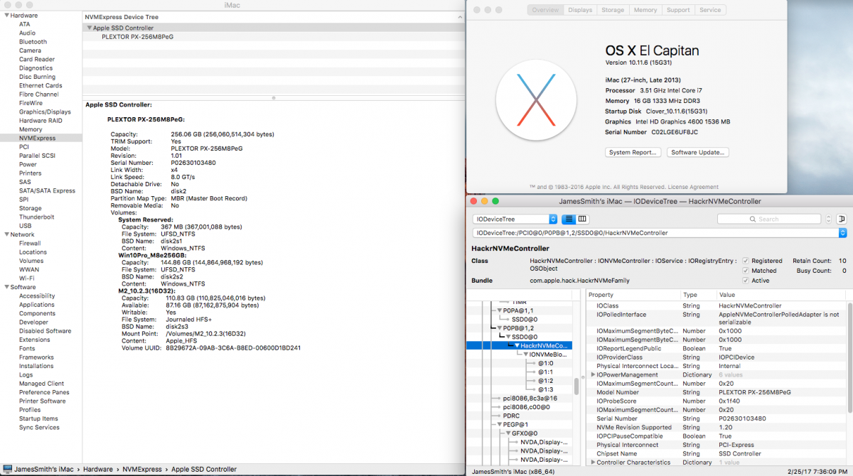

Big good news for me !
Combined your HackrNVMeFamily-10_11_6.kext with previous working config.plist at 10.12.x got it working at last at 10.11.6 now !
Great ! How magical the Hackintosh is !

Thank you again without your prompt reply and help I could not make it working at 10.11.6 !
By the way was this specific HackrNVMeFamily-10_11_6.kext patched by RehabMan's plist ?
It's quite strange because I have done it before at both 10.11.6 and 10.12.3, but not working with this HackrNVMeFamily.kext alone.
Only patched by Clover's config.plist working at 10.12.3 & 10.12.4, but not working at 10.11.6 with similar method by different patches.
[Edit]
At last I figure out why previous HackrNVMeFamily-10_2_3.kext not working even it was loaded.
I should not add Plextor specific patch or External -> Internal patch at the same time with RehabMan's plist.
I should complete RehabMan's plist at first, then add Plextor specific patch & External -> Internal patch to HackrNVMeFamily-10_2_3.kext by Hex Editor.
Follow this order HackrNVMeFamily-10_2_3.kext could be loaded and working now !
Thanks to Piker, RehabMan, syscl, Micky1979, & PMheart etc. without their patches & advice I can not get it working !

With some additional kexts you can get the 10.12 one *loading* but for reasons unknown it does not fully work on 10.11.
Anyway. I began work on an open source NVMe driver that would be a lot easier to use for everybody, (NVMe is supposed to be universal after all, it's a standardized protocol), but right now I'm not sure that I can work on it very much in the short term, although I wish to.
@jsl  I'm curious now, you say you have the Plextor M8Pe working under 10.11? Can you confirm this?
