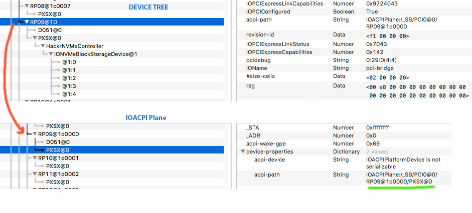

Tobinejumi Posted March 29, 2017 Share Posted March 29, 2017 Trying to move on spoof class patch, i've scanned my ioreg. Is this path ('_SB/PCI0@0/RP09@1d0000/PXSX@0') is what i need for my Samsung 960 evo (it's only one m2 drive in system)? Link to comment https://www.insanelymac.com/forum/topic/312803-patch-for-using-nvme-under-macos-sierra-is-ready/page/42/#findComment-2394644 Share on other sites More sharing options...

RehabMan Posted March 29, 2017 Share Posted March 29, 2017 Trying to move on spoof class patch, i've scanned my ioreg. Is this path ('_SB/PCI0@0/RP09@1d0000/PXSX@0') is what i need for my Samsung 960 evo (it's only one m2 drive in system)? Screen Shot 2017-03-29 at 22.17.54.png ACPI path is _SB.PCI0.RP09.PXSX I don't think there is any spoof class code in the IONVMeFamily of 10.11.6, it's a PCI ID instead in Info.plist? Spoof class code has been started since 10.12 if I remembered correctly? Extra injections required on 10.11.6 for certain SSDs are documented in my guide (linked from patch-nvme README). Link to comment https://www.insanelymac.com/forum/topic/312803-patch-for-using-nvme-under-macos-sierra-is-ready/page/42/#findComment-2394782 Share on other sites More sharing options...

Tobinejumi Posted March 30, 2017 Share Posted March 30, 2017 ACPI path is _SB.PCI0.RP09.PXSX Extra injections required on 10.11.6 for certain SSDs are documented in my guide (linked from patch-nvme README). SSDT patch created and installed, DSDT patch in clover config installed, spoof-code kext generated and installed - system boots up ok. Thank you! Here goes one question: do i still need to generate new spoof class kext after every system update? If so, can you add script for 10.11.6 2017-001 security update? Link to comment https://www.insanelymac.com/forum/topic/312803-patch-for-using-nvme-under-macos-sierra-is-ready/page/42/#findComment-2395101 Share on other sites More sharing options...
