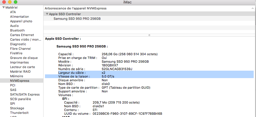

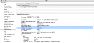

i use EFI v2 now with a spoofed HackrNVMeFamily.kext my system boot fine !!!!
but.... always in 5Gb/s transfert.... grrrrr !!!!!
I don't understand ... under windows it was perfectly recognized
And speeds were right
my case is hopeless.... forsake
Tomorrow I try to do a clean install....
Not a problem with the installation, but how the OS is working with your current hardware.
If it were me, I'd test it in Sierra 10.12.2 and see if I get the same slow result (just set up a "test bench" harddrive and not something for daily-use). Since you've already tested it in Windows 10 and get full read/write speeds, Mac OS might need to be upgraded, or your BIOS might need an update....
...or come to the conclusion that, unfortunately, your motherboard/hardware doesn't configure a NVMe drive well in a Unix environment.

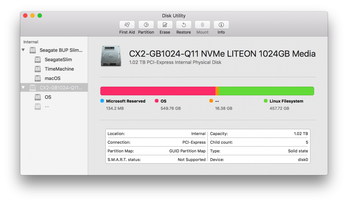

Couldn't make it work on Sierra, but running El Capitan on it, using NVMeGeneric.kext
For those who have issue on Disk Utility identified issue on some LiteOn, Plextor, Hynix NVMe.
Here's the code we need to change
test    cl, 0x10
jne     0x41d1
search for
0xF6 0xC1 0x10
0x0F 0x85 0x1C 0x01 0x00 0x00
change the value 0x10 into 0x01 or 0x02, 0x04 and 0x08 to see which one works for your drive.
For example, here's the patch I found for LiteOn CX2-1024
Comment: IONVMeFamily Preferred Block Size 0x10 -> 0x01 (c) Pike R. Alpha
find:    <f6c1100f 851c0100 00>
replace: <f6c1010f 851c0100 00>
Then enjoy your NVMe ;)
Good luck,
syscl

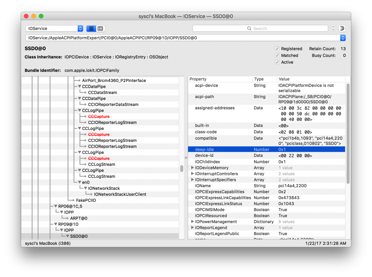

One of my friend has lent her new MacBook9,1 for me, and I soon found some properties rooted in Device (SSD0):
"deep-idle", here's the patch I applied for my XPS 13 9350:
#Created by syscl for Dell XPS 13 9350 patches
#Note: SSD0 must present under RP09
#NVMe _DSM stripped down credit Pike R. Alpha
#NVMe "deep-idle" property stripped down credit syscl
#NVMe Eliminate "sata-express-power-off" and "ssd-off-in-S4" credit syscl
into device label SSD0 parent_adr 0x001D0000 remove_entry;
into device name_adr 0x001D0000 insert
begin
Device (SSD0)\n
{\n
	Name (_ADR, Zero)\n
	Name (NVME, One)\n
	Method (_DSM, 4, NotSerialized)\n
	{\n
		If (LEqual (Arg2, Zero))\n
			Return (Buffer (One)\n
			{\n
				0x03\n
			})\n
		}\n
		If (LEqual (NVME, One))\n
		{\n
			Return (Package (0x06)\n
			{\n
				// "deep-idle" property stripped down credit syscl\n
				"deep-idle", \n
				One,\n
				"use-msi", \n
				One, \n
				"nvme-LPSR-during-S3-S4", \n
				One\n
			})\n
		}\n
		Else\n
		{\n
			Return (Package (0x02)\n
			{\n
				// refined else-if case credit syscl\n
				// eliminate "sata-express-power-off" and "ssd-off-in-S4" credit syscl\n
				"use-msi", \n
				One, \n
			})\n
		}\n
	}\n
}\n
end;
#PRT0 information property credit Pike R. Alpha
into device label PRT0 remove_entry;
into device label SAT0 insert begin
Device (PRT0)\n
{\n
	Name (_ADR, 0xFFFF)\n
	{\n
		{\n
			{\n
				0x03\n
			})\n
		}\n
		{\n
			"io-device-location", \n
			Buffer (0x04)\n
			{\n
				"SSD"\n
			}\n
		})\n
	}\n
}\n
end;
Notice, you need to change RP09 to your NVMe location(e.g. RP01, RP02 ...).
We no more need "sats-express-power-off" and "ssd-off-in-S4". And, yes, after injecting deep-idle, we can see this property in ioreg
syscl

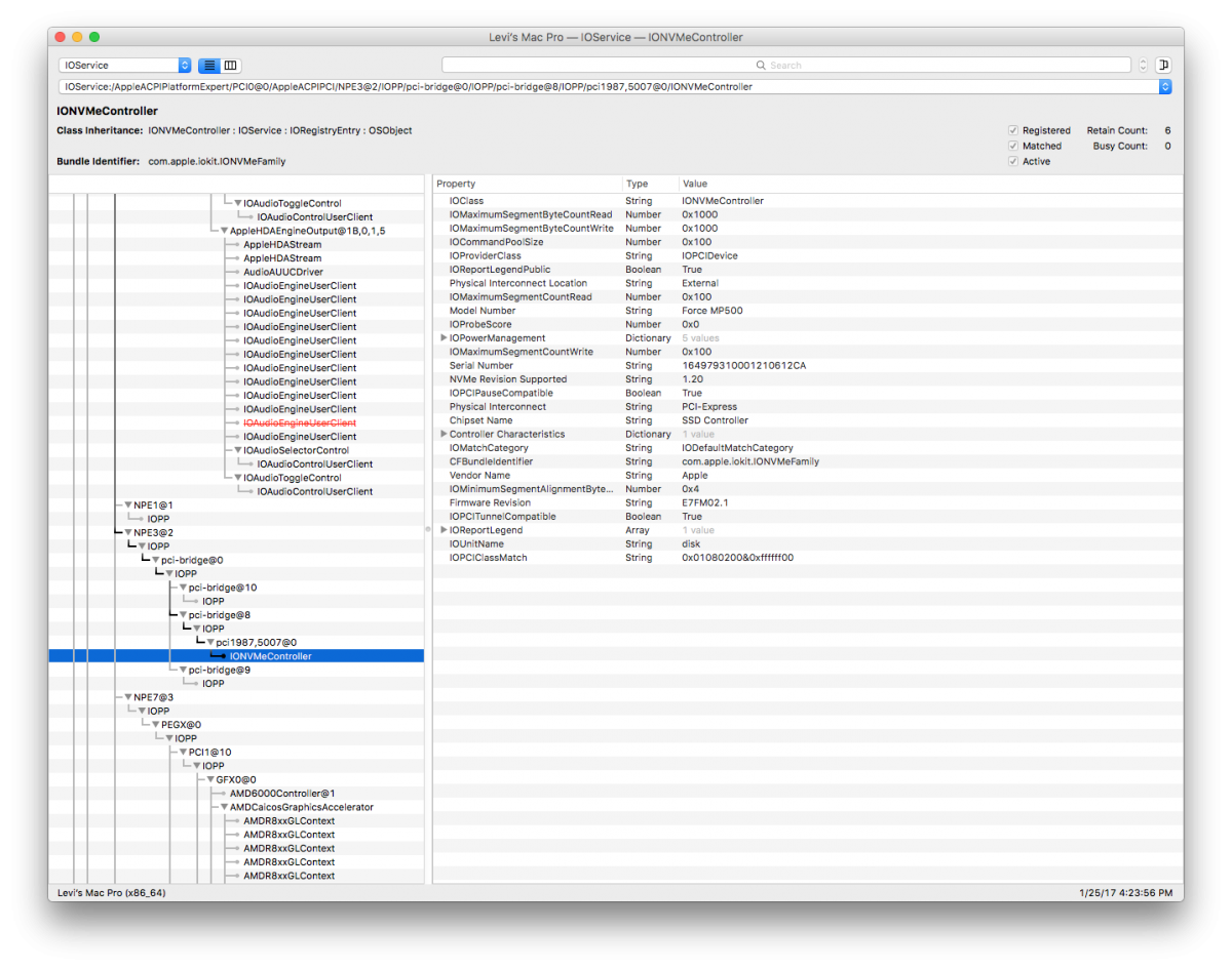

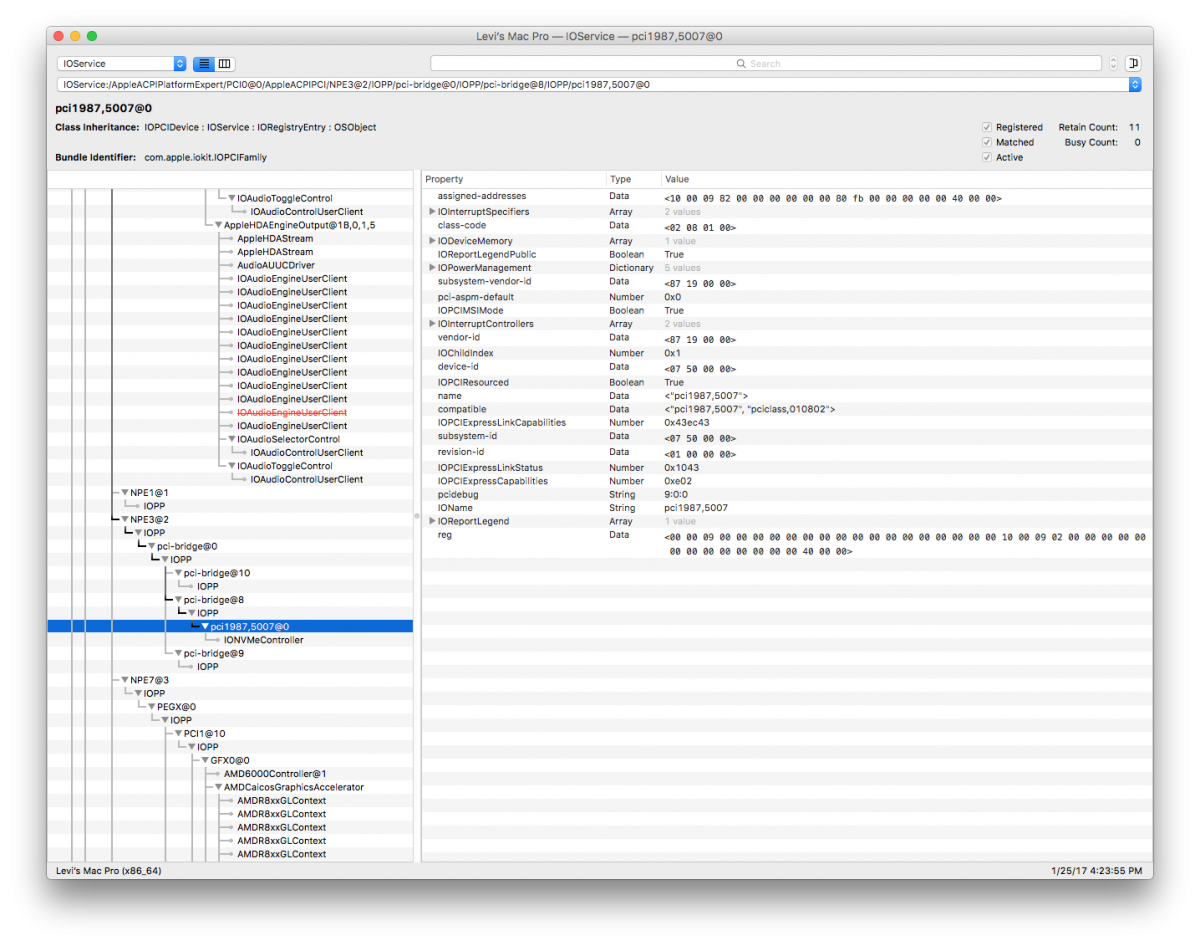

I have this drive (Corsair MP500 480GB) and its PCI ID info. How do I patch it to work? Already have `HackrNVMeFamily.kext` ready (System Information already detects NVMe activated, but no drives ATM).
Thanks.
EDIT: Attached screenshots of IORegistryExplorer. Drive shows up there perfectly…
Thanks.
It could be you don't need the patches enabled by HackrNVMeFamily (4k -> 512byte block size patches) and only need one of the patches mentioned in post #839.
So, delete HackrNVMeFamily kext and just use that single patch via config.plist?
Thank you! :)
UPDATE: Tried the Lite-On patch, no workie. Still detecting the "Apple SSD Controller" (in System Information), but still not populating it with the drive. I did notice an NVMe error during verbose boot:
"virtual bool IONVMeBlockStorageDevice::start(IOService *)::324:failed with status = 0xe00002c7)
AppleNVMe Assert failed: result StartFailureExit ....etc etc....."
Also, is there a way to get the verbose boot output in a file? I can't find that log anywhere… I have to video with my phone to get the above log!  :rolleyes:  Thanks!
UPDATE 2: removing the config.plist patch AND the kext gives me the same result: "Apple SSD Controller" is detected in System Information/NVMExpress but no drives… :(
From what I can gather, this should work with the patch-nvme script because the ID of this drive is already there ("pci1987,5007", same as "Zotac Sonix PCIe 480gb)… I'm confused why it's not working… :(
UPDATE:
Rebooted again back with a freshly patched HackrNVMeFamily kext. Seems like I get some additional error info:
ppleNVMe Assert failed: ( LBAFormat->LBA_DATA_SIZE == 12  ) CompleteBuffer file: /BuildRoot/.../IONVMeBlockStorageDevice.cpp line: 182
and then, similar as before:
AppleNVMe Assert failed: 0 == (status) QueueDelete file: /BuildRoot/.../IONVMeBlockStorageDevice.cpp line: 269
AookeNVMe Asser failed: result StartFailureExit file: /BuildRoot/.../IONVMeController line: 3277
Seems like a block size error, doesn't?
Hope this helps! :)

If you're on 10.12, and not using the class-code spoof, then keep in mind to use HackrNVMeFamily, you must delete IONVMeFamily.kext.
From reading your other posts, I realize the "class-code spoof" includes both the  "--spoof" when generating the HackrNVMeFamily but also some DSDT editing? Is that right? What changes should I make to my DSDT?
Thank you for all your work and help RehabMan! <3
The class-code spoof details are linked from the patch-nvme github README.
There is no need for me to repeat what is already written.
