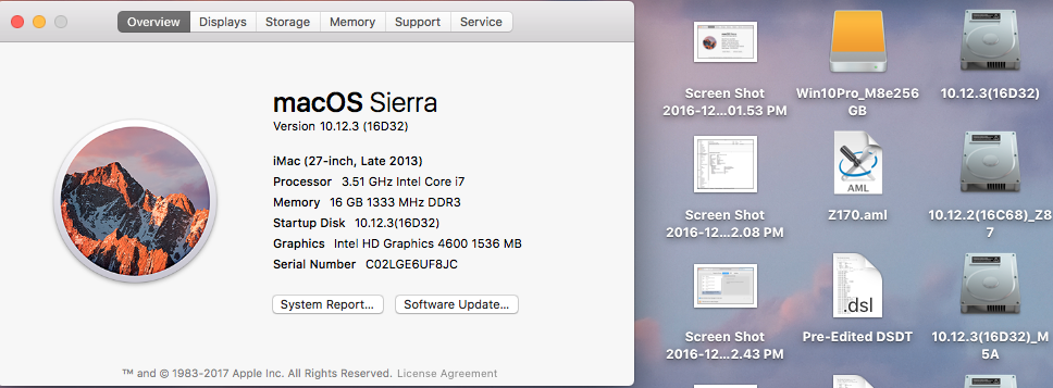

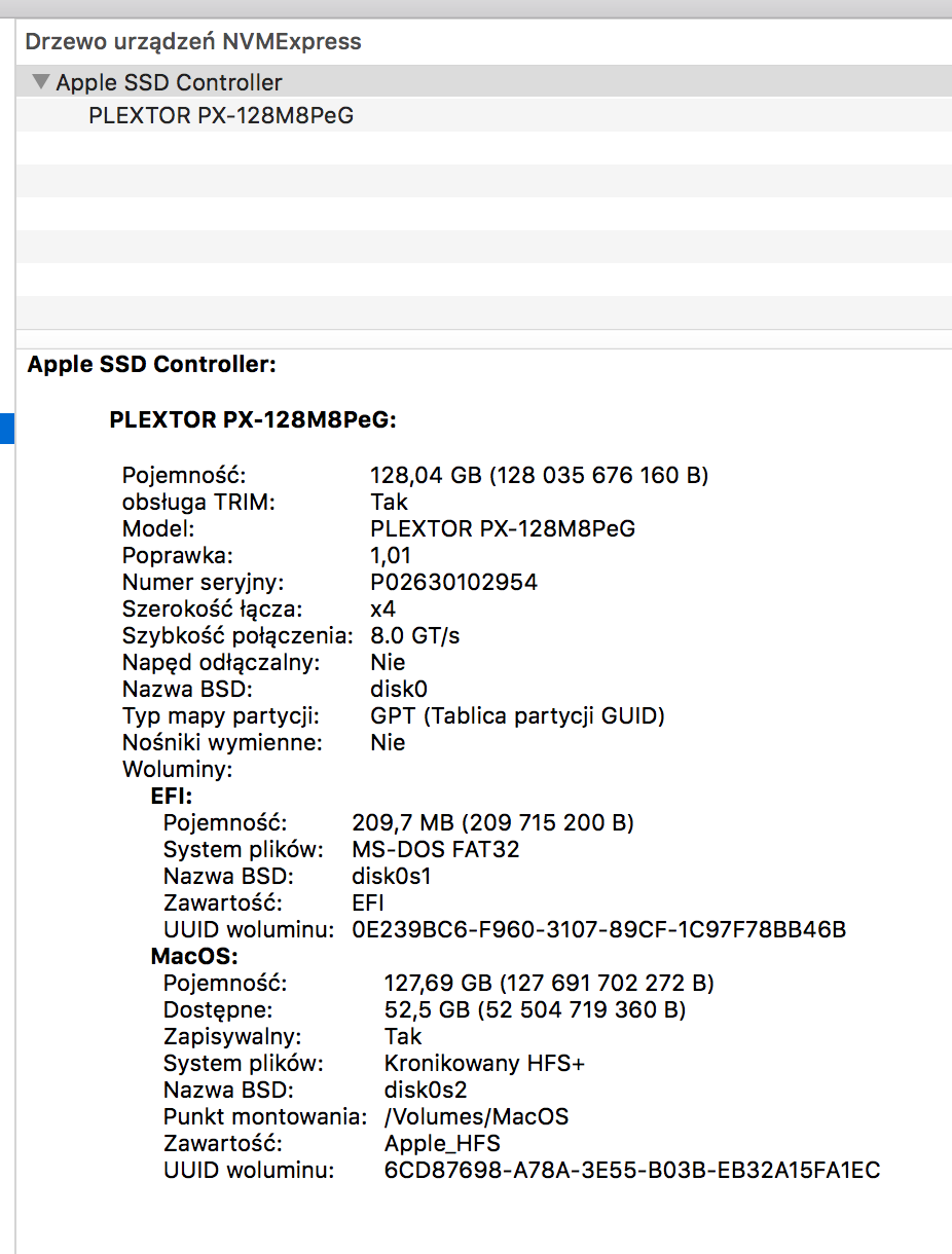

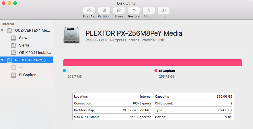

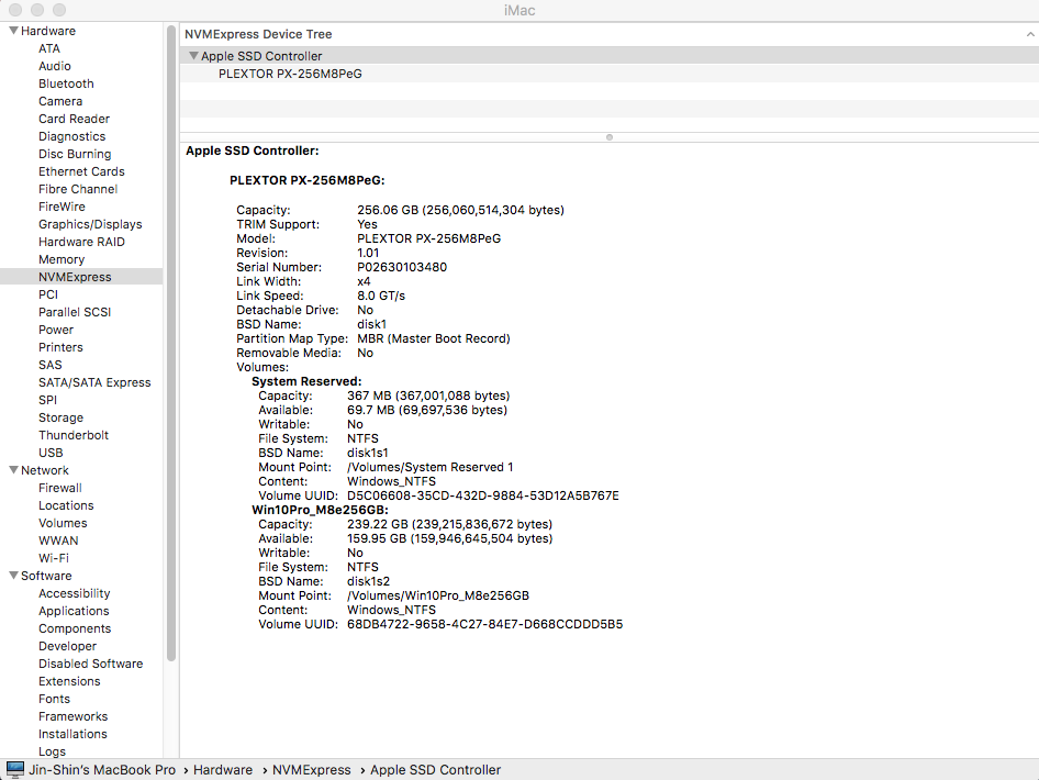

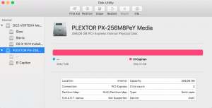

jsl Posted January 27, 2017 Share Posted January 27, 2017 Thank You. Working great (PLEXTOR PX-128M8PeG) Zrzut ekranu 2017-01-26 o 18.41.11.png Hi, Matthew82 & DMMA: Thanks for your config-nvme.plist which is also working for Plextor 256M8PeG M.2 SSD in my Asus Z87 Deluxe/Dual hackintosh at 10.12.2(16C68) & 10.12.3(16D32) now ! But it did not work at 10.11.6(15G31). The only pity is it's shown as an external SSD instead of internal one. Link to comment https://www.insanelymac.com/forum/topic/312803-patch-for-using-nvme-under-macos-sierra-is-ready/page/35/#findComment-2357856 Share on other sites More sharing options...
RehabMan Posted January 27, 2017 Share Posted January 27, 2017 Hi, Matthew82 & DMMA: Thanks for your config-nvme.plist which is also working for Plextor 256M8PeG M.2 SSD in my Asus Z87 Deluxe/Dual hackintosh at 10.12.2(16C68) & 10.12.3(16D32) now ! But it did not work at 10.11.6(15G31). The only pity is it's shown as an external SSD instead of internal one. The patch would need to be different for 10.11.x. Adding an ACPI identity (with an SSDT) for the NVMe device and injecting "built-in" should fix the internal vs. external problem. 1 Link to comment https://www.insanelymac.com/forum/topic/312803-patch-for-using-nvme-under-macos-sierra-is-ready/page/35/#findComment-2358252 Share on other sites More sharing options...
syscl Posted January 27, 2017 Share Posted January 27, 2017 Hi, Matthew82 & DMMA: Thanks for your config-nvme.plist which is also working for Plextor 256M8PeG M.2 SSD in my Asus Z87 Deluxe/Dual hackintosh at 10.12.2(16C68) & 10.12.3(16D32) now ! But it did not work at 10.11.6(15G31). The only pity is it's shown as an external SSD instead of internal one. 10.11.x, try this one Comment: Preferred Block Size 0x10 -> 0x01 (c) Pike R. Alpha implement by syscl for 10.11.x Name: IONVMeFamily MatchOS: 10.11.x find: <f6c11075 6b> replace: <f6c10175 6b> Through Clover config.plist the raw format will be <dict> <key>Comment</key> <string>Preferred Block Size 0x10 -> 0x01 (c) Pike R. Alpha implement by syscl for 10.11.x</string> <key>Disabled</key> <true/> <key>Find</key> <data> 9sEQdWs= </data> <key>MatchOS</key> <string>10.11.x</string> <key>Name</key> <string>IONVMeFamily</string> <key>Replace</key> <data> 9sEBdWs= </data> </dict> syscl 1 Link to comment https://www.insanelymac.com/forum/topic/312803-patch-for-using-nvme-under-macos-sierra-is-ready/page/35/#findComment-2358411 Share on other sites More sharing options...
PMheart Posted January 28, 2017 Share Posted January 28, 2017 (edited) Hi. I found that the external icon patch had been changed under 10.12.4 16E144f. This is for 10.12.4. FYI. 48 85 C0 74 07 80 8B 18 01 00 00 10 ==> 90 90 90 90 90 80 8B 18 01 00 00 10 # 10.12.4+ Previous the $8 was 0x08 and now it’s 0x18. PMheart ========== Update: @jsl for 10.11 you may need this one to fix the external icons issue: 48 85 C0 74 07 80 8B 00 01 00 ==> 90 90 90 90 90 80 8B 00 01 00 # 10.11.x Note: The patches are for IONVMeFamily. Edit: Pike has provided the external patch already! Deprecated. PMheart Edited January 28, 2017 by PMheart 1 Link to comment https://www.insanelymac.com/forum/topic/312803-patch-for-using-nvme-under-macos-sierra-is-ready/page/35/#findComment-2358528 Share on other sites More sharing options...
jsl Posted January 28, 2017 Share Posted January 28, 2017 10.11.x, try this one Comment: Preferred Block Size 0x10 -> 0x01 (c) Pike R. Alpha implement by syscl for 10.11.x Name: IONVMeFamily MatchOS: 10.11.x find: <f6c11075 6b> replace: <f6c10175 6b> Through Clover config.plist the raw format will be <dict> <key>Comment</key> <string>Preferred Block Size 0x10 -> 0x01 (c) Pike R. Alpha implement by syscl for 10.11.x</string> <key>Disabled</key> <true/> <key>Find</key> <data> 9sEQdWs= </data> <key>MatchOS</key> <string>10.11.x</string> <key>Name</key> <string>IONVMeFamily</string> <key>Replace</key> <data> 9sEBdWs= </data> </dict> syscl Thanks for your advice and help. Is this patch in config.plist to replace previous one in Post# 858 ? Or it is an extra one for 10.11.x ? Because I have tried both methods and still not working yet at 10.11.6 Link to comment https://www.insanelymac.com/forum/topic/312803-patch-for-using-nvme-under-macos-sierra-is-ready/page/35/#findComment-2358551 Share on other sites More sharing options...
jsl Posted January 28, 2017 Share Posted January 28, 2017 Hi. I found that the external icon patch had been changed under 10.12.4 16E144f. This is for 10.12.4. FYI. 48 85 C0 74 07 80 8B 18 01 00 00 10 ==> 90 90 90 90 90 80 8B 18 01 00 00 10 # 10.12.4+ Previous the $8 was 0x08 and now it’s 0x18. PMheart ========== Update: @jsl for 10.11 you may need this one to fix the external icons issue: 48 85 C0 74 07 80 8B 00 01 00 ==> 90 90 90 90 90 80 8B 00 01 00 # 10.11.x Note: The patches are for IONVMeFamily. PMheart Thanks for your advice and help. The following patch in config.plist solved my previous yellowish external HD icon issue now. <dict> <key>Comment</key> <string>IONVMeFamily Pike R. Alpha Patch#External</string> <key>Disabled</key> <false/> <key>Find</key> <data> SIXAdAeAiwgBAAAQ </data> <key>Name</key> <string>IONVMeFamily</string> <key>Replace</key> <data> kJCQkJCAiwgBAAAQ </data> </dict> Link to comment https://www.insanelymac.com/forum/topic/312803-patch-for-using-nvme-under-macos-sierra-is-ready/page/35/#findComment-2358552 Share on other sites More sharing options...
PMheart Posted January 28, 2017 Share Posted January 28, 2017 Thanks for your advice and help. The following patch in config.plist solved my previous yellowish external HD icon issue now. <dict> <key>Comment</key> <string>IONVMeFamily Pike R. Alpha Patch#External</string> <key>Disabled</key> <false/> <key>Find</key> <data> SIXAdAeAiwgBAAAQ </data> <key>Name</key> <string>IONVMeFamily</string> <key>Replace</key> <data> kJCQkJCAiwgBAAAQ </data> </dict> Glad to hear that. Congratulations! Oops. Pike has already provided that! Link to comment https://www.insanelymac.com/forum/topic/312803-patch-for-using-nvme-under-macos-sierra-is-ready/page/35/#findComment-2358560 Share on other sites More sharing options...
syscl Posted January 28, 2017 Share Posted January 28, 2017 Thanks for your advice and help. Is this patch in config.plist to replace previous one in Post# 858 ? Or it is an extra one for 10.11.x ? Because I have tried both methods and still not working yet at 10.11.6 Seems you do not implement NVMe patches completely. 10.11.x use different NVMe patches, first you need to apply patches 10.11.x then add my patch to Clover. Notice my patch MatchOS=10.11.x, thus you don't need to worry about it will be applied to 10.12.x syscl Link to comment https://www.insanelymac.com/forum/topic/312803-patch-for-using-nvme-under-macos-sierra-is-ready/page/35/#findComment-2358572 Share on other sites More sharing options...
