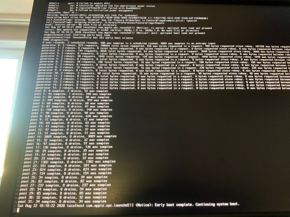

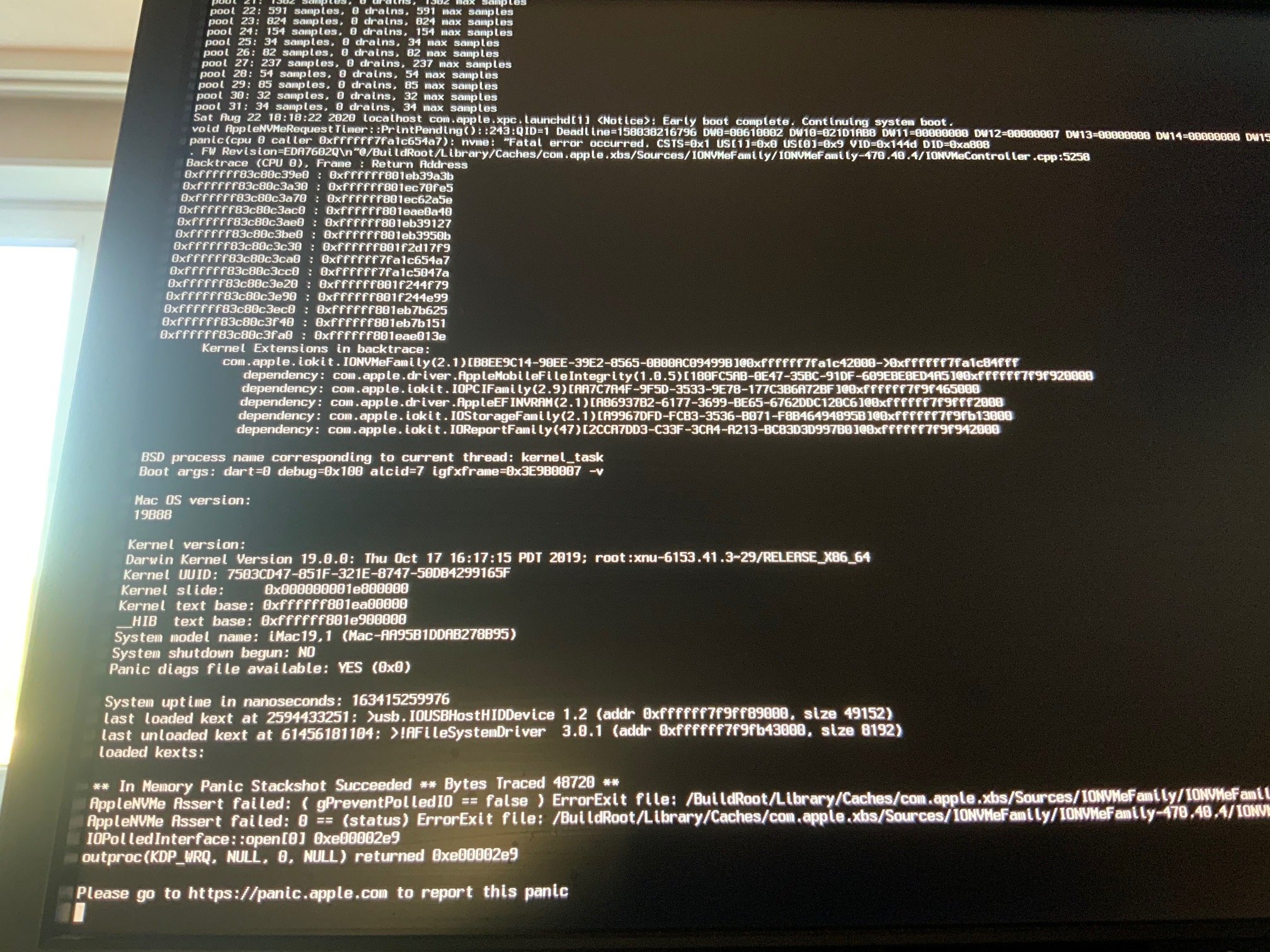

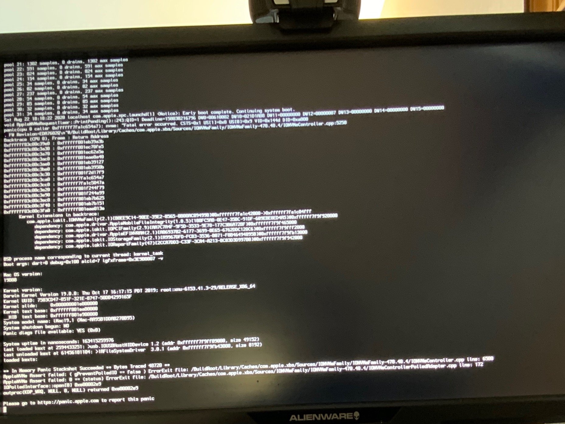

Hi!
Recently I bought an Enterprise M.2 NVMe SSD Samsung 983 DCT M.2 1.92TB (MZ-1LB1T9N). I’m trying to launch the Mac OS 10.15.5 in 1-st configuration with it on board. Getting such panic report:
000009.780357 AppleUSB20HubPort@14d20000: AppleUSB20HostPort::disconnect: persistent enumeration failures
panic(cpu 0 caller 0xffffff7f878004a7): nvme: “Fatal error occurred. CSTS=0x1 US[1]=0x0 US[0]=0xa VID=0x144d DID=0xa808
. FW Revision=EDA7602Q\n@/BuildRoot/Library/Cashes/com.apple.xbs/Sources/IONVMeFamily/IONVMeFamily-470.40.4/IONVMeController.cpp:5258
Without SSD in M.2 slot the system launches well. Screenshots are attached.
Configurations:
1. Asus Maximus XI Hero: Intel Core i9-9900K (LGA 1155-2), Z370, 32GB DDR4 3200MHz, Intel UHD Graphics 630, Samsung 983 DCT M.2 1.92TB (MZ-1LB1T9N) NVMe Express PCIe 3.0 x4 SSD; macOS 10.15.5/Windows 10
2. Asus P8Z68-V GEN3: Intel Core i7-2600K (LGA 1155), Z68, 16GB DDR3 1600MHz, Asus nVidia GT 710 2gd5, Samsung SSD 860 EVO 1TB SATA 3; macOS 10.15.5/Windows 10
Edited by mrAlexis777
