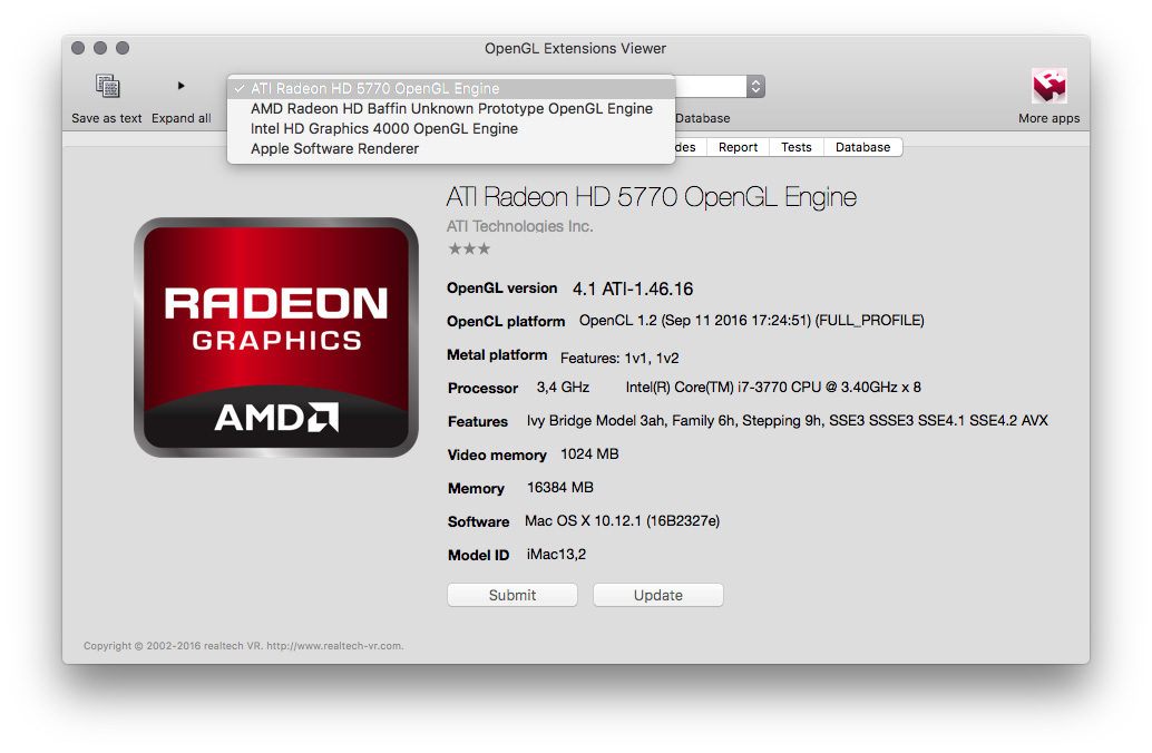

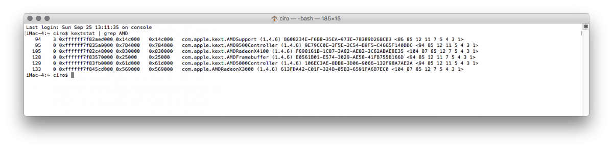

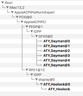

Ciro82 Posted September 21, 2016 Author Share Posted September 21, 2016 and it comes even better: NEW KEXT: AMDRadeonX4100.kext So BAFFIN FB is no longer integrated into AMDRadeonX4000.kext - now it has its own one! And X4000 doesn't contains Ellesmere? Meh... Link to comment https://www.insanelymac.com/forum/topic/312582-amd-polaris-ids-on-sierra-high-sierra/page/7/#findComment-2281632 Share on other sites More sharing options...
Mork vom Ork Posted September 21, 2016 Share Posted September 21, 2016 And X4000 doesn't contains Ellesmere? Meh... nope. but i havent look into the code of X4100 yet, cause currently i am at work, sorry... 1 Link to comment https://www.insanelymac.com/forum/topic/312582-amd-polaris-ids-on-sierra-high-sierra/page/7/#findComment-2281641 Share on other sites More sharing options...

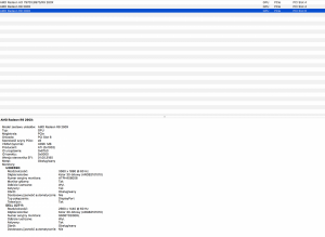

Mork vom Ork Posted September 24, 2016 Share Posted September 24, 2016 Hey folks, i have made some further more investigations: Plugged in my Sapphire R9 280x in PCI-Slot#1 Plugged in my Sapphire RX460 Nitro in PCI-Slot#2 Disabled IGPU in BIOS completely started ASRock Z170 Extreme7+ with latest CLOVER Rev. 3769 System started perfectly, as shown in the following screens: 1) Systeminformation Monitor: as you can see: just two VideoCards - one Radeon R9 280x and one Radeon RX460 Nitro 2) DPCIManager: So here you can see also just these two VideoCards: R9 280x and RX460 Nitro 3) IORegistryExplorer: R9 280X in PCI-Slot#1 just loaded AMDRadeonX4000.kext while... Radeon RX460 in PCI-Slot#2 just loaded AMDRadeonX4100.kext. So, both cards running native right now - but i think the only reason for this is, because the Radeon R9 280x is running "out-of-the-box", even under macOS Sierra. So my thougts are the following: all we have to find out, is why is the R9 280x running "nativ out-of-the-box"? Why we have to find out? Cause plugging the RX460 in Slot#1 (making THIS the primary gfx) and the R9 280X in Slot#2 (secondary gfx) gives the same black screen as using the RX460 on it's own (primary, stand-alone). Maybe it is just a VBios patch we need, maybe it is somewhat within AMD7000Controller.kext we have to investigate - but right now the only way to make it work is using a) IGPU as primary gfx or b ) a working out-of-the-box card in first PCI-Slot as primary gfx. ! So, common people, let's get back to work and find out ! Link to comment https://www.insanelymac.com/forum/topic/312582-amd-polaris-ids-on-sierra-high-sierra/page/7/#findComment-2284546 Share on other sites More sharing options...

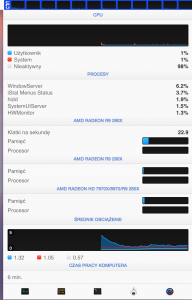

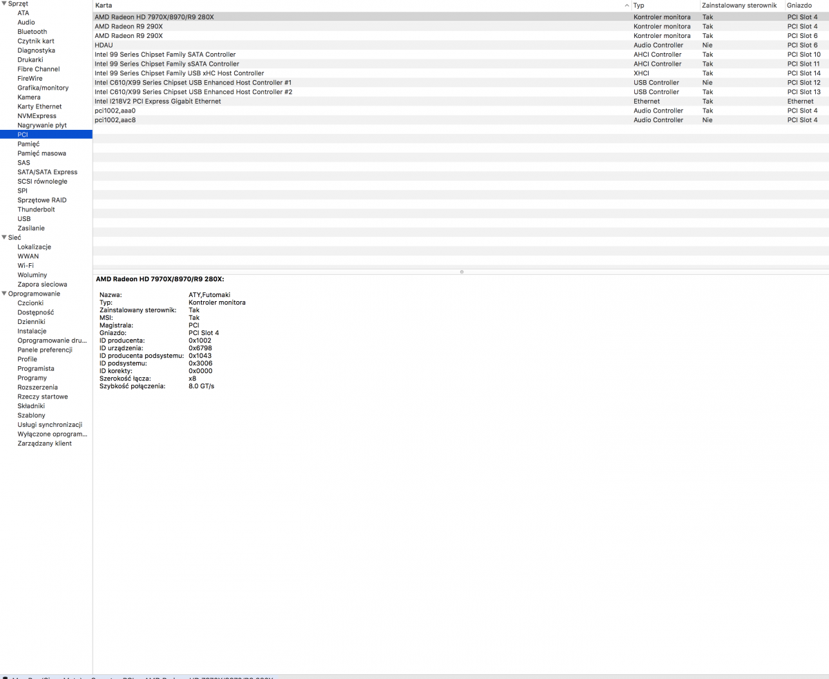

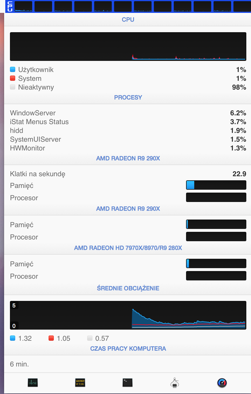

Matthew82 Posted September 25, 2016 Share Posted September 25, 2016 This is my solution for black screen issue. But I thing if you put slow gpu to first slot it will downgrade speed of this better. So I wos trying with low profile quadro 2000 in 1 slot and then turn off acceleration by adding fake id to invidia. Then 290x working faster but there wos random system KP on booting. Tomorrow i'll try HD5770 + RX480 and see what i can do. I think that Sierra won't load two different radeon acceleration kext Link to comment https://www.insanelymac.com/forum/topic/312582-amd-polaris-ids-on-sierra-high-sierra/page/7/#findComment-2284849 Share on other sites More sharing options...
Ciro82 Posted September 25, 2016 Author Share Posted September 25, 2016 I think that Sierra won't load two different radeon acceleration kext Are you sure? Link to comment https://www.insanelymac.com/forum/topic/312582-amd-polaris-ids-on-sierra-high-sierra/page/7/#findComment-2284881 Share on other sites More sharing options...
Matthew82 Posted September 25, 2016 Share Posted September 25, 2016 Are you sure? No Good that is working 1 Link to comment https://www.insanelymac.com/forum/topic/312582-amd-polaris-ids-on-sierra-high-sierra/page/7/#findComment-2284891 Share on other sites More sharing options...
Mork vom Ork Posted September 25, 2016 Share Posted September 25, 2016 Made the same test here with an AMD HD5450 successfully: HD5450 in Slot#1, RX460 in Slot#2 - bothe cards running native with their corrected FrameBuffers. So now i have a small HD5450, which needs no extra powerconnector, and a full supported RX460 running native. I have also made the following situation: disabled CSR in BIOS, so all connected devices should have UEFI compliant OROM. My Sapphire R9 280x got two BIOS Roms (switchable). One VBIOS included UEFI GOP, the other one only contains legacy VBIOS. When i boot CSR disabled and VBIOS with GOP, i get black screen after verbose boot! When i boot CSR disabled and VBIOS legacy, i get into macOS 10.12.1 after verbose boot.! When i boot CSR enabled and video OROM set to legacy, VBIOS with GOP i get into macOS 10.2.1 after verbose boot. When i boot CSR enabled and video OROM set to UEFI, VBIOS with GOP i get black screen after verbose boot. In all these described situations, my RX460 was active all the time in Slot#2 Of cause, that might be mean nothing - but i find it interesting and thought some might find this interesting. Also the fact, that all this doesn't happen, when running the R9 280X solo. Link to comment https://www.insanelymac.com/forum/topic/312582-amd-polaris-ids-on-sierra-high-sierra/page/7/#findComment-2285178 Share on other sites More sharing options...

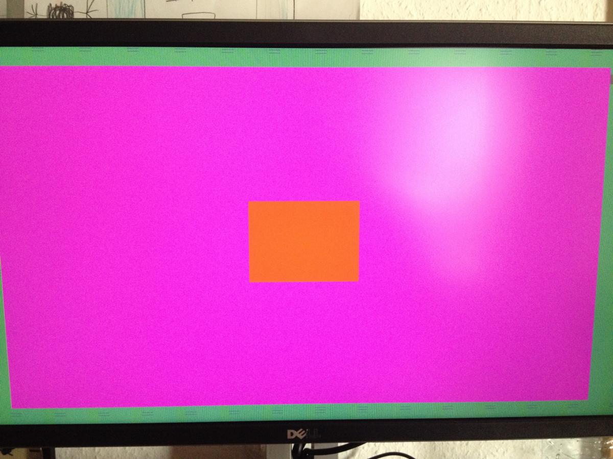

wern apfel Posted October 2, 2016 Share Posted October 2, 2016 I'm not satisfied with this card (RX 460), and will probably sent it back. After a few tests the fans became pretty annoying, most of the time they are off but spins up while scrolling some pages and watching videos. Also the bios splash screen looks like this. Link to comment https://www.insanelymac.com/forum/topic/312582-amd-polaris-ids-on-sierra-high-sierra/page/7/#findComment-2291545 Share on other sites More sharing options...
Ciro82 Posted October 2, 2016 Author Share Posted October 2, 2016 I'm not satisfied with this card (RX 460), and will probably sent it back. After a few tests the fans became pretty annoying, most of the time they are off but spins up while scrolling some pages and watching videos. Also the bios splash screen looks like this. bios.jpg That seems a DOA card... Link to comment https://www.insanelymac.com/forum/topic/312582-amd-polaris-ids-on-sierra-high-sierra/page/7/#findComment-2291569 Share on other sites More sharing options...
Tusskan Posted October 2, 2016 Share Posted October 2, 2016 I'm not satisfied with this card (RX 460), and will probably sent it back. After a few tests the fans became pretty annoying, most of the time they are off but spins up while scrolling some pages and watching videos. Also the bios splash screen looks like this. bios.jpg Quickly RMA it, this is bad card. Link to comment https://www.insanelymac.com/forum/topic/312582-amd-polaris-ids-on-sierra-high-sierra/page/7/#findComment-2291575 Share on other sites More sharing options...

wern apfel Posted October 3, 2016 Share Posted October 3, 2016 That seems a DOA card... Quickly RMA it, this is bad card. I don't think that the card is faulty, beside the annoying fans it works well, and the boot screen looks normal on non UHD displays. Link to comment https://www.insanelymac.com/forum/topic/312582-amd-polaris-ids-on-sierra-high-sierra/page/7/#findComment-2291875 Share on other sites More sharing options...
