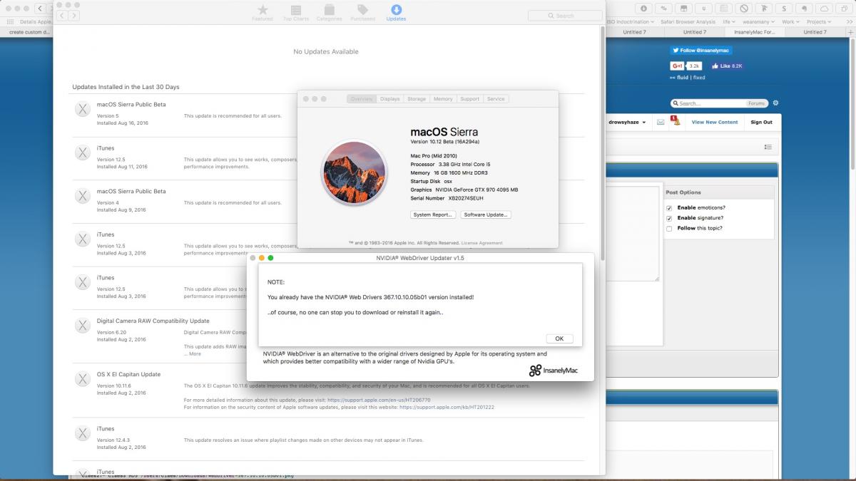

drowsyhaze Posted August 16, 2016 Share Posted August 16, 2016 Sorry for triple post - can't access full editor in edit mode... To be doubly sure, installed PB5 and no driver update necessary (had to use nv_disable=1 at boot to get installer to work): Link to comment https://www.insanelymac.com/forum/topic/312525-nvidia-web-driver-updates-for-macos-sierra-update-sept-27-2019/page/8/#findComment-2266510 Share on other sites More sharing options...

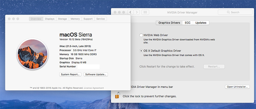

Squidderlee Posted August 17, 2016 Share Posted August 17, 2016 Nothing but tears and pulling out clumps of hair! This 367.10.10.05b0367.10.10.05b0 patch is utterly useless on my system. Simply refuses to load every time! Where Graphics should be reading NVIDIA GeForce GTX 750 Ti 2047 MB it only reads Display 6Mb.I Sincerely hope there will be a stable working driver that supports all Metal Cards by the time the GM is announced - and that can't be far away at all now. Doubt very much indeed that this is a Clover issue as El Capitan and nVidia have been great throughout and indeed I don't recall too many issues like this in the betas. Here we've gone from PB3 to PB5 in a short window indeed a.d we have had the same patched driver rather than an updated one that works! Link to comment https://www.insanelymac.com/forum/topic/312525-nvidia-web-driver-updates-for-macos-sierra-update-sept-27-2019/page/8/#findComment-2266557 Share on other sites More sharing options...
drowsyhaze Posted August 17, 2016 Share Posted August 17, 2016 Nothing but tears and pulling out clumps of hair! This 367.10.10.05b0367.10.10.05b0 patch is utterly useless on my system. Simply refuses to load every time! Where Graphics should be reading NVIDIA GeForce GTX 750 Ti 2047 MB it only reads Display 6Mb. I Sincerely hope there will be a stable working driver that supports all Metal Cards by the time the GM is announced - and that can't be far away at all now. Doubt very much indeed that this is a Clover issue as El Capitan and nVidia have been great throughout and indeed I don't recall too many issues like this in the betas. Here we've gone from PB3 to PB5 in a short window indeed a.d we have had the same patched driver rather than an updated one that works! What does "nvram -p" output in terminal? (This thread is a vacuum of lost posts) Edit: As far as I can tell this has to do with changes in the OS around SIP that clover hasn't dealt with. I, too, have never had GPU issues with betas or El Captain until PB3 (didn't try previous Sierra betas), which forced me to enter nv_drv=1 into the NVRAM for the OS rather than in Clover, at boot, for the first time (on a non-EFI motherboard). Link to comment https://www.insanelymac.com/forum/topic/312525-nvidia-web-driver-updates-for-macos-sierra-update-sept-27-2019/page/8/#findComment-2266564 Share on other sites More sharing options...

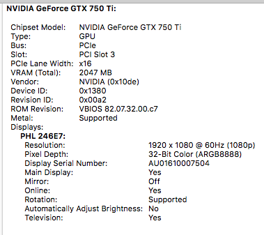

Squidderlee Posted August 17, 2016 Share Posted August 17, 2016 I have the EmuVariableUEFI-64 installed and just tried booting with Inject Nvidia... no difference at all! what is your issue with GTX750Ti? mine is working with PB5 What is my issue? really?... can't explain it any simpler than I already did... and even provided a screenshot! Seems it will load for some but not others!added (again) sudo nvram nvda_drv=1 nvram -p just spews out a load or random stuff and not any kind of ordered list from what I can see... Link to comment https://www.insanelymac.com/forum/topic/312525-nvidia-web-driver-updates-for-macos-sierra-update-sept-27-2019/page/8/#findComment-2266672 Share on other sites More sharing options...
ergot Posted August 17, 2016 Share Posted August 17, 2016 I have the EmuVariableUEFI-64 installed and just tried booting with Inject Nvidia... no difference at all! What is my issue? really?... can't explain it any simpler than I already did... and even provided a screenshot! Seems it will load for some but not others! added (again) sudo nvram nvda_drv=1 nvram -p just spews out a load or random stuff and not any kind of ordered list from what I can see... OK man no need to get angry have you tried using Mac Pro 6,1 SMBIOS with AGDP patch app? use nvram -xp you will see more listed details... Link to comment https://www.insanelymac.com/forum/topic/312525-nvidia-web-driver-updates-for-macos-sierra-update-sept-27-2019/page/8/#findComment-2266728 Share on other sites More sharing options...

drowsyhaze Posted August 19, 2016 Share Posted August 19, 2016 i had the same problem that you have right now, i spent all night trying all posible solutions, i finally fix it, i will upload the file for you, the problem is the web drivers, i tried fixing that version but i couldn't, but i use El Capitan latest drivers and i fixed, now is working in sierra 10.12.5 pb, i don't need to use the nvram value either, but the driver is in 99% i need to double check to try to make it 100%, the only problem is at startup it does the glitch like when you don't have acceleration enable, like when you use nv_disable but after that everything is enable and working perfectly fine both of my card are recognized in nvidia control panel , in about my mac, with the right ram, let me just double check everything and i will upload the files for you, i also felt the same way like you ,i was worried but now i'm not worry anymore , the official drivers will work the same way they always has, i look inside the beta drivers here and they have bunch of errors inside, incomplete system version, etc etc etc , i'm not saying that is the person that worked in the drivers here, most likely the drivers came broken from nvidia , just give me some time like an hour or 2 for me to prepare everything i just wanted to give you the good news. i'll be back later. I can assure you that the drivers are not broken and are working. The reason the version number is simply "16A" in the drivers is not because they're "broken," but because they need to work across different betas (this happens with every beta driver). Don't hack harder than you need to (ie injecting the OS version into old drivers). 1 Link to comment https://www.insanelymac.com/forum/topic/312525-nvidia-web-driver-updates-for-macos-sierra-update-sept-27-2019/page/8/#findComment-2267708 Share on other sites More sharing options...
