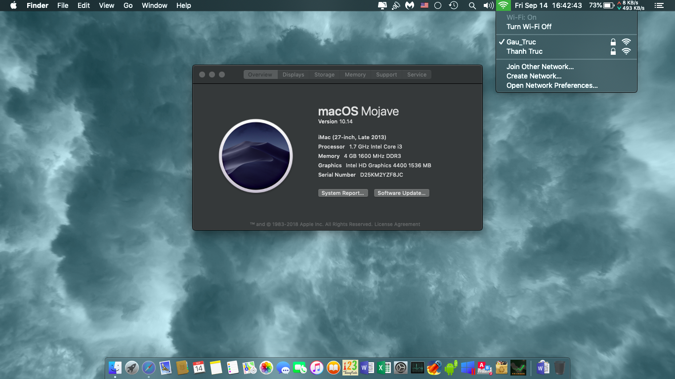

lucgiakg Posted September 14, 2018 Share Posted September 14, 2018 On 7/1/2018 at 7:35 PM, athlonreg said: Hi everyone here, today i driver my ar9565 wireless adaptor in macOS Mojave successfully, and i has commit the pull requests, https://github.com/chunnann/ATH9KFixup/pull/6 and there are the drivers i am usingATH9K-10.14.zip You can install atherosairport40 to /system/library/extensions/io80211family.kext/contents/plugins,install lilu and ath9kfixup to clover, good luck for you Thanks for help me, it work very well in mojave !! Link to comment https://www.insanelymac.com/forum/topic/312045-atheros-wireless-driver-os-x-101112-for-unsupported-cards/page/23/#findComment-2634755 Share on other sites More sharing options...
