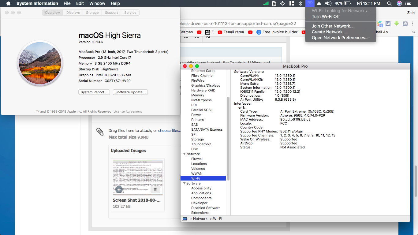

ic005k Posted August 23, 2018 Share Posted August 23, 2018 For DW1707 (AR9565), when connecting to a mobile phone hotspot, the Tx rate is 11Mbps, and there is no way to access the Internet. I don't know why, can it be solved? Thank you! On 8/21/2018 at 3:15 PM, zainanjum100 said: Please update AR9565 patch for high sierra 10.13.6 patch is not working on 10.13.6 10.13.6 is normal, you can use this method:https://github.com/black-dragon74/ATH9KFixup/releases However, when connecting with some routers, there will be situations where you can't access the Internet. For example, I am connected to the mobile phone hotspot. Link to comment https://www.insanelymac.com/forum/topic/312045-atheros-wireless-driver-os-x-101112-for-unsupported-cards/page/22/#findComment-2631483 Share on other sites More sharing options...
zainanjum100 Posted August 24, 2018 Share Posted August 24, 2018 (edited) 19 hours ago, ic005k said: For DW1707 (AR9565), when connecting to a mobile phone hotspot, the Tx rate is 11Mbps, and there is no way to access the Internet. I don't know why, can it be solved? Thank you! 10.13.6 is normal, you can use this method:https://github.com/black-dragon74/ATH9KFixup/releases However, when connecting with some routers, there will be situations where you can't access the Internet. For example, I am connected to the mobile phone hotspot. couldn't scan any wifi Edited August 24, 2018 by zainanjum100 Link to comment https://www.insanelymac.com/forum/topic/312045-atheros-wireless-driver-os-x-101112-for-unsupported-cards/page/22/#findComment-2631494 Share on other sites More sharing options...

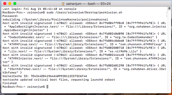

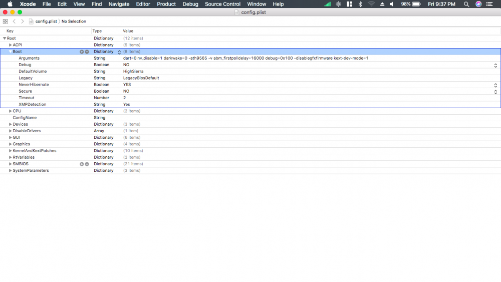

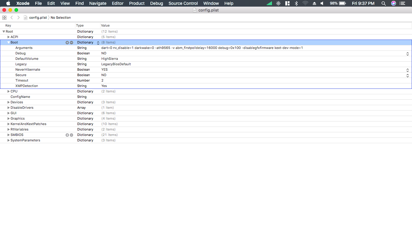

ic005k Posted August 25, 2018 Share Posted August 25, 2018 (edited) 20 hours ago, zainanjum100 said: couldn't scan any wifi User -ath9485 boot arg for AR9485 and -ath9565 for AR9565 (If you don't use any boot args it will do the patching for AR946X by default) Please include the boot tag in Clover's configuration file: -ath9565 Edited August 25, 2018 by ic005k Link to comment https://www.insanelymac.com/forum/topic/312045-atheros-wireless-driver-os-x-101112-for-unsupported-cards/page/22/#findComment-2631566 Share on other sites More sharing options...
zainanjum100 Posted August 25, 2018 Share Posted August 25, 2018 2 hours ago, ic005k said: User -ath9485 boot arg for AR9485 and -ath9565 for AR9565 (If you don't use any boot args it will do the patching for AR946X by default) -ath9565 is already there but still wifi not working Link to comment https://www.insanelymac.com/forum/topic/312045-atheros-wireless-driver-os-x-101112-for-unsupported-cards/page/22/#findComment-2631583 Share on other sites More sharing options...

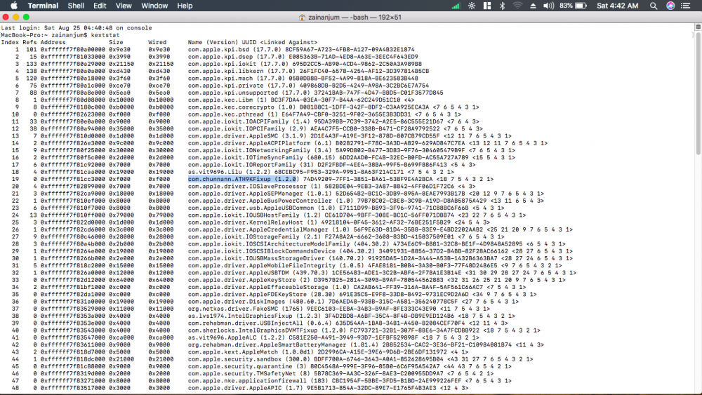

ic005k Posted August 25, 2018 Share Posted August 25, 2018 3 hours ago, zainanjum100 said: -ath9565 is already there but still wifi not working It seems that ATH9KFixup.kext is not loaded properly. Please check if ATH9KFixup.kext is loaded normally? Link to comment https://www.insanelymac.com/forum/topic/312045-atheros-wireless-driver-os-x-101112-for-unsupported-cards/page/22/#findComment-2631607 Share on other sites More sharing options...
zainanjum100 Posted August 25, 2018 Share Posted August 25, 2018 (edited) it is loaded check below: Edited August 25, 2018 by zainanjum100 Link to comment https://www.insanelymac.com/forum/topic/312045-atheros-wireless-driver-os-x-101112-for-unsupported-cards/page/22/#findComment-2631620 Share on other sites More sharing options...

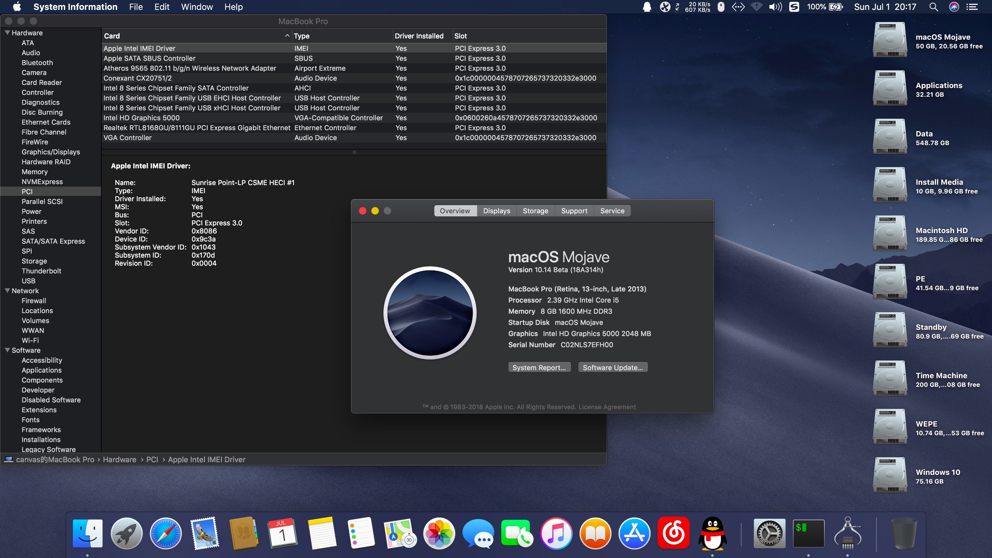

zainanjum100 Posted August 26, 2018 Share Posted August 26, 2018 On 7/1/2018 at 5:35 PM, athlonreg said: Hi everyone here, today i driver my ar9565 wireless adaptor in macOS Mojave successfully, and i has commit the pull requests, https://github.com/chunnann/ATH9KFixup/pull/6 and there are the drivers i am usingATH9K-10.14.zip You can install atherosairport40 to /system/library/extensions/io80211family.kext/contents/plugins,install lilu and ath9kfixup to clover, good luck for you i have the same wifi device AR9565 and i am on Mojave public beta 8 i followed your method but it did not work even hardware did not recognize Can some one come up like an angel and fix my problem.? Link to comment https://www.insanelymac.com/forum/topic/312045-atheros-wireless-driver-os-x-101112-for-unsupported-cards/page/22/#findComment-2631734 Share on other sites More sharing options...
ic005k Posted August 26, 2018 Share Posted August 26, 2018 1 hour ago, zainanjum100 said: i have the same wifi device AR9565 and i am on Mojave public beta 8 i followed your method but it did not work even hardware did not recognize Can some one come up like an angel and fix my problem.? Is the network card hardware broken? Try to see if this NIC is working properly under Windows or Linux. Link to comment https://www.insanelymac.com/forum/topic/312045-atheros-wireless-driver-os-x-101112-for-unsupported-cards/page/22/#findComment-2631740 Share on other sites More sharing options...
