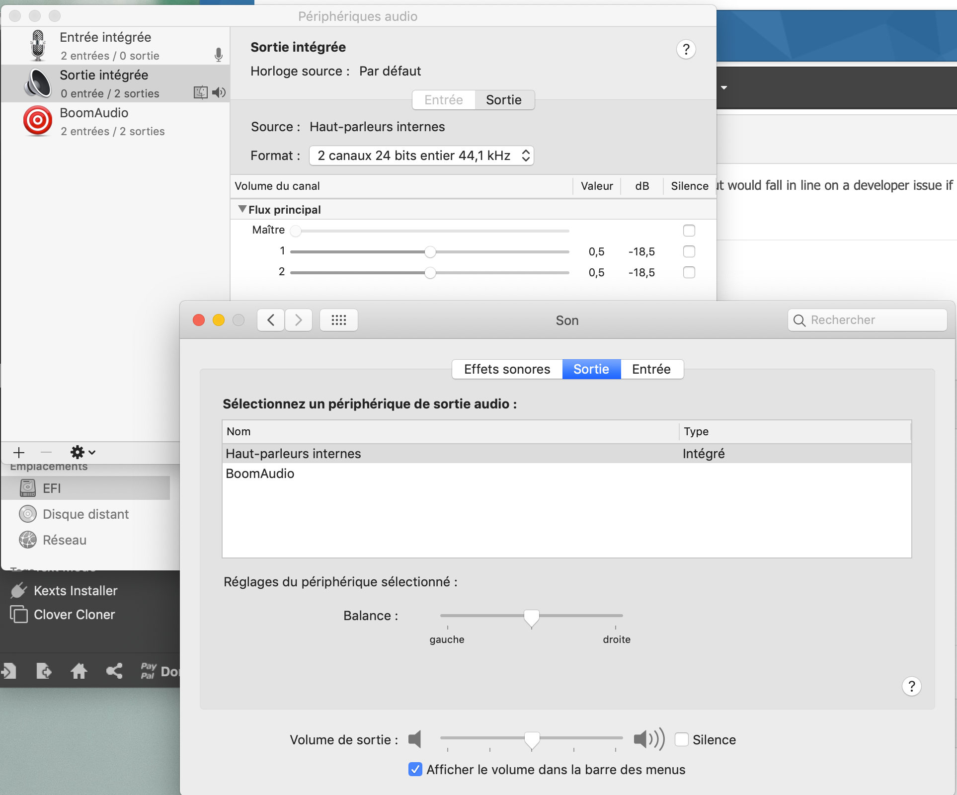

My laptop has speaker Left and Right working.
What's not working : Subwoofer, Internal Microphone.
Based on my research linux user successfully enable the subwoofer by doing this :
  • Set pin with ID 0x17 to "Override" with "Dock Headphone"
  • Try setting pin 0x21 to "Override" with "Headphone" to resolve the quieter headphone sound.
I've done some tries using pin configurator but I don't know how to apply my modification to appleALC.
Thanks a lot if we can find a way to make the subwoofer work ?
And That would be perfect if the internal mic could also work, but I might be dreaming ^^.

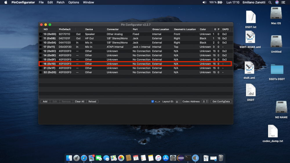

Hello! I was wondering if it was possible to enable my laptop's subwoofer using AppleALC. I did a lot of research and found nothing.
I booted into linux and got a codec dump, and I know for a fact that the subwoofer is at Node 16 (0x10), because enabling it on linux with hdajackretask works perfectly fine.
But when opening the dump on Pin Configurator it shows as is in the image:
Any help will be appreciated! :)
I'll attach the codec dump too. IDT 92HD91BXX
EDIT: I'm able to get sound using layouts 12, 13, 33 and 84. But all sound really terrible due to the lack of the subwoofer.

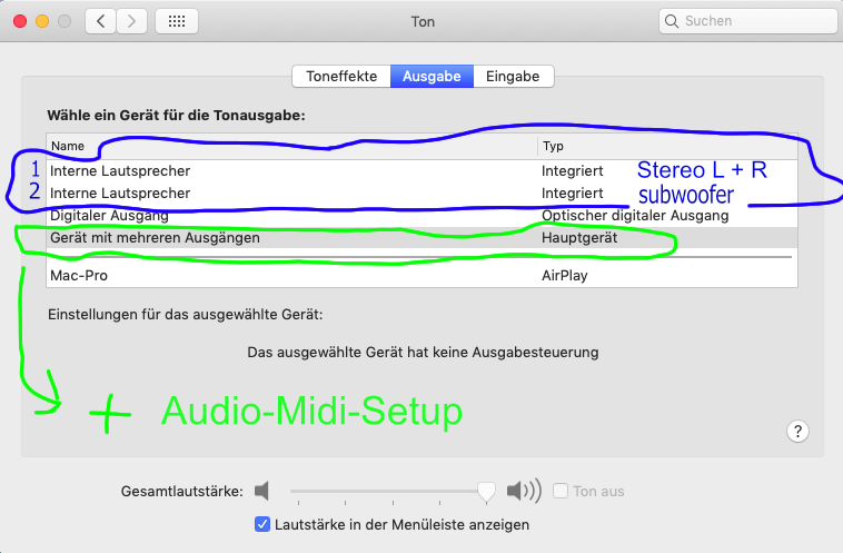

Speaker L + R and subwoofer are two connections.
No problem with Windows, here the driver connects. With Linux, too.
Everything is different with macOS.

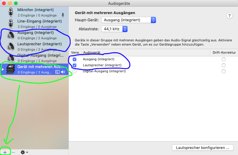

HowTo laptop subwoofer with macOS:
There are only a few laptops with a subwoofer.
The existing IDs may not help.
One of my laptops has a subwoofer and works with my LayoutID with AppleALC.
Example (my codec ALC888S-VD - LayoutID 28 (1C) in AppleALC source):
Internal speakers (1) are configured in switch mode with HP -> sound alone is not good
internal speakers (2) subwoofer -> sound alone is not good, only bass
Then in the Utilities / Audio Midi Setup with + characters a "Create device with multiple outputs"
Select both internal connections here.
Then select "Device with multiple outputs" in System Settings / Sound.
Sound is now perfect with stereo L + R + subwoofer.
The codec for you must certainly be developed first.

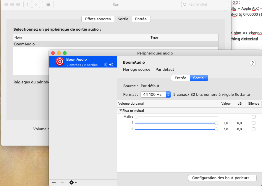

Thanks a lot for the time you spend working on my issue.
Even in linux i had to go to unaffected pin to enable it.
I've done the process but sadly my subwoofer does not show...
Therefor I can not see many output device : only stereo shows here...
I have install BoomAudio to merge my audio I/O
1046088679_Capturedecran2020-05-12a18_22_27.thumb.png.c738c1c06122941c2fd5ec0c7f075c01.png
1 hour ago, MacPeet said:
@IMarty @EmiZanotti @all
I will look at your codec_dump's in the next few days.
The layoutID's probably have to be developed first.

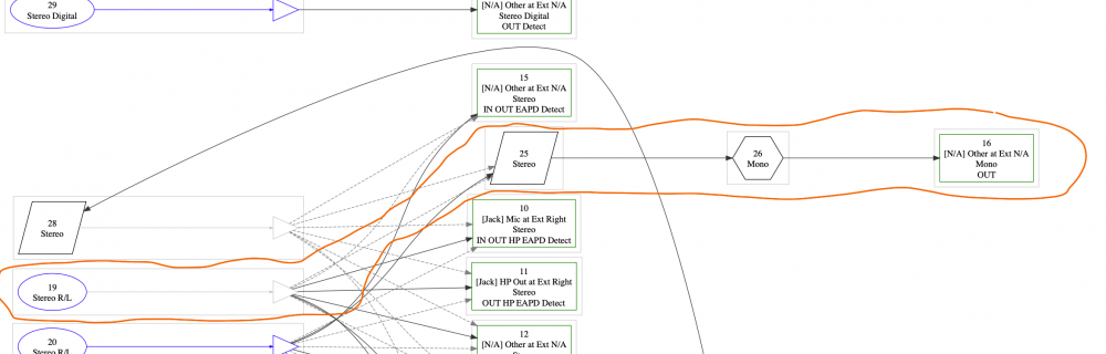

@EmiZanotti
Your Linux codec_dump isn't any better either.
I think subwoofer is at node 16-26-25-19.
I will continue to see tomorrow.
Dump.zip
Sub is only mono. Bass box mostly installed on the right.

@MacPeet yeah, on ubuntu when I override node 0x10 with "Internal Speaker (LFE)" it enables the subwoofer.
This is the tutorial I followed to enable it in linux:
STEP 6
Go to the section having pin id : 0x0d .
Change (Internal Speaker, Front side) to “Internal speaker”.
STEP 7
Go to the section having pin id: 0x0f.
Change (Not connected) to “Internal speaker”. This part is about the under-display speakers.
STEP 8
Go to the section having pin id: 0×10.
Change (Not connected) to “Internal speaker (LFE)”. This part is about the sub-woofer
Please let me know how can I help you with. I'm very grateful for the time you are spending to help me with this problem.

Here is the process I did :
Download you files Lillu + Apple ALC => put them in L/E
Change the alc-layout-id to 0F00000 (15 in hexadecimal)
Rebuild Kext cache
Restart
Boot loop due to GFX pbm => changed intelGFXId to 0x12345678
Result is sadly nothing detected 168587292_Capturedecran2020-05-15a16_15_26.png.4e7c3fea12ff3dddba985dd0c696f250.png
I have the sound workking perfectly on Windows10, is there a process I can follow in order to "transfert" the windows lenovo drivers to macos or linux ?
Is there any way to "clean" my linux dump error ?

@EmiZanotti
I'm looking at step 6/7/8.
The "Internal Spe aker (LFE)” option is unfortunately not available in PinConfig under macOS, only "internal speaker".
Unfortunately, the link does not help me.
Okay so due to me and iMarty having a similar issue, I replaced AppleALC with VoodooHDA, and sound works (no subwoofer tho) but I don't know how to get a VoodooDump. I researched and fount that get dump utility is included, but I can't find it
I really don't want to stick with VoodooHDA though. Internal mic is super saturated and sound is really low
