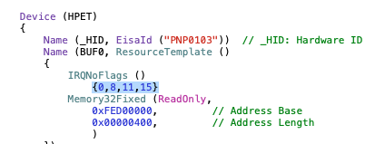

You need to add IRQFlag 0,8,11,15 to HPET then Delete IRQFlag from IPIC, RTC and TIMR in your DSDT
somehow it fixed when i block Com.Driver.AppleHPET
https://github.com/acidanthera/bugtracker/issues/422#issuecomment-523642854
as if there're another elegant solution please kindly reply

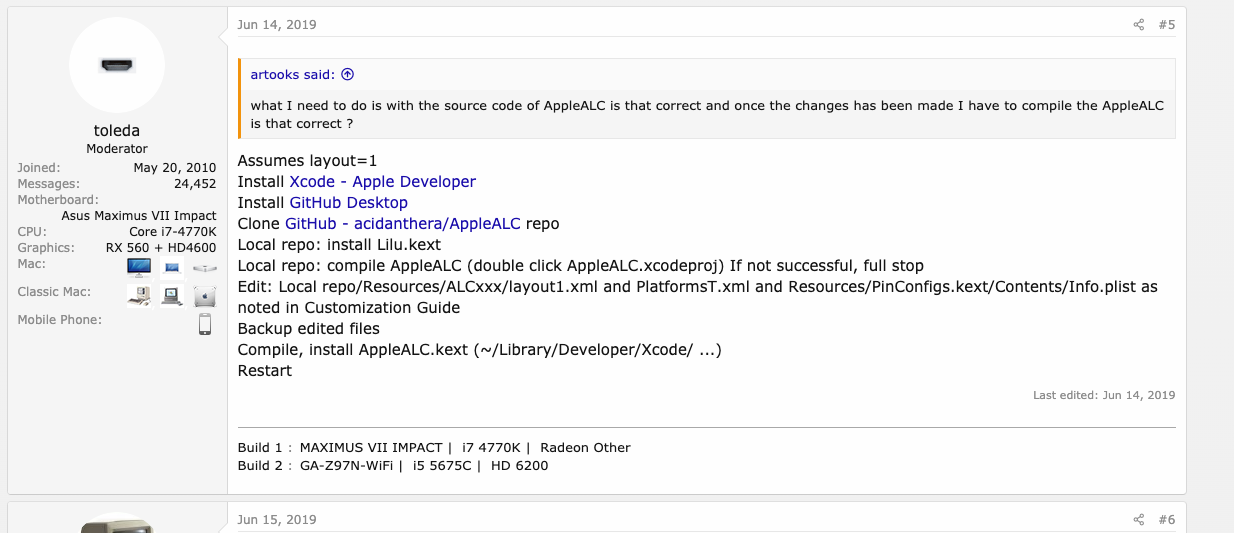

I need help in customizing AppleAlc based on (https://github.com/toleda/audio_ALC_guides/blob/master/Customization.pdf).
I can get my PCI SPDIF to work under ALC887 layout ID 99 but then I lose the other jacks. My board has :
Meaning if I use ALC887, layout ID 99, I don't see the above colored ports.
I was hoping to customize a new layout based on layout ID 7 or 1 which can see the above ports but add SPDIF-2.
I need more handholding regarding the steps below provider by Toleda:
1861414892_Screenshot2020-04-07at2_48_06PM.thumb.png.5cb6c6c3a2bfb619ed17475d91202d72.png
I have done:
Install Xcode
Install Github Desktop
Clone Github - acidanthera/AppleALC
Lilu is installed
Stuck at steps to do AppleALC compile......
Thanks.

Take a look to Acidanthera/AppleALC Repo, the laster release is out :)
To build AppleALC (Lilu plugin), You need Lilu debug kext (copy/paste) to AppleALC directory, before to build.
OK. Did that and AppleALC compiled susccessful from the cloned GitHub repo.
Apparently I can use Pin Configurator to do the customization. Any hand holding for this here? I'm not sure what the steps are...... Thanks

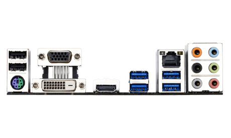

On 4/9/2020 at 12:11 AM, MacPeet said:
Ok, SPDIF works with ID99.
The colored connections work with which ID ¿¿¿
Solvable with new codec and new ID.
Which computer is it at all ¿¿¿
They do not give any hardware info, no signature !!!
A codec dump from a Linux Live version is always better.
We can do more with that.

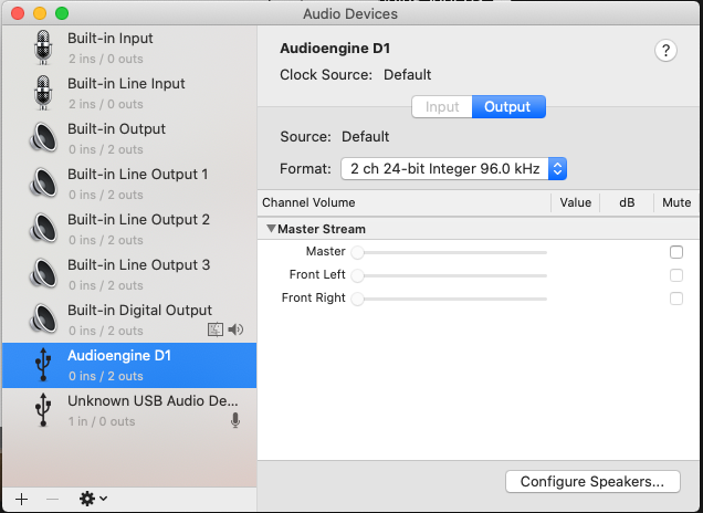

Motherboard Gigabyte H97-HD3.
Using ALC887, Layout ID = 7, I get:
Lime Green (Rear) - is built in output - works. Lime green (front) also works and has autodetect.
Grey - is built-in line out 1 - works
Orange - is built-in line out 2 - works
Black - is built-in line out 3 - works
Built-in digital output - DOES NOT work.
I do not have a Mic to test the input ports.
I did not test built-in inout and line input.
The above USB sound devices (Audioengine and audio - Logitech Webcam) - work.

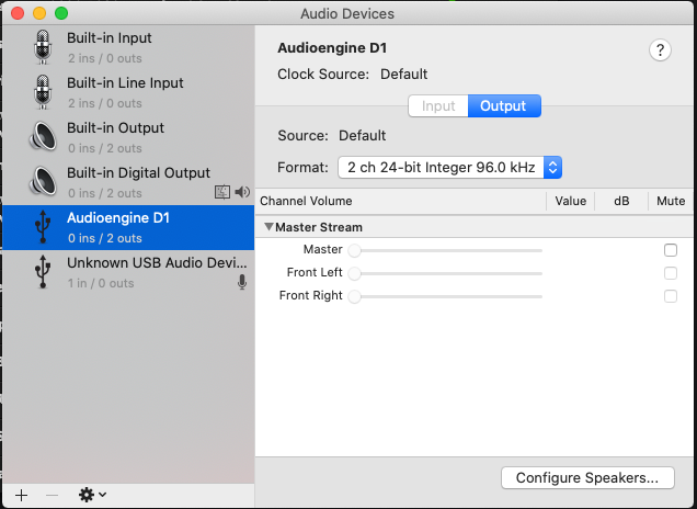

Using layout ID=99, I get:
Built-in digital output now works.
The built-in output works and is lime green. Front headphone works and autodetects.
But I lost the other audioports.
Thanks for all the help.
Edited by mengshi
