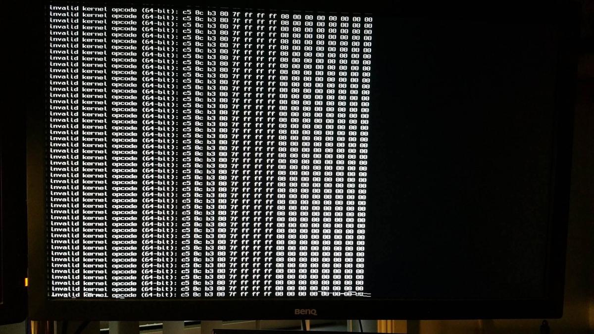

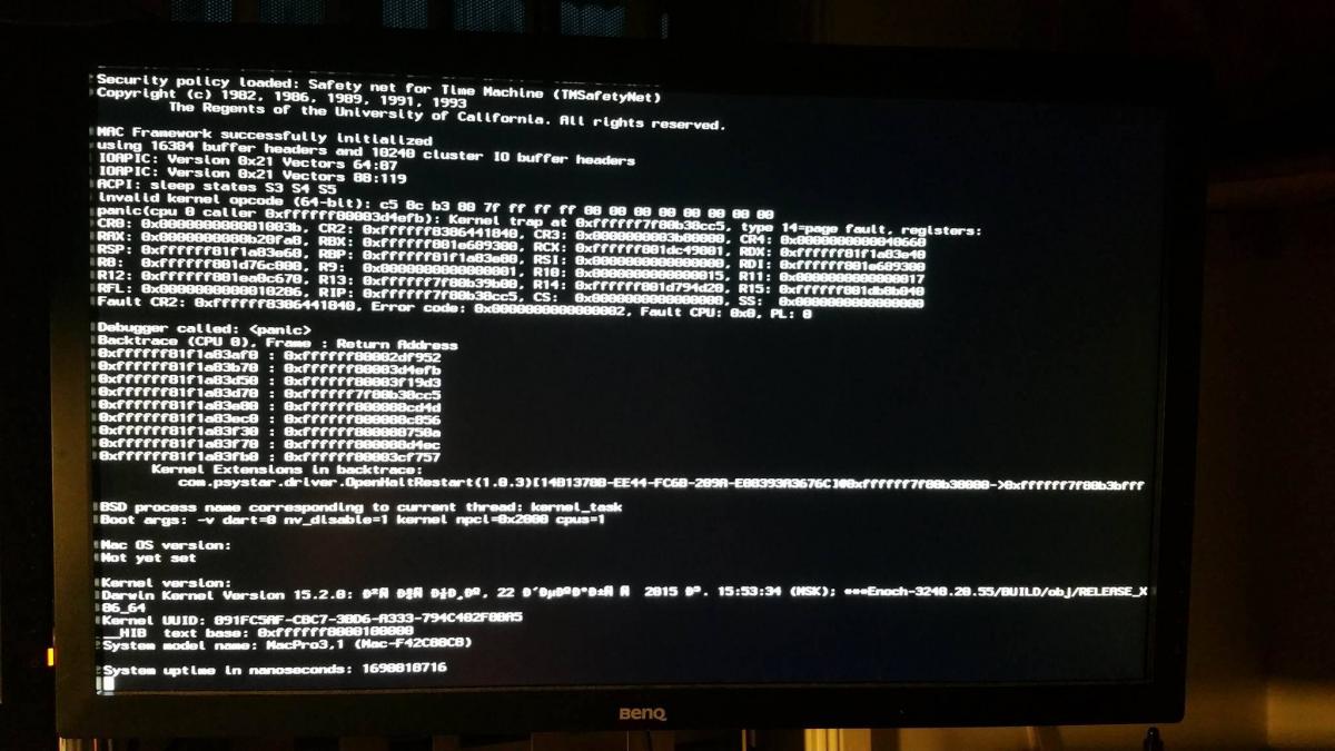

I've got a laptop already running Mavericks that I've used to create a USB install media disk for my AMD-based rig. I've used Enoch with El Capitan and an AMD-based kernel, placed in /System/Library/Kernels and also in the root of the drive, and I've set Chameleon to use this kernel.
However, when I boot, I get the two attached crash screens.

try npci=0x2000

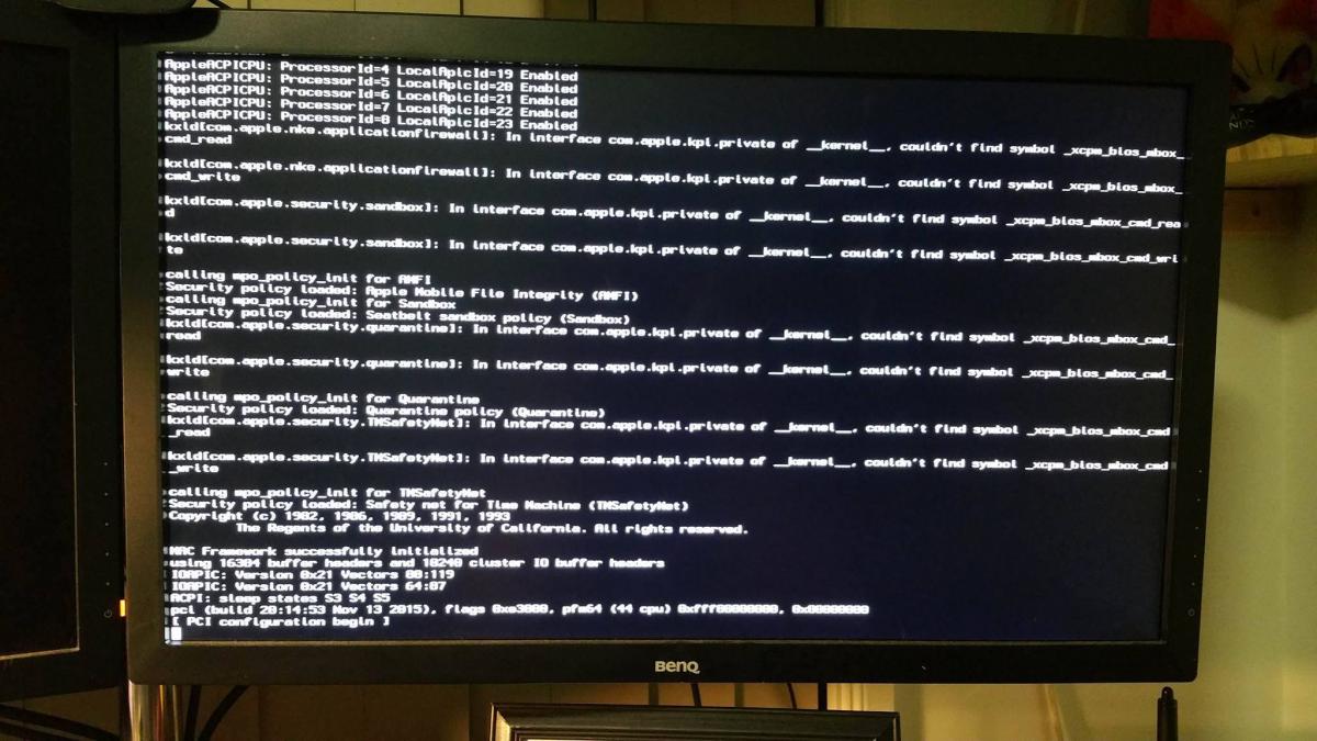

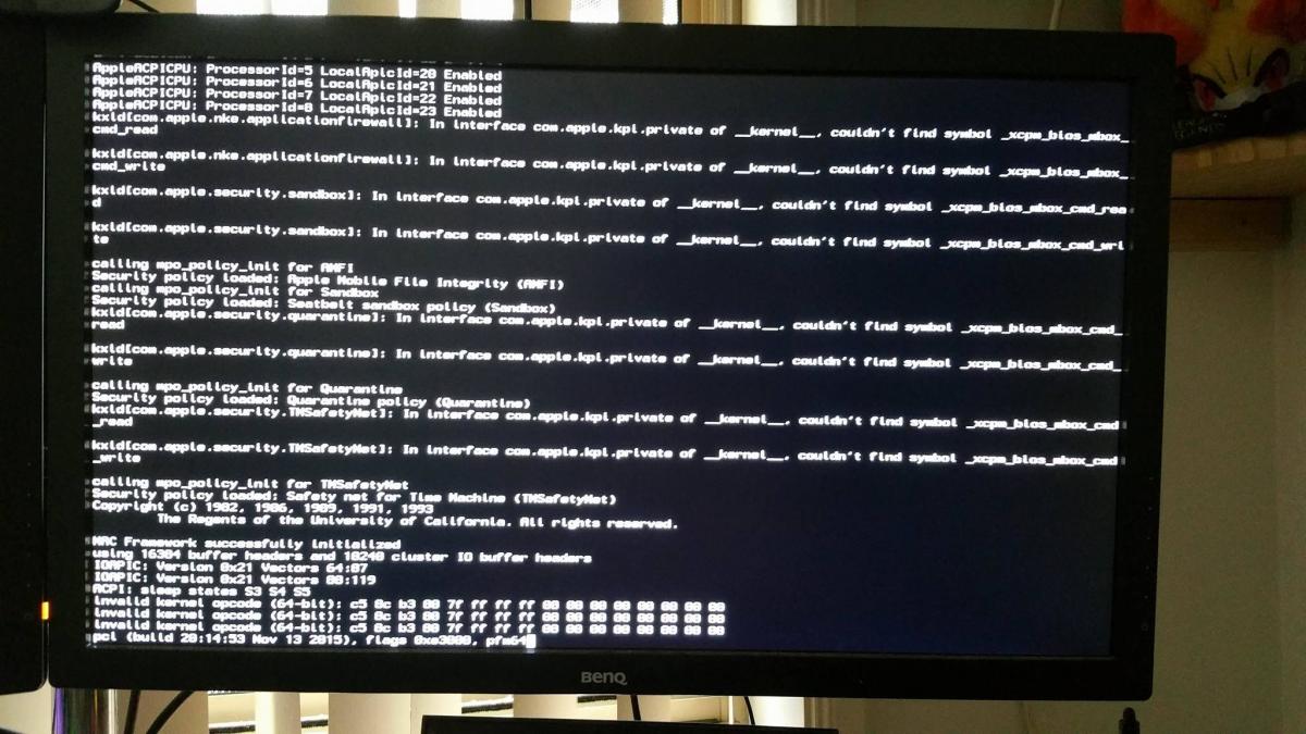

UPDATE: I tried Bronya's AMD kernel instead of y2k4u's one, and used the boot flag npci=0x2000 like you said earlier and BOOM a new result! According to this, the system actually lived this time before it crashed. Progress!
Hi, thanks for your post!
I did as you said, and I got the USB stop restart loop that I've seen others have. Any advice on fixing that?
