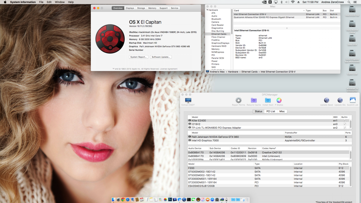

Hi Guys, i upgraded my motherboard from Z170-HD3 to Z170X-Gaming 7 :)
System Specifications :
Processor : Intel Core i7 6700 SkyLake
Motherboard : Gigabyte Z170X - Gaming 7 (I need more onboard Sata Ports)
VGA : Palit Jetstream GTX960 4GB DDR5
Memory : Dual Channel Team Extreem Dark 8GB (2x4GB) DDR4 3000Mhz OC
Storages : 6 Storages (120GB SSD Natno For Windows 10 Enterprise, 120GB Fujitsu for OS X El Capitan, 2TB For Data Multimedia / Program, 2TB for Master Game Installer, 500GB For Data OS X, 500GB for Game Live Installed)
Optical Drive : Asus DVD-RW Box
LAN : Dual LAN - Killer LAN E2400 dan Intel I219V
Camera : A4Tech PK-920H WebCam
Monitor : 2X Asus VN248H @24" Full HD Supported
Audio Codec : Creative CA0132
Clover version : 3330
OS X Version : El Capitan 10.11.2 Beta Build 15C48a
Boot Mode : UEFI with CSM Disabled
Working :
1. QE/CI Full Support with Nvdia
2. Camera Webcam OOB
3. Sleep, Restart, Shutdown
4. I use Voodoo HDA version 2.8.8 for my Creative CA0132
5. HDMI Audio from Nvidia Card
6. Power Management, Multiplier dan Turbo Boost with SSDTPrGen from Pike R. Alpha
7. iMessages (Inject MLB and ROM from Real MacBookPro)
8. LAN Killer E2400
9. Etc
Not Working :
1. Can'nt use AppleHDA :( Update : we can use AppleHDA for Creative CA0132. See here http://www.insanelymac.com/forum/topic/309441-new-applehda-patcher/?p=2194865
2. Not supported Ethernet I219V yet
3. Intel HD 7000 Integrated
4. Super Speed USB 3.0 not function at 10.11.2 Beta version. But, with 10.11.1 Public releas it's working nicely. Bug i thought. Update : with 10.11.2 Build 15C50 all USB are Working, use my "Z170X-Gaming-7-USB3.0-Injection.kext" and SMBios 17.1 Credit to Rehabman
I just need to flash bios into beta version then disable IOAPIC Entry :) , then dumping your DSDT with Clover and check about all of your XHC device port and make USBInjection.kext from Clover :)

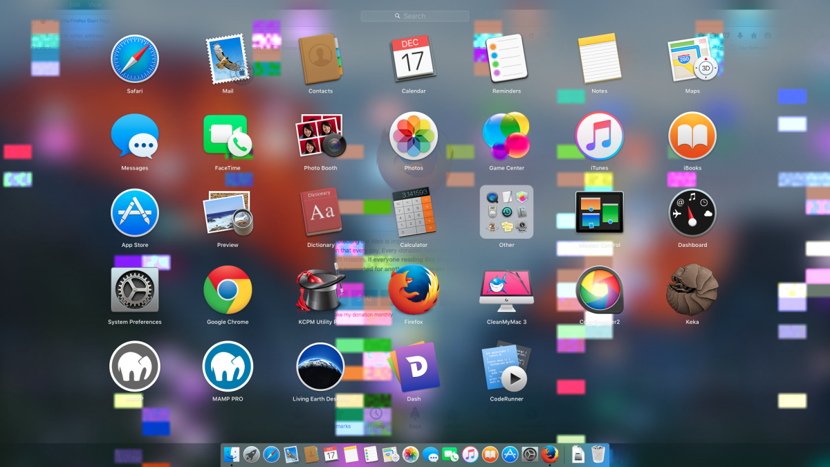

Seems like vga not work well. I had to boot using port display port, then the login screen to switch to hdmi port and I have set up in BIOS Intel Hd Graphics onboard card was 530. I used discrete amd r9380. Where can I find this kext ?
This is screen shot
for AMD Graphics Card,, you need to Patch ATY Connector :D
Read this one, credit to Vlada http://www.insanelymac.com/forum/topic/303186-how-to-modification-of-amd-fb-clover-injection/

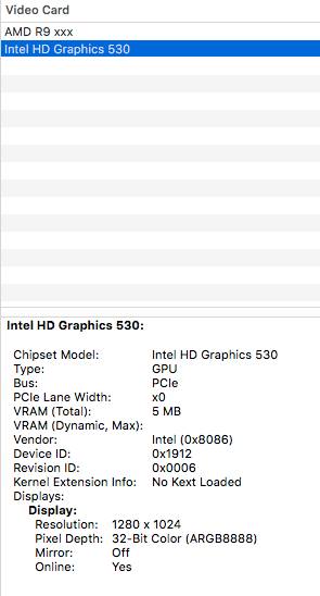

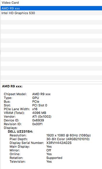

I have Nvidia 970 4GB, but after installing alternative drivers from nvidia my machine is still running some weird 7MB version of it.
Is there anything special I need to do? When I enable Integrated graphic on the BIOS my machine does not want to boot up.
Thats like its not working properly, safe mode style! You should download and install latest (google them) nvidia web drivers, then check your config plist in clover configurator and make sure nvda_drv=1 is checked in 'Boot' section of clover, File>Save. reboot to see if it works. If not you'll have to nv_disable=1 when you reboot to Clover boot, arrow over to options and put them in the boot attributes there so you can one time get back into OS X and sort it out.

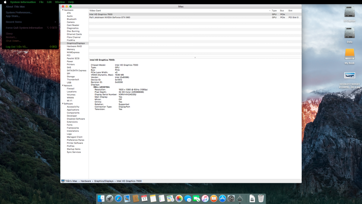

Don't use my DSDT, LoL
I have already inject my Nvdia GTX960 at DSDT, so you need remove DSM method at PCi0.PEG0.PEGP so it will detect your graphcs card correctly
I think Intel Hd Graphics 530 not working correctly.
This is my screenshot. Anyone can fix it ???
