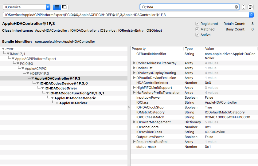

After following some links from OP on this thread, I found another thread where Wern is still developing a modded AppleHDA.kexthttp://www.insanelym...ohda/?p=2379348
I got rid of all my other audio-related changes, replaced my /System/Library/Extensions/AppleHDA.kext with that, and set audio layout inject to 1 with HDAS to HDEF renaming in clover plist. I've now got audio on most of my headphones and line out ports with volume control! I'm on 10.12.3.

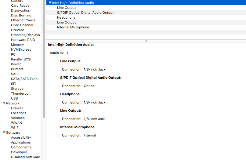

I got my audio running with AppleALC 1.1.1 and Lilu 1.1.0 in clover/kexts/other with Layout id=2 injected. Z170X Gaming 7 rev 1.0 MOBO. Only once did it not work and i hat to shut down, start windows and start Sierra again. But like i said it works 98%. Never happened again. (Its been a few weeks). If layout ID 2 doesnt work, try 0-6.
Let me know if that helps.
