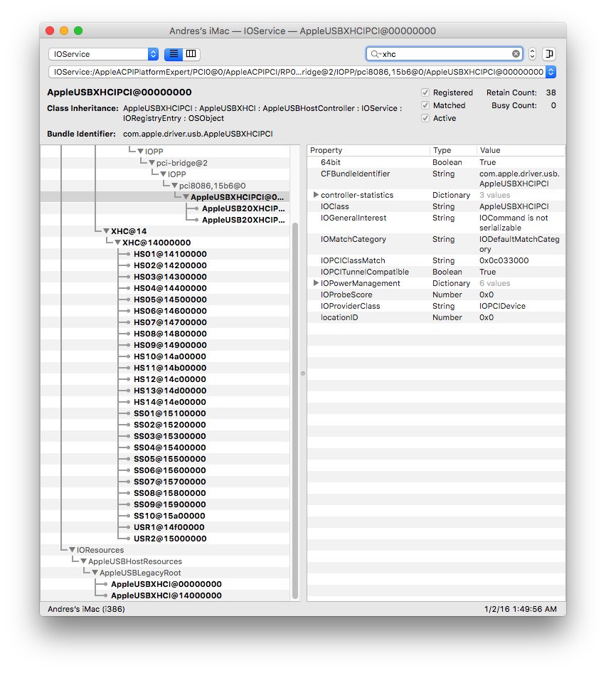

Andros, Ive hit upon a snag with the GIGABYTE Gaming G1. Id been using a PCIe USB 3 card of recent weeks but decided to see if any of the motherboards USB ports would work since developments and take out the PCIe card. Also one of my front side USB3 blue ports has a pin broken so I have to get round to soldering it back together at some stage but wondered if a missing pin would effect other parts of the USB chain. The fronts list as HS04 4 port from 14410000 to 1440000 and the broken pin means port 14420000 doesn't work. So I should be ok Id have thought with one missing port.
What I would like to know.
Did all your USBs show up from HS01 all the way upto the USR ports when you used USBInjectAll for your board ? Im only getting HS01 to HS10 and since I have a very similar board to yours I wondered why this was occurring.
In System Information > USB I see the non working device listed as USB 3.0 Bus with;-
USB 3.0 Bus:
  Host Controller Driver: AppleUSBXHCIPCI
  PCI Device ID: 0x15b6
  PCI Revision ID: 0x0000
  PCI Vendor ID: 0x8086
Nothing I do can get it working it seems.
Could you take a look?
Here attached is my ioregistryexplorer file zipped if you need it.
Thanks
PS   The other device is fine as in;-

Sorry for the late reply,,,
Yes,, i have all port HSx and SSPx show at IOREG
Don't forget to use Patch to unlock limit ports, see the screenshot for the patch

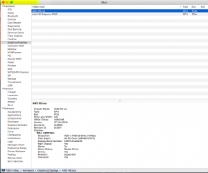

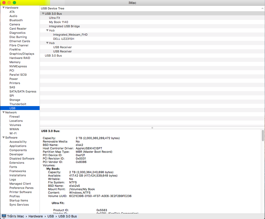

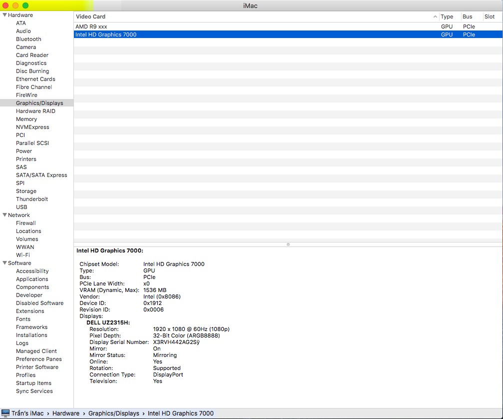

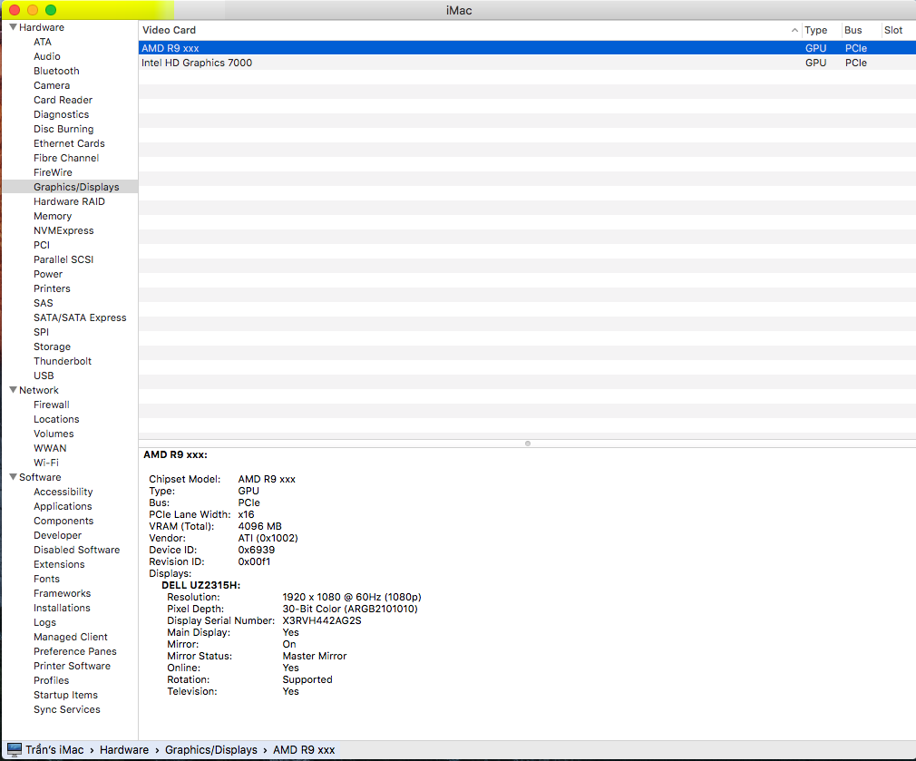

Hi Guys, i upgraded my motherboard from Z170-HD3 to Z170X-Gaming 7 :)
System Specifications :
Processor : Intel Core i7 6700 SkyLake
Motherboard : Gigabyte Z170X - Gaming 7 (I need more onboard Sata Ports)
VGA : Palit Jetstream GTX960 4GB DDR5
Memory : Dual Channel Team Extreem Dark 8GB (2x4GB) DDR4 3000Mhz OC
Storages : 6 Storages (120GB SSD Natno For Windows 10 Enterprise, 120GB Fujitsu for OS X El Capitan, 2TB For Data Multimedia / Program, 2TB for Master Game Installer, 500GB For Data OS X, 500GB for Game Live Installed)
Optical Drive : Asus DVD-RW Box
LAN : Dual LAN - Killer LAN E2400 dan Intel I219V
Camera : A4Tech PK-920H WebCam
Monitor : 2X Asus VN248H @24" Full HD Supported
Audio Codec : Creative CA0132
Clover version : 3330
OS X Version : El Capitan 10.11.2 Beta Build 15C48a
Boot Mode : UEFI with CSM Disabled
Working :
1. QE/CI Full Support with Nvdia
2. Camera Webcam OOB
3. Sleep, Restart, Shutdown
4. I use Voodoo HDA version 2.8.8 for my Creative CA0132
5. HDMI Audio from Nvidia Card
6. Power Management, Multiplier dan Turbo Boost with SSDTPrGen from Pike R. Alpha
7. iMessages (Inject MLB and ROM from Real MacBookPro)
8. LAN Killer E2400
9. Etc
Not Working :
1. Can'nt use AppleHDA :( Update : we can use AppleHDA for Creative CA0132. See here http://www.insanelymac.com/forum/topic/309441-new-applehda-patcher/?p=2194865
2. Not supported Ethernet I219V yet Work with new kext see here http://www.insanelymac.com/forum/topic/205771-appleintele1000ekext-for-108107106105/page-38?do=findComment&comment=2195842credit to @alreadystarted
3. Intel HD 7000 Integrated
4. Super Speed USB 3.0 not function at 10.11.2 Beta version. But, with 10.11.1 Public releas it's working nicely. Bug i thought. Update : with 10.11.2 Build 15C50 all USB are Working, use my "Z170X-Gaming-7-USB3.0-Injection.kext" and SMBios 17.1 Credit to Rehabman
I just need to flash bios into beta version then Go to BIOS Setup and "disable IOAPIC Entry" :) , then dumping your DSDT with Clover and check about all of your XHC device port and make USBInjection.kext from Clover :)
This is my Files
1. This is for Z170X-Gaming 7 + Palit Jetstream Nvidia GTX960 + TL-WDN4800. So if your system build is not same to my sytem then you need to modify DSDT File
2. Universal Setting Clover. Try to use this one,, if you want to use Integrated Graphics and Discrette Graphics Card then set into BIOS for Primary Graphics from IGFX then just boot and it should active your integrated first and discrette graphics output few later. If you just want to boot with Discrette Graphics then set at bios primary graphics is PCI-E Download
Another Screenshots
3. Sleep, Restart, Shutdown <== My hackintosh not working correctly. Sleep and not wake up, don't shutdown, it restart forever.
4. Super Speed USB 3.0 not function at 10.11.2 Beta version. But, with 10.11.1 Public releas it's working nicely. Bug i thought. Update : with 10.11.2 Build 15C50 all USB are Working, use my "Z170X-Gaming-7-USB3.0-Injection.kext" and SMBios 17.1 Credit to Rehabman <=== I install with KCMP Utility Pro but not working.
I have attach my DSDT and config.plis.
Tks for help.
