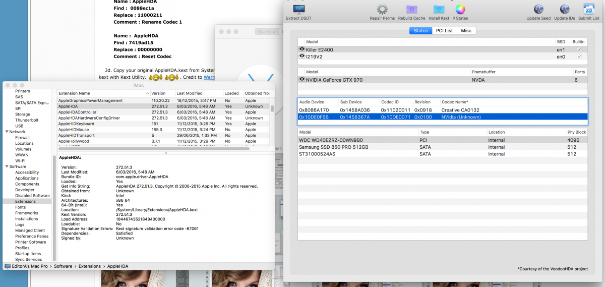

Andres ZeroCross Posted March 17, 2016 Author Share Posted March 17, 2016 Yes, I use your config.plist as well, but with a few modification. The config.plist is as attached. Can you upload image of DPCIManager.app. Run it, and take a screenshot Link to comment https://www.insanelymac.com/forum/topic/309729-gigabyte-z170x-gaming-7-success-hackintosh/page/6/#findComment-2224617 Share on other sites More sharing options...
Hiko Posted March 18, 2016 Share Posted March 18, 2016 Can you upload image of DPCIManager.app. Run it, and take a screenshot I will do that on next Monday, the computer is in my office. Link to comment https://www.insanelymac.com/forum/topic/309729-gigabyte-z170x-gaming-7-success-hackintosh/page/6/#findComment-2224681 Share on other sites More sharing options...
Hiko Posted March 21, 2016 Share Posted March 21, 2016 Here it is.. Link to comment https://www.insanelymac.com/forum/topic/309729-gigabyte-z170x-gaming-7-success-hackintosh/page/6/#findComment-2225310 Share on other sites More sharing options...
